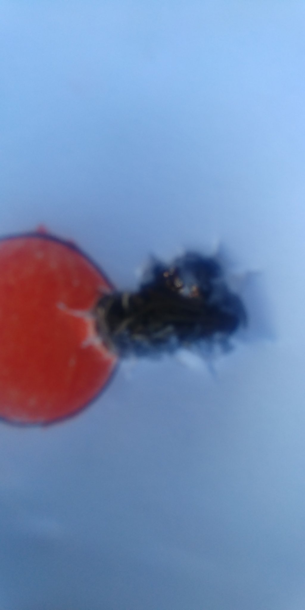

I have ridgeback and its non bedded and shoots light out. Cheaper than others but i love the features on them. I will stick with the greyboe and stick extra in pocket.
4 shot group rem 700 300 win mag unbedded
