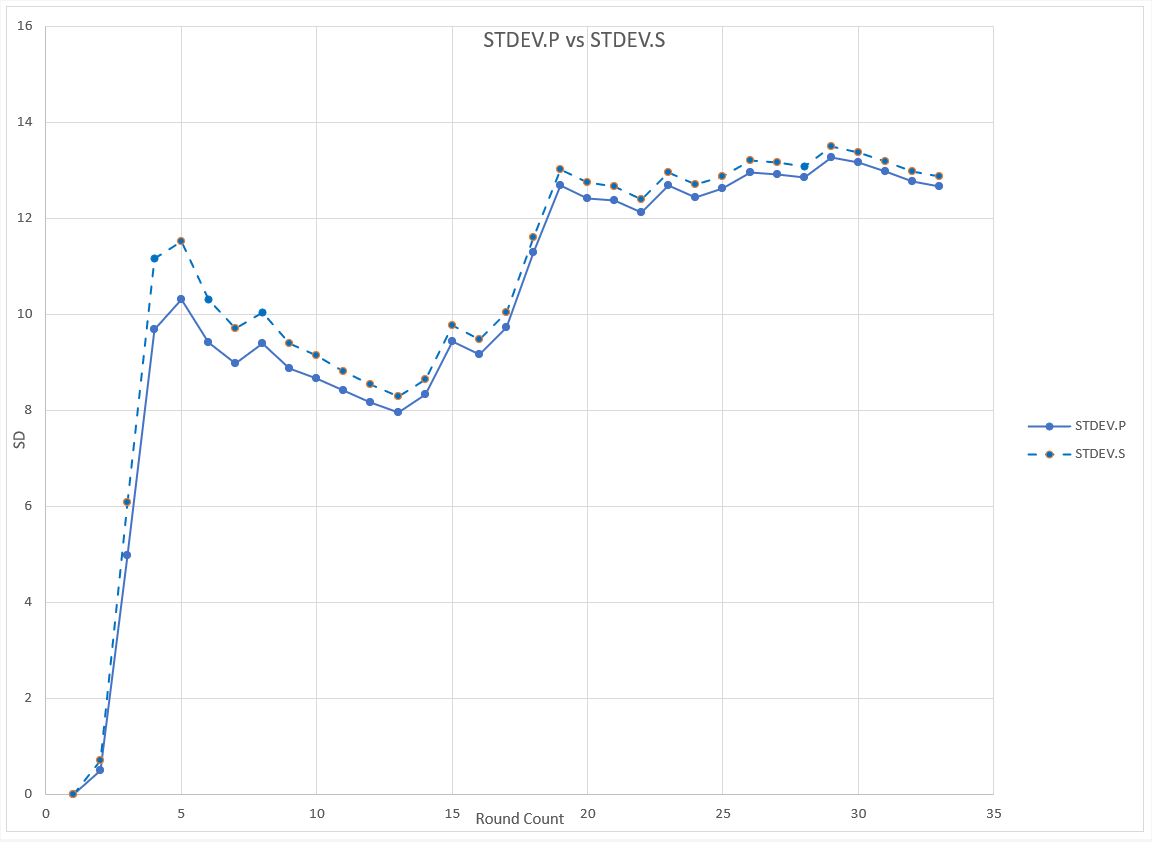

Pragmatically, it doesn't matter if you are 'sampling' enough shots to get a good idea of your actual SD. At least in my own experience, you need to have about 20-rounds +/- in order to get a good idea of your SD. The further below that you drop in terms of round count, the further into the noise you'll find yourself.
Here's a real life example with 33 rounds:
2628
2627
2638
2611
2612
2623
2617
2635
2625
2631
2630
2620
2620
2637
2645
2630
2610
2599
2596
2617
2611
2626
2600
2625
2638
2602
2609
2610
2598
2629
2615
2621
2629
STDEV.P = 12.665 fps
STDEV.S = 12.862 fps

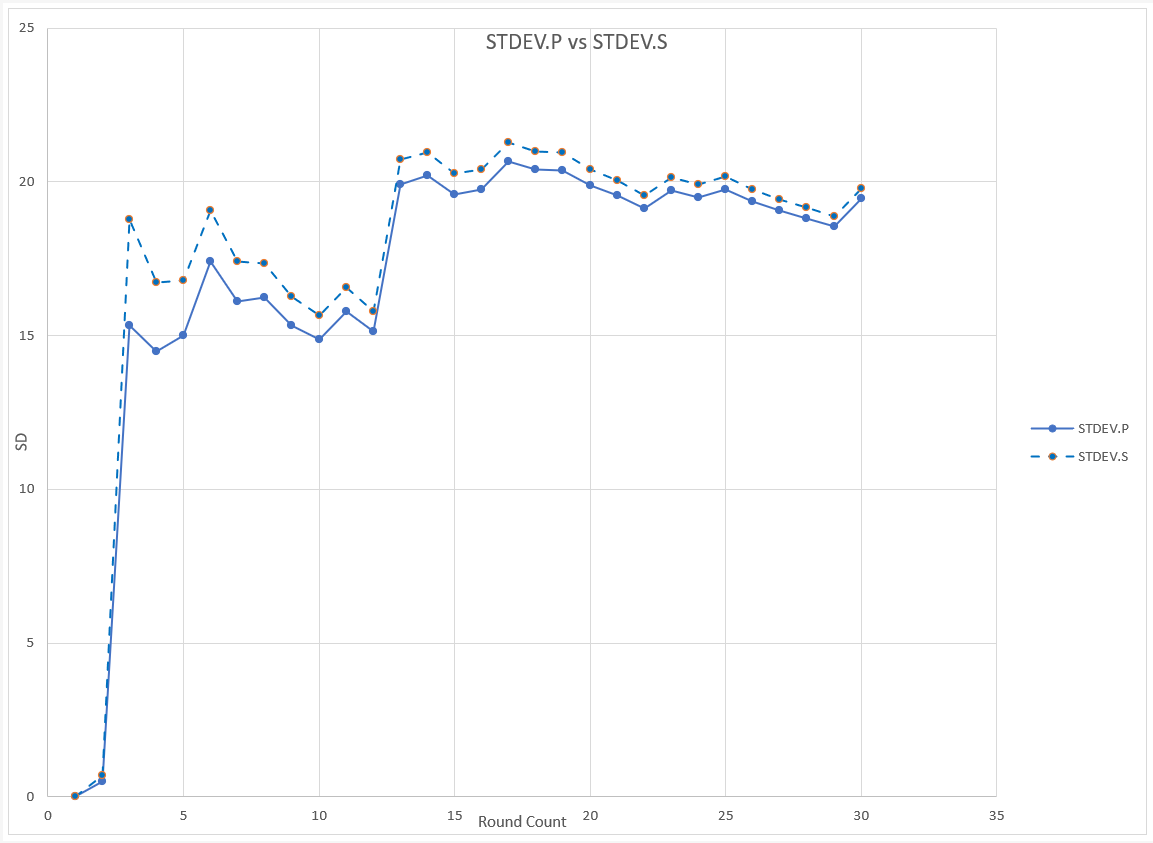

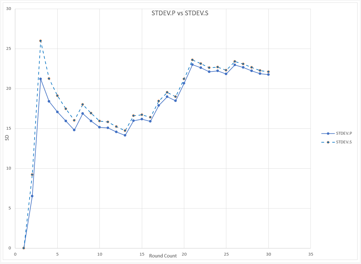

Here's another 30 rounds from a different rifle (different cartridge, different ammo, different day)
2889
2876
2839
2865
2856
2856
2860
2834
2855
2860
2874
2868
2868
2894
2883
2854
2903
2900
2869
2915
2923
2862
2870
2848
2881
2915
2886
2877
2881
2892
STDEV.P = 21.732 fps
STDEV.S = 22.104 fps

Once you get about 20 rounds+ (approximately) not only does the variation within each "method" become more stable, but the difference between the two "methods" becomes negligible from an application standpoint. It's really a non-issue unless you are one of these guys that thinks a 3-shot group is a meaningful test.
