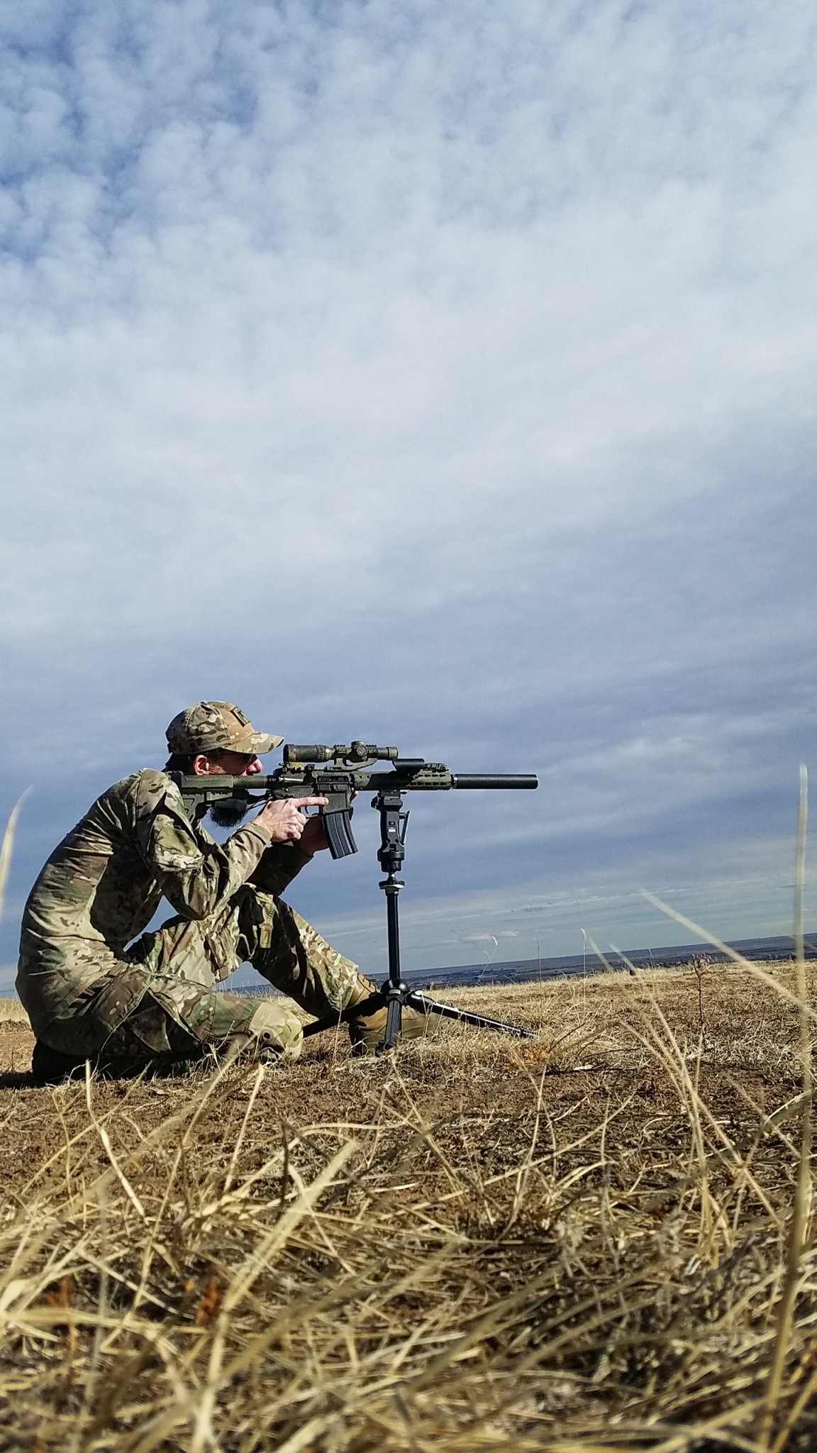

My personal 12.5" Grendel, with Bartlein barrel (with carbine +1" gas system) by Craddock, built up on a LaRue Stealth 2.0 upper, with a 16 year old LMT SBR lower that sports a Vltor A5 recoil system:
I've only shot it with my TB Ultra 7 suppressor. It's a tad picky about ammo, but manages 5-shot groups well under MOA with the right Hornady ammo. With a muzzle velocity of 2315 fps, it's a very potent package.
As an aside, the Stealth 2.0 upper (with forend) is an outstanding product.

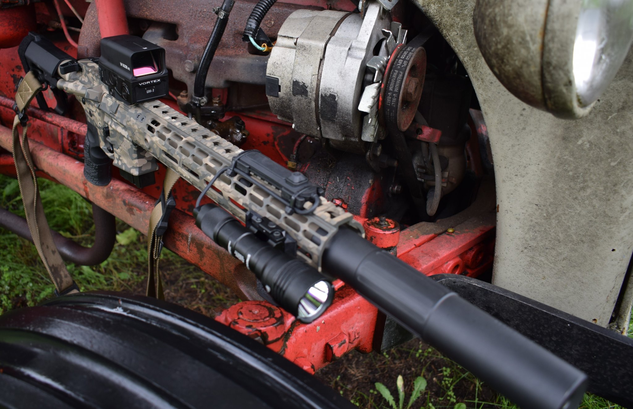

Badass! Seriously thinking about a Grendel pistol down the road. Love my 18". Any plans to hunt with this rascal?
I know you were asking him, but figured I'd chime in too. :)
I used the 129 ABLR in my 12.5" SBR a few weeks ago. Only shot one smallish deer (and some turtles, they eat the fish in our ponds), but it worked great. Impact damage was more than I expected from this mild cartridge, and plenty adequate for southern whitetail.
After walking the woods with it for a week, I really like this Grendel SBR for hunting; it's way lighter and smaller than my more traditional hunting rifles, it carries easy and is fast on target, and even with a suppressor attached it's still not any bigger than most other rifles. I'll be using it again.
Also, mine is an SBR, but it really wouldn't have made any difference if it were in pistol format with a decent brace. I do sometimes use that upper on a folding pistol lower, with good effect. Either setup works well and has it's place.

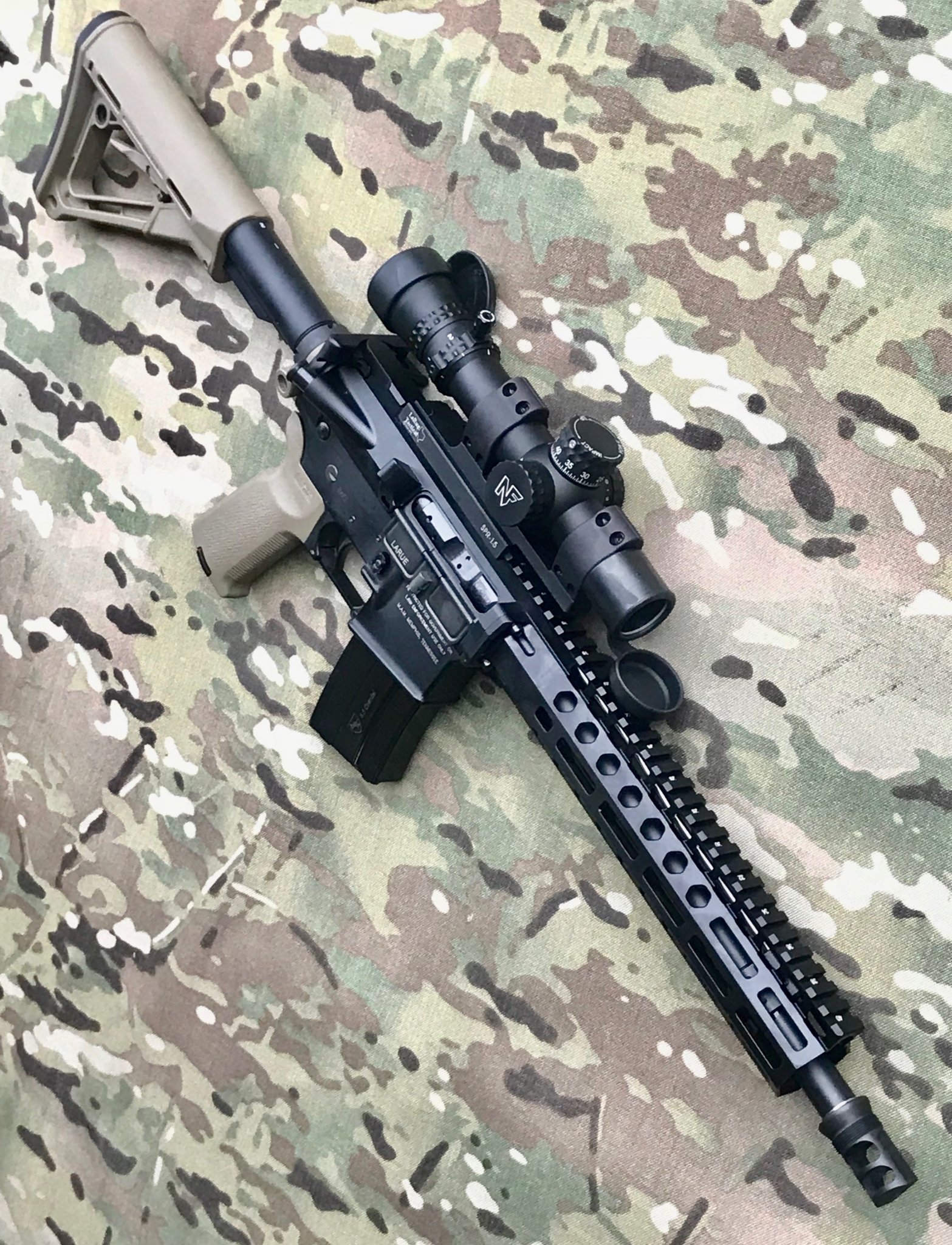

Here is my 6.5 Grendel pistol. It's currently rocking an EXPS3 instead of the UH-1. I absolutely love it. Had 2 jams in one box of Wolf, but after that she's ran 100% for the next few hundred rounds.
Also, I put my 4-14 NF F1 on it and was getting around 1 MOA with Hornady black and SSTs.
Reactions: long range sponge
I love it, it's become my go-to for damn near everything. Using 129 ABLRs even gives it damn good reach on deer too. It came out this past elk season, but unfortunately didn't get to take a shot with it. It's culled quite a few 300-400yd coyotes, and racks in a few more most every weekend.
Kinda priceless watching people's faces at the range when I take a short rifle and start ringing steel at 800+ too
