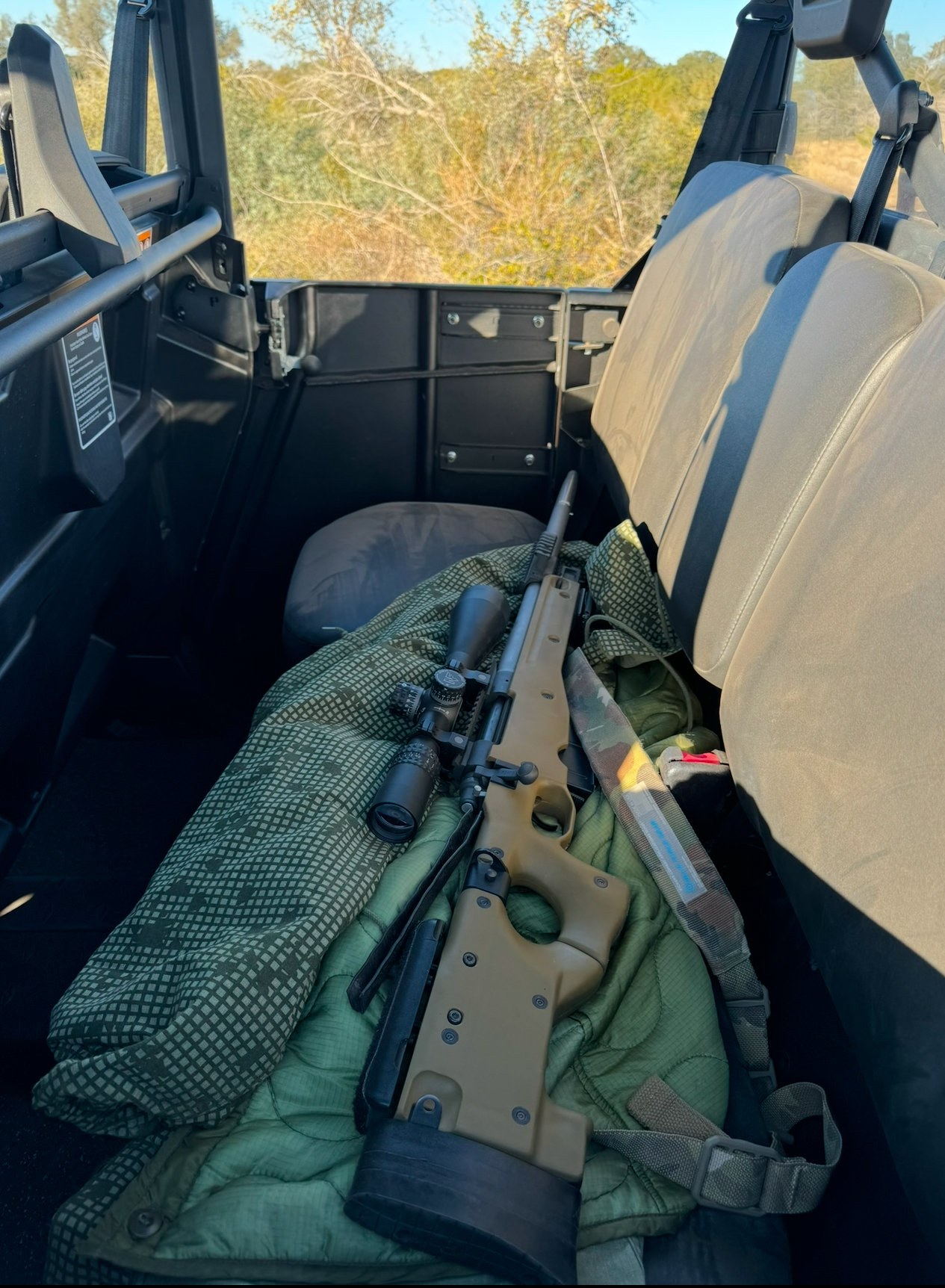

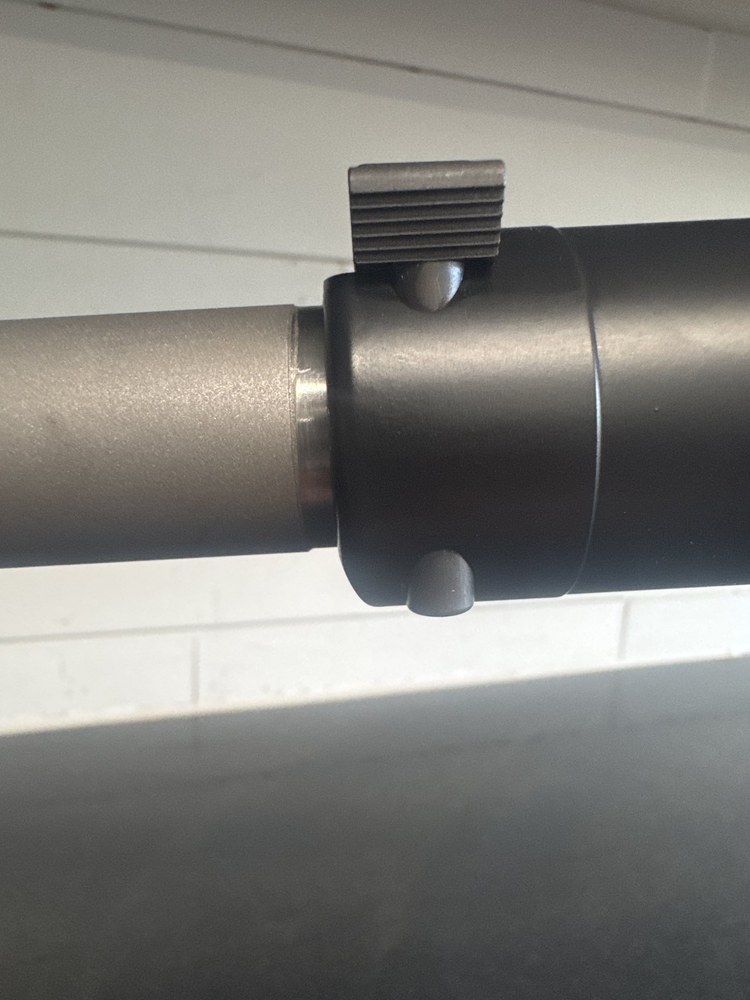

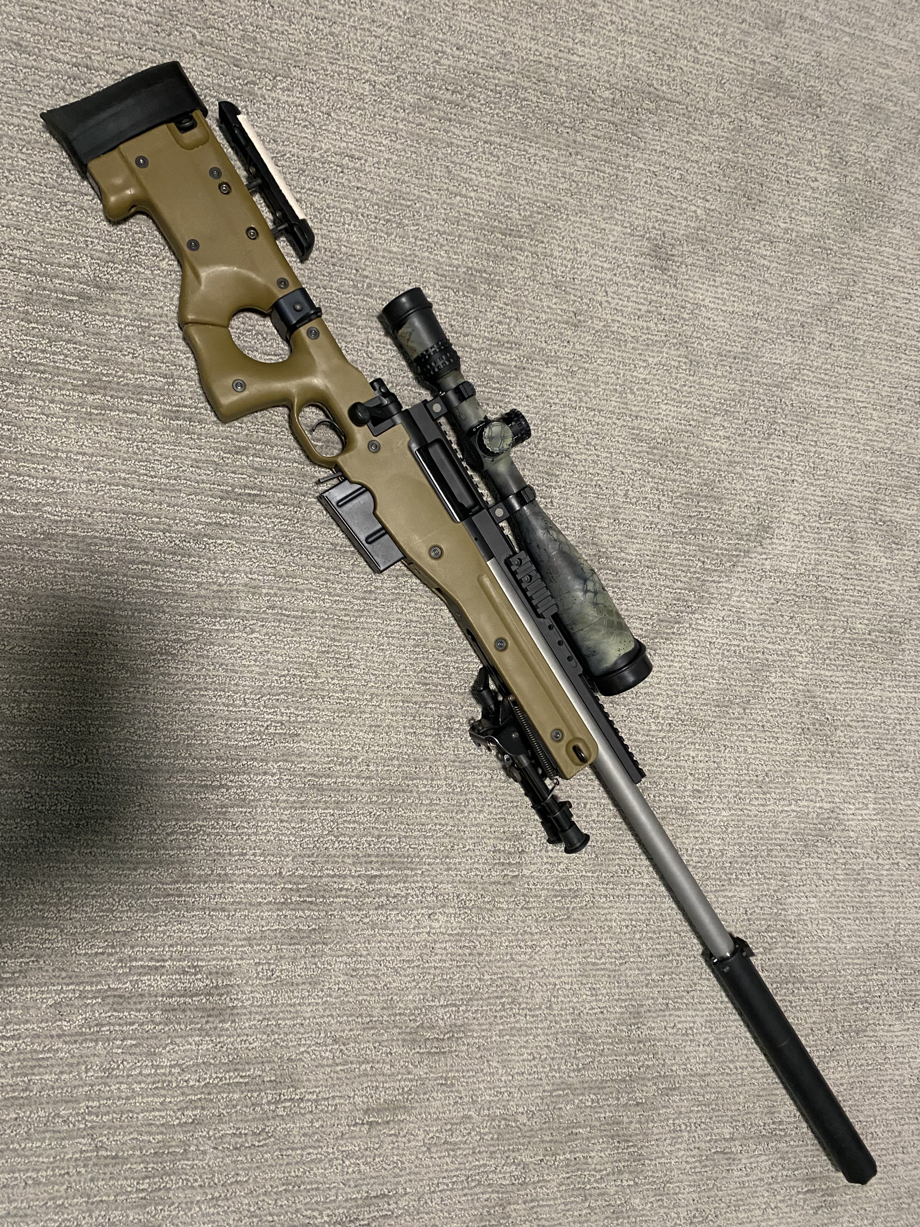

Griffin makes a great product, I have zero concerns it’ll be up to par.

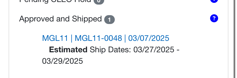

I received my approval about 2 weeks ago and am now waiting for capital armory to ship it to my house. Very exited. From time of purchase to receiving should be right at 1 month. Easy time compared to years prior. I'll post a follow up.
Mine just got approved this morning. This was my first time using this process, I will most likely never choose to do this again. For me, there is too many inconvenient steps that had to be taken to make it work, and now I still have to wait for it to ship and coordinate being home when it arrives to sign for it. I’d much rather have it shipped to a local FFL to start with and submit through silencershop. Did this that exact process two weeks ago with a can from thoroughbred armament and had it approved and in my hands within 9 days.

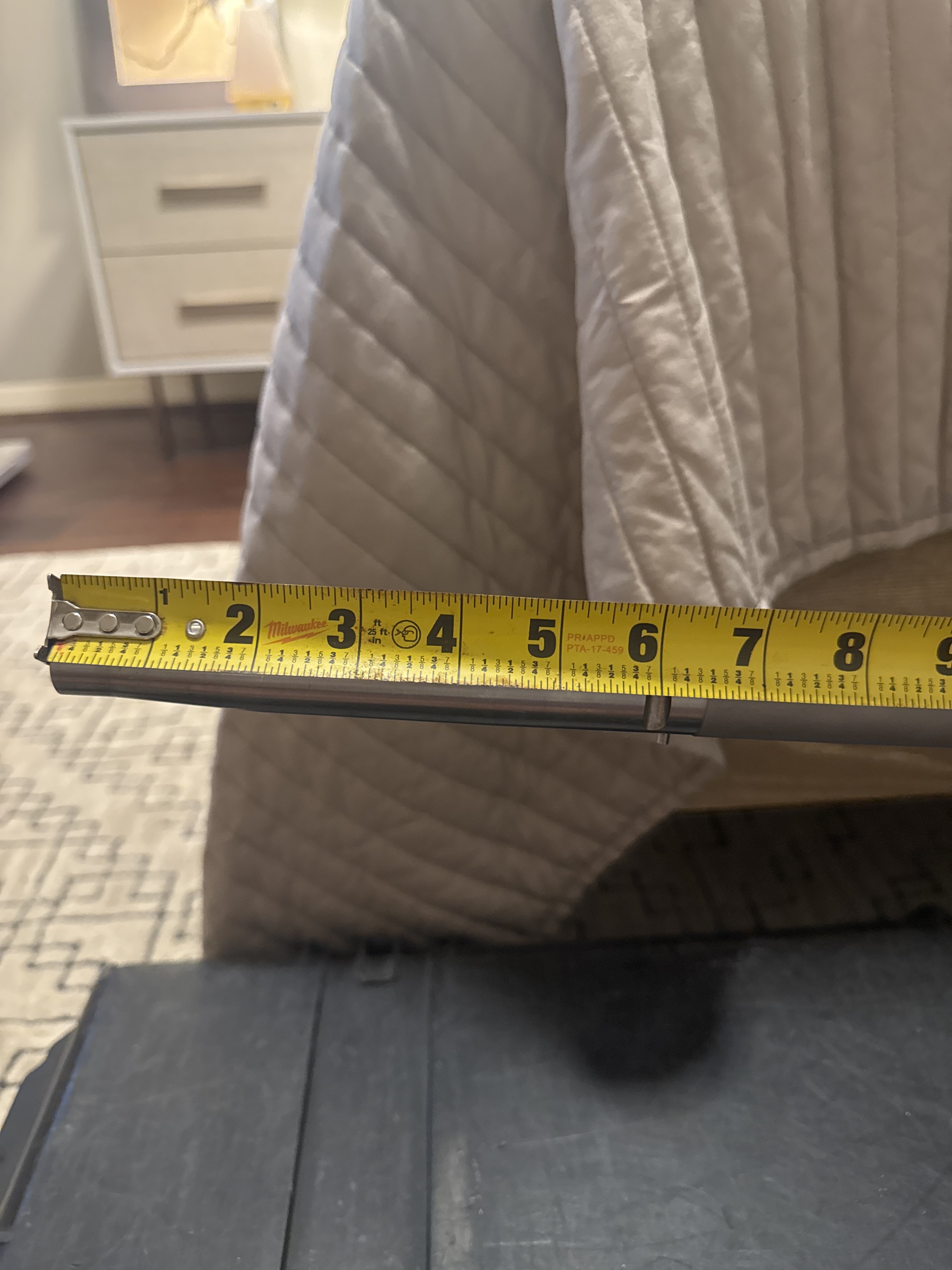

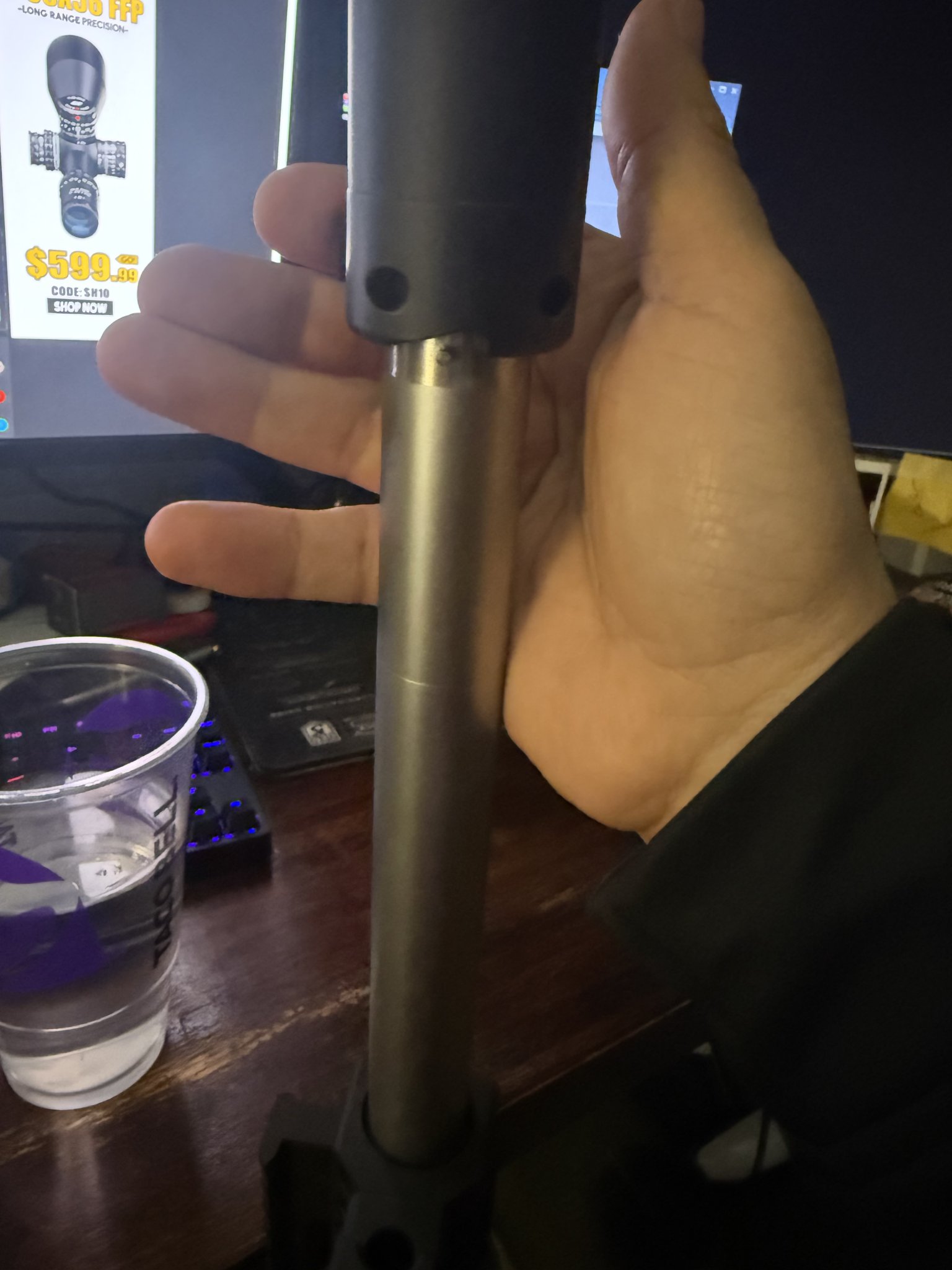

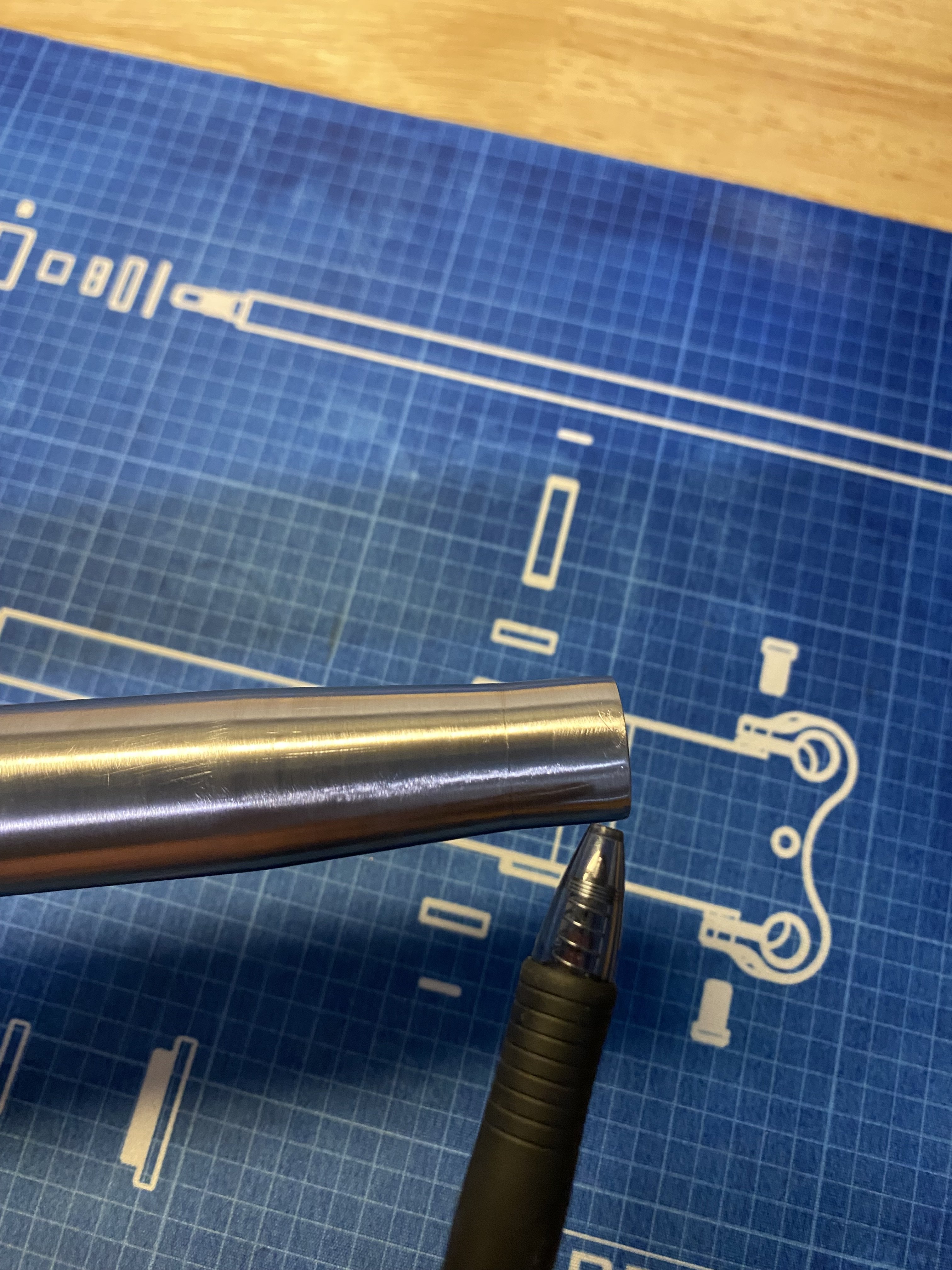

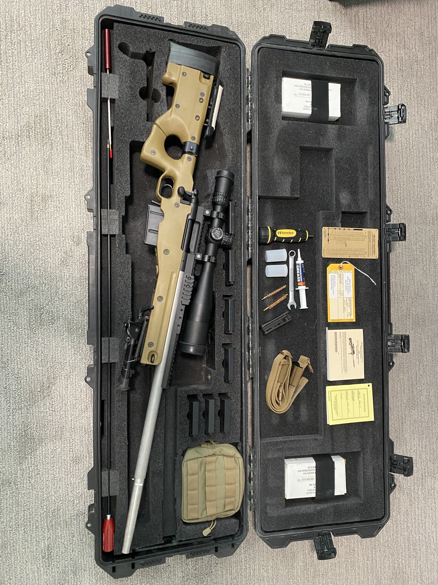

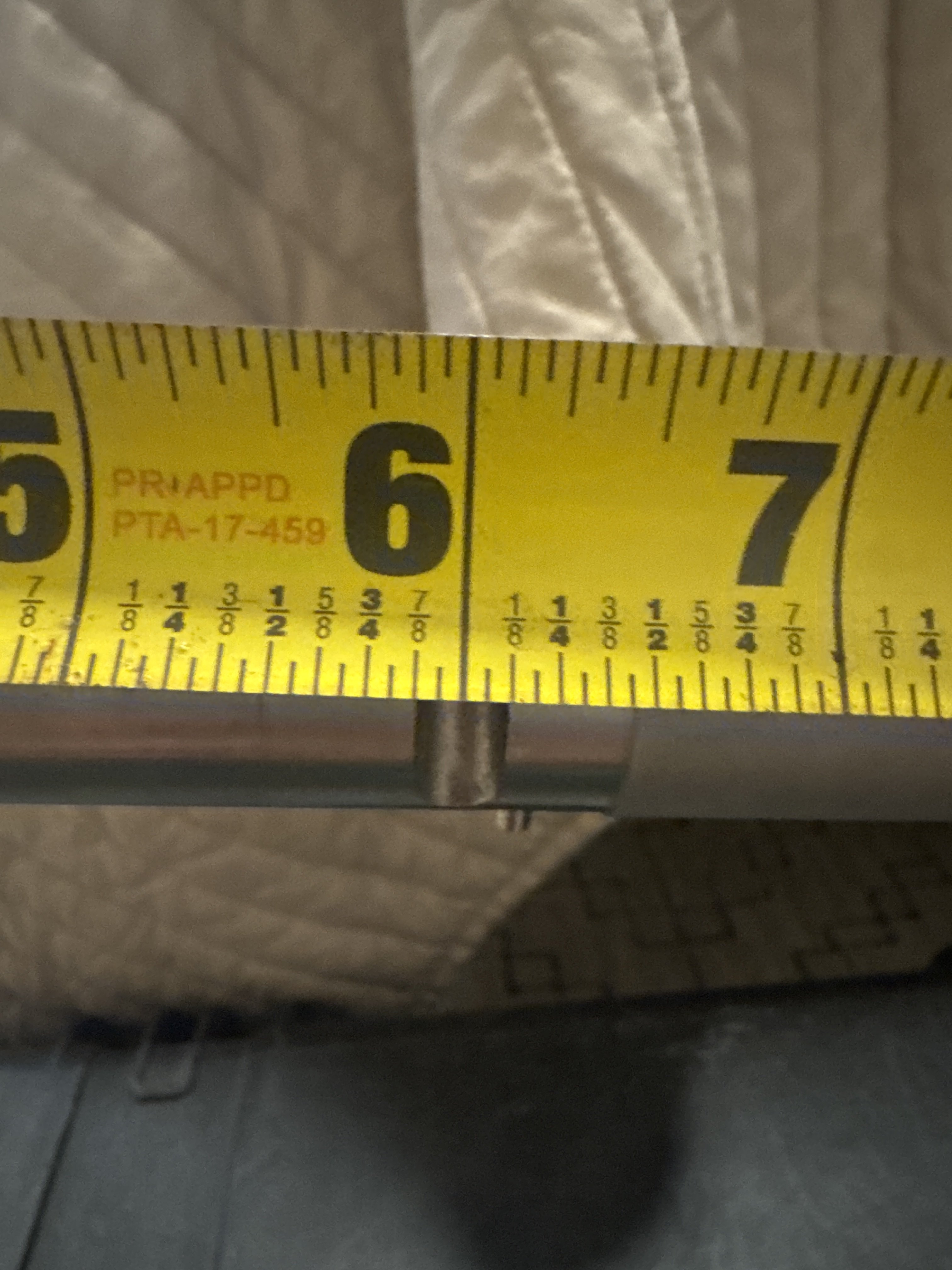

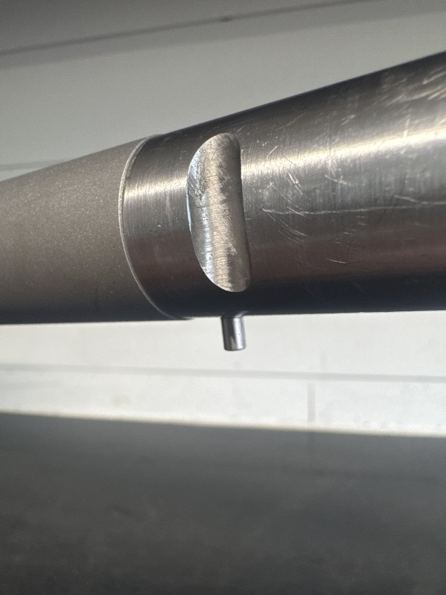

I'm betting your barrel diameter is just a tad too thick. Mine has a visual step where the taper starts. I wonder if you could hit your barrel with some fine grit to get it in place...if not, back to the smith...
That's what it looks like to me. I just really don't want to ship it out, this barrel will be killed within the next year or so anyways so I'll see if I could get a local guy to resolve my issue.

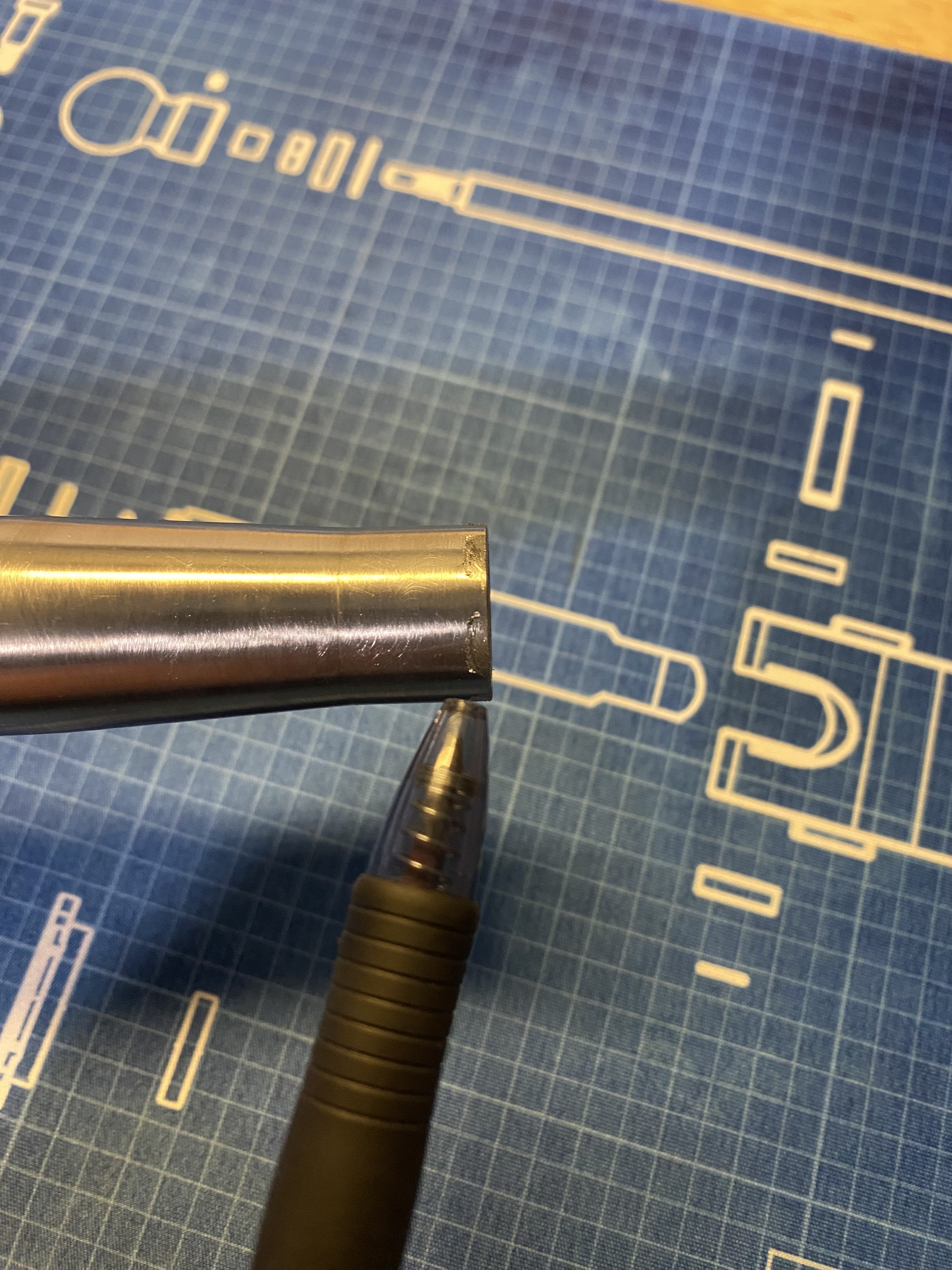

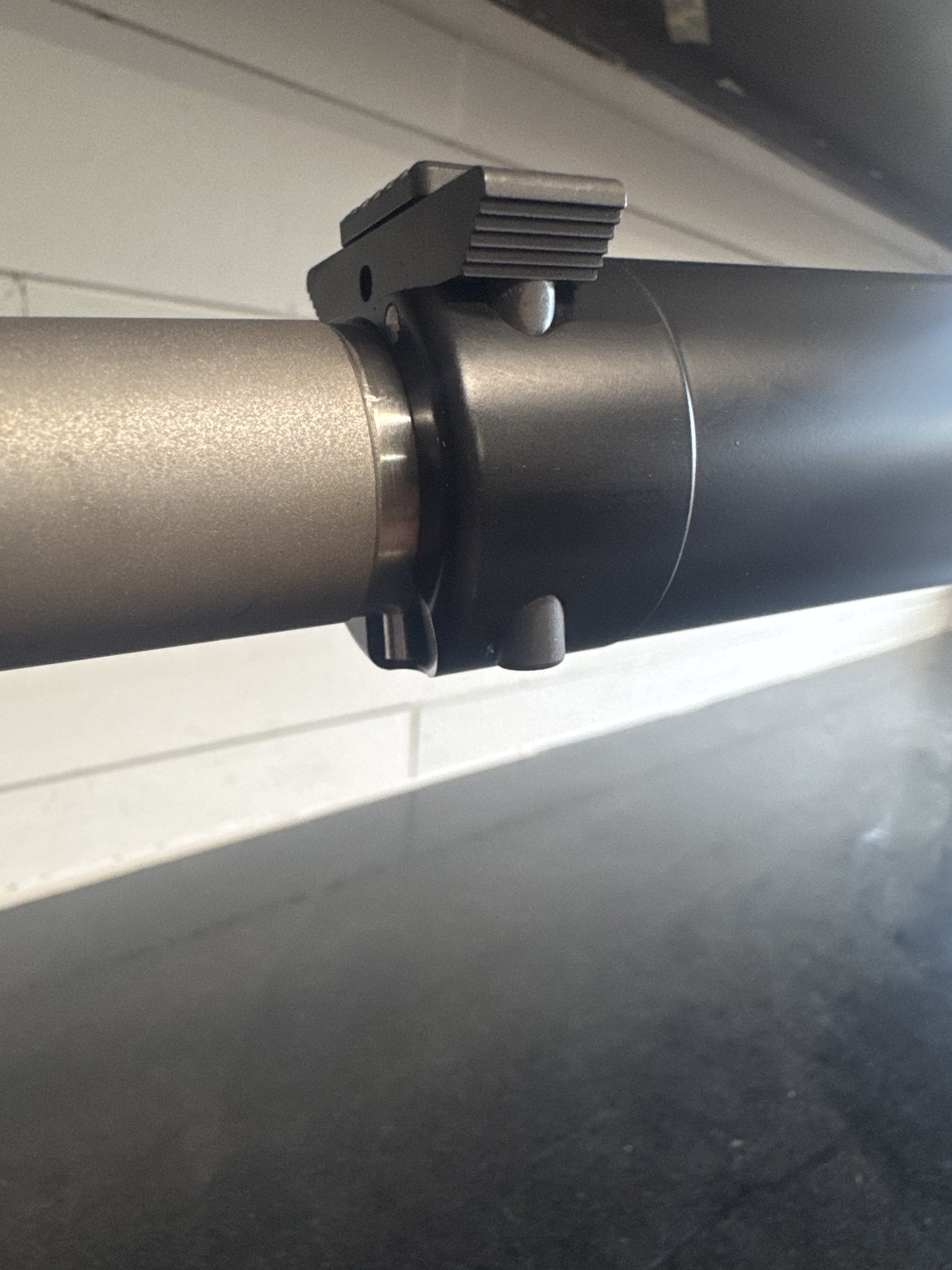

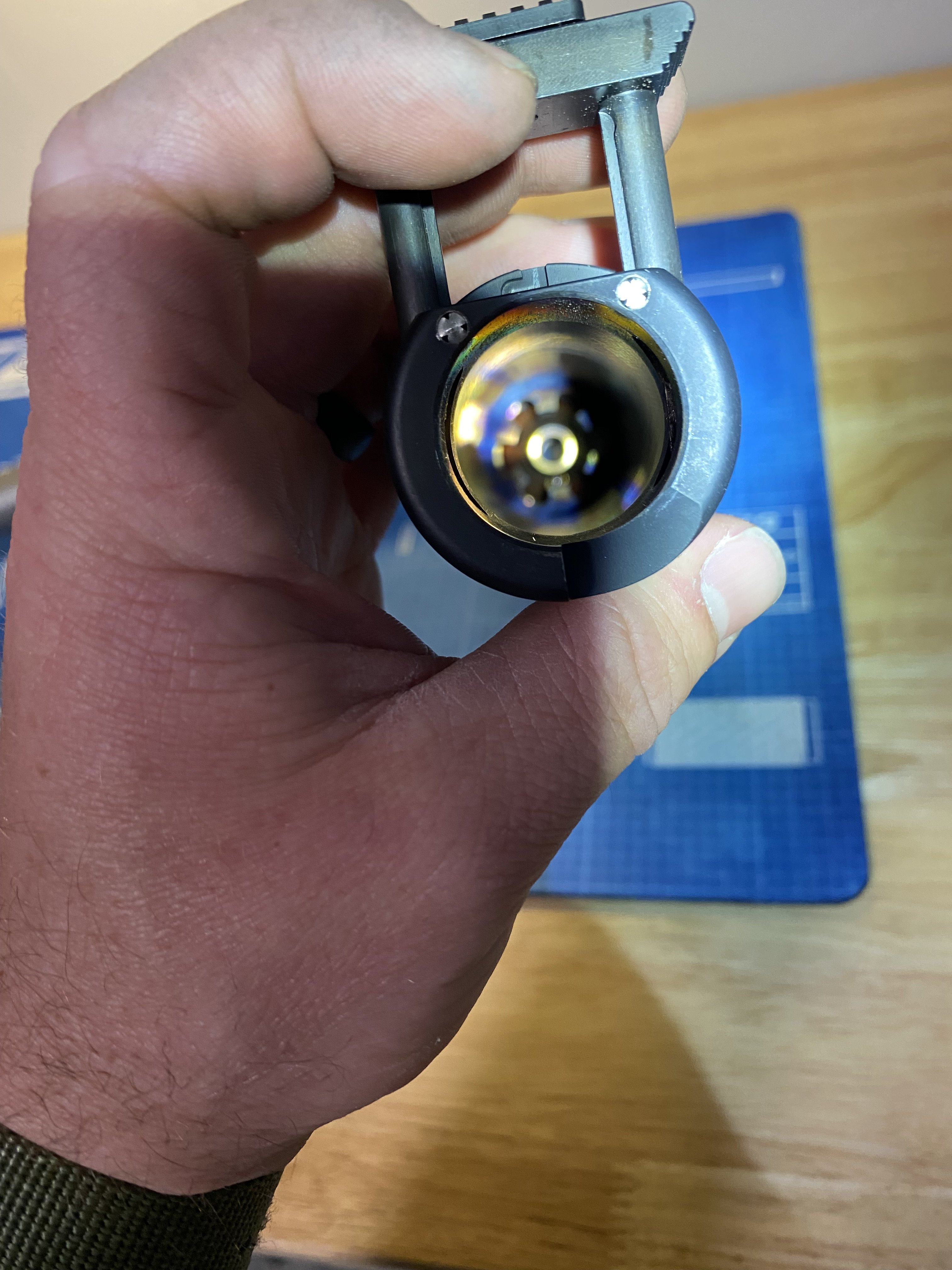

Alright dudes, update here. After more messing around with it this morning I found the issue. In the first photo you’ll see some marks near the crown. There’s an index point inside the can, looks like a gear wheel, which the muzzle slides through. I noticed it was binding up at this point. Using several high grit sandpapers and some patience I made passes around the muzzle until the can fit snug. Perfect fit now, no issues with it going on or off. Not sure if this is an actual issue on the builders end or GA, or if this is a common occurrence with even the original MK11 cans requiring a little more attention to fitting at times. Could be why builders occasionally want you to supply a MK11 when having the barrel done.
*Don’t do this if you don’t feel comfortable with it*
