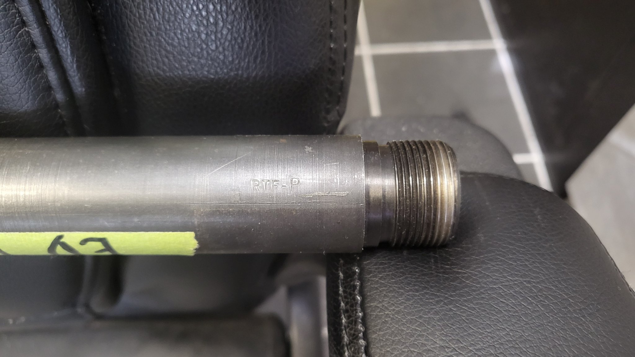

I was given an original A1 barrel by Mr. Land. It was a used take off. If I recall correctly the muzzle is around .900". I'll double check tonight when I get home.
So that's the first question is the muzzle diameter. What would you guys want? .875" or .900".

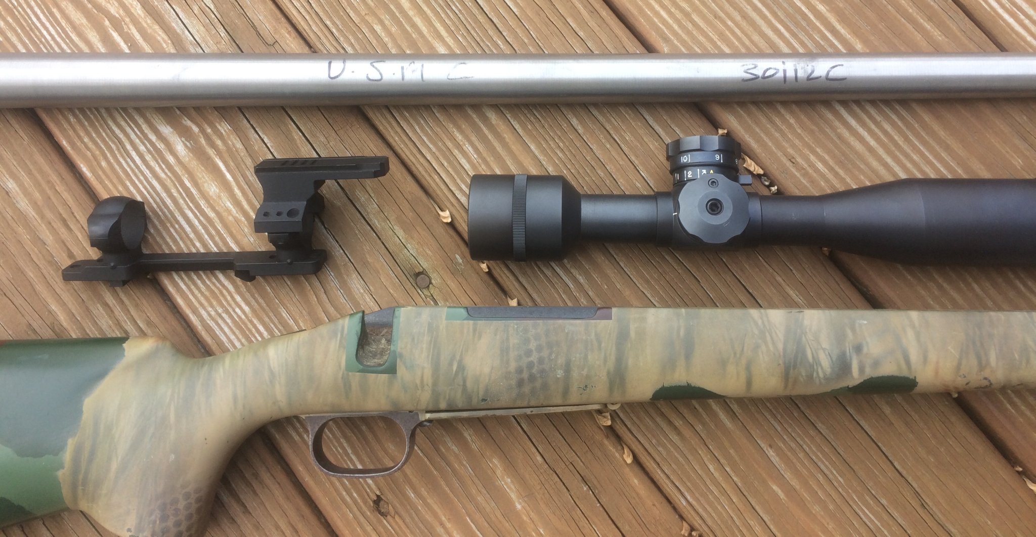

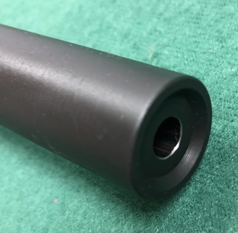

FWIW, this replica was built ‘on-location’ using one of extra USMC barrel blanks that Gary Schneider would sell from time to time. (Back then the “Hobby Lobby” program was tolerated for 2112s seeking to maintain their skills, but it went away thereafter). I got the barrel maybe in 2017 or so, and Gary told me whenever he got an order from the USMC for M40(A5) barrels, he would make 5 or 6 extra barrel blanks for guys like me, who wanted to build a replica rifle. Mine came marked as seen here:

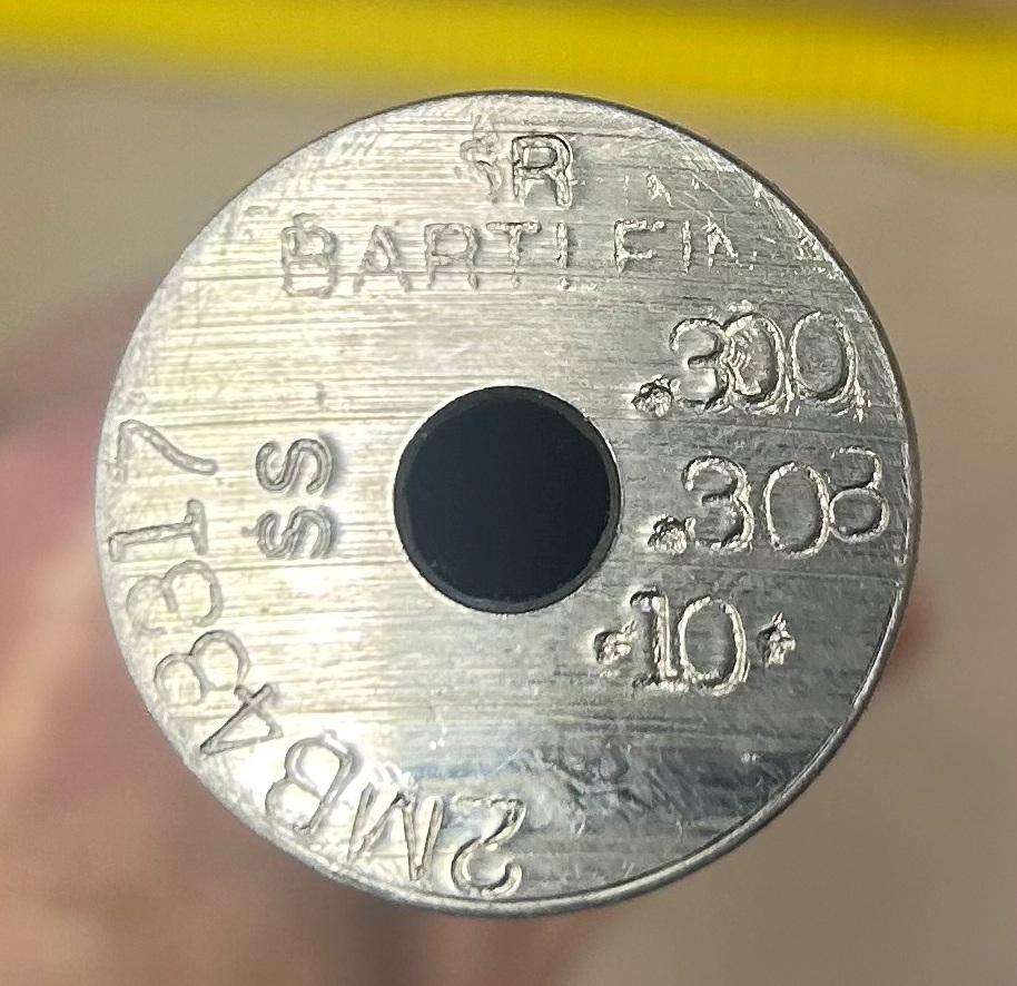

(Shameless plug, just got my replica M40 back a few days ago, it also has a Bartlein 1/10 twist, 5R rifling - but in the M40 profile)
No target crown, and diameter at muzzle is 0.837", like the originals. Just need to do a range trip to break-it in...

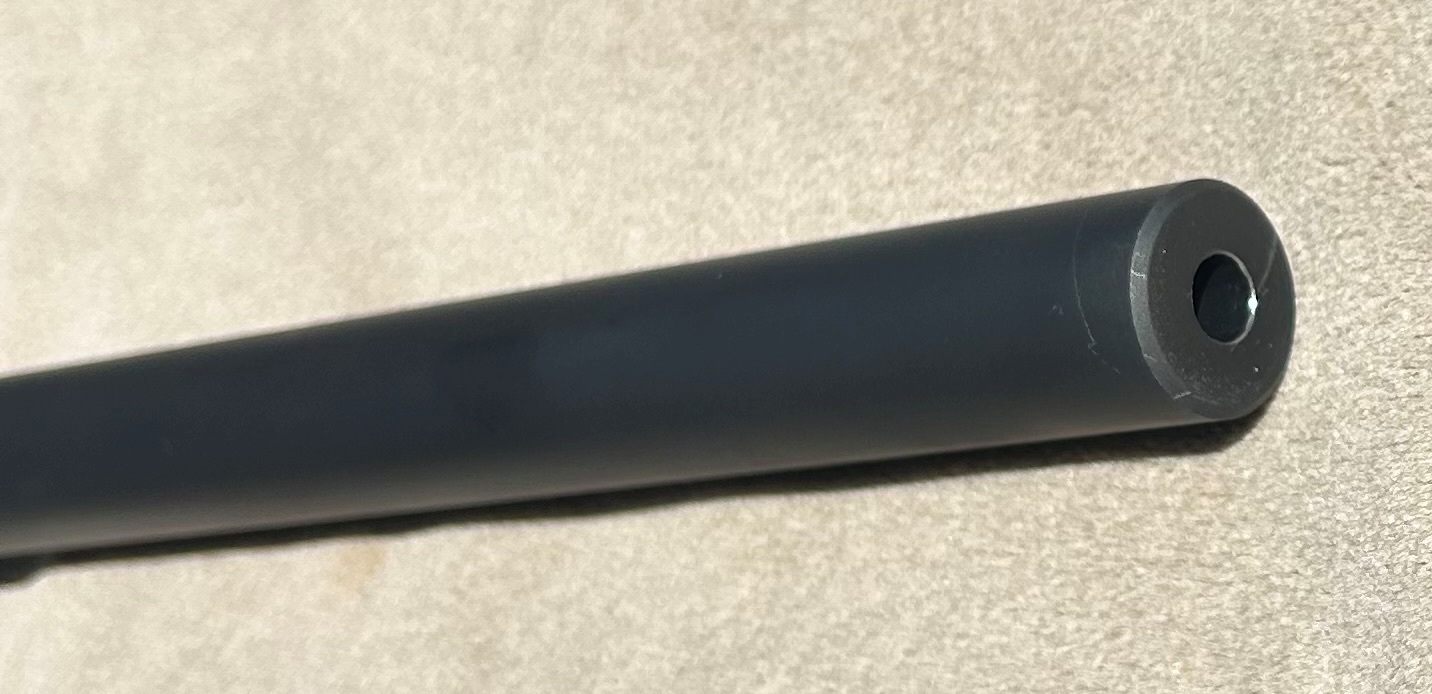

I'll post some nice pic's. I'm cleaning the tape off of the take off Land barrel I've got and when we get one turned up.... I'll post some pic's side by side.
When ready for the group buy... I'll make a post here and tell everyone to email me they're info. I'm going to give it one more week and then I'll take a count and close it out for orders.
I went back this morning and remeasured the take off barrel I got from Land.
The breech diameter is 1.170"... the muzzle is at .928".
So will stick with 1.200" x 4" and straight taper to .900" @ 25" finish / 27" blanks.
Lance out in the shop is playing with the finish on turning the barrels and once we have that figured out... I'll post side by side pic's next to the original I have.
