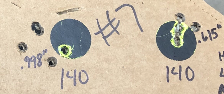

Example #1:
When I first got my 6CM, I did not have my dies yet, so bought 200 rounds of Hornady factory, match-grade ammo to break in the barrel and have a little fun. I was not overly impressed with the results. I was getting somewhere in the neighborhood of 3/4 MOA with 5-shot groups.
When I got my dies, I used the spent Hornady brass and was shooting 2" groups at 300 yards. Decent, but still short of where I wanted to be.
Finally, Lapua got into the 6CM game, and I bought a bunch of their brass. On my first trip to the nearby 100 yard range to get some once-fired brass, I fired the first shot, then the second. Where did it go? I had to look through the spotting scope to see that it went in the same hole. The rest of the shots were within .4 inches - and the rifle consistently shot in that neighborhood there on out.
Example #2:
First shots, post barrel break-in, out of my 300 PRC were using Hornady and I got 5-shot groups again in the 3/4 MOA range. My goal was to use this rifle for mile+ shooting. Without going into the gory details about my brass saga, I got better brass, found the load, and now shoot best groups roughly in the 1/3 range.
Example #3:
A friend was having issues with his newly rebarreled 338. He had his seating depth way out and was getting 3" groups at 300 yards. Brought the seating depth in, and his ES/SD dropped, along with his group size (roughly averages just over 1" now)
I'd love for someone who thinks that the "argument of higher accuracy and precision falls a bit flat these days" to explain what the reason could possibly be for these improving results using their logic and view of the reloading world.
This notion that you can consistently get the same results from factory ammo as you do from a post-load-development round is simply not supported by the data. CAN you get similar results? Sure, if all the stars align and it just so happens that your rifle is a good match for a particular factory ammo. WILL you always get similar results? No.

Example #1:
you changed components...thats been covered since the beginning of the the thread
Example #2:
again...component change
Example #3:
new barrel fresh off the lathe/cleaned...the only difference in the above pics is the first group started around 30-35 rounds on the barrel...the middle 2 were 50-60...the last 2 were back to back 5 shot groups when it had 75-80 rounds...its all the same load
it has shot consistently like the last picture since
was that the case in your situation, maybe not...could have been similar...have you gone back and shot the "bad" loads again since changing it?
i dont think anyone is saying this, least not from what im reading

But that's not my point. In some cases, first shots were factory, subsequent reloads using same components, but reloaded. My point in posting is in response to this notion that "the argument of higher accuracy and precision falls a bit flat these days."
I had already broken in the barrel in both cases. In my friend's case, the seating depth was well past barrel break in, as he had already done powder charge load development.
Perhaps I am completely taking the statement: "the argument of higher accuracy and precision falls a bit flat these days" completely out of context.
you didnt actually use the same components...lot to lot along can change things...you dont have access to the same powder hornady/federal/who ever uses...unless youre an ammo manufacturer, then maybe lol
the main thing im seeing is...im picking whatever charge and jump i want, using similar quality components, as my buddy's (who are no slouch shooters), who are testing charges/jumps,distanct groups/etc......and my results are as good or better than theirs without cherry picking and explaining away shots...thats just what ive seen.....they still swear by their load developments tho...
i generally feel GOOD factory match ammo is "good enough" for most...but its not consistently as good as hand loads where everything can be controlled better....if you arent already in consistently in the top 10-20% with good factory ammo...reloads probably arent going to help you much
