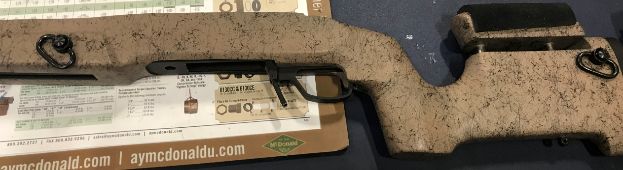

Just got done with my first DIY flush cup install in a Manners. Used the appropriate tap , a little Dremel action and epoxy . Works great for me.

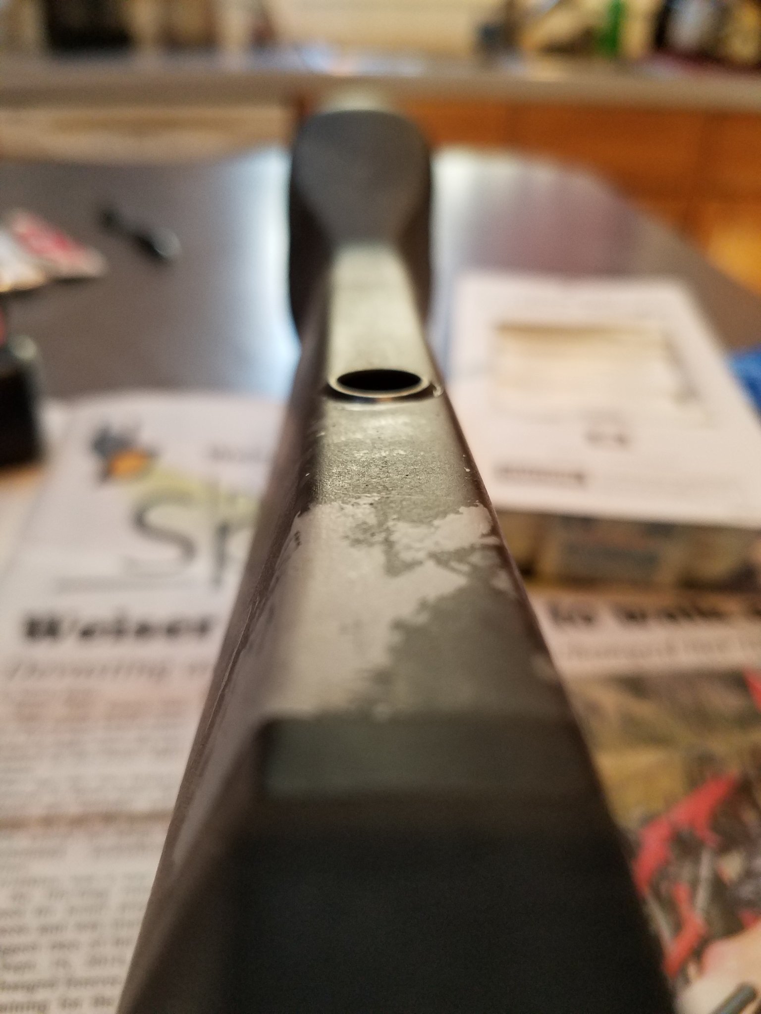

well Napa Autoparts came through in the clutch and I picked up the tap this morning.
here is the finished product. super easy. Just need to epoxy it tonight and then let it set and done.
