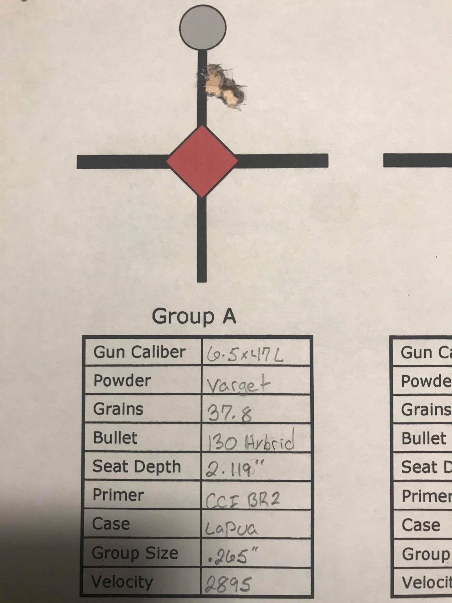

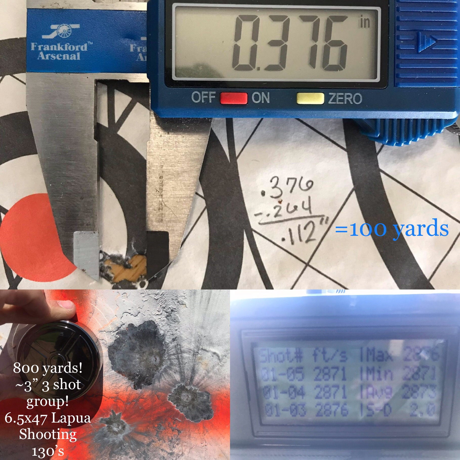

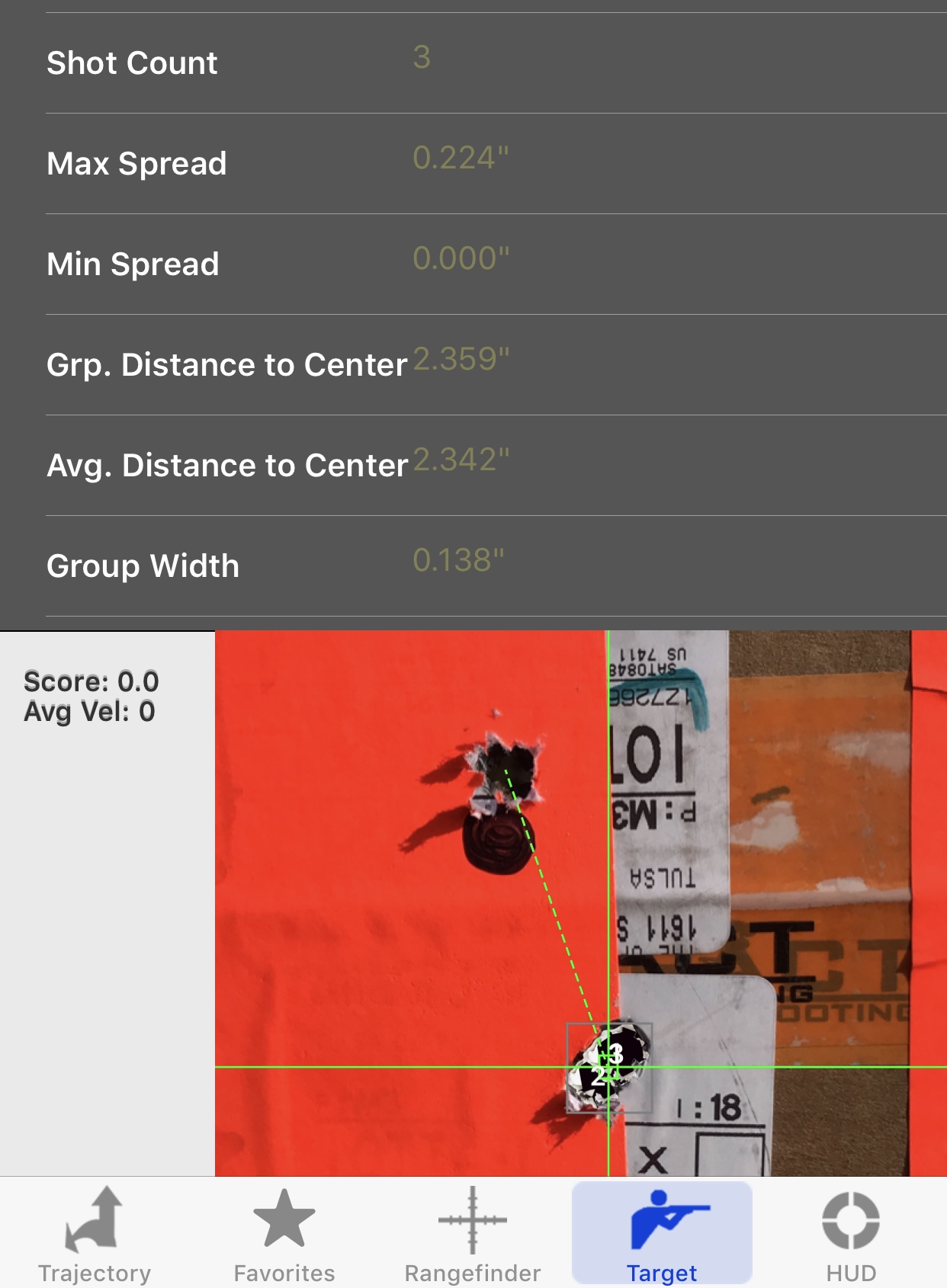

These are all from prefits I’ve done. I’d say they are pretty darn accurate. I don’t worry about timing the barrel to 12 o’clock unless I have the action in hand. It is usually a non issue. I do more prefits than anything else and have had great results. On certain receiver you can time the barrels, not all of them have the tolerances to do so.
You 100% do not need the actions in hand to get great results from a barrel on most custom actions.
