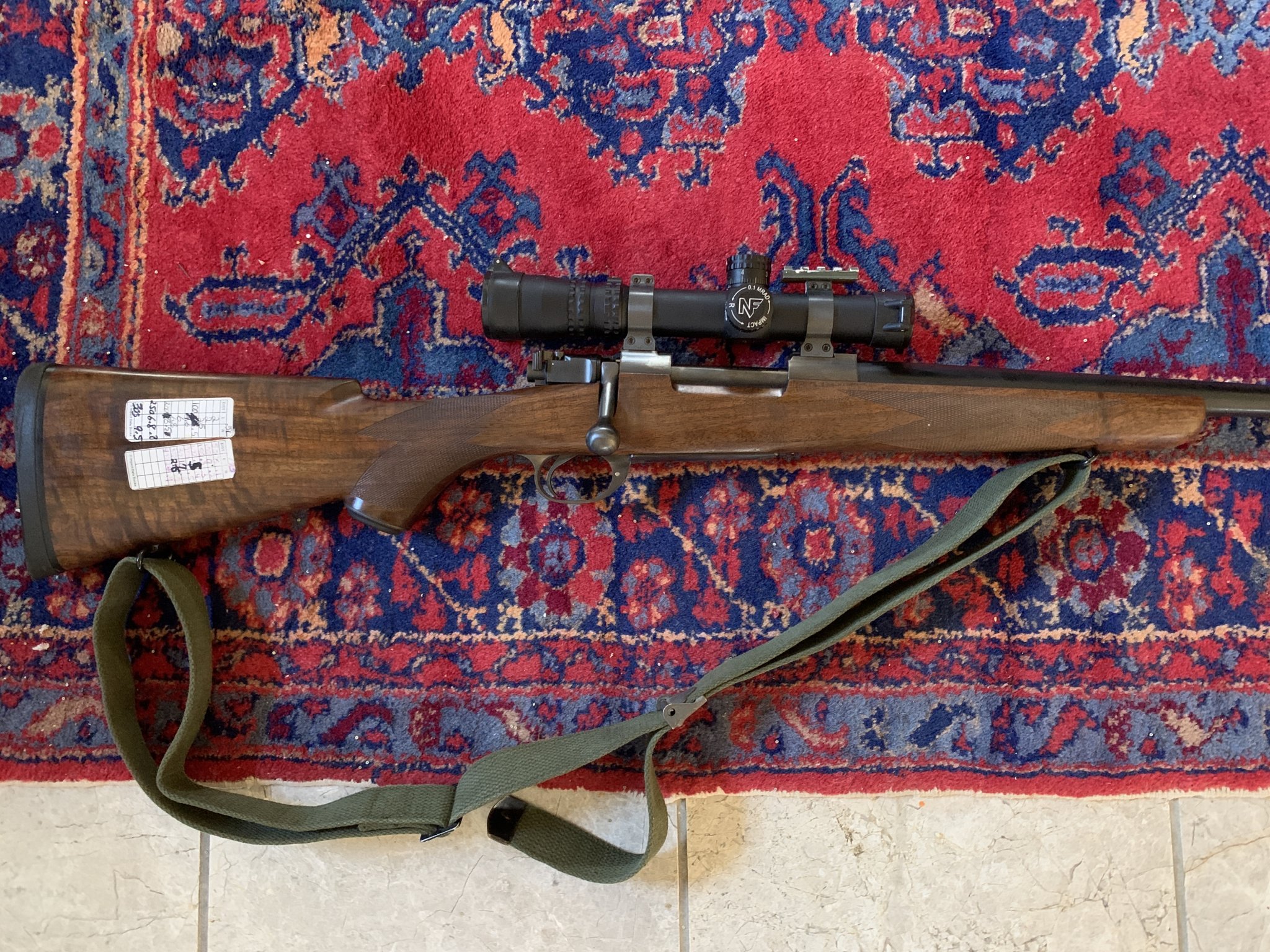

This is the Mauser with complete titanium action. All parts are titanium, not just receiver.
it has served well.
Welcome. I think there were about 12 of them made.
The action is very light due to EVERYTHING being titanium. Extractor, bolt, extractor collar, firing pin and even the springs are Ti spring steal. The magazine, follower, its all TI. The rifle shoots very well with this barrel. The first one was a Christenson Arms CF and had issues. I put about 1K rds on it but removed and replaced with this Krieger.

See if LRI has any hunting Mausingfield's left. There was a special edition hunting Mausingfield made through collaboration of LRI and ARC.
LRI might have a couple of them left.
