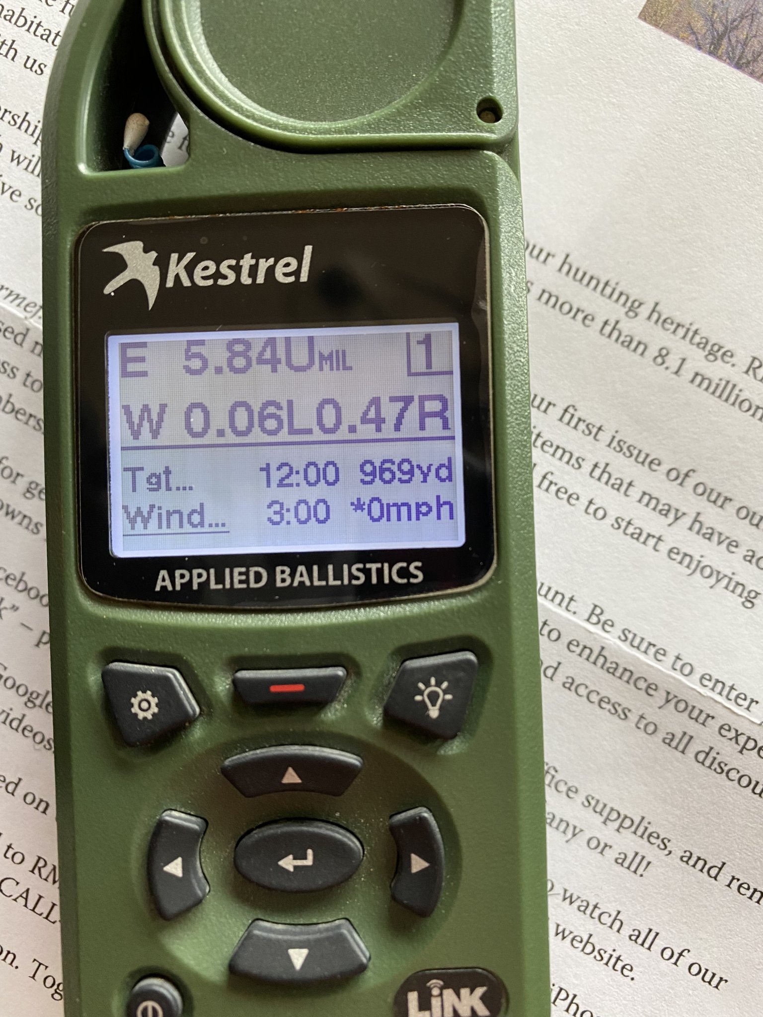

6) I have not tested the ballistic accuracy of there software, but it looks to be great so far on my 300N as compared to my Kestrel 5700AB, which has been trued and spot on. This was done with the BR4 “Base wind” @ 5mph direct crosswind and the kestrel set at 5mph for the second wind setting (pic only catches first wind at Zero. (The front cover is closed or the BR4 in the pic below)
