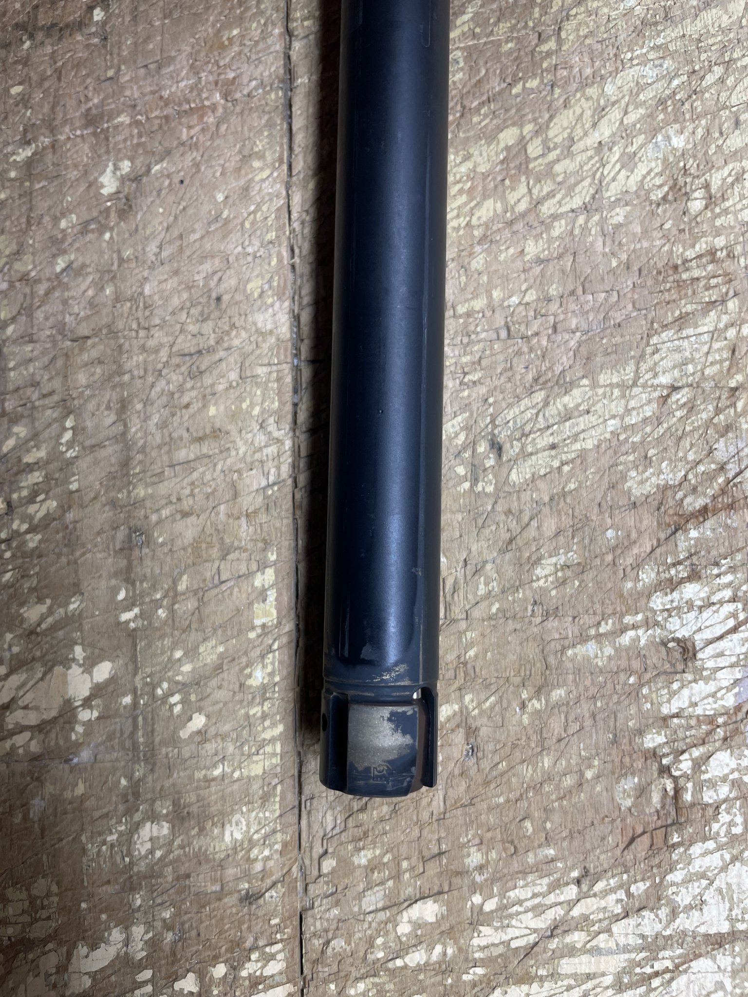

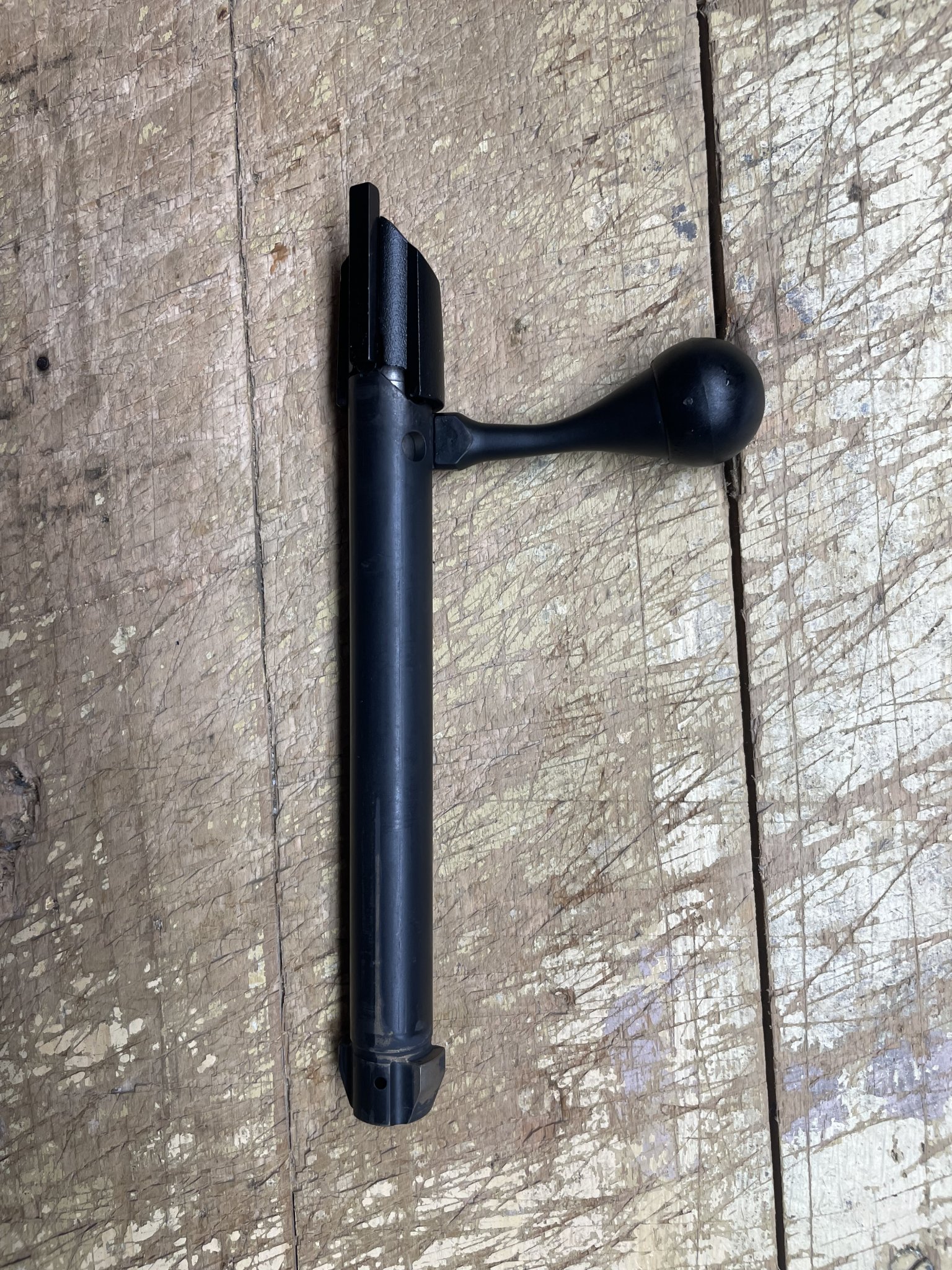

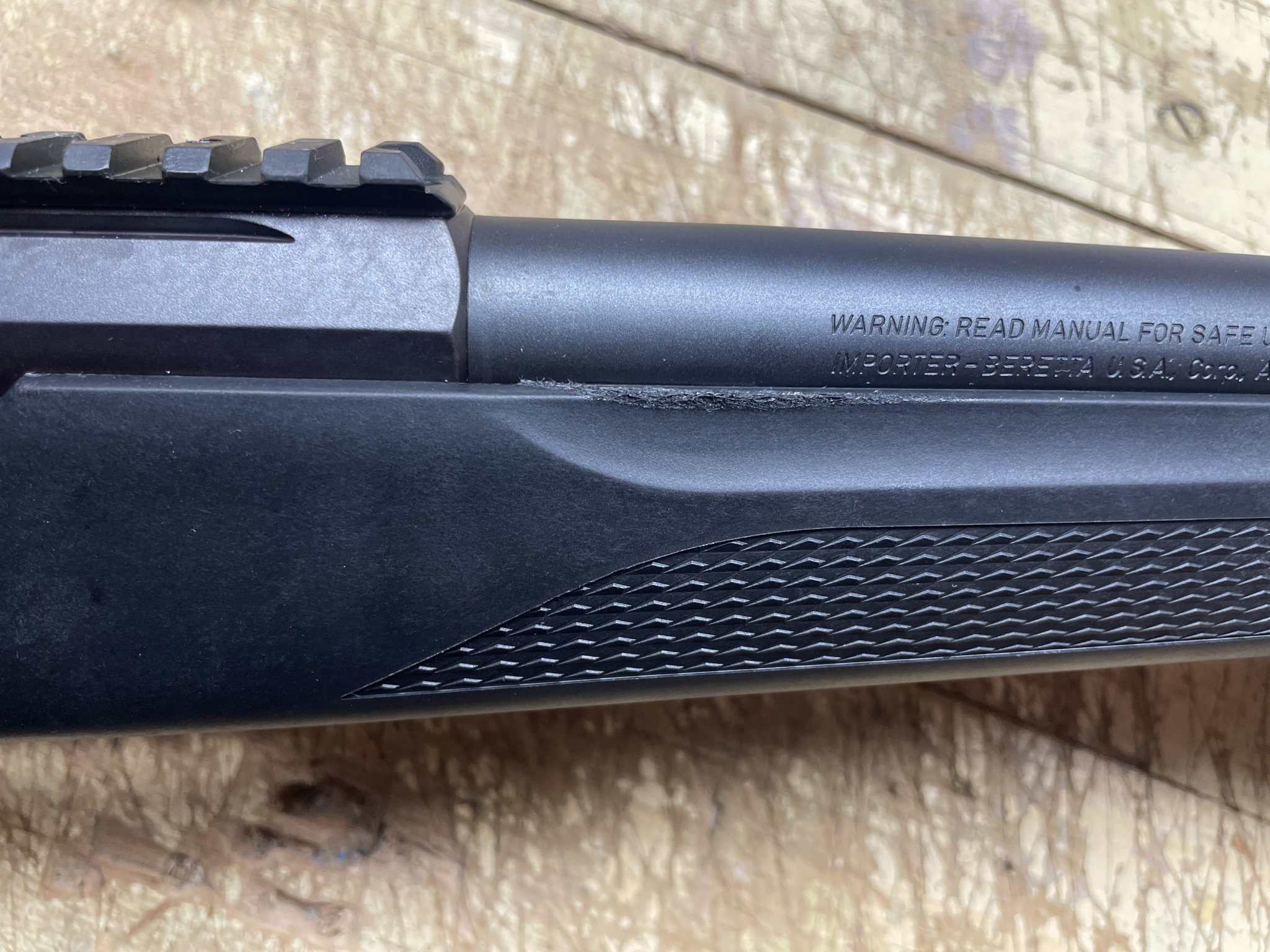

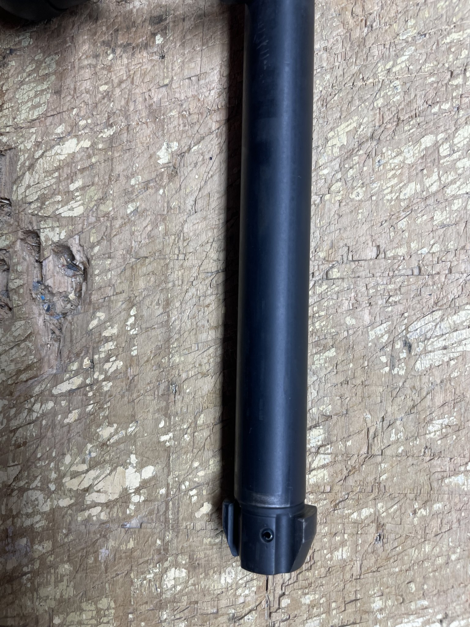

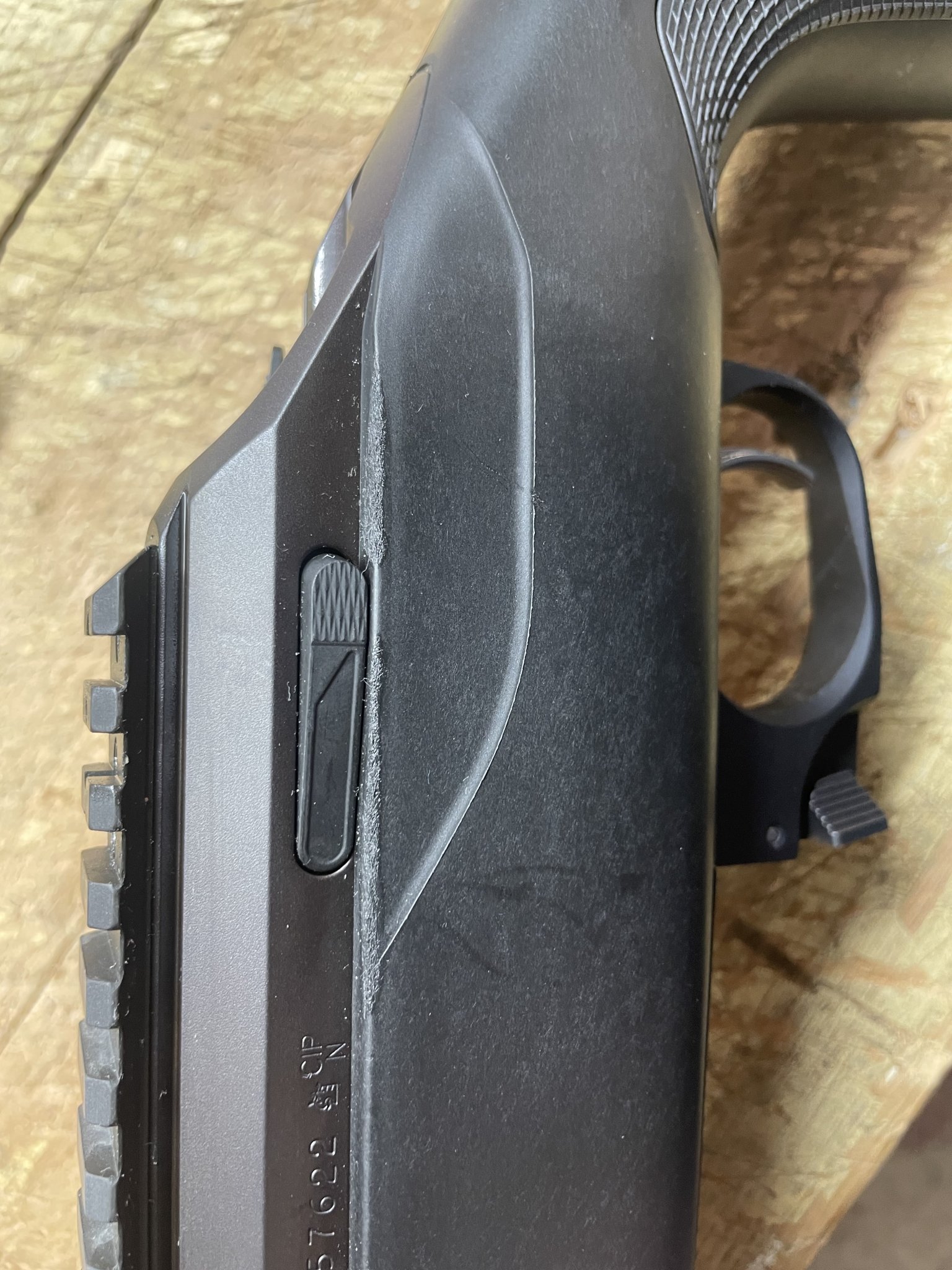

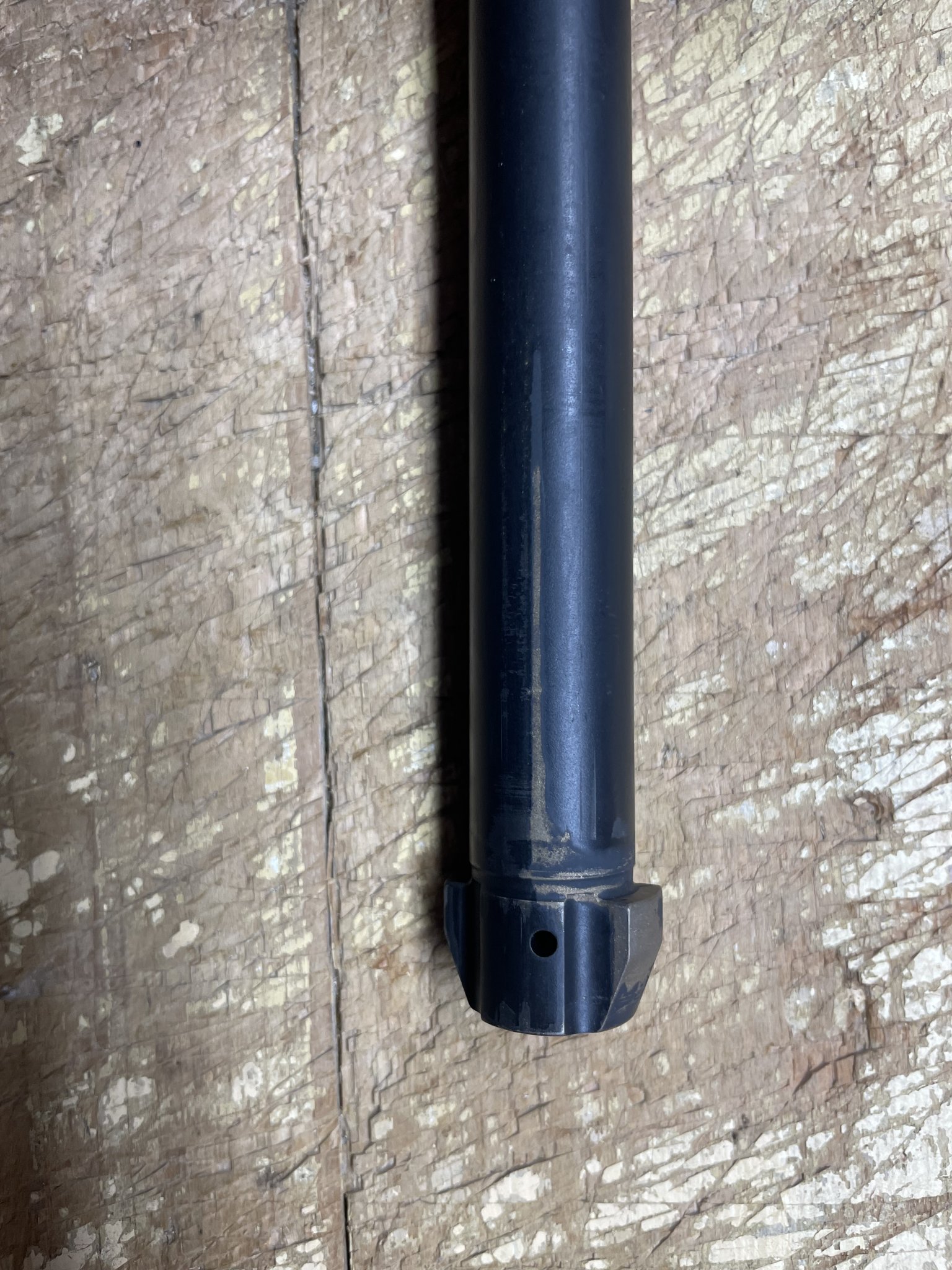

Guys…I messed up…
Reformedcitykid
Mar 23, 2023
180
36
New York

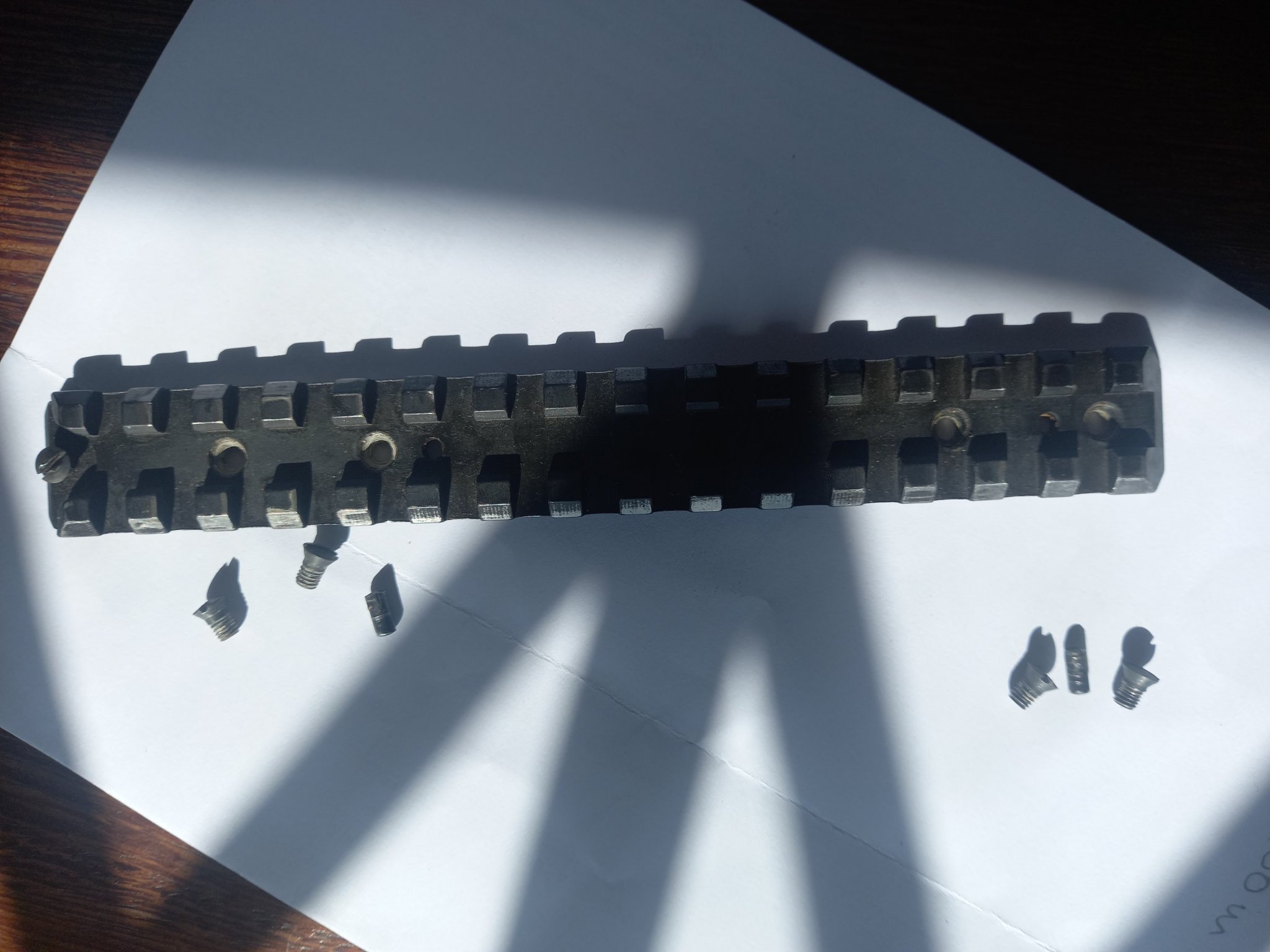

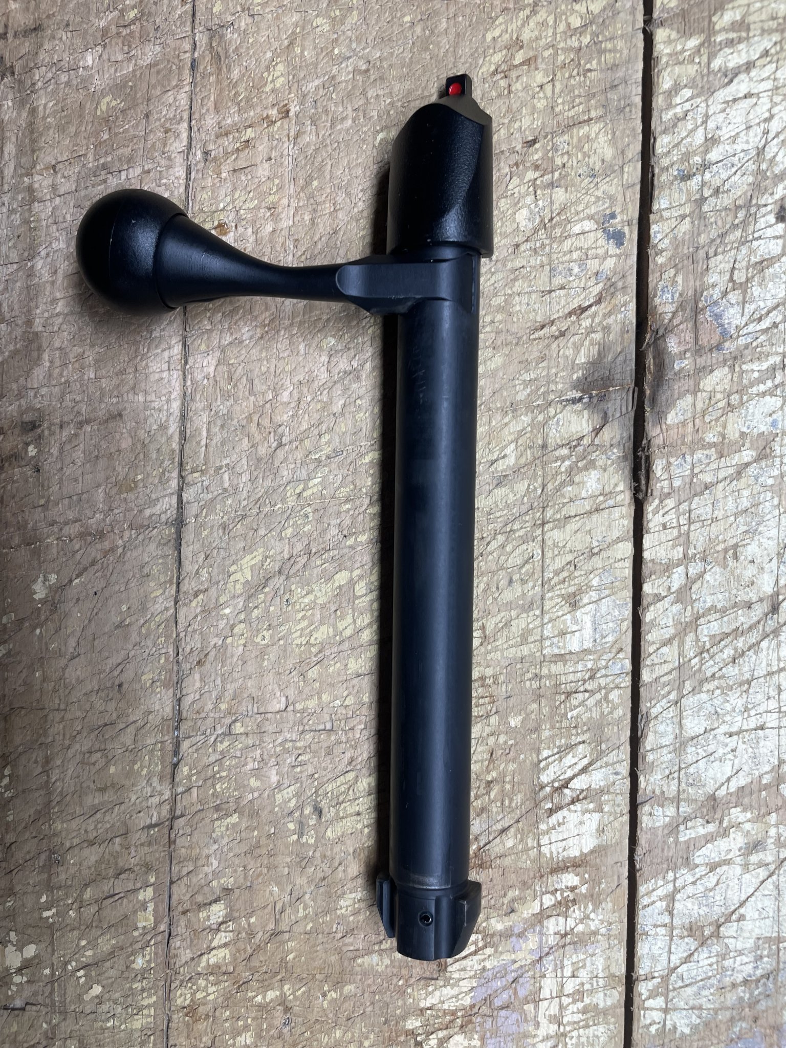

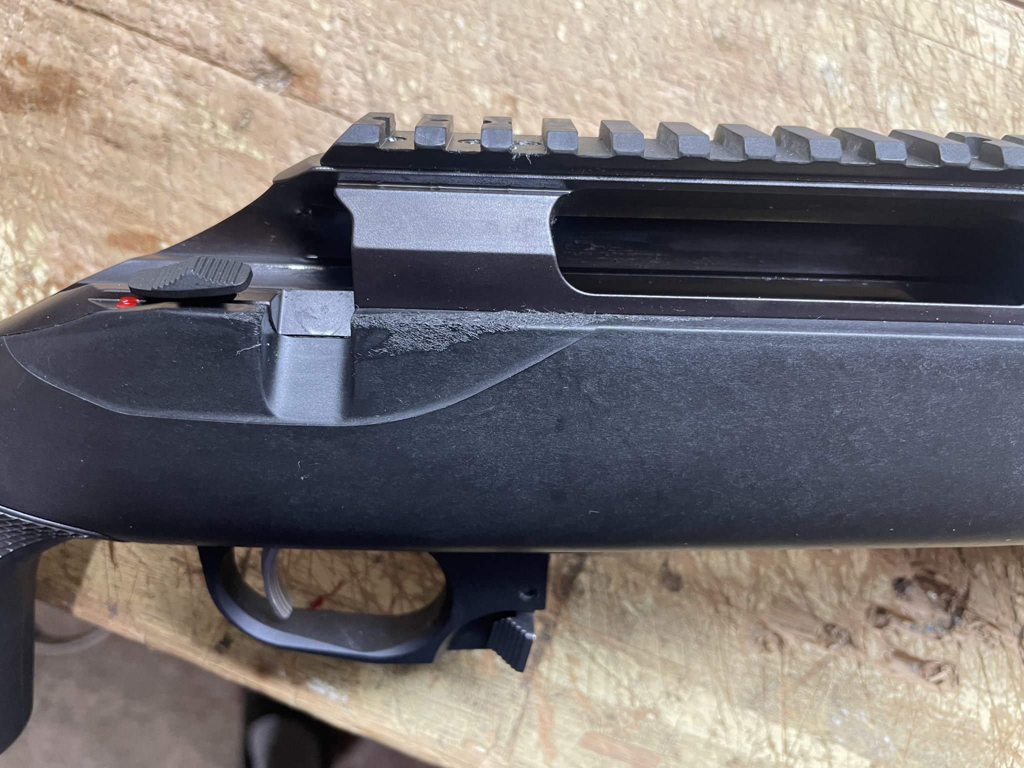

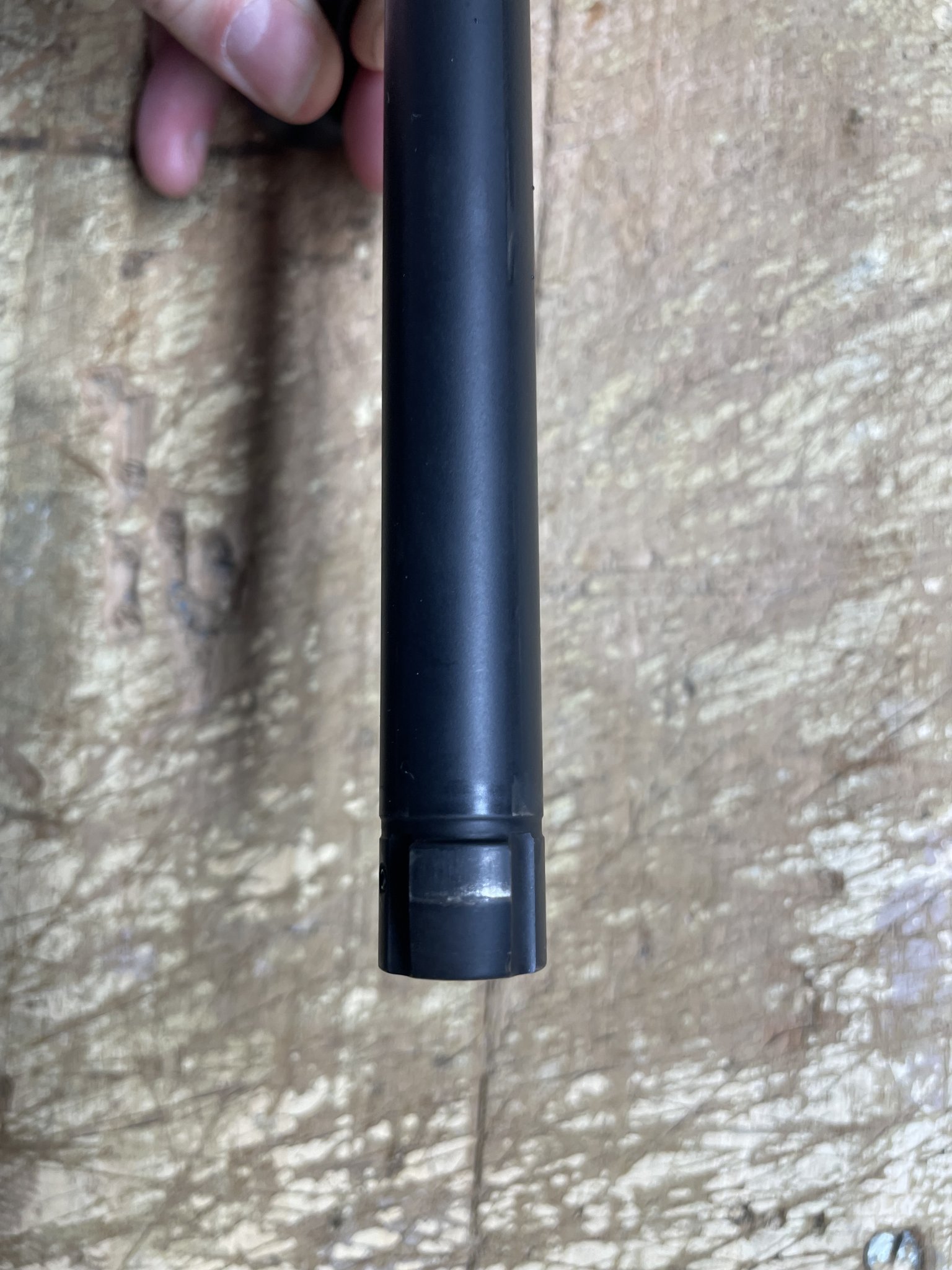

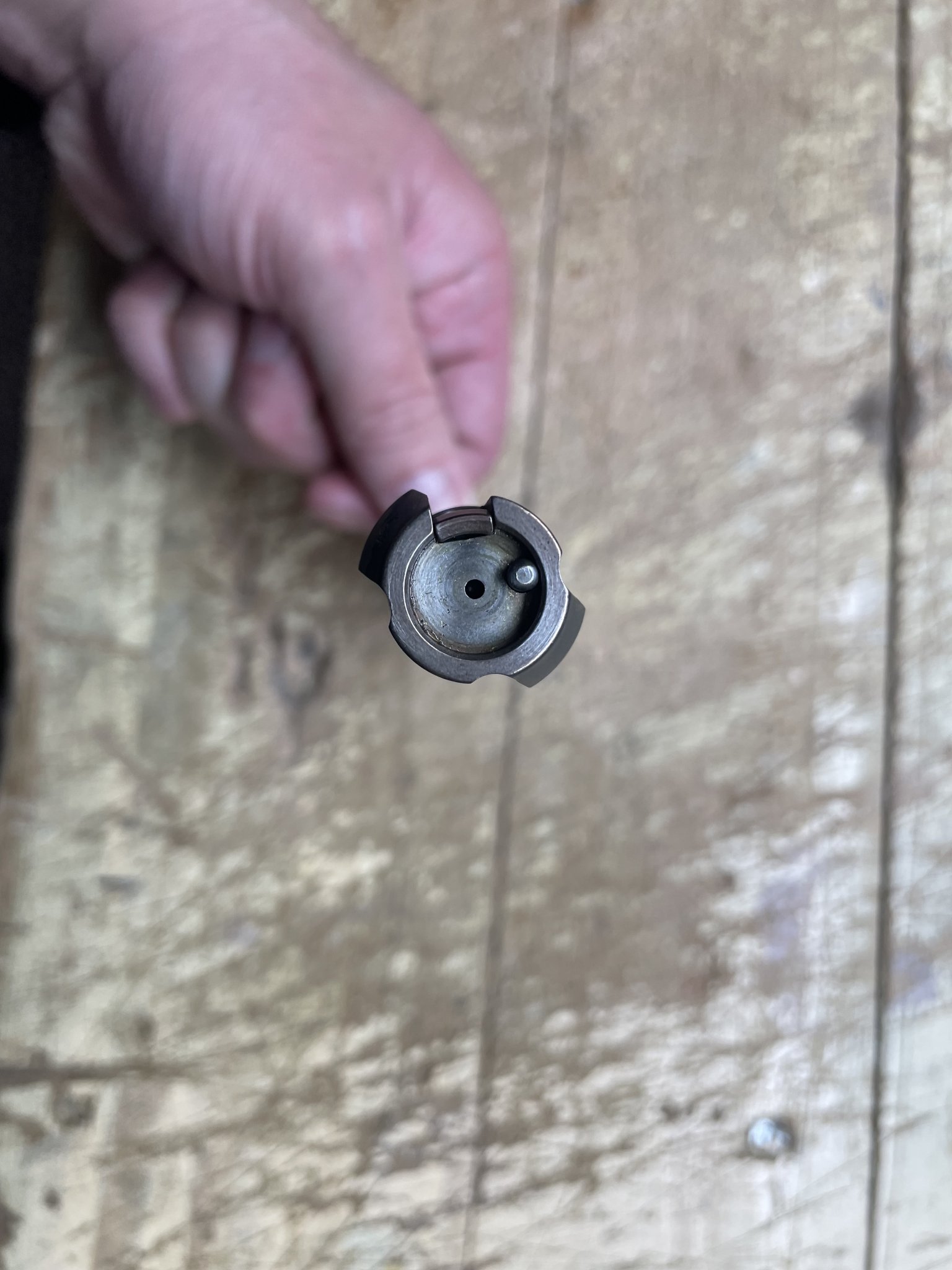

I’m trying to remove the factory 0 MOA rail on my Tikka T3x CTR to replace with a 20 MOA rail, and apparently this is an impossible feat. I got 2 screws out and the rest of the goddamn things will not budge. I’ve used PB blaster, an extractor, and a heat gun to no avail. The heat gun is where the issue might be… True to form and in moronic fashion, I forgot to remove the bolt before heating… I pulled it out and noticed some of the finish came off. Oh, and I began to melt part of the plastic stock around the barrel.
So, I ask this of you all, how bad is it?? The melted plastic is cosmetic, but what about the bolt… Come take pity on this poor dumb idiot and offer words of encouragement, advice, mocking, insult, or some combination of the above.
Try soaking them in angel piss (Kroil) overnight. It should penetrate enough if there's any rust that has them bound.
Worst case scenario is your last ditch effort... Get your drill and some sharp Ti bits and slowly drill the heads out down to the stem where the rail will pop off. Then the rail will come off, use a pair of vise-grips to clamp on the screw stud sticking out, and remove it from the bolt hole. Then clean everything up, use a brush and Kroil and clean up the holes. Then wipe it all down, and reinstall the new rail with proper torque specs and some vibra-tite VC-3 on the screws to keep them from backing out. 👍🏼
My guy…yet again coming through with some great suggestions to save my hide. If I ever make it down to wherever it is that you’re at, I owe you more than a few cold ones!
I MIGHT have had to do this once or twice before. Also, if you don’t have a set, get a Fix-it-Sticks torque wrench set. They’re worth the money. 👍🏼
Dude... Stop what you are doing and take that rifle to somebody who knows what they're doing if you don't want to be buying a whole new rifle. If you don't know to pull the plastic parts before starting to heat shit up then you shouldn't be doing that. After those screws come out the rail is held on with adhesive too which is a process as well.
Reactions: Tx_Aggie
The bolt finish wears off in those spots anyway. Doubtful you got it hot enough to mess up any heat treat, just might look ugly.
The Tikka base is usually threadlocked in place. It also uses small pins, 2 of 3 of them if I recall. It being so well locked down is the reason I went with a 20 MOA mount and left the rail in place.
Some heat should help loosen the threadlocker or whatever they use. Can also try a plastic or rubber mallet and tap the base UPWARDS to try and pull it from the receiver. Remember, even with the screws removed there are a couple pins in the base, so tap upwards. You can also use the Mirage band screw to sort of pry the rail up. Screw a screw into that front most hole on the base and it will bottom out on the reciever and apply some upwards pressure.
It’s ok dude, I’m a professional 😎
Haha glad to know I’m not alone. Seems like this is a common issue. I can’t imagine what would compel Tikka to epoxy a commonly replaced part onto a commonly modified platform…
I’ve looked at those, not in the budget at this time but definitely something I would like to have at some point!

Did you get it? I had a rail on a r700 that 2 of the torx heads striped out. I drilled the heads off then popped the rail off. Vise grips rounded what was left of the screws. I got some small flange nuts and tacked them on with the flange up to give more area to weld to. The heat of the welding and more area to grab onto worked for me.
mine came out fairly easy despite beig glued previously.
Remove stock and bolt aply heat with a propane torch and pull it strait up
Original rail has 4 screws and 2 pins like photo of mine after removing
