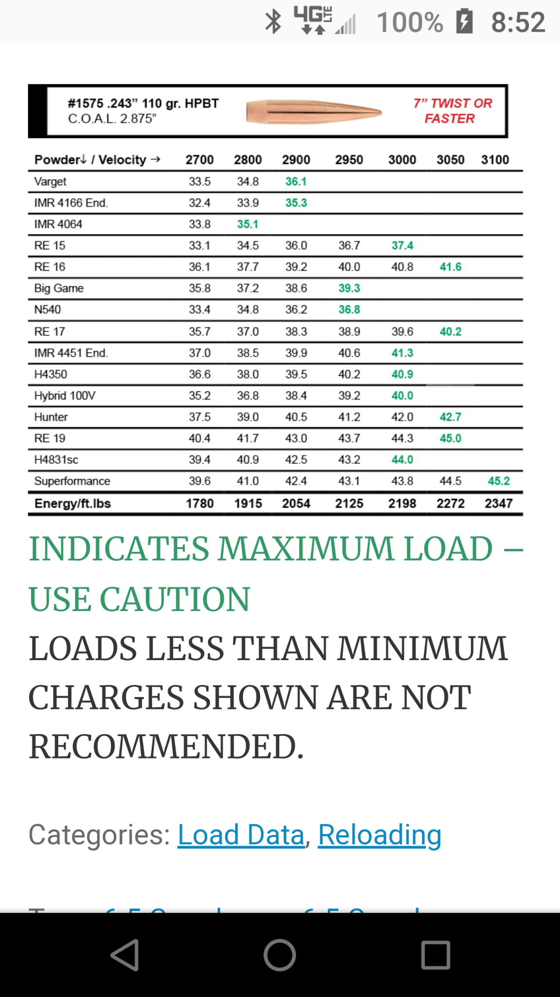

Here is Sierra's data on the 110 in the 6 creedmoor.
The freebore on the reamer and the coal used will determine the pressure point

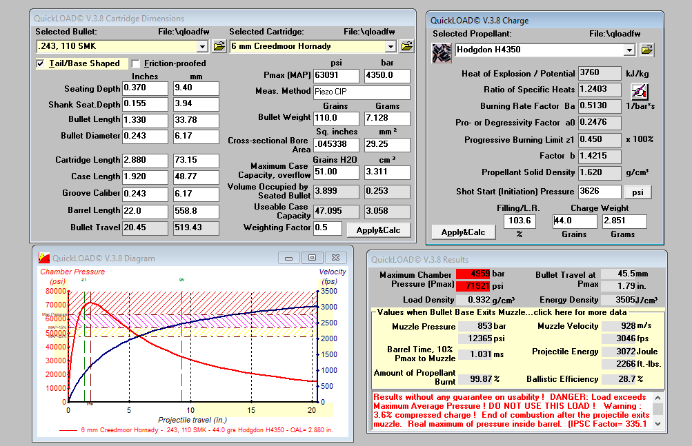

Here's a generic 44gr load

Longer freebore means much lower pressure with the same amount of powder ala Roy Weatherby.
If you look at the graph it shows well over 70,000 psi but if you read the text it says 63,000 so something is off 10,000 psi?
Functional
I believe that 63,000psi number is the max allowable pressure for the specific cartridge.
The 70k number is the actual projected pressure based on the load data entered.
