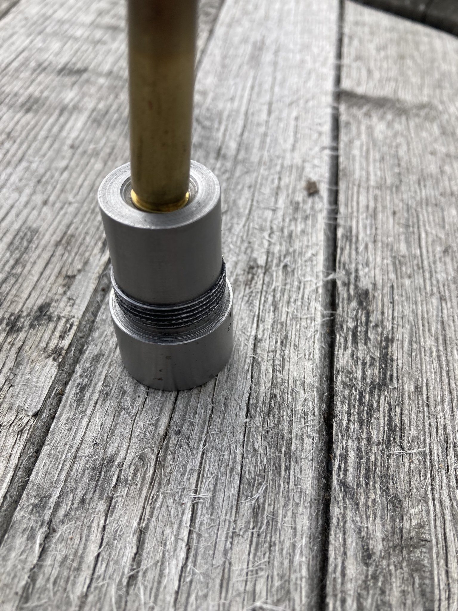

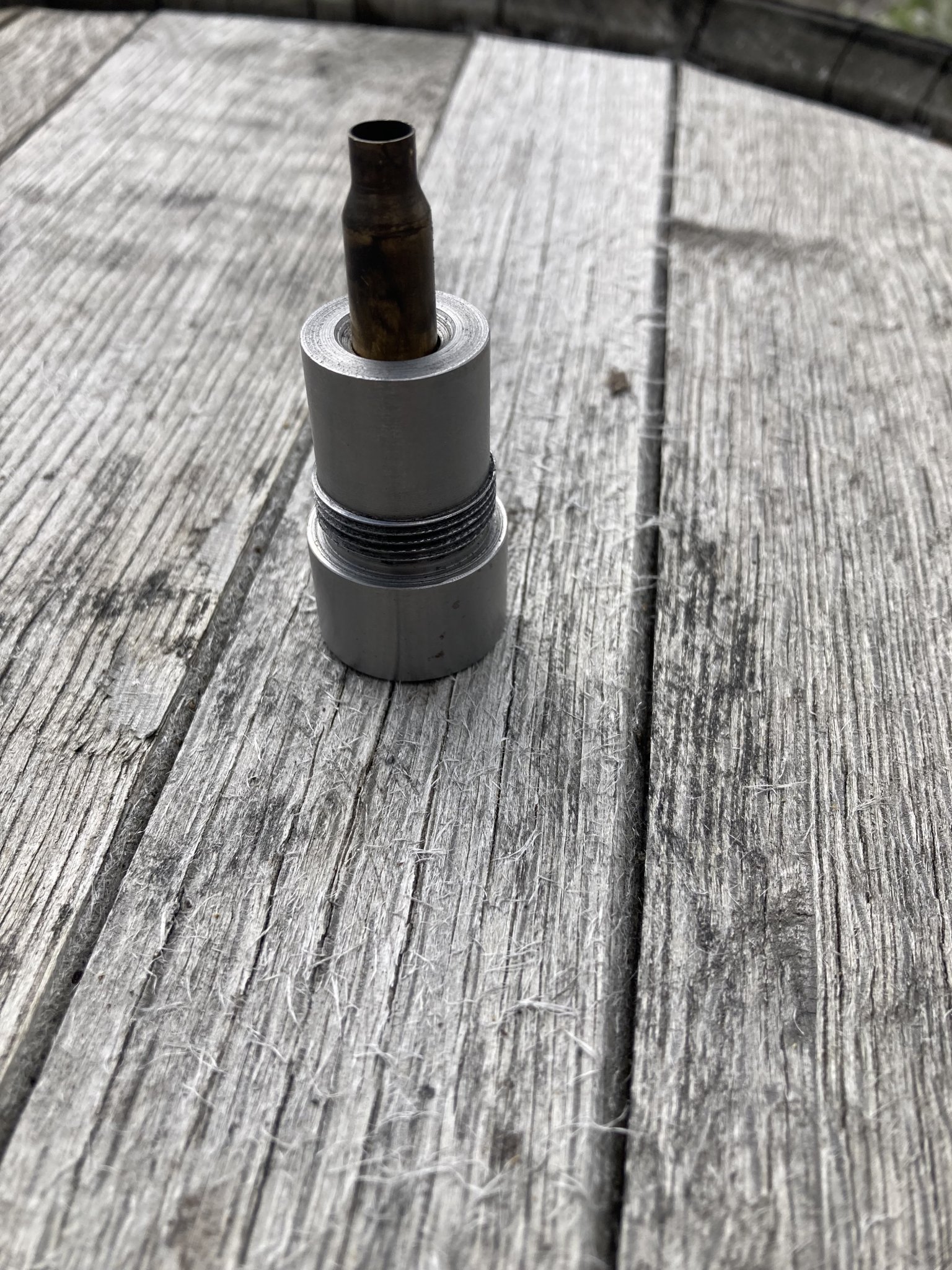

Since you mentioned having a case gauge I thought I would show what an over pressure load does to a 223 case. One picture shows how a case will fit in upside down in the gauge. The other shows the case head is so expanded it won’t even begin. A small base die cannot help here either. You would continue to have weird extraction and other problems. This expanded case would probably still feed and extract in a Wylde chamber, that's how loose the Wylde chamber is. Your brass has to be in spec using a CLE chamber. I found the results at the target are worth having the CLE. Just have to pay attention to the brass when reloading.
