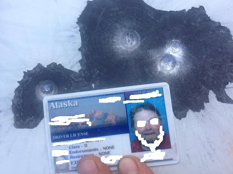

I'm shooting a 300 Norma, getting 2904 in 25 1/2" barrel, 1:10 twist, with Berger 230's and 86 gr's of 50BMG with an ES of 3 FPS over a 10 shot string. RL 26, RL 33, and N570 will produce better velocities but 50BMG at .040 off the lands will always be my go to because its usually the only powder on the shelf in interior AK. This photo was a 4 shot group at 774 yards with 50 BMG, 230 Berger's
