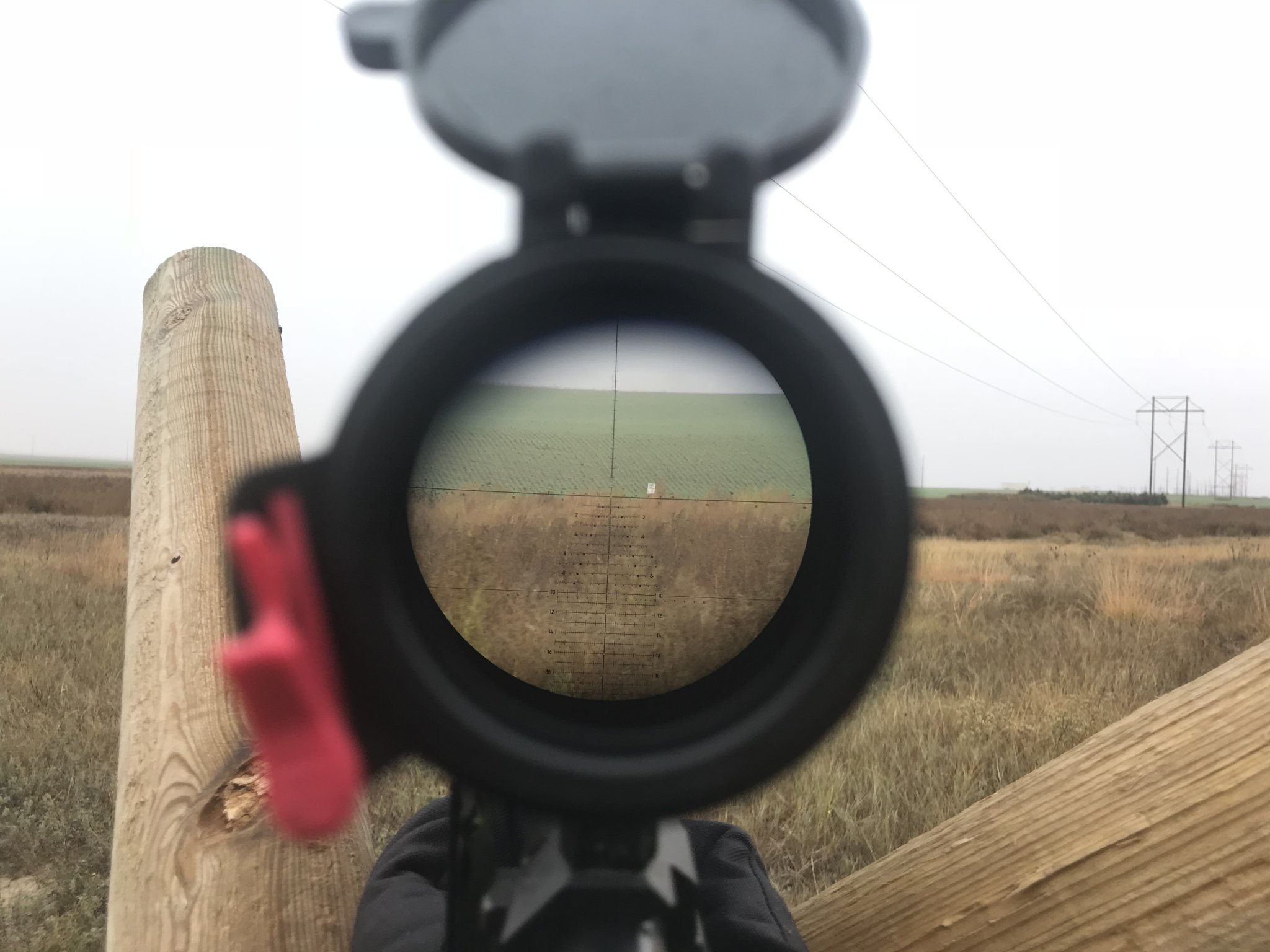

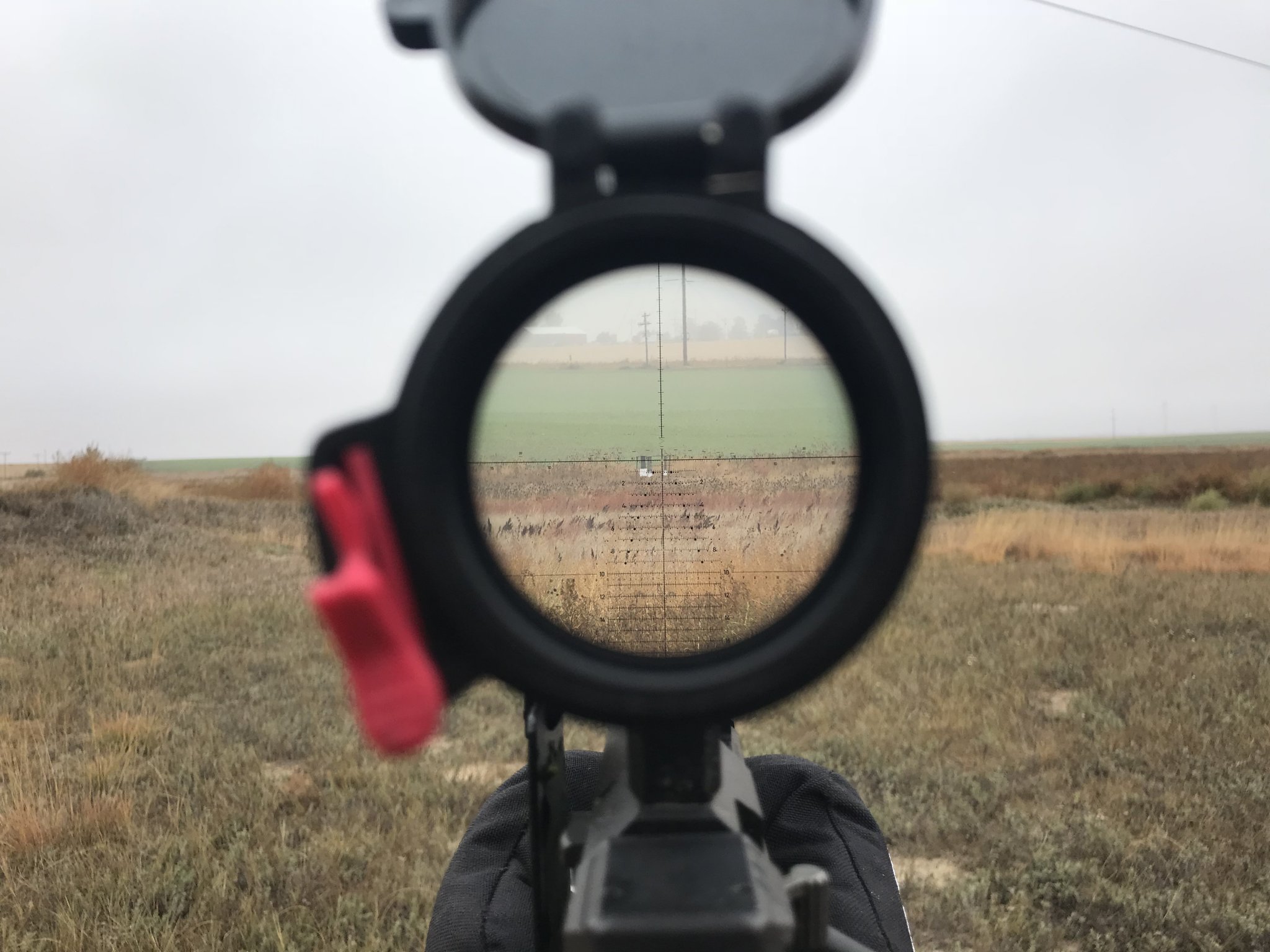

That gives you a pretty good idea what the reticles look like against something other than a white background. Thank you for including the pics and the descriptions. It helps.Here is a couple of my T3 at 500 yard kyl rack around 12-15 x in a s&b 5-25 the other is 395 yard small ipsc can’t remember if it’s 50% or 2/3 on the same magnification. It was a drizzling overcast day. View attachment 6964176View attachment 6964177

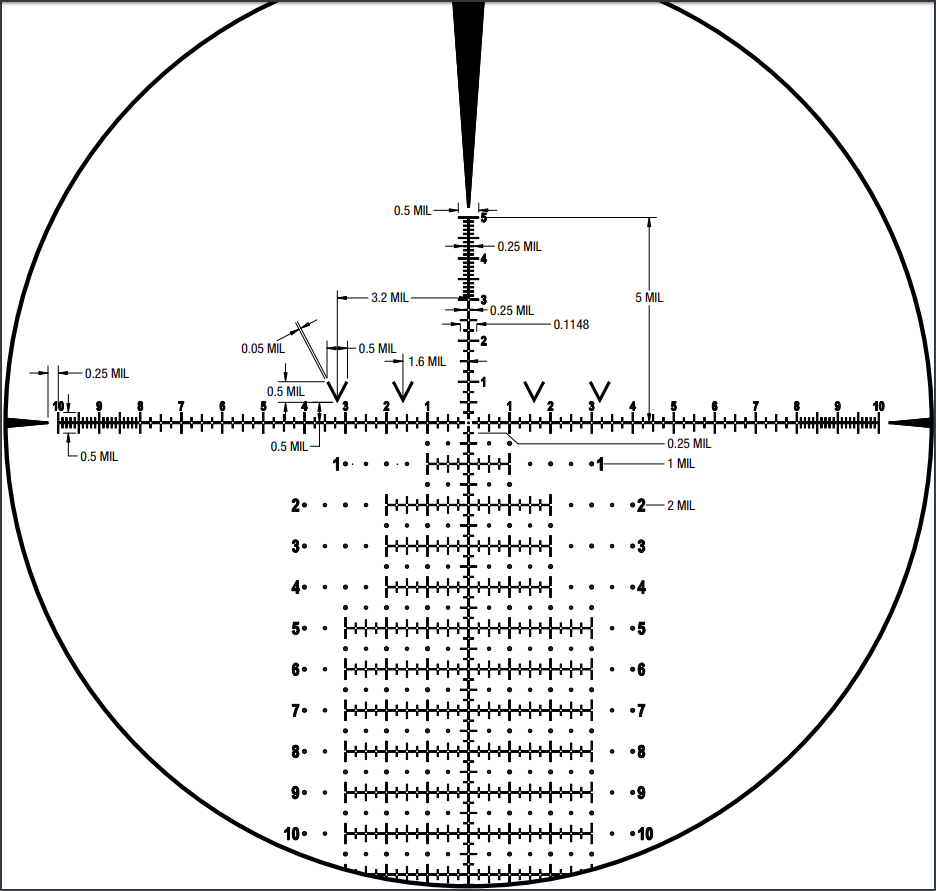

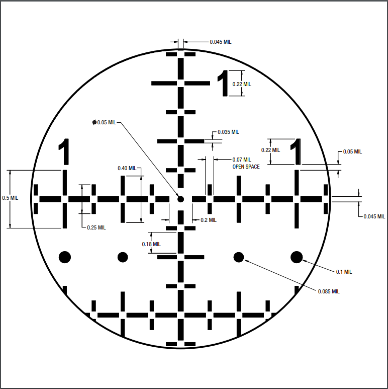

Here are some non download necessary viewsThis reticle by Leupold, The FFP CCH seems to be Leupold's entry in to the elaborate reticles: https://www.leupold.com/reticles/reticle-ffp-cch-177
Leupold sent me the subtensions diagrams which are attached here. Of all of them I would have to say I almost like Vortex's MRAD the most but the Tremor3, H59, and Leupold's CCH all have positive aspects.
