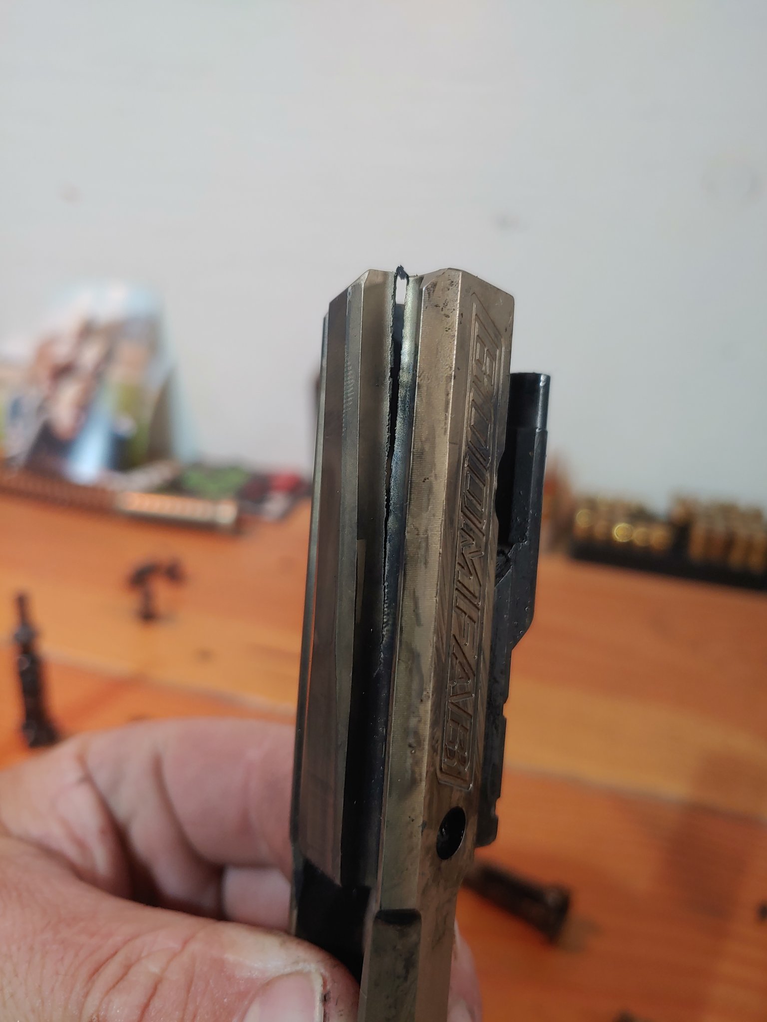

Had a boom yesterday first round of some new reloads.
Known good rifle.
Blew the magazine out the bottom, blew the mag bottom off. Bolt hard stuck, case is still in there. See pictures.
223 rifle shooting reloads with 55 Hornady SP over 24.7 grains of TAC. Range brass (which might be the problem?), CCI 450s
Barrel does not seem bulged (as in obstruction), and it would be hard to fit too much TAC in a 223 case, especially under a 55 grain bullet.
Barreled upper is sitting at the 'smith's now waiting for him to have a look.
Thoughts on cause? Thoughts on breaking the rifle down to do forensics?
Will know more about a cause when the stuck case is removed but possibilities include but not limited to:
1) excessive headspace
2) partial obstruction / object(s) in barrel near throat
3) overcharged case
4) wrong powder used
5) foreign object(s) in chamber
Gunsmith will tell you what happened and why; let us know what he says.
Reactions: S197
My vote is for improperly sized brass.
I had a single incident before where it had the same net effect except my bcg split like a banana.
The bolt appeared "closed" but it was not fully in battery because of a single piece of brass.
Reactions: Maxduty
Dillon 550 RL. Well worn with a rebuild and upwards of 50,000 rounds on it.
it's a suspect, as well.
Possible but not likely unless youve had a pattern of issues across everything youve been loading on that press in the recent past.
6) Case structural defect
perhaps on the case web above the groove was excessively thin / partial separation signs not visible from the outside
I'm voting against case head separation. I've always got a handful of imminent separation rounds that slipped through initial brass QC, I shoot them all through a beater gun and it's pretty anticlimactic. Some extra noise and smoke out of the ejection port and then shaking the front half of the case out of the chamber when it cools.
I have kaboomed similar to the OP once. I was shooting in the crotch of a tree and bark was flying everywhere. I had a round not fully go into battery so I pulled the CH back a bit and it seemed to go all the way home. At the same time as I told myself not to shoot it, I pulled the trigger and blew the mag out, split the bottom of the carrier, blew out the extractor and locked the gun up solid. My best guess as to the cause was all the bits of bark in places it shouldn't be keeping it from properly going into battery.
I have kaboomed similar to the OP once. I was shooting in the crotch of a tree and bark was flying everywhere. I had a round not fully go into battery so I pulled the CH back a bit and it seemed to go all the way home. At the same time as I told myself not to shoot it, I pulled the trigger and blew the mag out, split the bottom of the carrier, blew out the extractor and locked the gun up solid. My best guess as to the cause was all the bits of bark in places it shouldn't be keeping it from properly going into battery.View attachment 7719500View attachment 7719501View attachment 7719499
But even then, if the gun was out of battery, the firing pin should not have been able to reach the primer...
And yeah, I have had a couple of partial separations in my Grendel- a bit of extra smoke and a "WTF I need to check my brass more closely" upon seeing the case. Still hit the targets under time...
Reactions: supercorndogs
Yeah I know. It's a just a partial theory that I haven't spent a lot of time validating. It couldn't be an overcharge, the case is full of powder in that particular load and I couldn't seat a bullet if it had much more.
I had the exact same thing happen as Tony. The bolt was barely out of battery. Just enough to prevent full lock up. My carrier looked exactly like his.
Reactions: Ravenworks

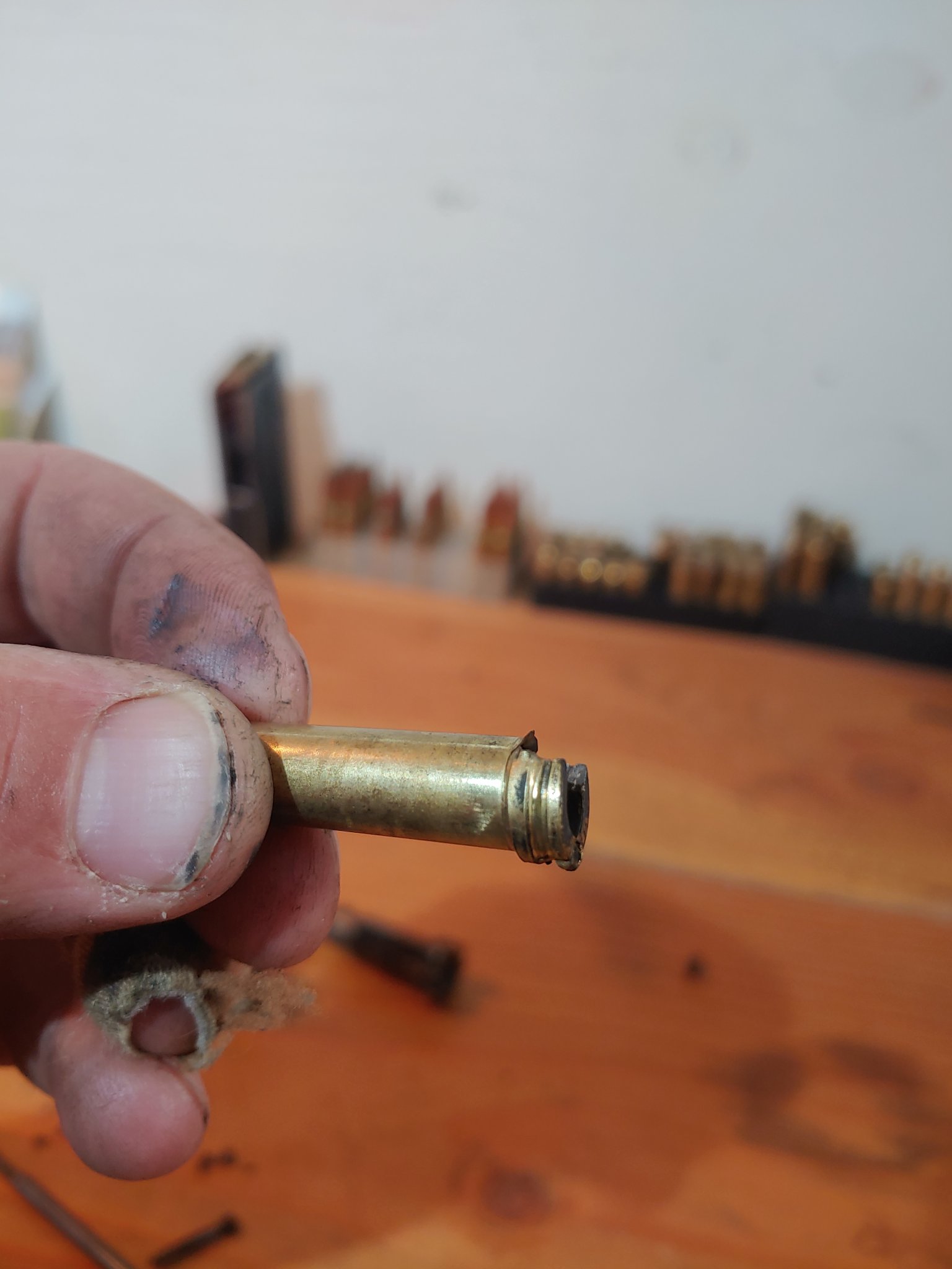

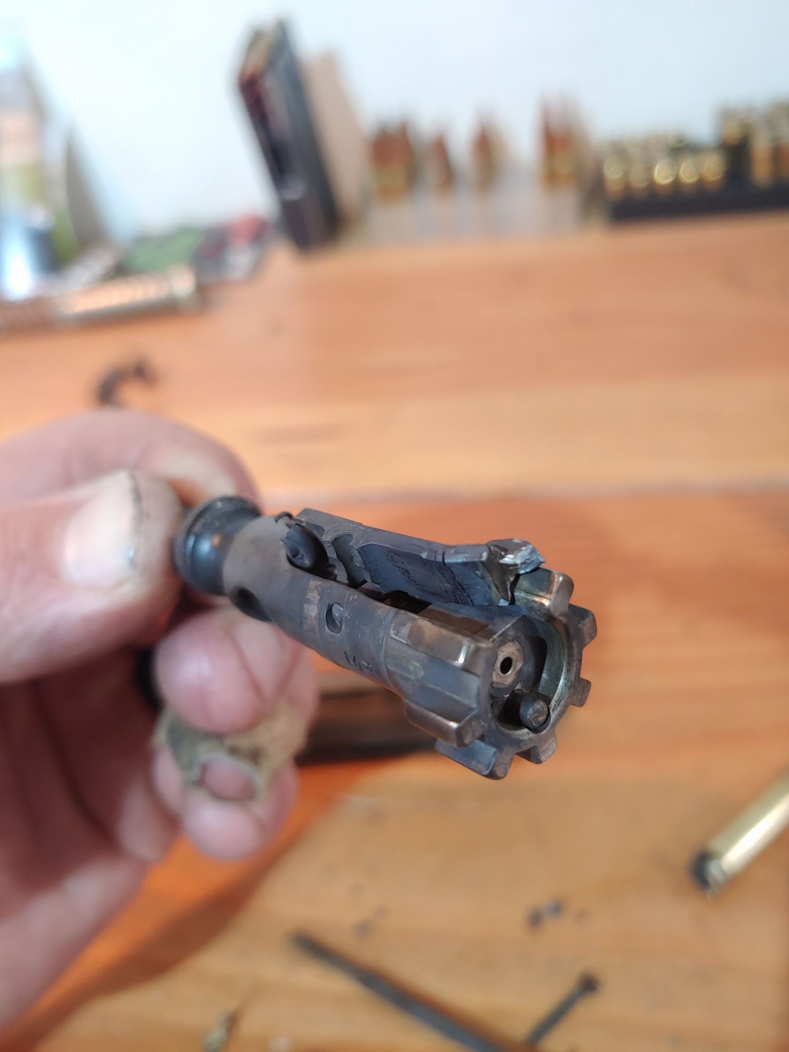

So, finally got the unit apart, and it was a case head separation. The upper, barrel and BCG are OK, the bolt needs replaced, and the charging handle is bent from me "mortaring" it to get the stuck case out.
No more reloads from pick up brass, I guess.
And no more reloads from friends.

That case head was blown off by excessive pressure. ITs not the cause of the pressure, but the result. A normal CHS, is not going to blow a chunk out of the case head, or expand the primer pocket like that.
