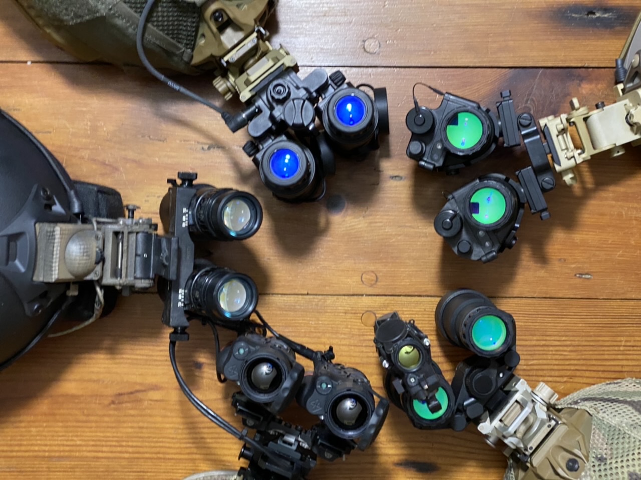

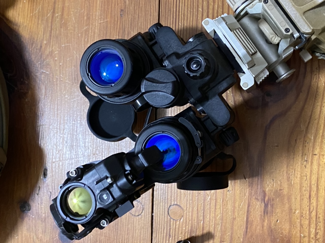

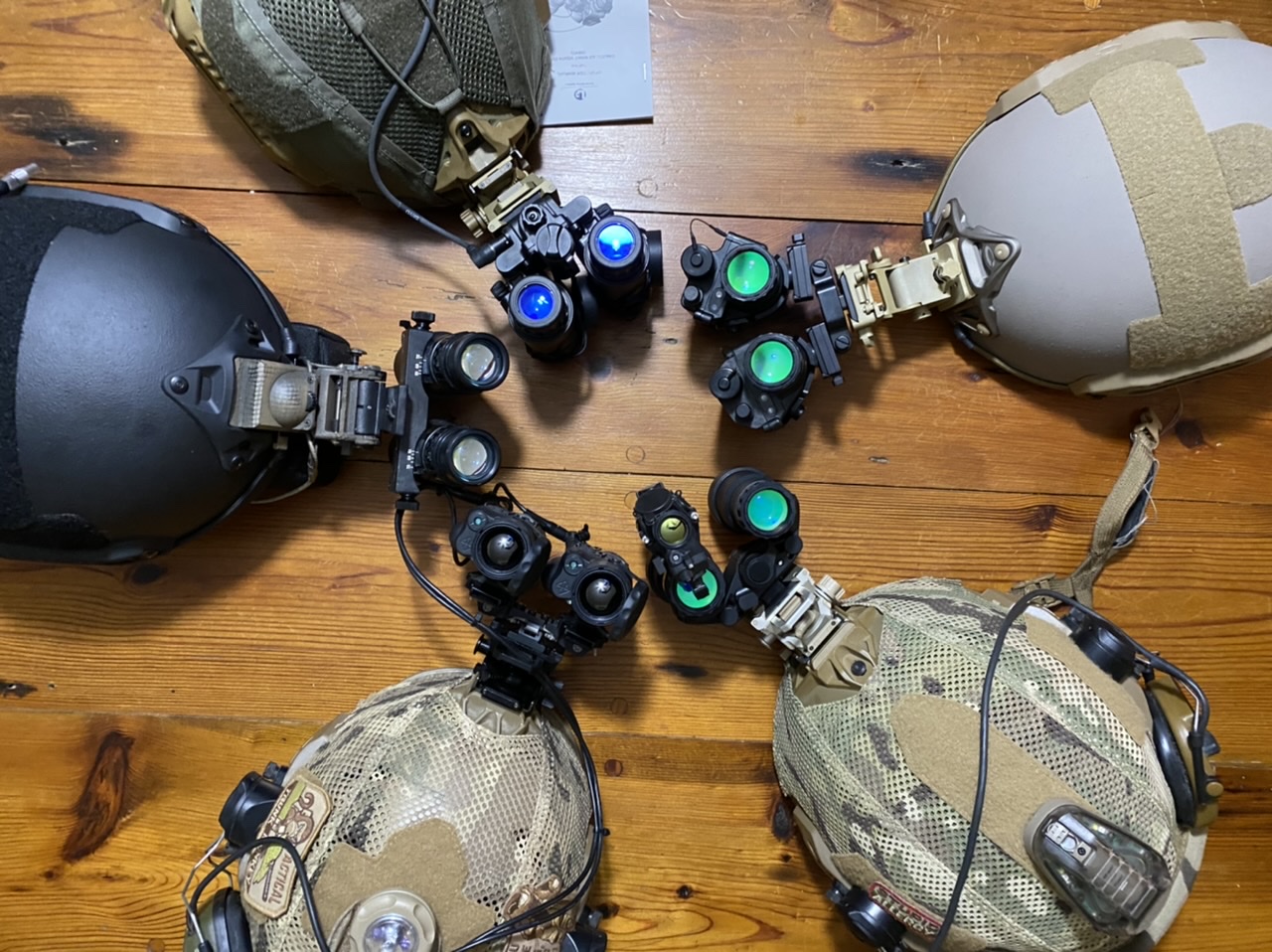

Night Vision Hail Hydra! Battle of the Dualies!
TheHorta
Nest-stirring pot-poker.
  • Jan 17, 2014
    5,247
    15,265
    NO AL
    Most people are blissfully unaware that Hortas have 5 heads. While you inferior carbon-based life forms talk about “Dual Band” sillyness, we silica-based superior beings are Pentacephalous.
    So, in figuring out which dual-optic solution works best, I submit the following:
    Of course, the Apex Predator of dual-optic solutions are dual SkeetIR-X’s on the KVC bridge. This solution makes you Heimdahl — nothing escapes your gaze.
    Just to the right (counter-clockwise) are DTNVGs with matched >2500 FOM L3 Filmless WPs with custom $3K RPO optics, with a PAS-29A COTI riding shotgun. Even this pimped-out setup can’t come close to dual Skeets. In fact, nothing comes close to dual Skeets.
    Continuing CCW are dual high-FOM WP PVS-14’s on the high-end ModArmory bridge. While they’re heavy and not collimated, they work great as dual tubes for the poors. They’re not going to put you far behind my $15K set of DT’s.
    At the 12:00 position are a set of vaunted, legit L3 PVS-31A’s — full meal deal MIN 2376 FOM factory units with battery back. I know some aren’t big fans, but I love them. They’re the truth, and since I have better than 20/20 in both eyes, I don’t need diopters.
    Last, but certainly not least, are a gorgeous set of AVS/Anvis-6. I’ve had both Anvis-9’s and 6’s — ditched the 9’s and kept the 6’s, so that should say something. Many mistakenly believe the 9’s are newer or somehow better than the 6’s because, well, 9 is bigger than 6. Alas, the only difference between the two are the type of lenses employed. 9’s have non-translating objectives, meaning when you focus them, the entire lens/optics pod rotates. With the 6’s, the non-translating objectives do NOT rotate when focusing, meaning if you have a COTI attached, it will NOT rotate when focusing.
    All-in-all, dual Skeets are what I wear every night. I feel naked running DT’s or 31A’s, even with a COTI attached. What I cannot see using lowly NV or NV/COTI is staggering. I hike, walk, and drive with Skeets, no problem (split windscreen in the Ranger). Were I taking a NV class or kicking doors, sure, NV would be the way to go. But for every single thing I do, dual Skeetahs make this silly-con life form feel all warm and gooey inside.
    Is this what you were wearing when you wrecked the Ranger into the ditch? :rolleyes:
    If you ever want to dial in those dual -14’s together (or any articulating NV), loosen the eyepiece lock collars, flip up one, find a bright star, and turn the eyepiece until the star is level (ETA: with your unaided eye).
    Repeat other eye and lock in the collars. Quick and easy DIY collimation and works awesome. 👍
    I will say this, my pimped DTNVGs outperform my PVS-31A’s. There is slight optical distortion in the 31A’s. It’s not bad, but it’s there if you look for it. With the RPO optics, there is absolutely zero distortion in the DT’s.
    The DT’s are eye-bleedingly sharp. The level of detail is superior in the DT’s. Contrast is superior as well. I think the tubes are probably very similarly spec’d, since both are equipped with L3 filmless WPs.
    The 31’s are bad-ass. The weight, form factor, manual gain, battery pack, IPD reset, etc are awesome and second to none. That said, my DT’s aren’t that far behind, and they’re optically superior — which is where the rubber meets the road. The perceived sharpness may have to do with the lack of diopters on the 31’s, but I doubt that has anything to do with the distortion, but it could have to do with the slight contrast deficit.
    I’d love to compare another set of 31’s and DTNVGs (or others, like BNVD’s, etc).
