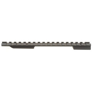

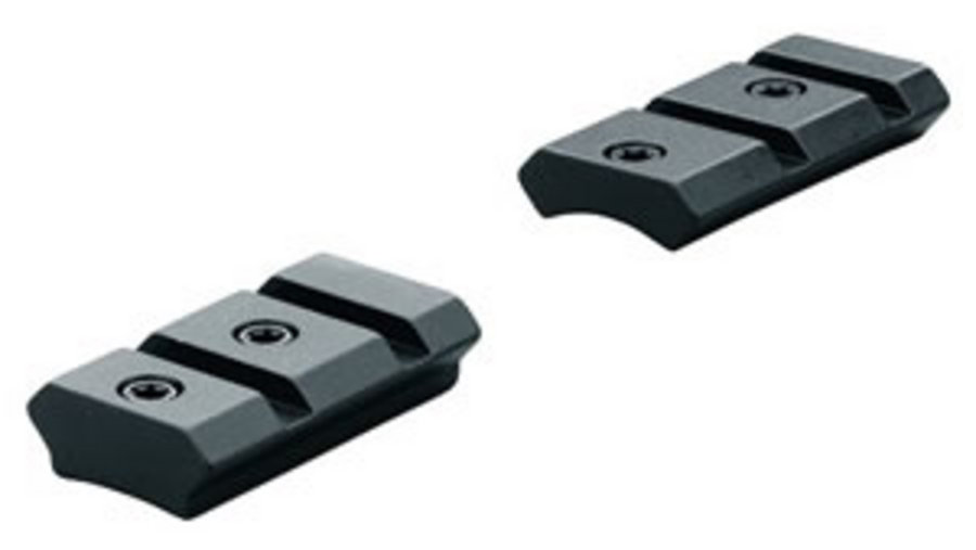

bigbore74 National Armory Full Member Minuteman Aug 3, 2012 104 0 PA Aug 3, 2012 #1 Aug 3, 2012 #1 Half Cut or Full Length Scope Mount? Pros and Cons? Like to read your thought or preference..
2 2156SMK Sergeant Full Member Minuteman Jun 8, 2009 729 2 50 Los Angeles, CA www.caprc.com Aug 3, 2012 #2 Aug 3, 2012 #2 Re: Half Cut or Full Length Scope Mount? What is a half cut scope mount? Do you perhaps mean a 2 piece scope base? The advantage of a 1 piece base is that the rings get aligned better. With 2 piece bases, you are at the mercy of the receiver to align the two pieces. In my opinion, a 1 piece scope base is the way to go.

CleanMoostang Sergeant Full Member Minuteman Jun 30, 2010 535 1 Eastern KY Aug 3, 2012 #3 Aug 3, 2012 #3 Re: Half Cut or Full Length Scope Mount? Not to mention a one peice gives you tons more mounting options in the terms of ring and scope distances and eye relief.

L leadbullet Gunny Sergeant Full Member Minuteman Sep 25, 2010 3,870 10 57 kitsap WA Aug 3, 2012 #4 Aug 3, 2012 #4 Re: Half Cut or Full Length Scope Mount? one piece all the way everything else is just a waste of money.

Pat M Gunny Sergeant Full Member Minuteman Feb 28, 2005 1,879 18 Cashmere Washington Aug 3, 2012 #5 Aug 3, 2012 #5 Re: Half Cut or Full Length Scope Mount? if you run a ADL*BDL stock & really low scope, a 2 piece gives a larger port opening for reloading

3 3oh8er Sergeant Full Member Minuteman Jul 5, 2012 104 0 69 Virginia Aug 4, 2012 #6 Aug 4, 2012 #6 Re: Half Cut or Full Length Scope Mount? One piece is best. If using two be sure to check alignment and shim as necessary.

bigbore74 National Armory Full Member Minuteman Aug 3, 2012 104 0 PA Aug 10, 2012 #7 Aug 10, 2012 #7 Re: Half Cut or Full Length Scope Mount? Half Cut in Mid Section for Shell Rejection 2156SMK said: What is a half cut scope mount? Do you perhaps mean a 2 piece scope base? Click to expand...
