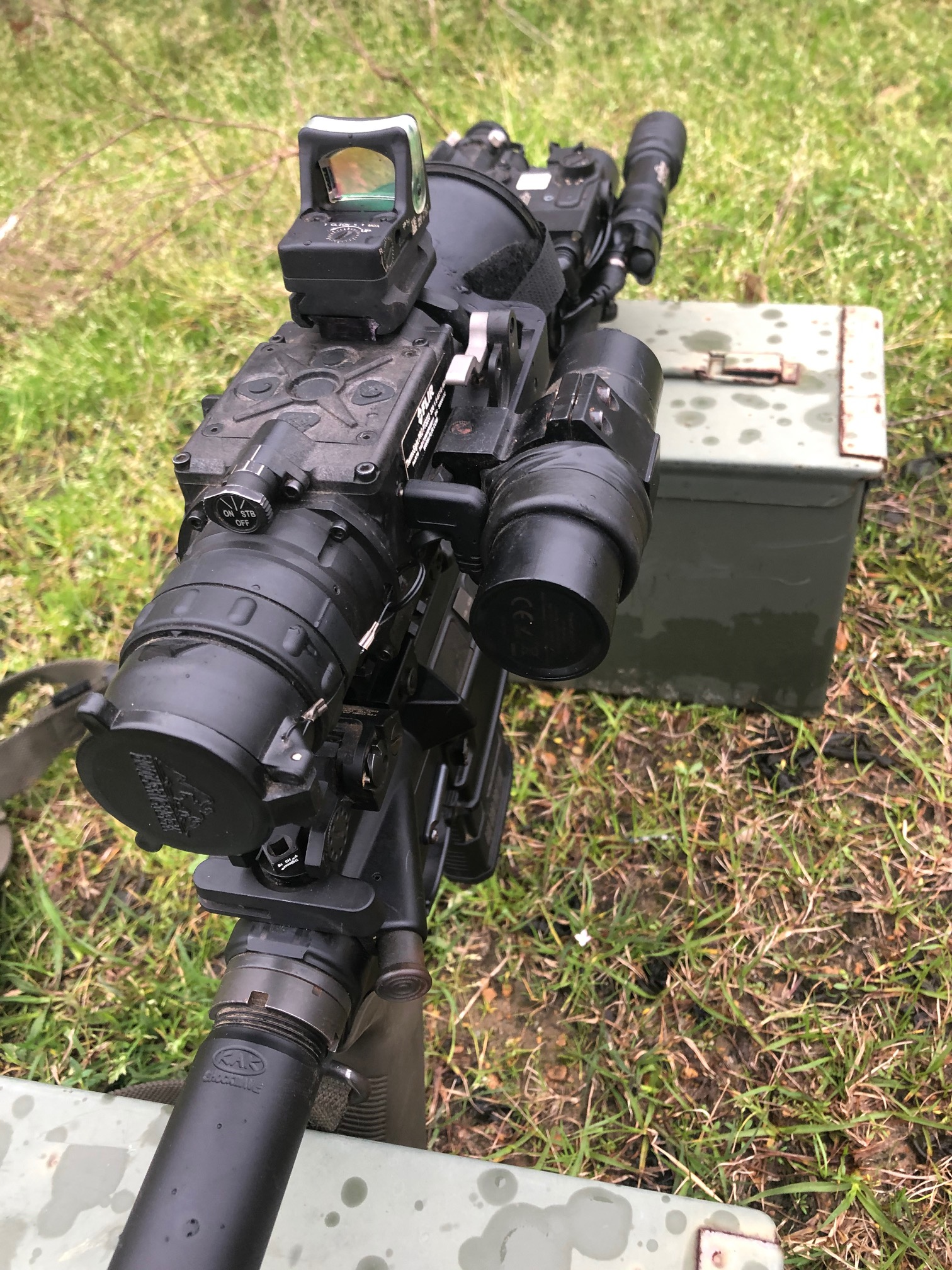

I’ve set mine up to run external power but what I’ve found is it just adds more weight and cables and the halo has enough battery to get through a night. I also don’t hunt every single night so I’m not exactly burning through batteries. I use a handheld scanner while in the buggie or walking to detect. Then turn on the halo to identify.
We had a xq38 and xp50 side by side with the halo LR and the identification range and overall image quality of the halo LR is pretty amazing. The new reticle is awesome as well. I think NVision should make a rifle
Mounted laser rangefinder next similar to the discontinued SiCo radius. There’s nothing on the market in the sub 1000 dollar price range. Ranging to 1000 yards is all that would really be needed
