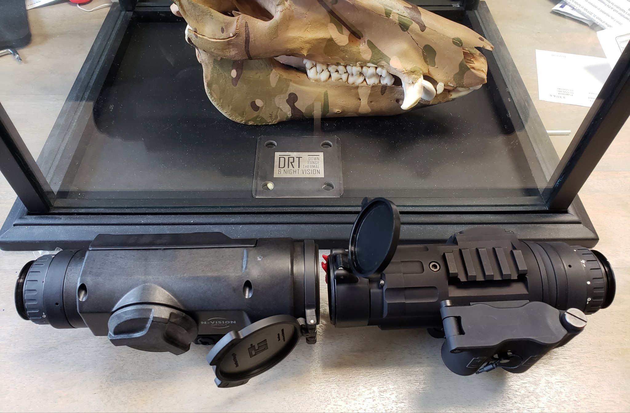

Here is a comparison pic between the v2 reap 35mm and the 25mm halo. The halo is 5 ounces lighter when both are sans batteries. 18 ounces vs 23 ounces.

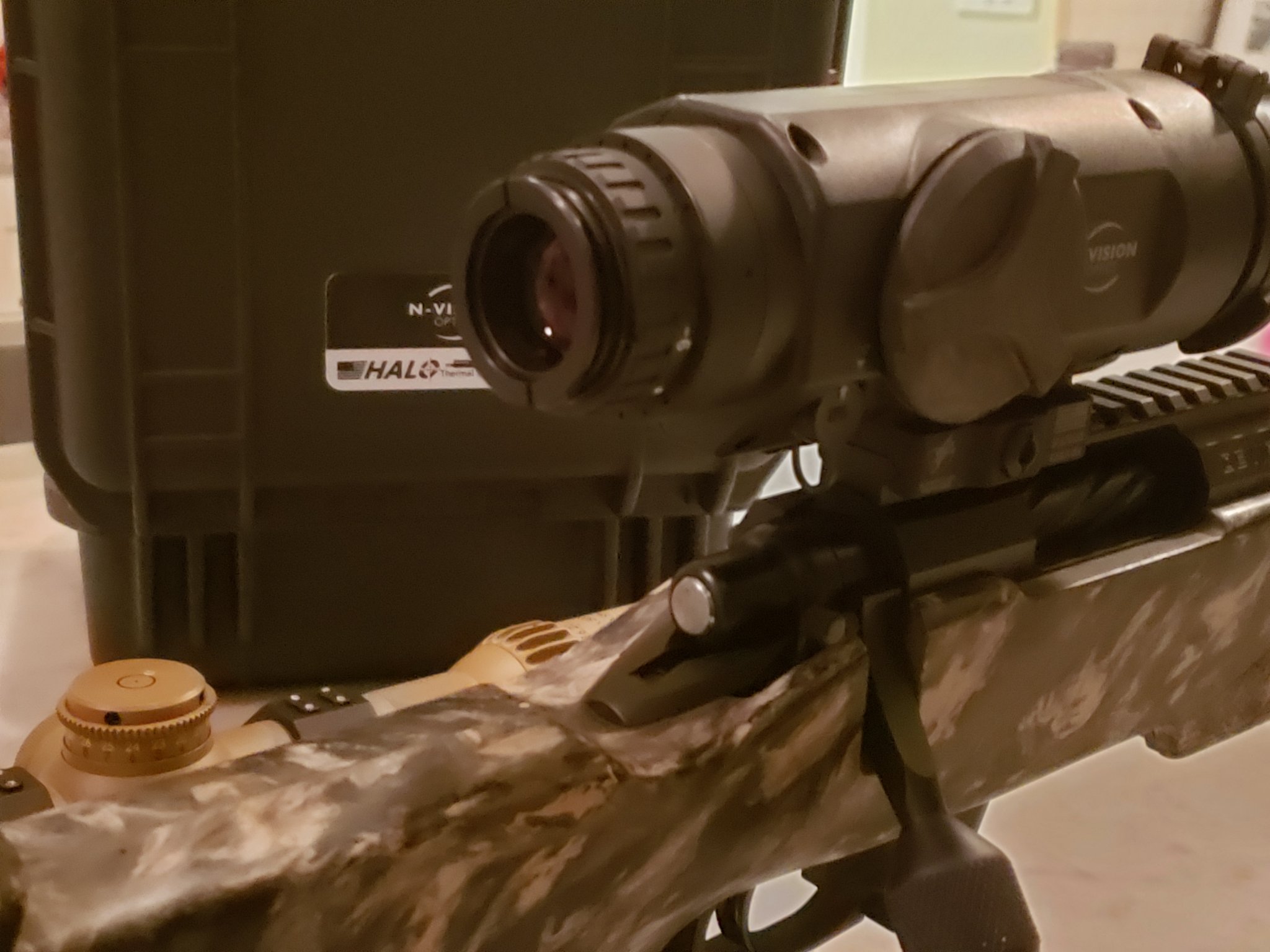

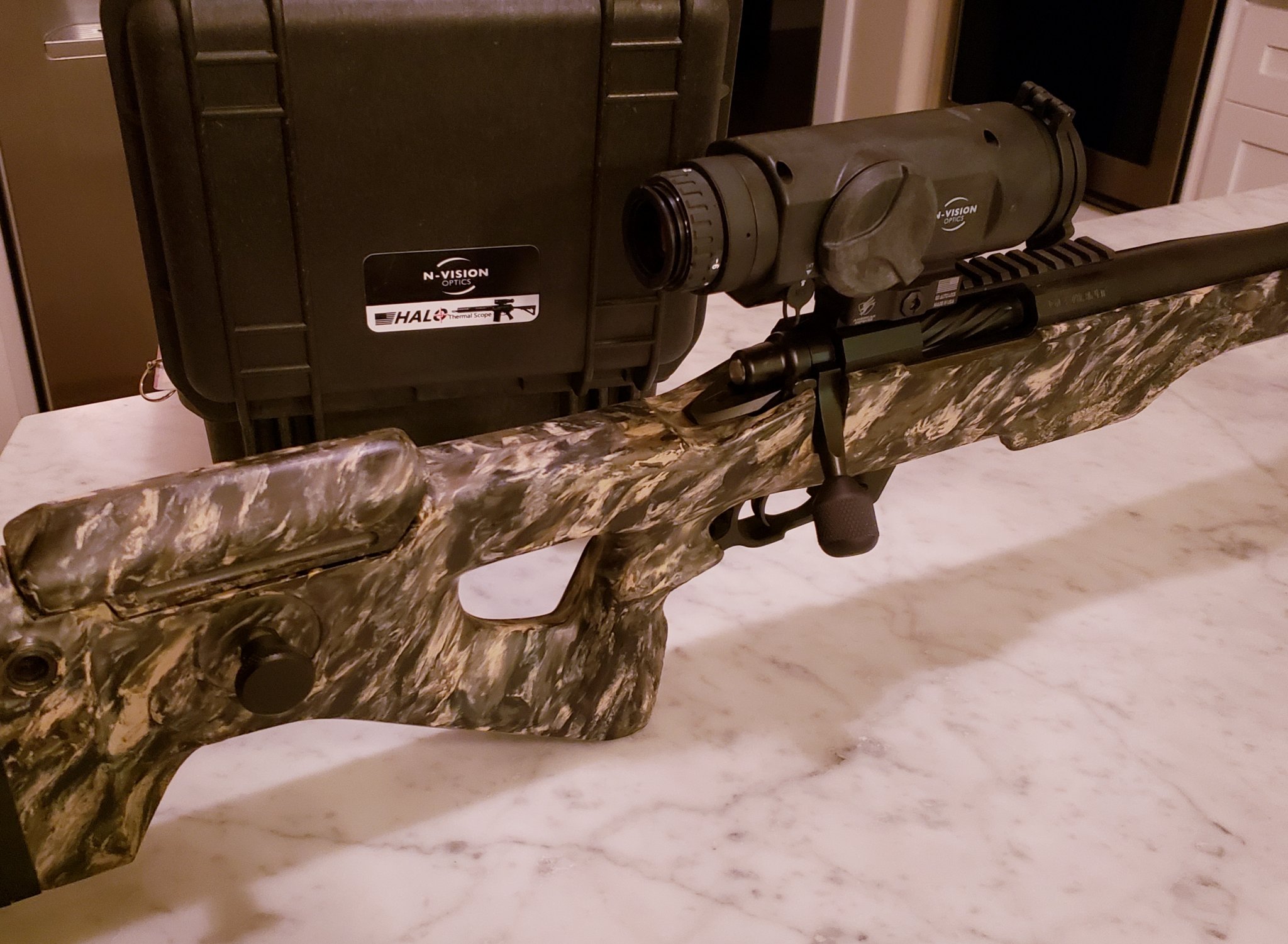

I'm planning on mounting mine on a bolt gun. Does anyone have it pictured on a bolt gun so I can see where the eyepiece ends up? I'm a bit concerned I might not be able to get it mounted back far enough. It's going on a 60 degree throw action as I know 90 degree throws can sometimes interfere with thermals
Its always a a bit of a hassle getting the proper eye relief with a thermal on a bolt gun. The 60 degree will be nice. The single lever adm mount sits pretty far forward on the optic. I can try and get a pic for you this evening.

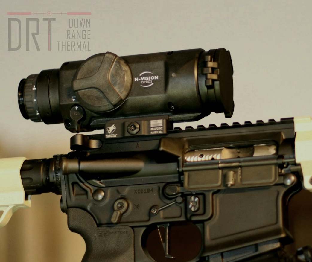

The lens looks like it should have an eye cup. Did you take it off for pics? If it has one, is it a shuttered eye cup? I hate how the trijicon units eye piece always falls off. Drives me crazy.
Yes I took it off.....it has a pvs14 eyepiece so shuttered Eye cups and Open Rubber Eye cups fit it. I just usually dont use them.

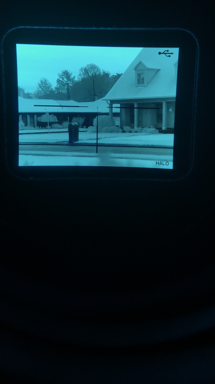

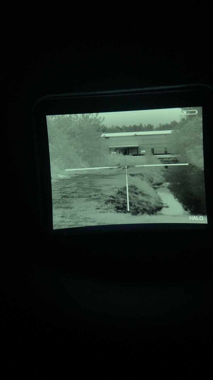

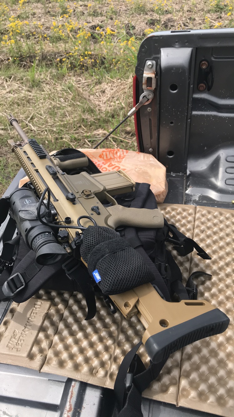

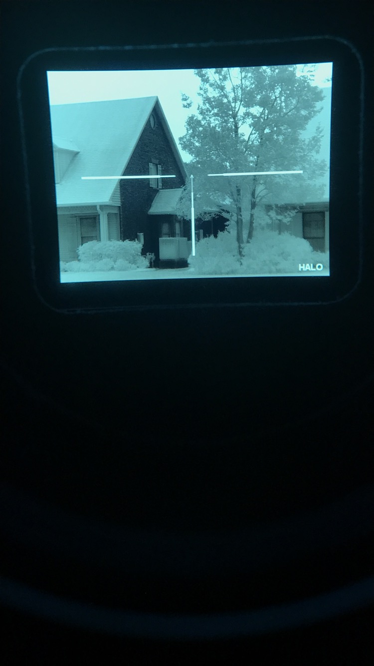

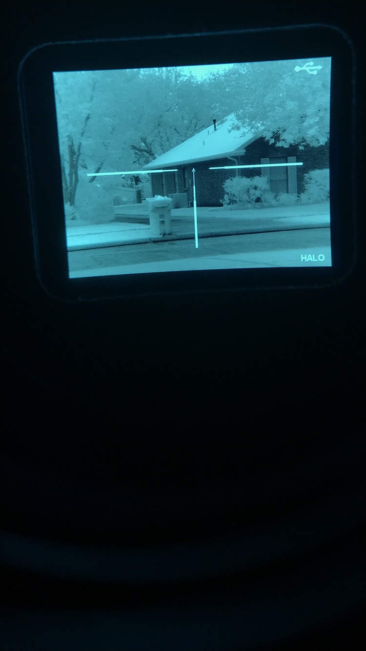

Took out my HALO 25mm today to sight it in on my scar and DDMK18 pisto.l.. and man this thing is nice. Once I got familiar with the controls, I found that I was faster with these than the trijicon REAP-IR. Glad I went with this optic over the REAP. The picture that I have here looks so much better in person.
