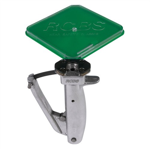

I have used an RCBS hand primer that takes the shell holders and I didn't have a great time with it.
I now have the Hornaday tool. Its an even bigger pile than the RCBS.
Does someone make a good one?
I was looking at the Frankford Arsenal one but I think RCBS has a universal one as well.
Are either of these worth the money?

I think it really depends on what you're trying to achieve other than just primer seating. I've have 6 different priming tools, including the Frankford Arsenal that's adjustable, and the one hand primer I like most is the 21st Century priming tool. I like it because it's adjustable, it has a hard stop making it pretty consistent for a hand tool, and it has lot of leverage making it easy on old hands like mine when doing a lot of priming (it's worth the price to me). Sinclair and PMA has one of similar design as the 21st Century and there's been reports of the same benefits. I thought the Frankford Arsenal would be good that way too, but it just doesn't provide the consistency I look for as it doesn't have a hard stop nor is it very easy on the hands.

The way you swap out a Frankford Arsenal is pretty similar to the RCBS, but slightly faster and also adjustable for seating depth. Swapping between LRP and SRP takes <30 seconds. If you think the FA is too slow for lots of pistol rounds, then you need to be priming on a progressive.
The 21st Century tool is indeed a precision instrument. But I choked on the $185 price - especially after comparing 10 rounds loaded by a buddy using that tool with 10 rounds loaded on my Dillon 550 using identical components from my bench. SD values were pretty much identical.
So I bought the Frankford Arsenal tool. It's done fine. In larger-sample comparisons of .223 ammo loaded by me with the FA tool and by my buddy with his 21st Century tool, ES/SD values are pretty much the same. Full disclosure: the .223 ammo with similar SDs loaded by both of us is using Starline brass. In our 6BR loads using Varget, Berger 105HT, and CCI 450 in the same lot of Alpha brass, his SD values are better than mine.

I have always used the RCBS universal and it does the job. For those using the Frankford, do you have troubles seating the primer deep enough? A buddy has one and he brought it over so I could compare. Even with the depth adjustment set the deepest, the primer was only flush with the case and not as deep as my RCBS seats. Maybe there was an issue with his?

Apparently, something is right with his Frankford seater. I have the Frankford adjustable set and do not have that problem at all. Though I find it a bit difficult to get primers fully seated to where I want them as the leverage is just not as good as I'm used to with the 21st Century hand primer.

Absolutely no issue with mine. My primers are 0.125" and primer pockets are 0.129"
I seat the primers at 0.006" below flush to get a 0.002" crush.

On brass with tight pockets, yes. They want to seat ~0.005" proud. When I make sure I fully squeeze to bottom out, I believe I'm getting post deflection. It's worse on LRP.
Still working on this though, I don't have enough confidence to say I'm not the problem.
Interestingly ... I've found a seating depth setting for my Frankford Arsenal priming tool that gives me a perfect depth for literally all of my reloading calibers (all Large Rifle ... either standard of Magnum). Works for 6.5-CM, 300-WM, 300-NM, 300-PRC and 338-LM. Haven't changed my depth setting in a couple of years, and all primers seat and shoot perfectly. Absolutely "love" the FA priming tool.
