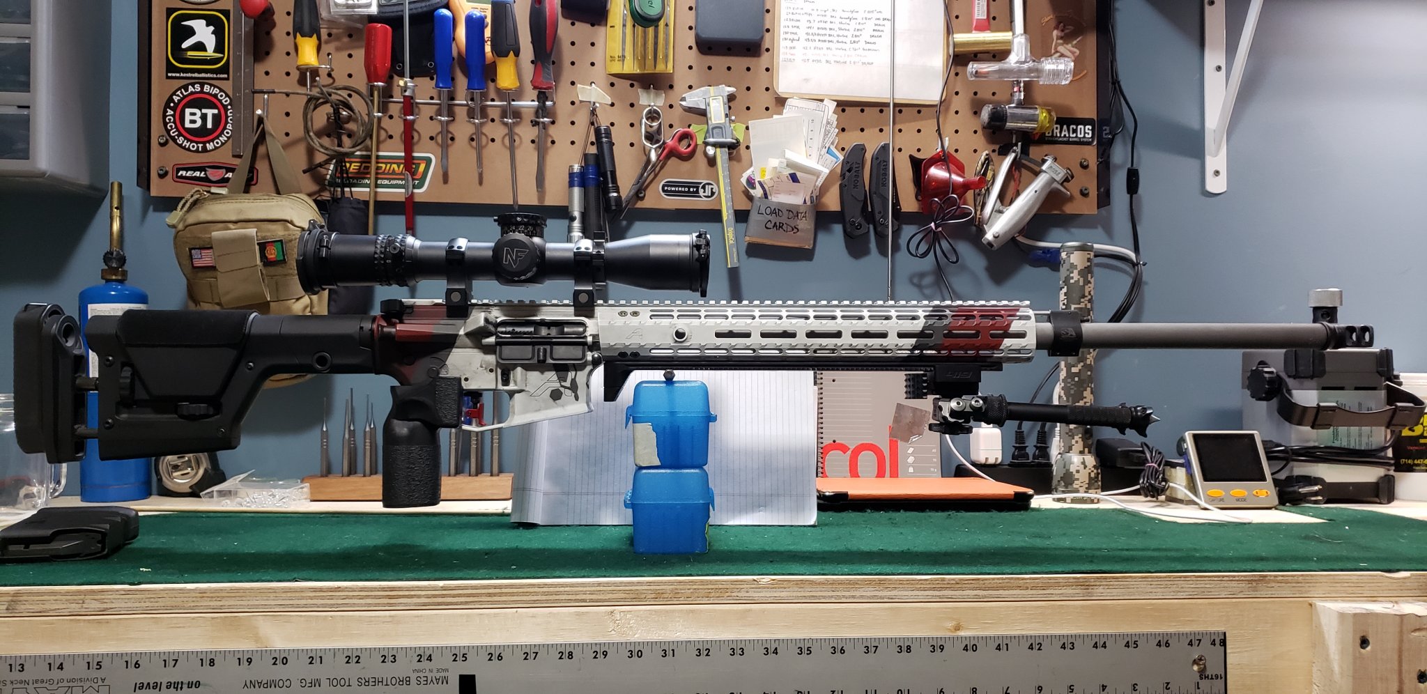

I run a 15" on my +3 gas. Block sticks out front but I don't mind at all and actually prefer it so that I don't have to worry about issues with gas block clearance inside foreend. Here's what it looks like at 15" handguard.
At 16" long, about 1/3 of gas block is covered (used ruler to see how far it needed to extend).
