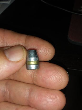

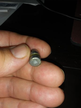

I was loading 10mm hard cast bullets that I poured and when I run them through the RCBS auto luber I noticed there is a bit of lube on the bottom of the bullets. I wiped it off every bullet I made - 500 rounds - and this was very tedious. Can the small amount of lube on the bottom of the bullet affect the charge in any way? - these performed well at the range. - "Darn spider jumped out of my powder thrower and I screamed like a girl, may need to sit down to pee for a week.
To your main question, That little bit shouldn't hurt the powder unless you load and then store for 6 weeks or so, especially if they will be subject to summer heats.
One think you might notice is a bit of smoke when shooting these "boolits" and a little more time required to clean your weapon.
Since you have a BB mold, first clean the top of the knock out pin in your H&I die. Second , try adjusting the depth on your lubersizer so that your bullet doesn't go in as deep but still fills the lube groove .

The thin smear of lube on the bullet base won't hurt a thing, no matter how long you have them loaded for. That smoke you're seeing isn't just lube though, it's lead too, and that will hurt you, eventually.

Appears your bullet has a slight bevel base, and it’s almost unavoidable to get a slight bit of lube on base, depending on sizer setup used. I have both Lyman and RCBS sizers and loaded straight/flat based or gas check molds to avoid exactly what you’ve encountered. Powder coating seems like a good option, which wasn’t available to me a long time back when I cast everything I shot. As long as your alloy throws a bullet that would net a bullet diameter that was appropriate to use in your load/chamber once coated, that might be a be a solid process to follow. Good looking bullet for the 10mm, by the way.

Where the hell did you come up with that ? 6 weeks , myth . Little bit of lube on base will not hurt a thing, ever . As long it is actual bullet lube and not a bubba mixture of petrol products .
Appears your bullet has a slight bevel base, and it’s almost unavoidable to get a slight bit of lube on base, depending on sizer setup used. I have both Lyman and RCBS sizers and loaded straight/flat based or gas check molds to avoid exactly what you’ve encountered. Powder coating seems like a good option, which wasn’t available to me a long time back when I cast everything I shot. As long as your alloy throws a bullet that would net a bullet diameter that was appropriate to use in your load/chamber once coated, that might be a be a solid process to follow. Good looking bullet for the 10mm, by the way .
This bullet did have a slight bevel - I call these my flops and I re-pour them - only used it here for example - all my loaded rounds look a lot better - I sort out the weird ones.
