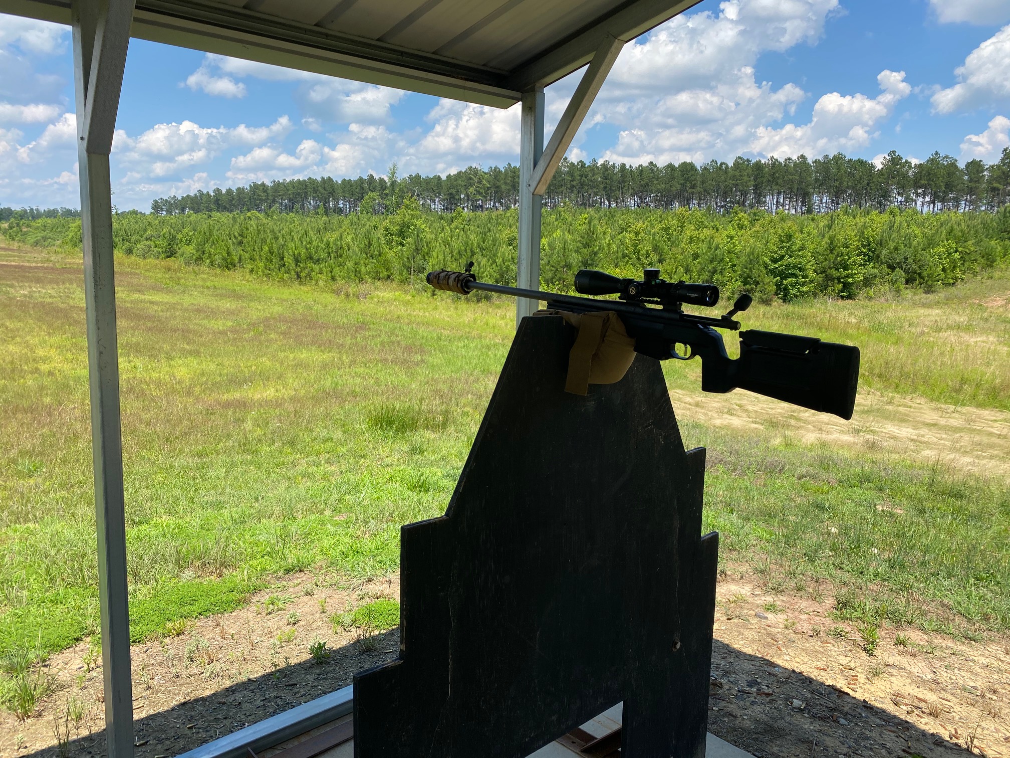

I recently purchased a Rem 700 in 6.5 Creedmoor and put it in a KRG Bravo(It's my first precision bolt gun so I'm pretty new to this) Intended use it shooting steel for fun out to 1,000 and a few PRS style competitions a year(I've only done two so far and was using a 6.5 Creedmoor gas gun and decided to switch to a bolt gun after those).
I noticed on my first range trip with the rifle that with a Harris Bipod attached to the sling stud in the stock that there isn't room to fit a game changer bag between the bipod and the barricade stop that's in front of the magazine. I had to remove the bipod to be able to shoot of a barricade or other surface using the game changer bag for support. What have others done to get around this and be able to fit a game changer bag behind the bipod but still in front of the magazine?
I'm also wanting to have at least a short section of Arca raid for attaching the rifle to a tripod and I'm considering two options:
1. Buy the full length Arca raid to mount to the Bravo then get an adapter to mount the Harris bipod to the Arca rail and see if I can get it far enough forward.
1. Buy both the Arc rail and the minimalist spigot mount and attach the bipod to the spigot mount
3. Buy the full length Arca rail and a different style bipod I can mount directly to the Arca rail and see if I can get it far enough forward. I've only ever used a Harris or Harris style bipod, but not opposed to trying something else if it doesn't require spending Atlas kind of money...
4. Other ideas?

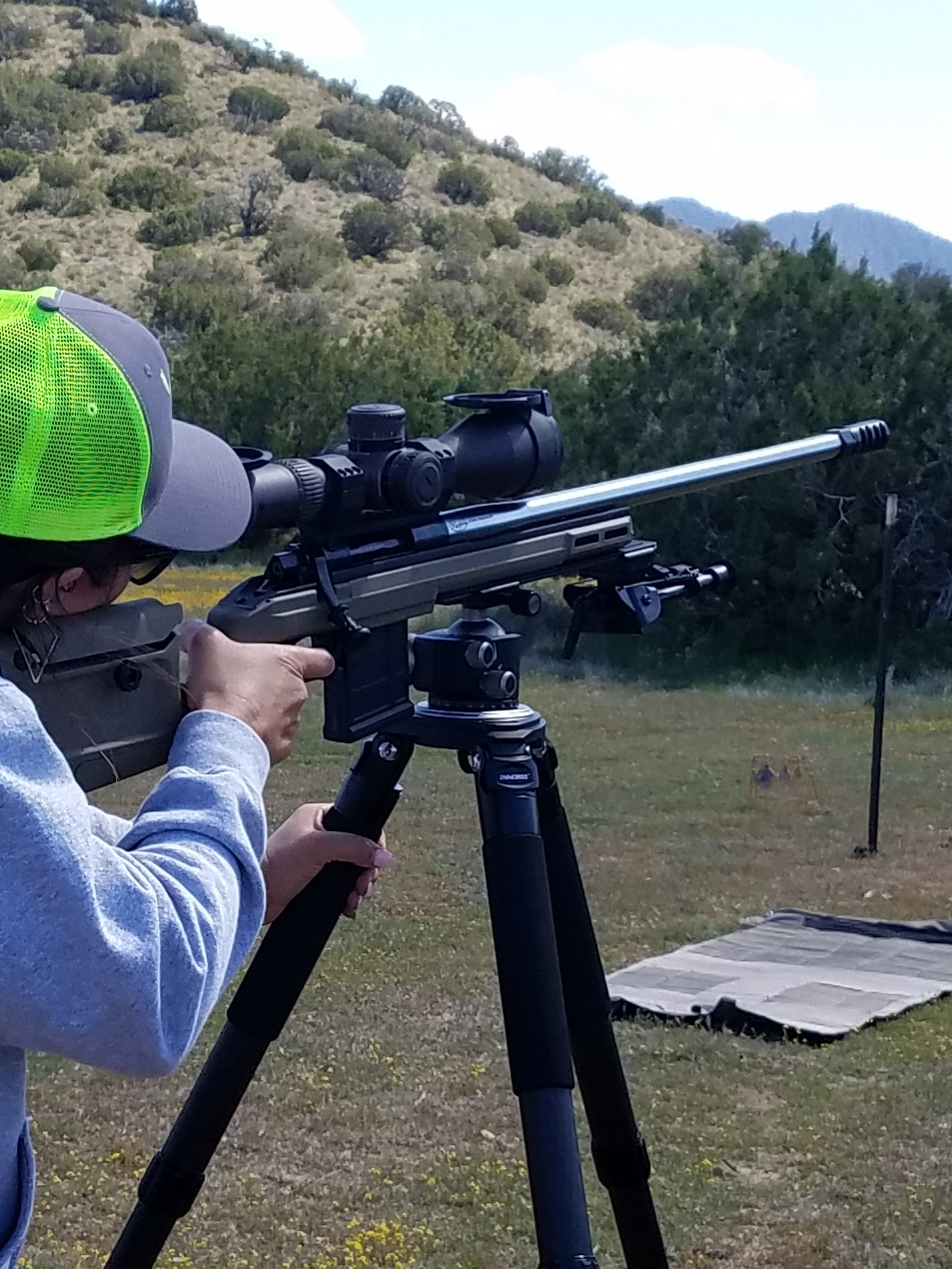

I just made these upgrades to mine. I bought the RRS arca adapter (one with the knob) over the area 419 because the RRS will attach to a picatinny mount and arca for use across other rifles. It made a big difference on the harris bipod. The krg arca rail standard length. KRG missed the boat not putting an integrated arca rail in the enclosed forend. I dont have a barricade stop on mine and didnt have issues with that bag before but this is my experience.
RRS BTC-Pro adapter for your Harris and a 12 inch ARCA optimized for the Bravo rail from Sawtooth Rifles would be my choice.
This. Sawtooth full length rail and Sawtooth harris adapter work great. Sawtooth is an awesome company to do business with.
