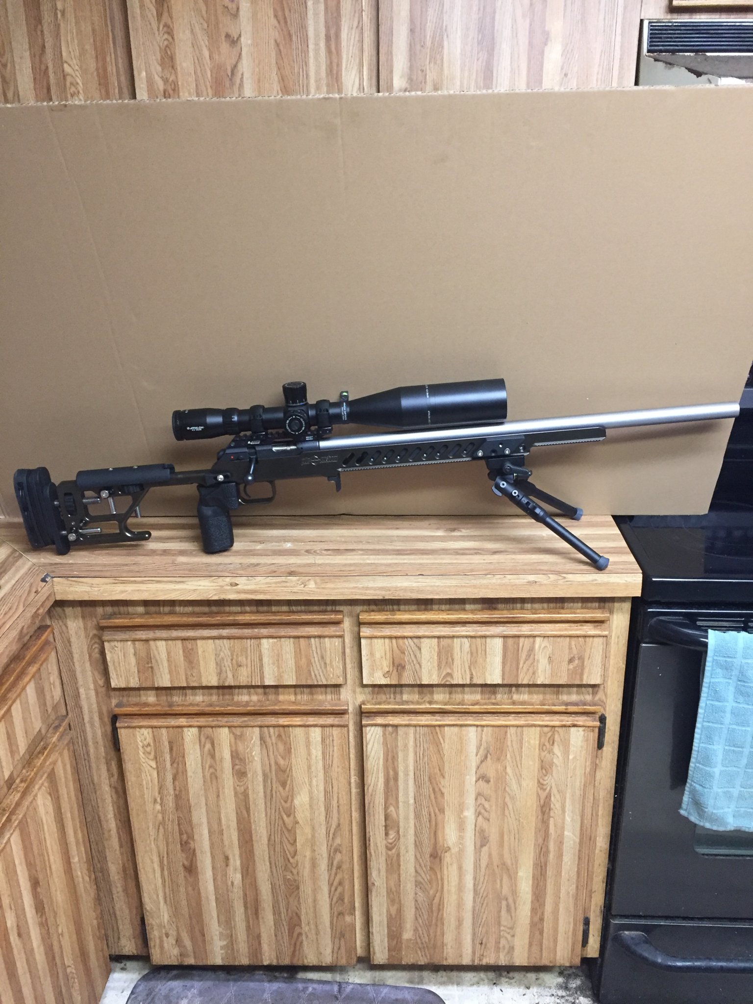

I just finished my two builds I was working on. Both have Hart barrels and Athlon ETR 4.5x30x56 scopes. One has the Oryx chassis, CZ455/24" barrel. The other the PDC, CZ457/26" barrel. I finished the Oryx and have shot it once, last week. I just shot 50yds so far and the first 6 shots of TAC22 went through the same hole, not a ragged hole, the same hole and then one flyer and 3 more in a now ragged hole. Thats a 455 with a Mr Fly trigger. I havent shot any high dollar ammo through it yet.
Tomorrow I shoot the PDC and see how it does. I am taking some TAC22 just like with the first gun but I am also bringing some Eley Match, Lapua Center X, and Lapua Long Range, to see how it behaves with good ammo and whether or not the batches are liked by the barrel. Hoping for a low wind day or I wont waste that high dollar ammo and just shoot the TAC22 and probably some CCI STD.
Anybody have any questions about Hart barrels, just ask and I will do my best to answer. I had a 5 month lead time with them. Same for PDC. The quality is such that I think its worth the wait.

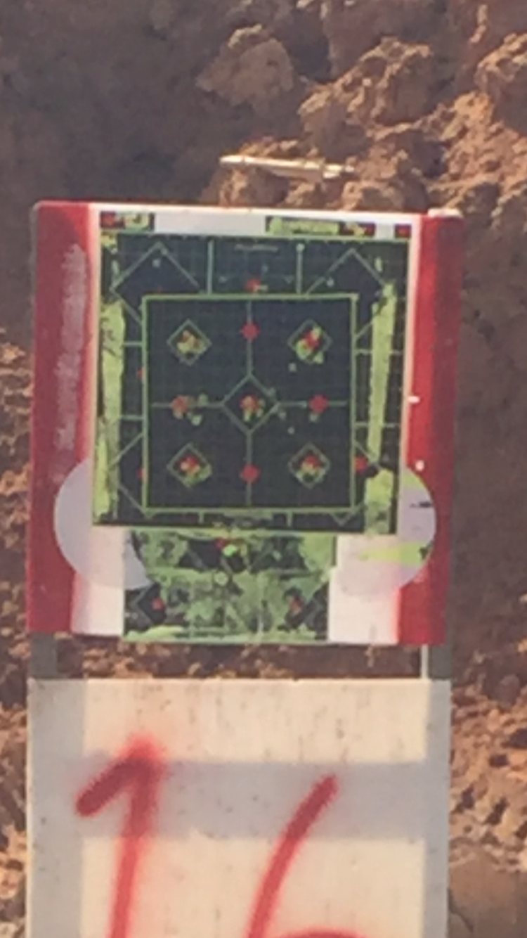

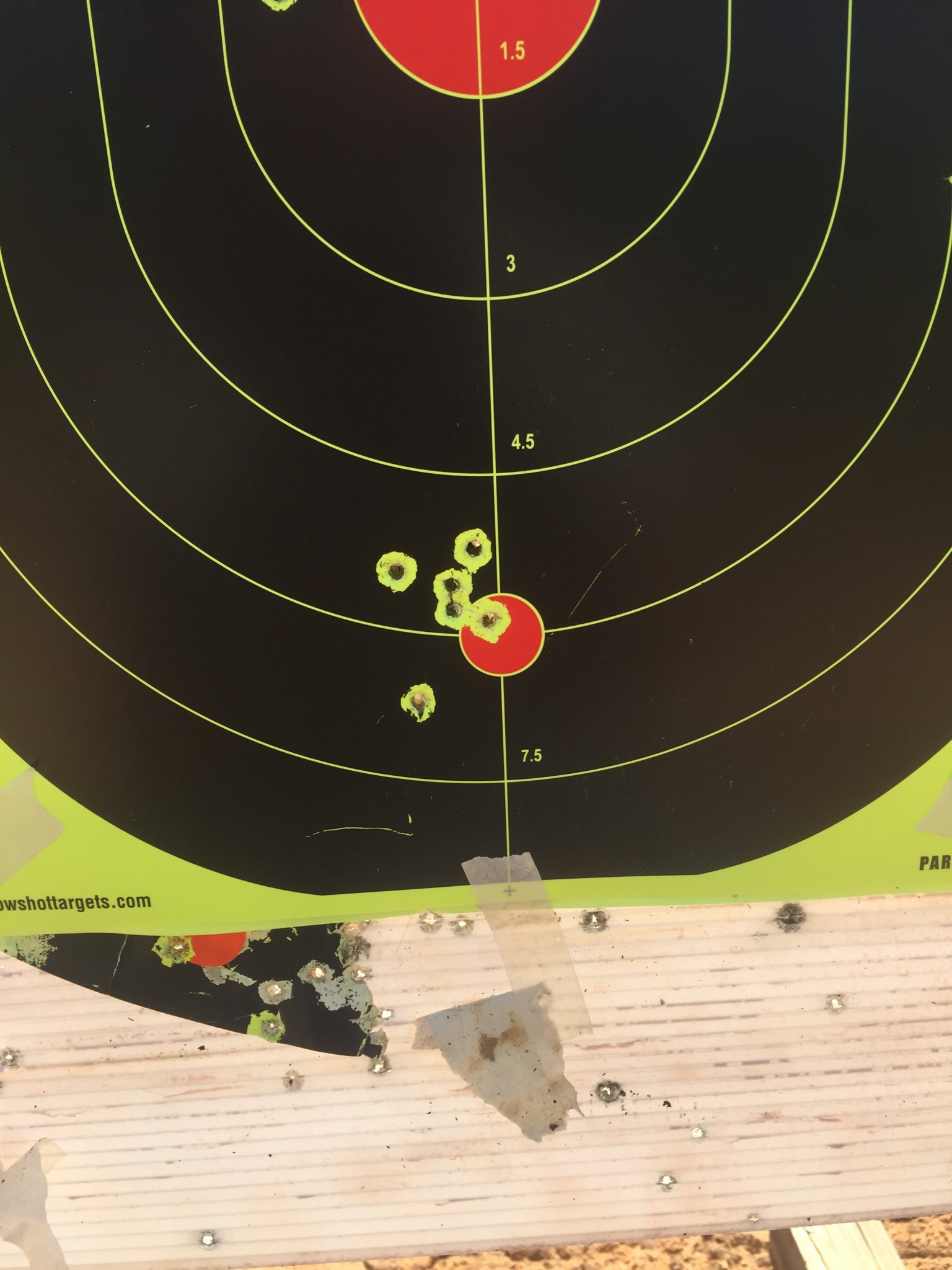

I gave up trying to wait for no/low wind. Had 12MPH winds with gusts to 18. First pic im on the 100 #16. You cant see wind flag in 2nd pic. 3rd pic center target was initial shots after I estimated wind and drop. Upper and lower, right and left, are 10 shot groups. 4th pic 3" target with 1/2" bullseye. All are 10 shot groups except top 3 and first target in second row which are 5 shot groups. All shot with TAC22. 5th target was left by a guy, the lowest hole was there, I put the 5 above it TAC22. 6th pic ARA target at 50yds. This is why I decided to shoot the 100. There are 2 flyers in these targets totally ammo related. These were shot with Eley Match. I installed a Jard trigger @4oz in the gun. That trigger is awesome and I recommend it. I probably should add that these examples were shot from a bipod. Im going to invest in a cheap bench rest to take me out of the mix. I dont want to buy a good one because Im not interested in bench shooting. Now if I can get a good one for cheap.....LOL

That is exactly what I was doing there. If you look at that square target in pic #3 I estimated drop and wind and the center square of that target was where my first shots landed. Couple more clicks to the left and I was on it. That is the main reason I got into 22LR. I realized that my scope knowledge was limited to deer hunting, making sure your zero was still good, hunting, and waiting for the next year. If I shot past my 100 zero I would use the reticle and Kentucky windage to make the shot. There is a place for that but I feel the correct way was to learn how to adjust the scope on the fly. I never even heard of bullet dope. Now I have a little book with different brands of bullets, MV's, and drops. I have learned so much in the last year and come to really realize and enjoy what the 22LR brings to you in knowledge. Centerfire hides imperfections in technique. Rimfire exposes them.

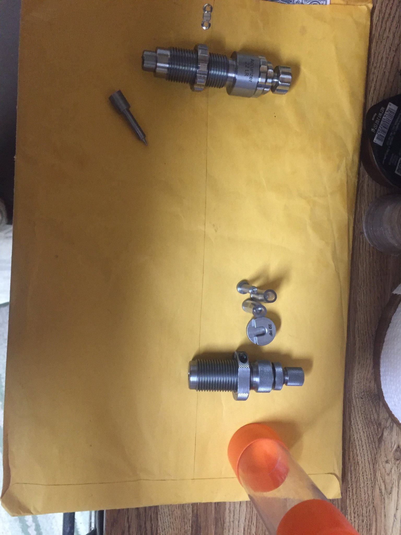

What are you using to reprofile ? Picture please
The only thing I have heard of is a Neal waltz sizing die ?
The Neal Waltz is the one that reprofiles them to .2255" diameter. I bought one from a guy in Norway off e-bay that is the same theory but slightly different in that it has a spring loaded sleeve that compresses with the bullet and actually helps with keeping it concentric. If you go to RFC and search reprofiling, does it work. I have pics of both of them. The Norway one is the one that makes them .2245" in diameter. I just found out that difference a few weeks ago and have been playing with them to see which ones certain guns favor. Sometimes less is more, know what I mean? I pulled them up and edited. The one on the top is Norway, bottom is Waltz

What chamber are you shooting this through ?
Did the cci sv load easier after reprofiling ?
Match chamber. Now that is one thing I noticed is they fit more snug. Im taking my LabRadar with me on the next run to get measurements. One thing I can tell you is according to my records, SD's drop drastically when I reprofile. That being said, just because they drop does not necessarily transfer to accuracy. There is also a drop in ES readings with a slight increase in MV readings. Many that have played with this state that high dollar rounds usually dont change much or for the better by reprofiling. The difference I came across is most high dollar rounds are 223.5 to 224.5 diameter slugs. Cheap rounds can go as low as 221. The most accurate, high dollar, rounds are 224.5 in most cases. I am just now starting to use the Norway die and really test it. Many that use these dies concentrate on how many turns of the adjustment and how it effects the accuracy. I started out that way and then switched to Overall Length which is way more of an accurate way to measure for consistency. If you press too big you have problems feeding semi auto guns with Benz chambers and even some standard chambers. Bolts will feed anything pretty much. One thing I will be doing next trip is, you saw the targets with Center X. Well they are shooting like garbage anyway so I reprofiled them to 960 with the Eley flat button tip and 224.5 finished diameter from 223.5 they started with and see if accuracy improves.
