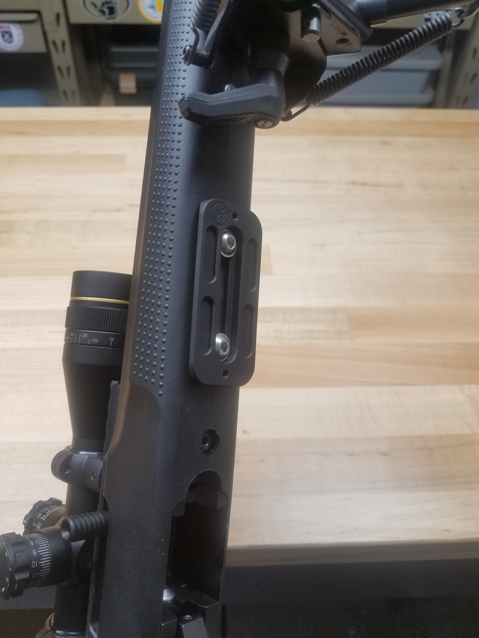

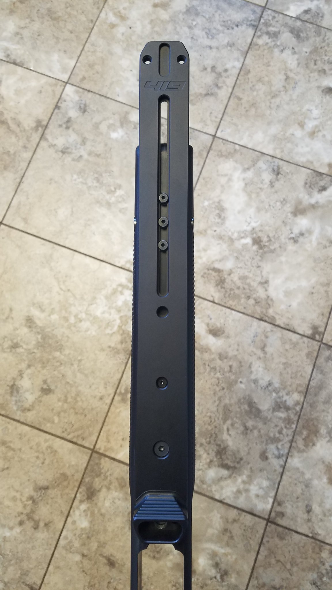

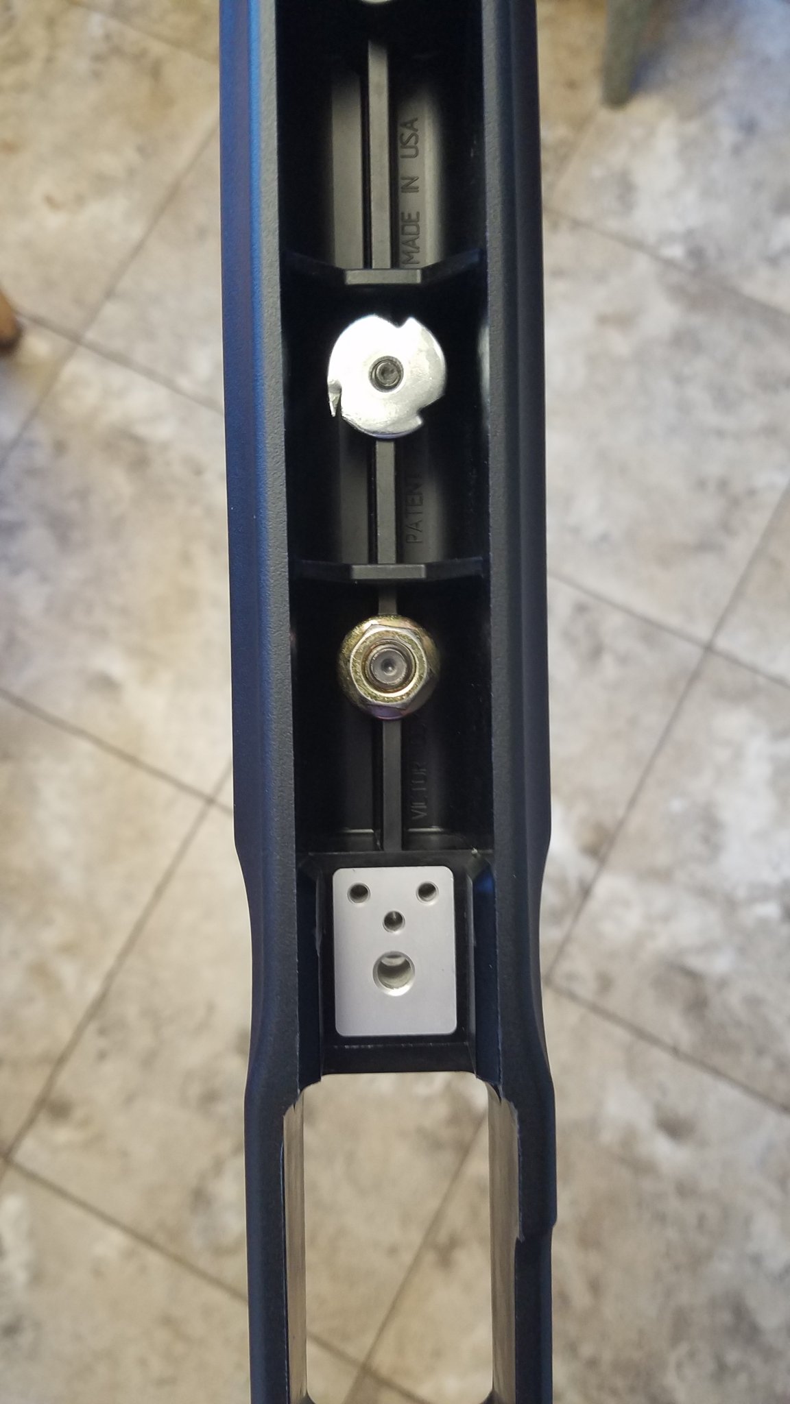

Has anyone added an arca rail to a Victor Co. stock?
I sanded the forearm "flat" and drilled several holes to install a universal Area 419 rail. It turned out OK, but has a little more flex/twist at the end than I had hoped. I think it needs to be bedded and have some epoxy added for support on the inside of the forearm, along with another bolt & t-nut.

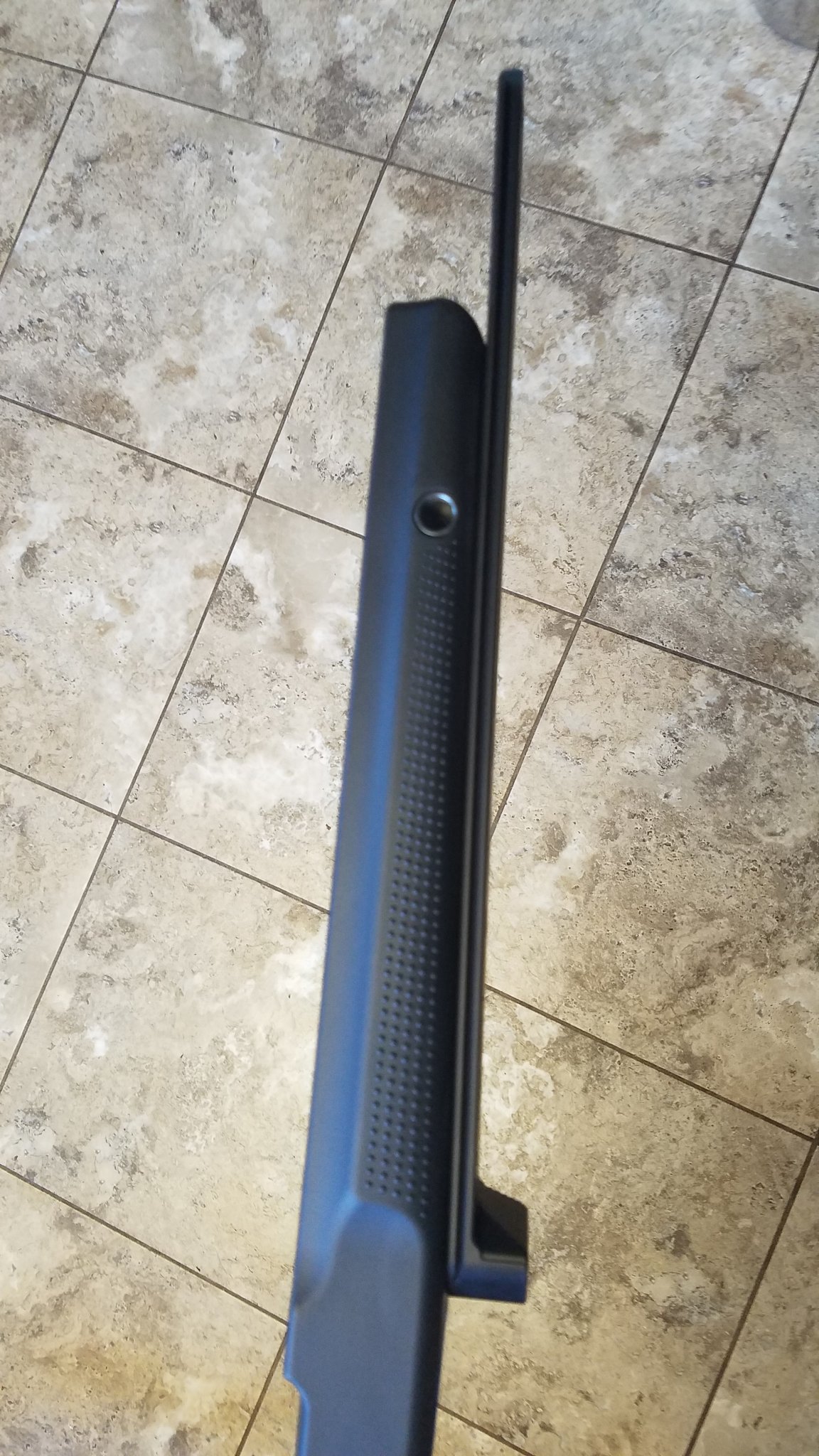

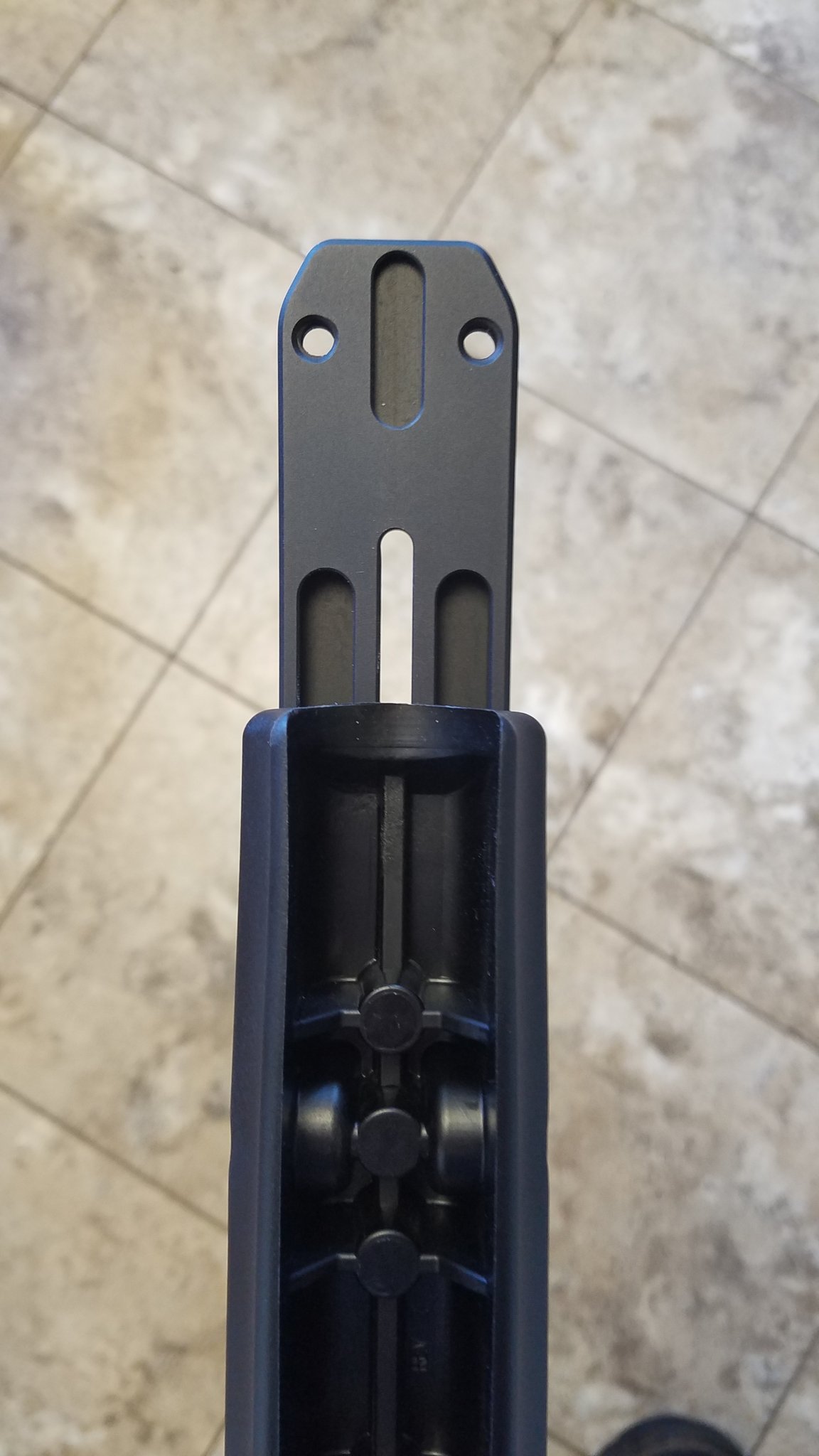

Hey Gents-
We just put together a kit to fully install Henderson's Precision 10" D ARCA Rail on our Titan Stock. The kit comes with pretty much everything you need to get the job done- you only need a power drill. It takes about 5-10 minutes and will solidly attach the D-Rail (ARCA) to your Titan 1022 stock. This will give you full use of any ARCA-Swiss Style Tripod or Bipod.
We sell the D Rail Install Kit with the 10" Henderson D Arca Rail and the attachment screws as a full package for $114.99
The individual D Rails with attachment screws are $94.99 each.
Here is a link to our buy page, we are still updating our main website:
https://shop.victorcompanyusa.com/10-HENDERSON-PRECISION-D-RAIL-INSTALLATION-KIT-DRAIL10.htm
Let me know if you have any questions,
Michael V.
