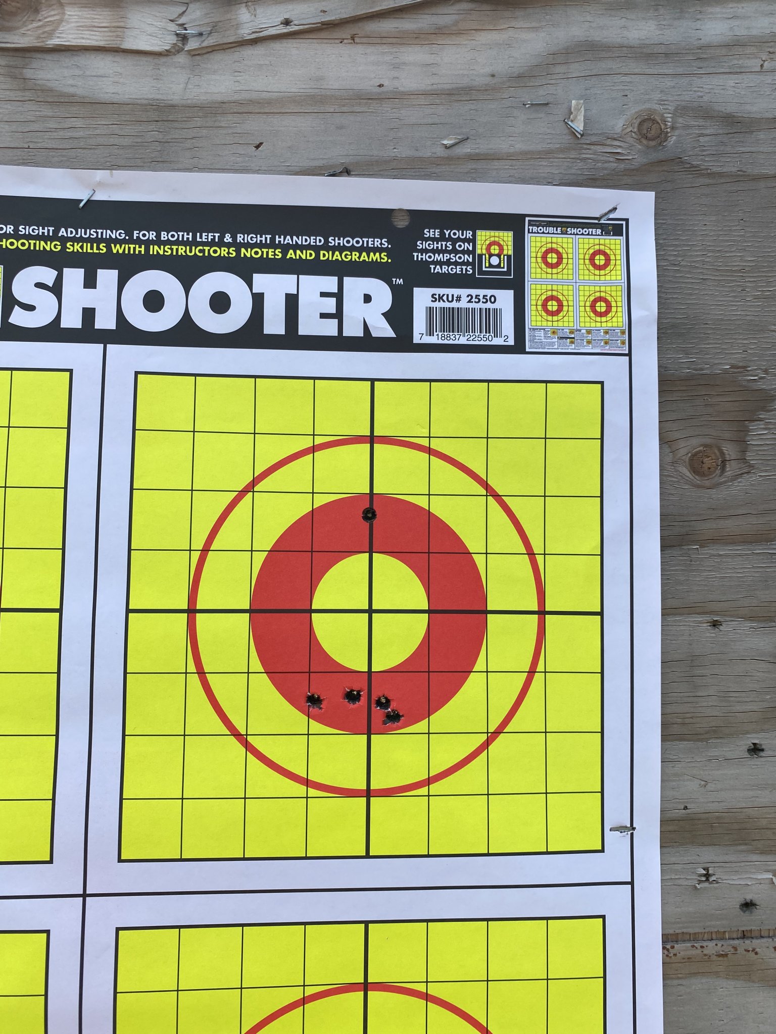

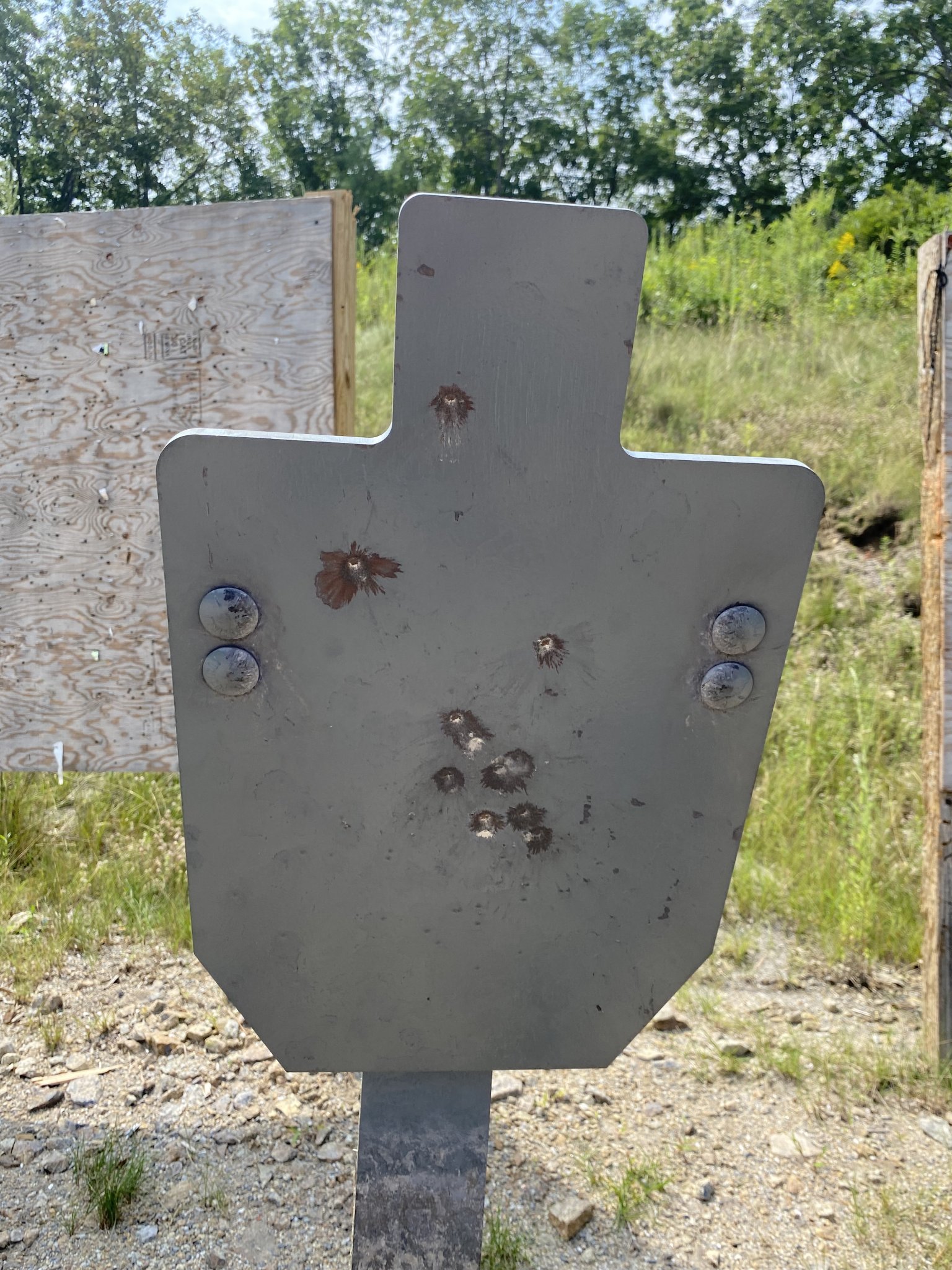

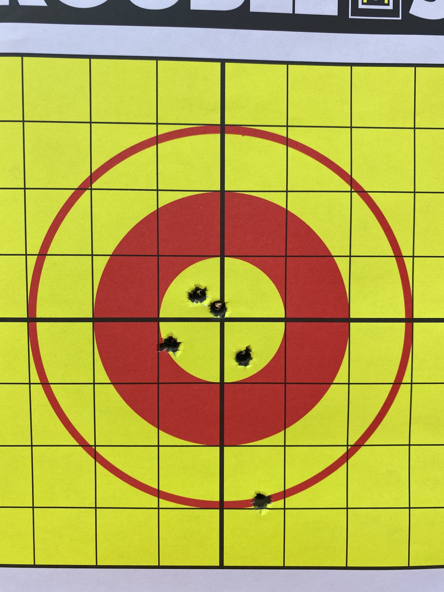

400 yards last weekend with the Lapua 139gr Scenario Al’s on top of 43.6 grains of Sta-Ball. Yup. I’m proud of that. First time shooting at distance with this weapon system…
Reactions: acudaowner
