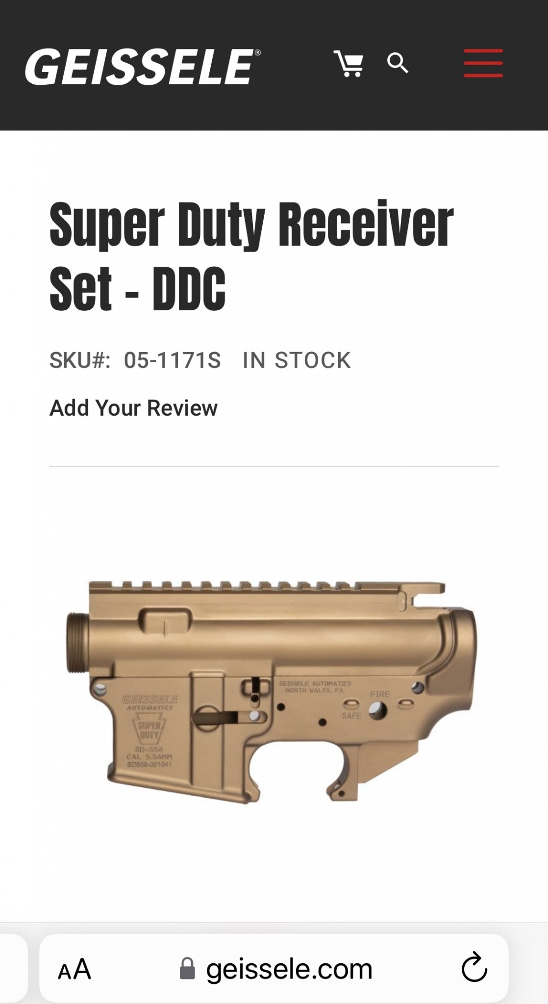

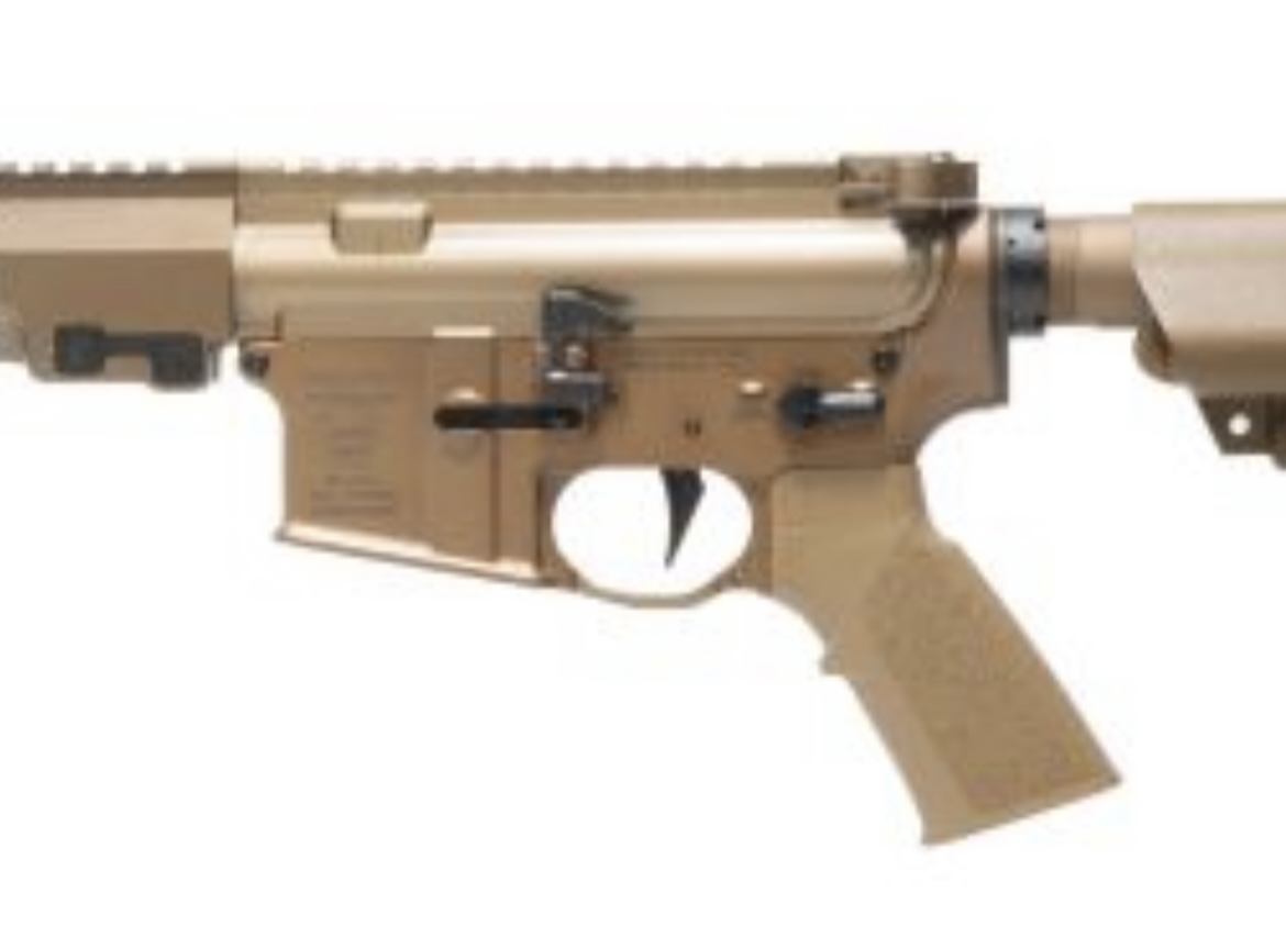

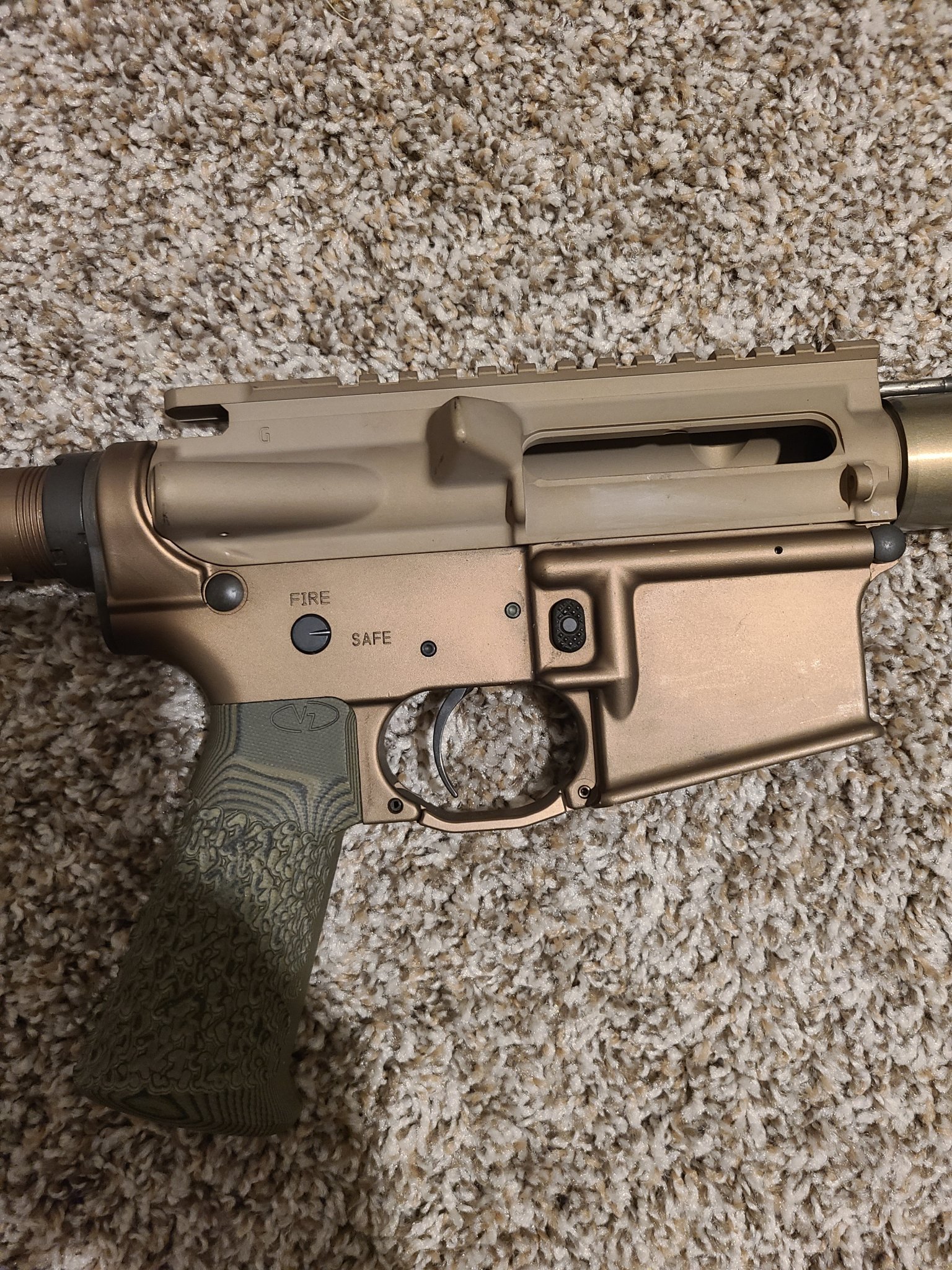

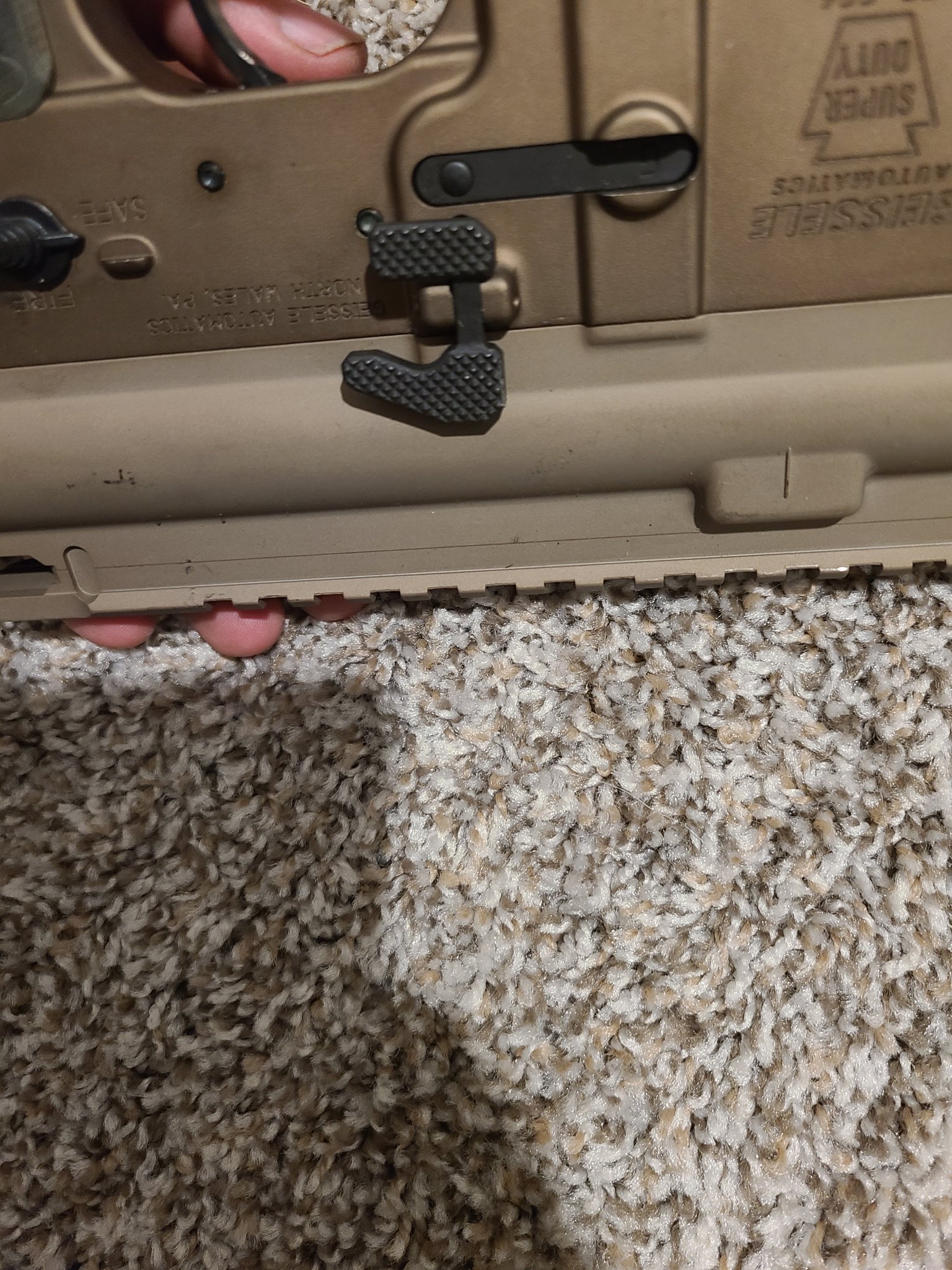

Has anyone bought anything ddc from geissele lately? I just got this G marked upper and aside from the color being more of a magpul fde, it doesn't have the slick/hard finish the ddc lower in the photo has.

That's how it came from G, looks coated to me too. I know they talk about the anodizing process producing different shades but none of my ddc stuff is anywhere close to looking like that upper

People have been recently complaining that parts have arrived chalky from G. Try oiling it. Might make it better.
I think it has to do with long term storage and petro chems for contracts. KAC does the same thing with their stuff sealed in bags. It is so dry its almost like chalk, but rub a little oil on it and it comes back to life.

could also be that the upper and lower are different alloys and therefore the coating will have a variation? 6061 vs 7075? Geissele only says the lower is 7075, they dont say whether the upper is milled or forged and i dont have one to look at and see. I would assume they are milled but i could be wrong.
They are forged uppers. Not sure if they do them in house or farm out the work.

pretty sure the same 2 or 3 forging houses do every lower and upper in the country.
Raw forgings have to be finished. Finishing is where the magic happens and what separates the really good forged uppers (KAC, BCM) vs the rest of the commercial stuff even if they use the same raw forgings.
BCM had to bring their upper finishing in house to cut down on rejects many years ago. Most places that make AR parts are just machine shops and the quality is all over the place.

I recently ordered a receiver set from them in OD. Color on the upper vs lower was quite different - it’s fine. When you order you have to check a box that states:
” I have read and understood the "Anodize Shade Variations and Finish Methods" notice linked on "Notes" section of this page.”
Here’s the link - they are very up front about color variations.
https://geissele.com/anodize-shade-variations-and-finish-methods
