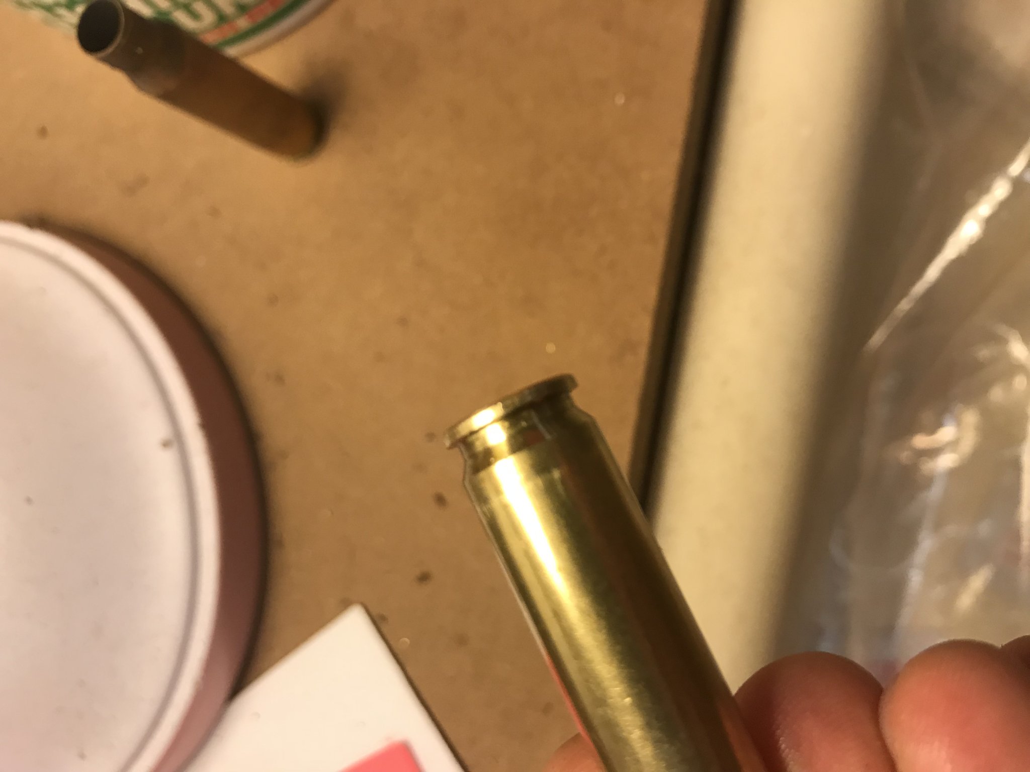

Below is reference of how far down the case the sizing is getting. This is at 1/4 turn past touching shell plate. Per the tech when I called, he stated you should not have to run more than 1/4 turn past the die meeting the shell plate. Somewhat Moderate cam over at that point.

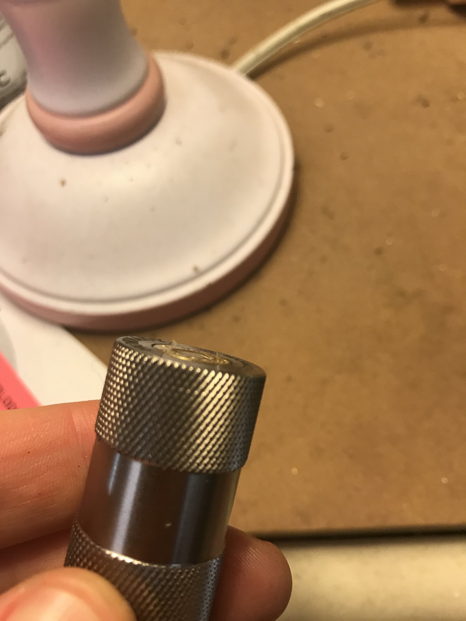

This is how this case gauges in my Hornady case gauge
I can continue to sink the die a bit lower until cam over gets to be harder. At that point I give up and don't want to pressure the press etc... more. The base of the shell doesn't look much different, but the case will gage better, but as u can see still quite a way from flush.

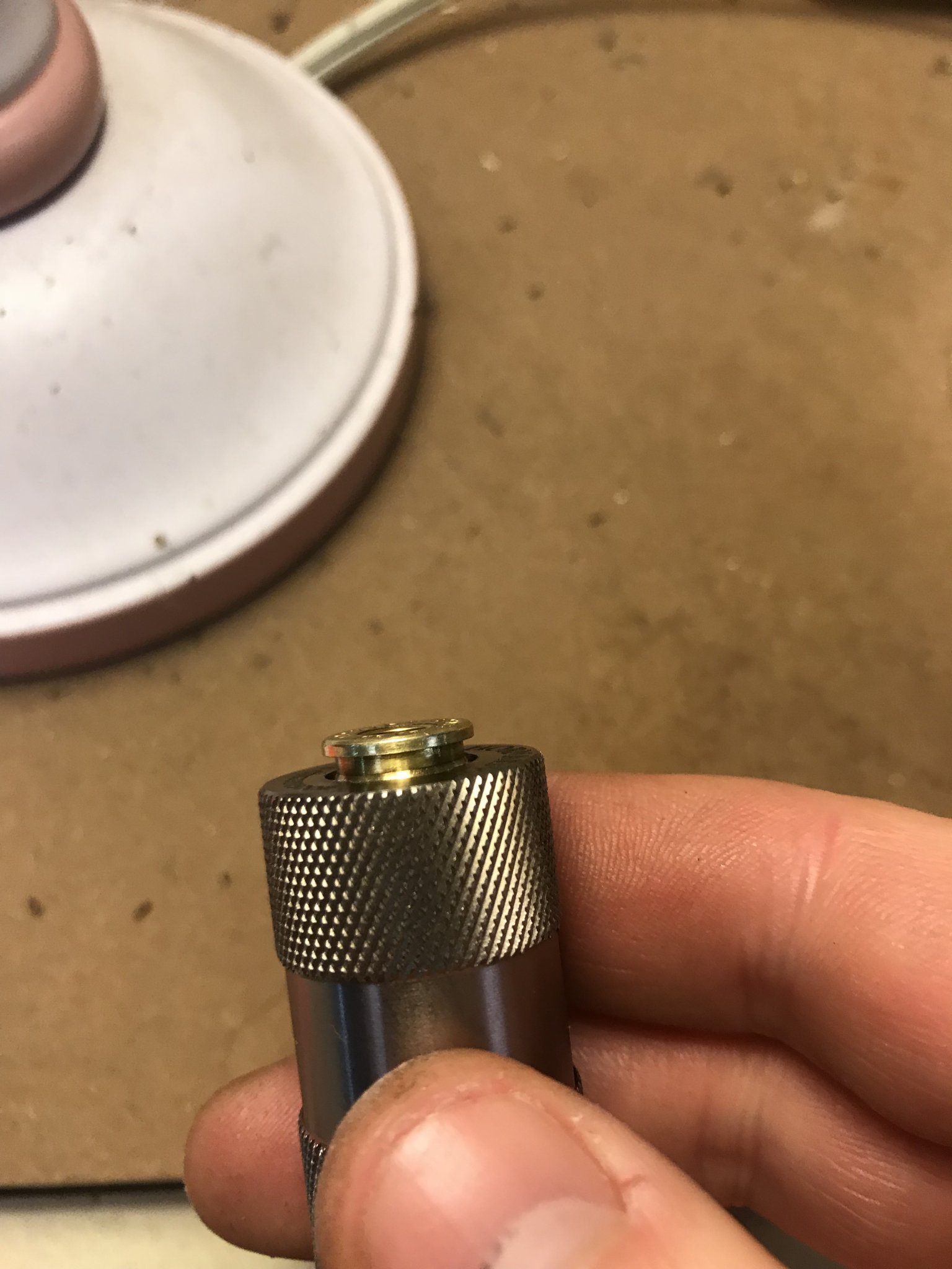

For reference, a new piece of starline brass just to make sure the gauge wasn't faulty etc...

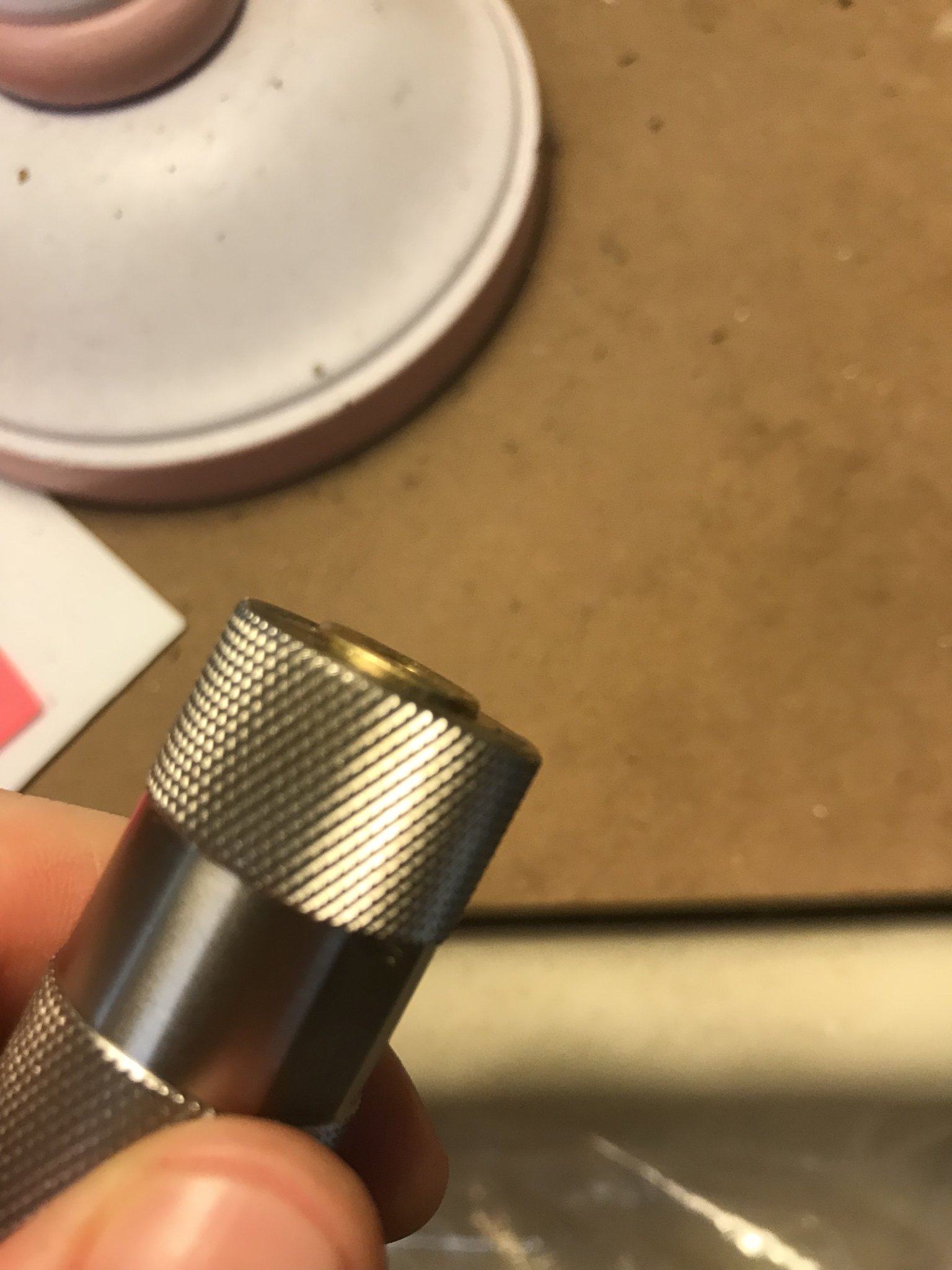

Also, just to confirm I wasn't over bumping/crushing the shoulder, I backed the die out 1/2 turn from touching shell plate and with another set of once fired, cleaned, brass I put them through the die. This was not the fix as I needed to keep lowering the die to get any sizing done, but was able to see with successive adjustments the process of the die coming down the neck and eventually getting to the shoulder. The point at which the die started to hit the shoulder was a little past or approximately 1/4 turn past touching the shell plate. FYI in case people thought I may have been crushing the shell in the process etc...
