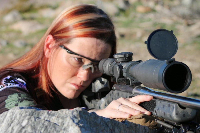

Thanks very much for the response. To be fair, I see some PRS competitors shooting with their ears level. But a LOT of them, including match winners and presumably well-trained military/LE snipers and instructors, do rest their head on the stock.
I'm aware that there are athletes in all sports who excel despite their "poor form". So to be clear, are you saying that that's what I'm seeing in, for example, this photo of a PRS match winner? I'm asking because what feels most comfortable to me is to tilt my head about as much as the shooter in the photo is, and I haven't been able to adjust my cheekpiece to let me keep my head much more vertical than that. So if it really is important, I'll see if I can modify or replace the cheekpiece.
That picture is oooolllllldddddddddd and from photo shoot. I didn't know much about fundamentals and natural point of aim back then. These days I don't have that much cant in my head whether I'm prone or not. It took a lot of dry fire to figure out, but when I adjusted the cheek piece on my McMillan A3-5 and A-6 laterally to give my face more room, I found that I could drop down repeatedly without leaning to one side for a clear sight picture (if I have to shoot support side, I drop the cheek piece completely). I don't know what magic unicorn dust Terry Cross puts on KMW's but I haven't had to take any new approach for the Sentinel I have.
Haha, thanks for responding, Regina.
Wasn't trying to call you out specifically; yours was just the first photo I found of a winning competitive shooter with head canted.

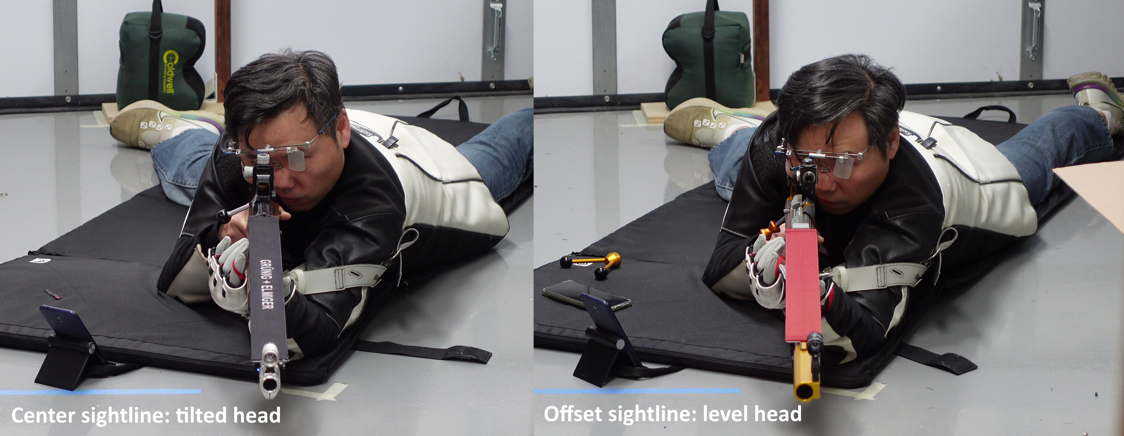

I know this is a very old thread but, I do have some additional information to contribute.
The question was: why Olympic shooters generally keep their heads more level than long-range shooters.
The essential difference is that Olympic shooters are shooting smallbore rifles, and long-range shooters shoot centerfire rifles. Smallbore rifles have very short bolts that do not impede the range of adjustment of the cheekpiece. This allows the cheekpiece to be adjusted laterally, and they are able to achieve a very level head position as a result.
(It must be noted that not all top level smallbore shooters have level head positions. Some of the best shooters in history shoot with their heads tilted.)
Centerfire rifles, on the other hand, have long bolts that intrude into the cheekpiece when withdrawn. This limits the range of adjustability of the cheekpiece (if it's adjustable at all laterally); it cannot be moved rightward enough (for a right-handed shooter), to achieve that level head position. Therefore, most centerfire shooters shoot with a canted head.
But there is a solution to overcome this problem for centerfire rifles. Many Swiss-made 300-meter rifles, most famously those by Tanner, feature sights that are offset 10-13mm to the left (for the right-hand shooter). See picture. Moving the sight line to the right has the same effect as moving the cheekpiece to the left: the shooter's head can now be held level, just like in smallbore rifles.
That said, are there advantages to a level head in prone shooting? I think there are several:
- Your head and neck are in a more natural, less stressed position.
- Your face is better supported by the cheekpiece. This makes for more a consistent head position from shot to shot.
- You don't need to move your head nearly as much when cycling the bolt, since it's further away from the bolt. This is more of a factor for sling shooters since they tend to be much closer to the action than PRS guys, in order to make it easier to single feed, and for better front-aft balance.
- If you wear glasses or a shooting lens for astigmatism correction, and the orientation of the lens is designed for a level head, the correction will be off when you tilt your head in position. This is because of a phenomenon called "ocular counter-roll", in which your eyeball self-levels when your head tilts. Your lens has tilted along with the head, but your eyeball remains level, thus throwing off the alignment of the lens to the eye. By keeping the head level in position, it's no longer a problem.
