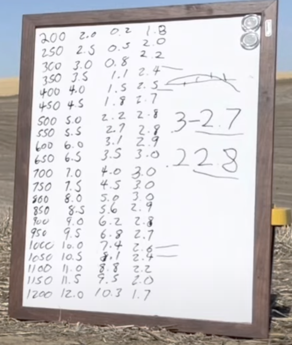

2) SPEED DROP FACTOR
my grasp is that, first of all you have to have your own dope already
at each yardage, divide by 100, you then subtract your dope from that.
you then some how pick one of those numbers and decide what is your tolerable error limit (0.3, 0.2, 0.1)
you then subtract that error limit from the (almost speed drop factor) and dial UNDER that amount, THAT is then your SPEED DROP NUMBER
and this lets your range your target, and simply dial that number to target (I think)
this is from mountains, mullets, America, on YouTube
seems quicker, but is it as accurate as using actual dope?

Speed Drop Factor is a way of aligning your turret to your data to save time on the clock. It works as well, but must be trued to your weapon system.
