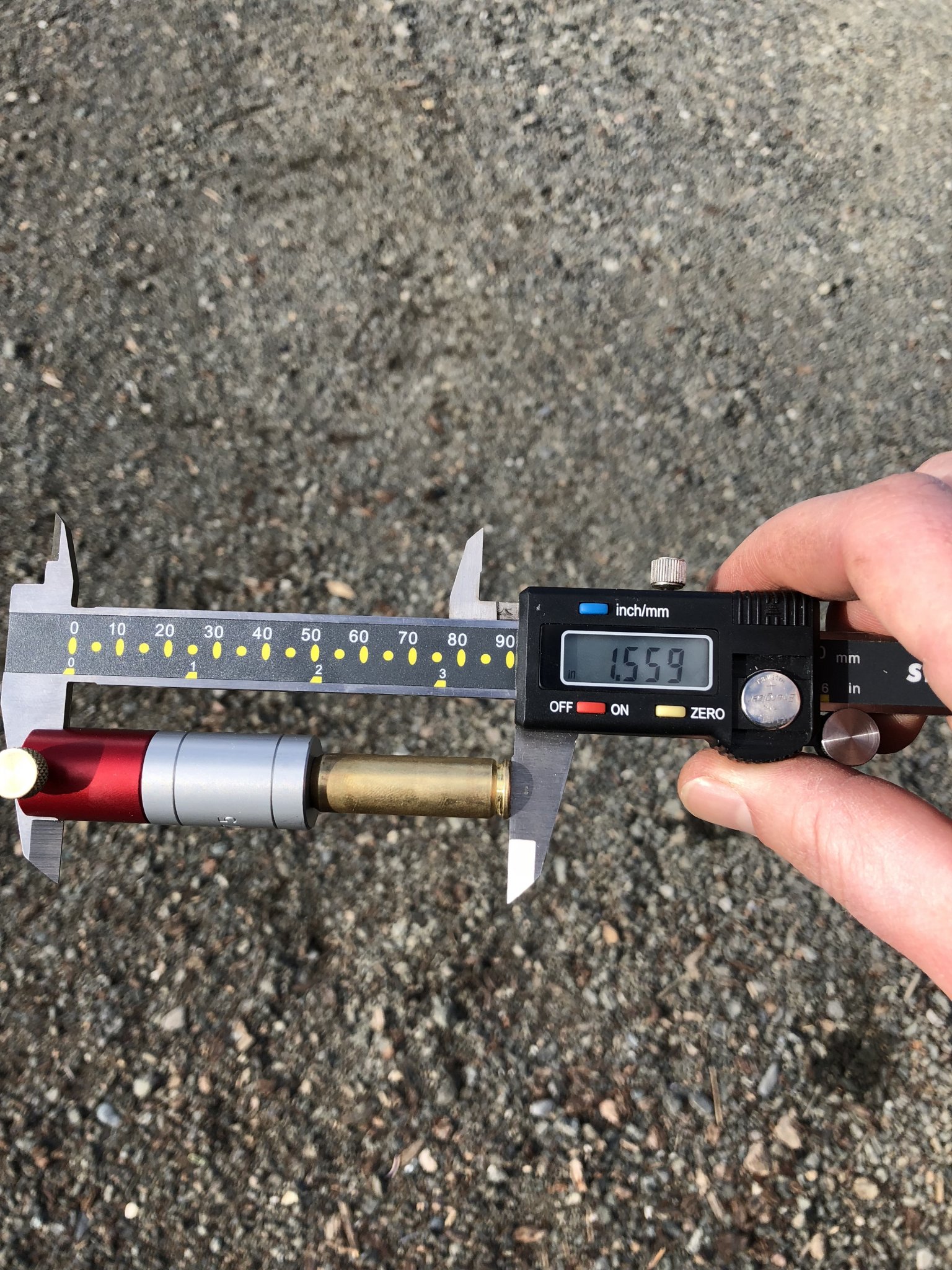

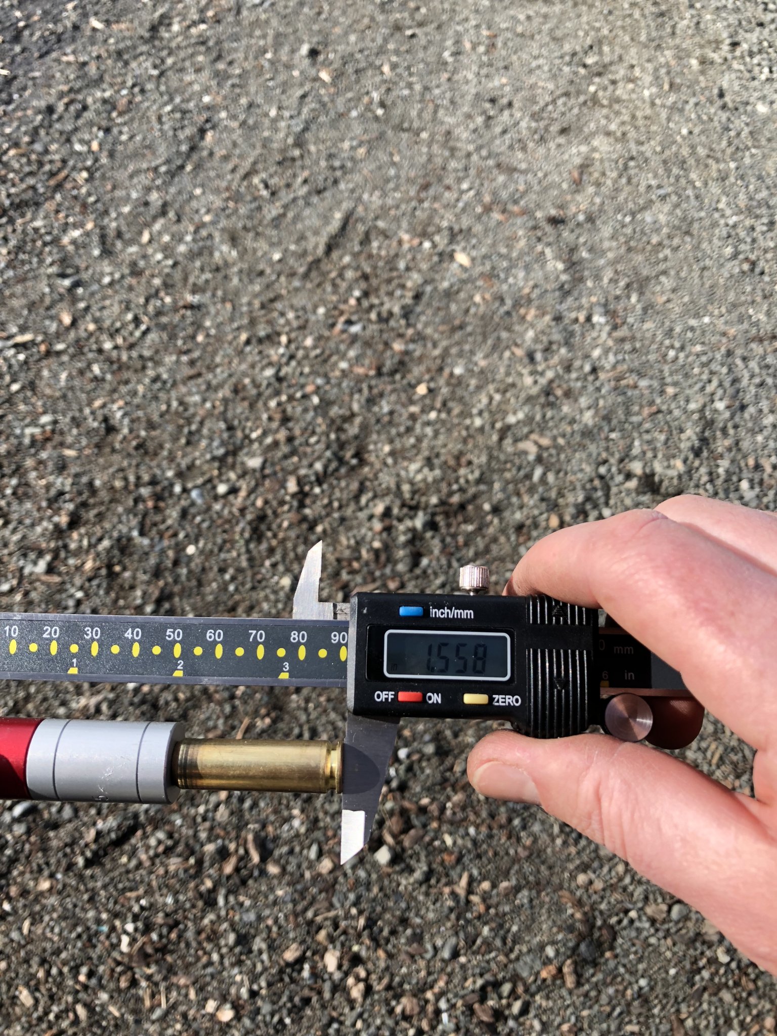

Alright, at some point you guys might get sick of my questions about reloading but I keep banging my head on this one!
So I bought some tools to get more precise reloading. This included a Redding Type S die and Hornady comparator, plus headspace gauge bushing. I bought the C or .375 bushing for my 6.5 CM. I read that the D/.400 and the C/.375 works.
I also got a set of Redding #1 competition shellholders. I’m basically going off the sticky on this forum that outlines the process of precision reloading.
I put my bushing in the die, screw it down until it hits the shellholder starting with the .010 shellholder.
I check my shot brass and get an average neck reading of 1.559”. So I run my brass through the die and it comes back with the same reading. Then I run through ALL the shellholders in succession until I’m down to my .002 holder. The best I can get my neck reading down is 1.558”. That’s not .002 off from my fires cases so now what?
I screwed the die in about 1/4 turn and it hasn’t changed.
Wrong gauge? Screw the die down more?
I’m screwing something up, but not sure what!!!!
This is driving me nuts.
Thanks!

First things first. You bumped the shoulder .001, yes? 1.559 down to 1.558? You’re done! Nothing else needed. .002 is a general guideline. It could be .00075, or .0011576...doesn’t matter. .001-.002 is a good area to be in.
Now, if you must have more, put the standard shell holder back in, which would theoretically give you another .002 worth of bump. So you’d end up with 1.556. In practice, you’ll probably end up with 1.5565 or so. Do make sure that 1.559 is correct, and that represents a piece of brass that has full grown to your chamber. It is possible that your chamber is actually longer, but a softish load doesn’t push the shoulder all the way out.
Understand, you’re working with multiple sets of tolerances here. A longer chamber(producing longer fired cases), would have you working with the longer shellholders, and vice versa for shorter chambers(what you’re expereincing now). since you have a savage, you could actually adjust this(don’t do that). You’re on the good end of things now.
Load em’ up!
