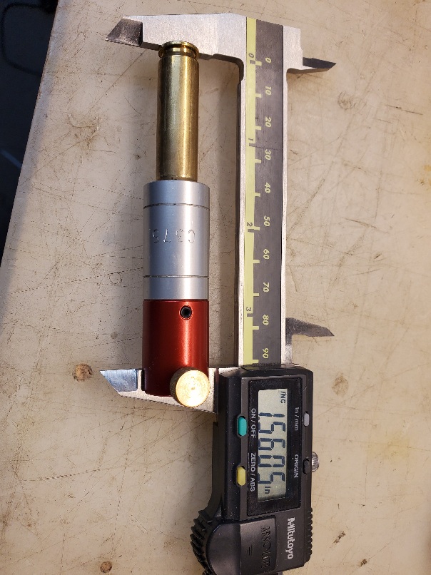

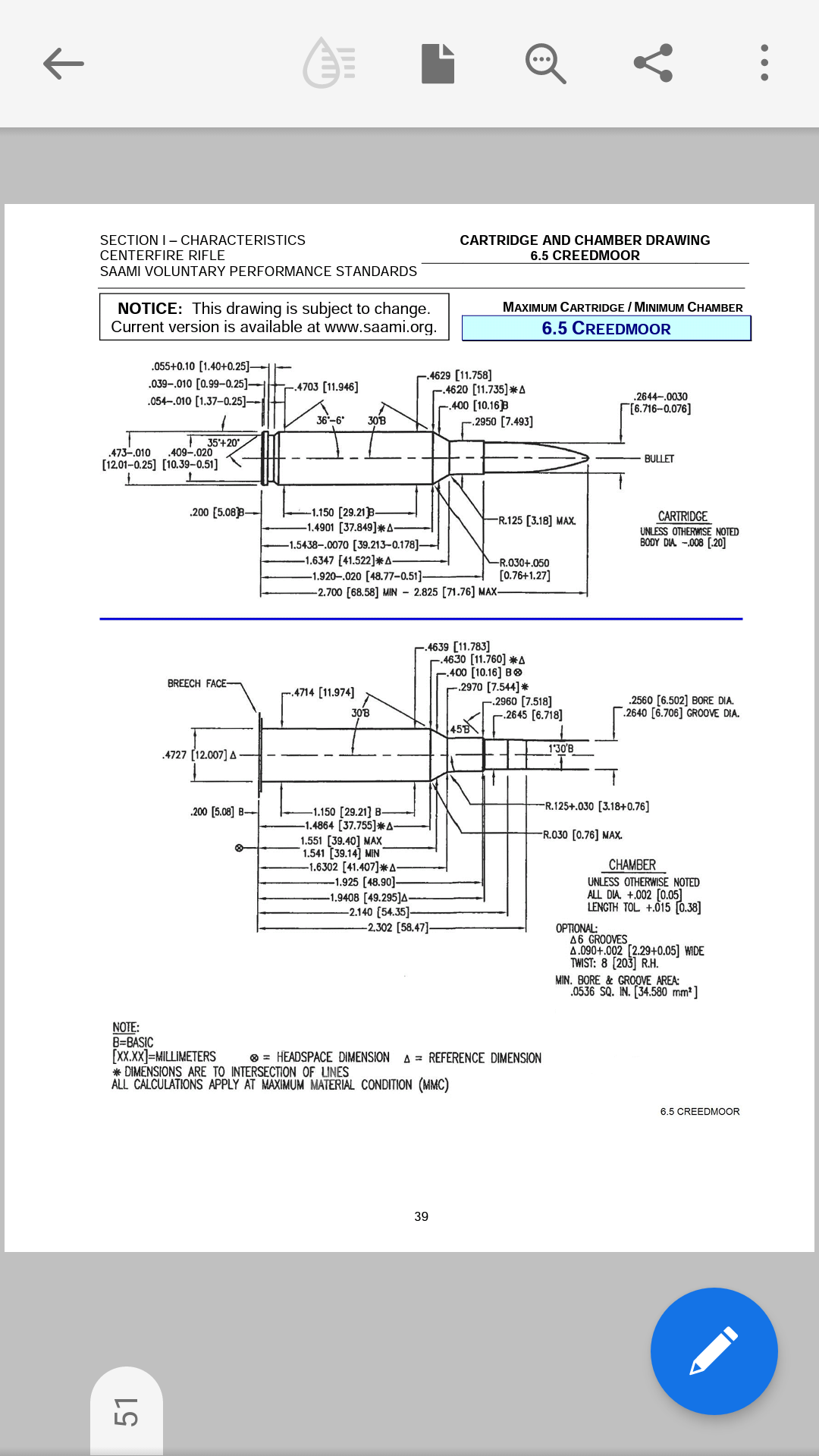

I think. 6.5CM. A new case is my "zero". A fired case is only .002 bigger than the brand new case. A fired, sized case is only .001 bigger than a brand new case and .001 smaller then a fired case. Sounds sweet right? Until I get 1 out of 3 that are hard to chamber. Would it fix the problem if I took .002 off the top of the shell holder so it would push the case up .002 higher? AND...I am not measuring the shoulder on the .400 datum line. I dont know what the bore is of the "comparitor" that i have but as long as I use the same tool on all the cases does it have to be measured on the .400 datum line?
It's really difficult to get consistent shoulder bumps if you're not properly annealing every firing as the springback of unannealed brass can result in what you're experiencing.
The ones that are hard to chamber, have you measured the headspace measurement on those as well? You may not be getting consistent enough to run only 1k of bump.
Re: measuring - It doesn't have to be exactly on the datum. As long as you are using the same comparator, you'll get a measurement that's good enough for what we use it for- Comparing.

Thank you for posting this - been looking for a SAAMI cartridge and chamber drawings for the 6.5 CMoor...I have a Proof SS petit for my AXMC and in a discussion with proof, they advised their chambers are on the short side; my fired case CH- Shoulder is 1.554 using Hornady’s headspace gauge.
@105gr - what are you using to measure your fired case case headspace? Can you post a pic? Just curious what you’re using...
Its a home made CBTO comparitor insert I was using for my 338. So the bore is probably around .336
I wonder what your measurement would be if you used the Hornady tool.
I size mine to 1.551”, measured using the Hornady tool...FGMM 130 Berger chambers with resistance and have to crank down on the bolt to get them in there...They all measure 1.554/1.555 as factory new. At 1.551” I get only a slight hint of resistance to no resistance. 1.552” a tad more resistance. Resistance starts to become real noticeable at 1.553”+.
Not sure if any of that helps you but perhaps your chamber is on the shorter side of SAAMI like mine.
