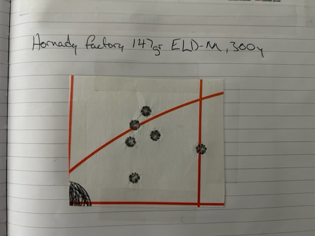

So basically, none of those bullets are too deep into that case to start screwing with shot group size then, correct? Is that what I'm gathering?
She groups pretty well with that load?
I found this in my reloading notebook. The squares are 3” wide…
Truth be told, that’s from a bolt action- a Ruger precision rifle, shot prone from a bipod and a fortune cookie, with a vortex razor gen 1 5-25. But, it was fed from a Magpul pmag. And, that ammo is money in a 6.5 creedmoor lr-308 that I built for my dad, but I don’t have any groups from it.
Federal gold medal berger (130 gr) also shoots great and fits in a pmag.
All that is to say that you shouldn’t feel constrained by loading to mag length in a large frame AR.
