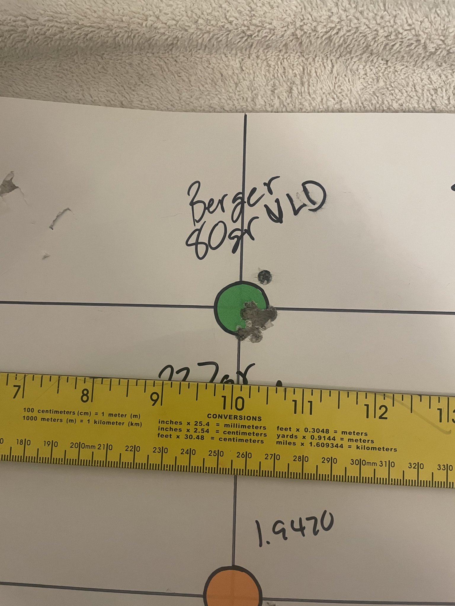

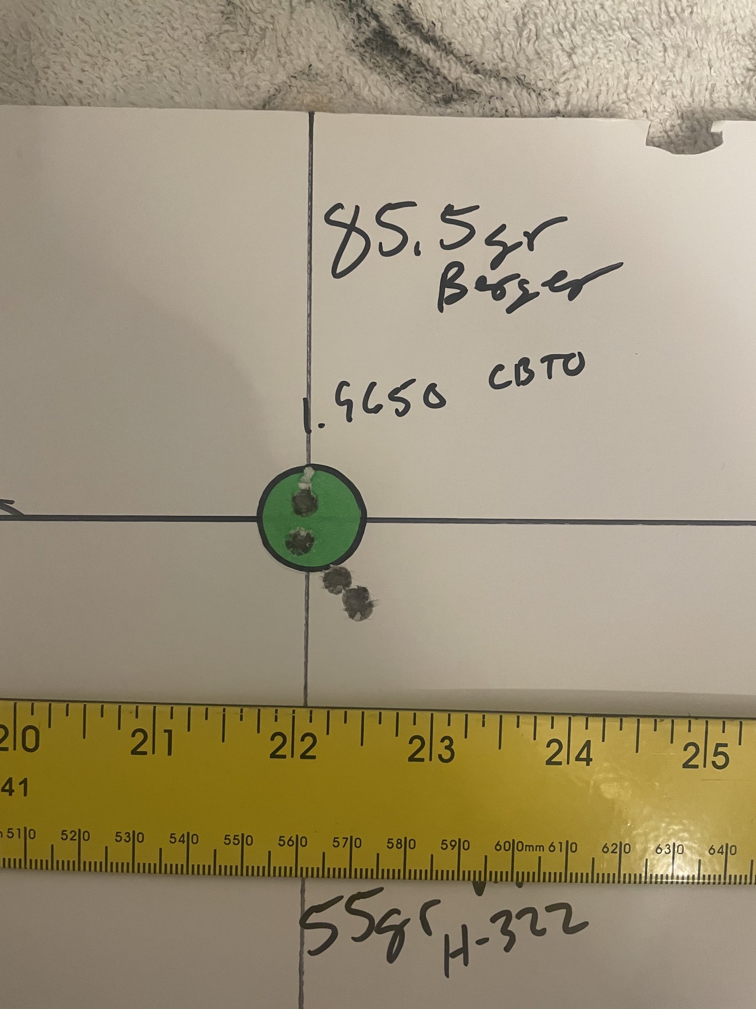

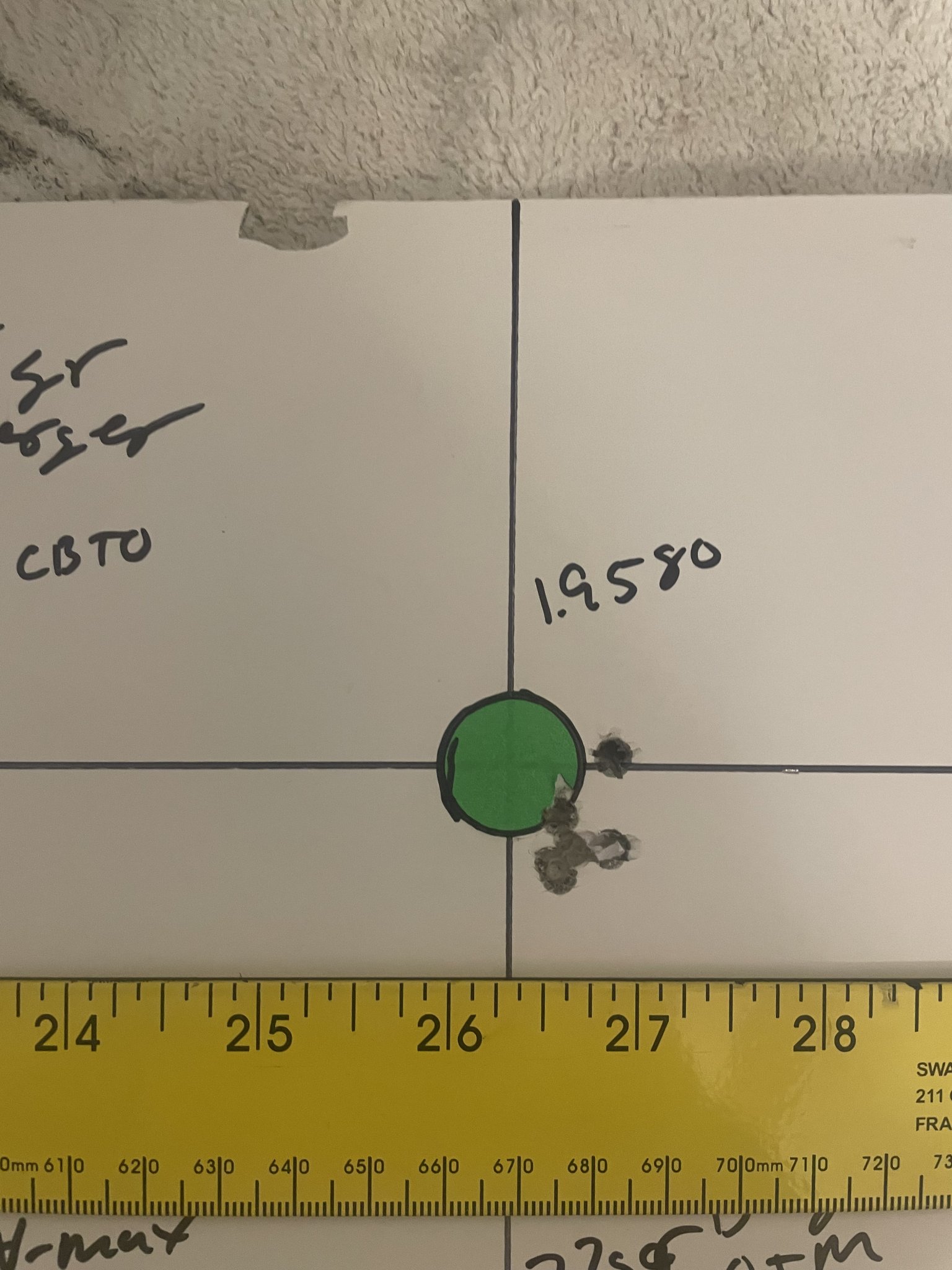

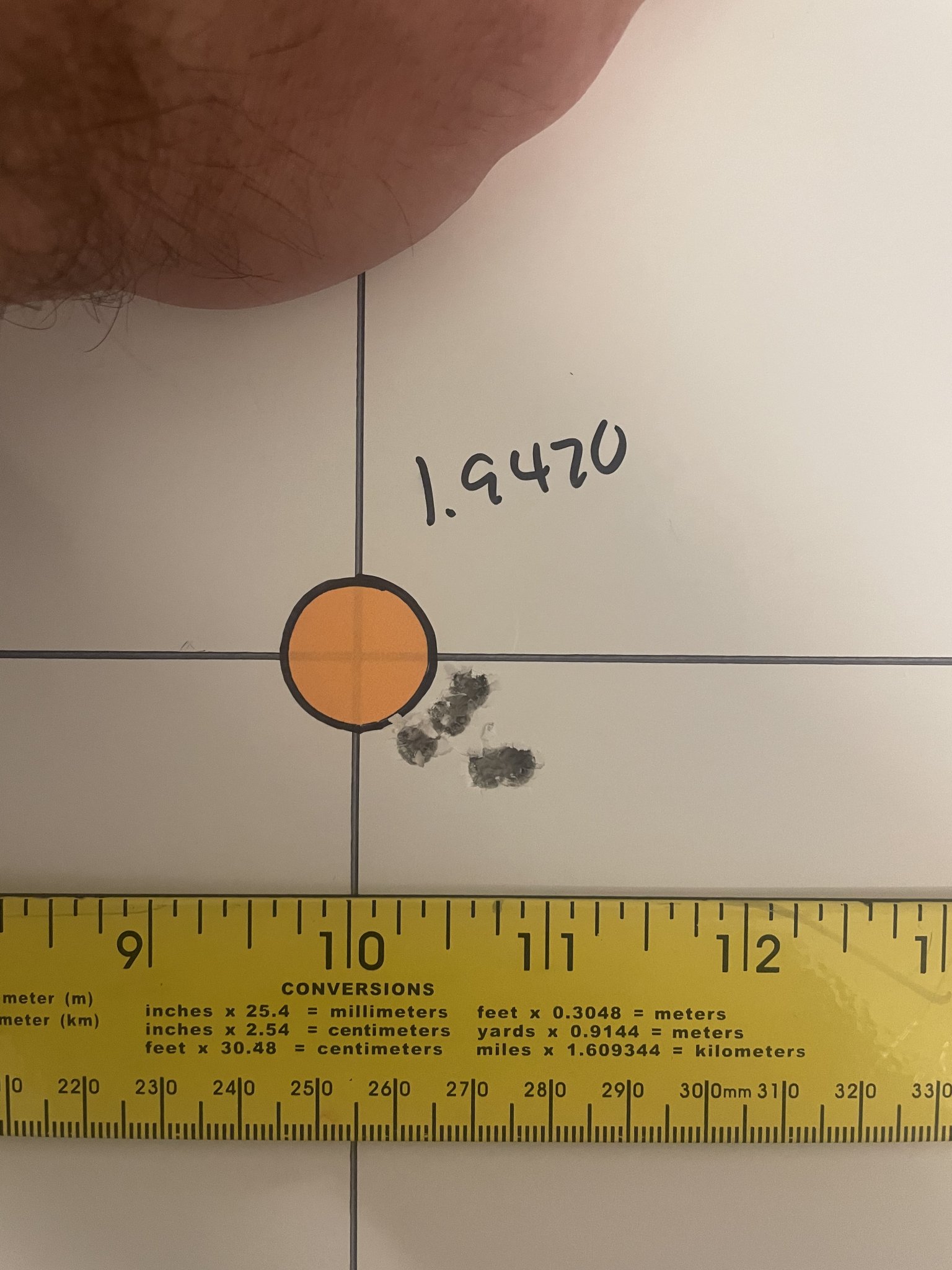

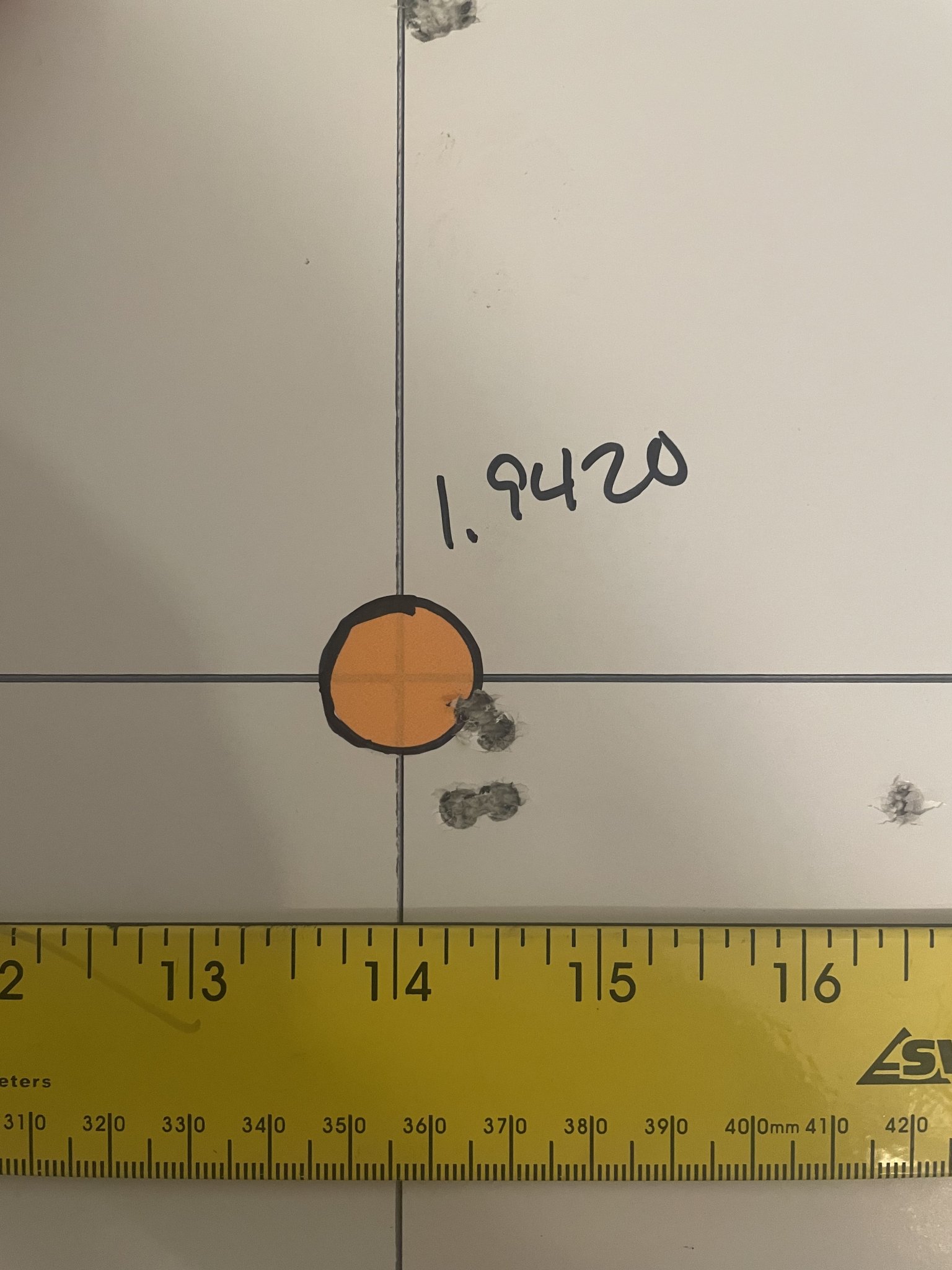

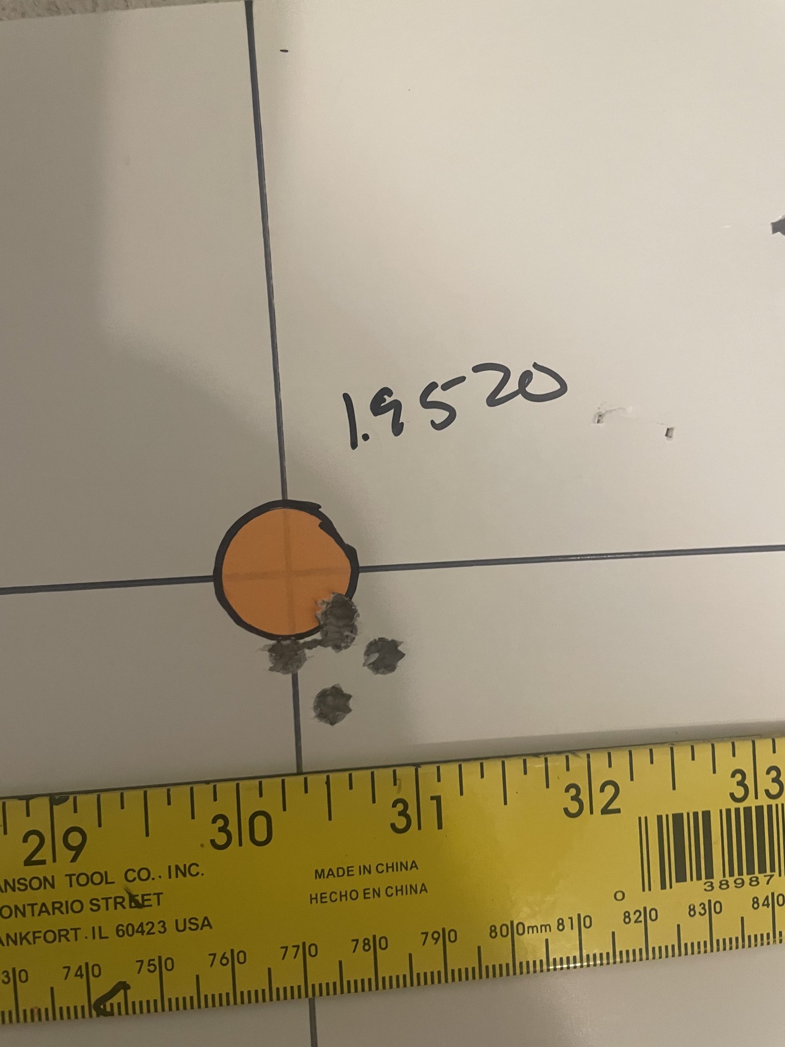

So some results so far. I started by picking a speed I wanted to achieve then adjusted seating depth on the 85.5gr Berger. 5 shot groups

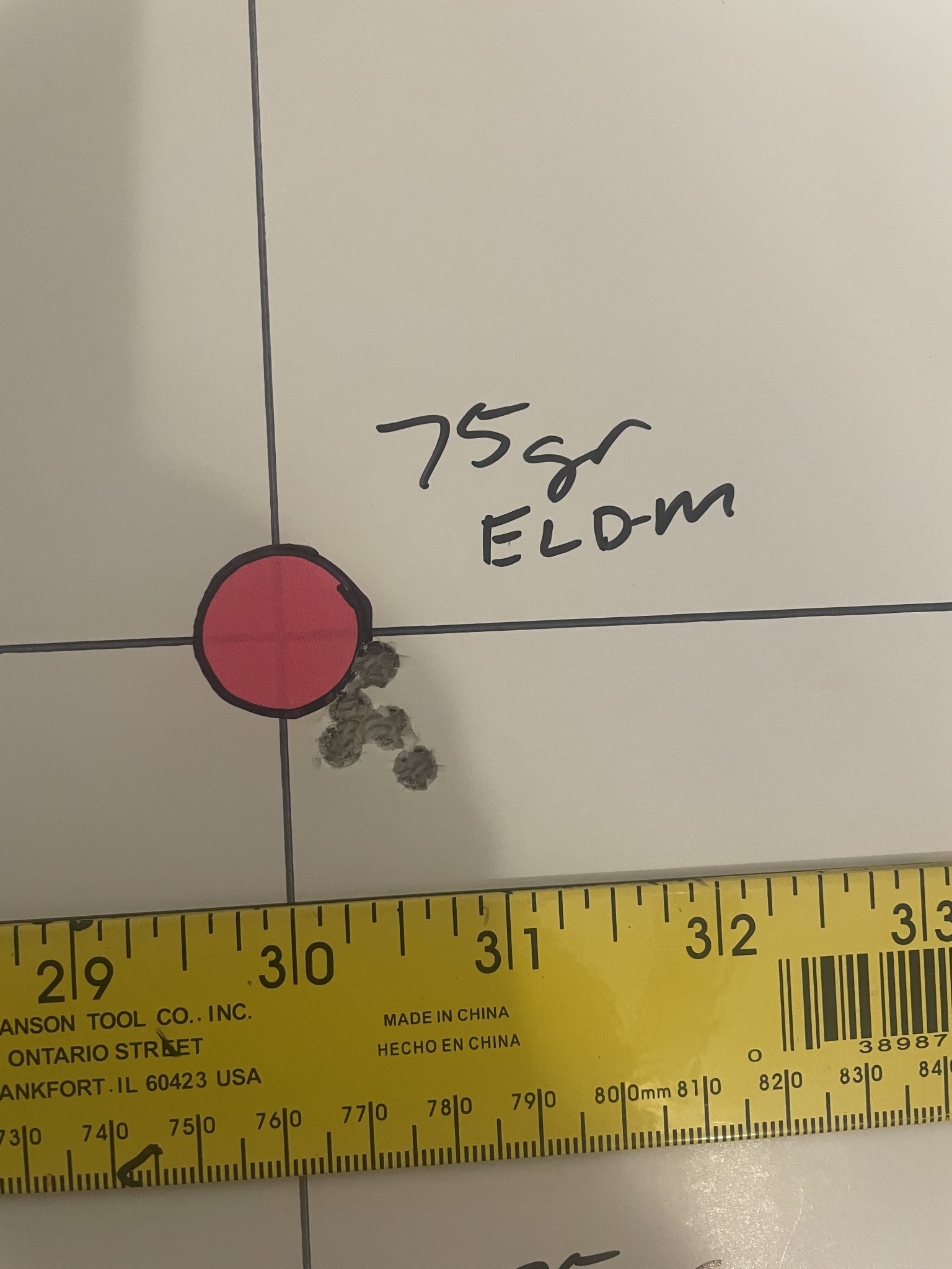

I haven’t started playing with the 80gr yet. Just picked a speed and saw how it shot. The first shot out of the group on the 80’s was the cold bore shot. It’s a 10 shot group.
