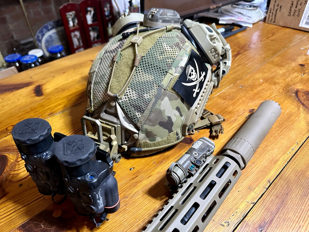

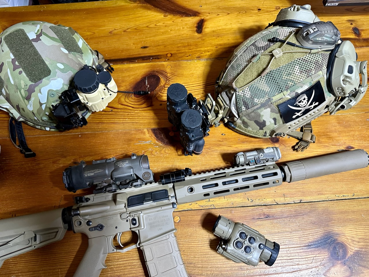

    This is what you seek.
    It’s a smidge higher than $20K. About $35K tied up in that lid with dual Skeets.
    The Jerry-F fusion monocular (what’s on the other lid) is actually very good, now that I have it dialed in and know how to get the best out of it. I have a >2800 FOM L3 WP tube installed (thanks to Jay at SSNV). That’s a VERY solid option and the outlay for that setup was under $15K. Only downside is the mount feels cheap and it’s a likely failure point if you’re rough on gear. I’m a dainty little girl, so my stuff gets babied.
    I just took those photos all for you, brother. Between those two buckets and the gun and other accessories, it’s pushing $100K.
