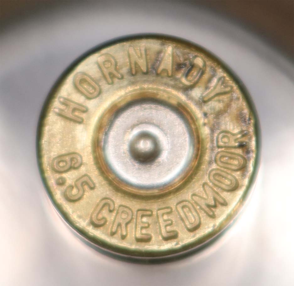

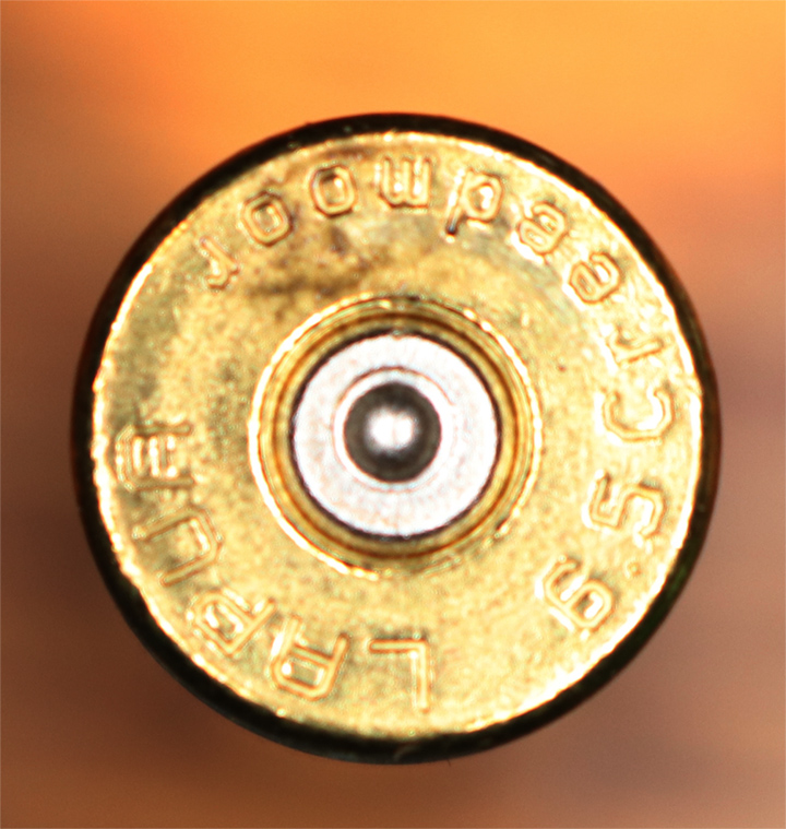

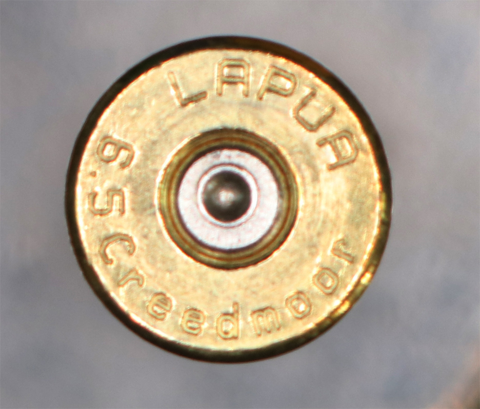

1. Hornady 140 gn ELD with 39.5gn IMR 4350 loaded to 2.80
2. Hornady 123 gn ELD with 36gns of Varget loaded to 2.80
3. once fired Hornady case 140gn ELD loaded to 2.80

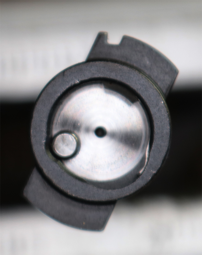

Cratering is caused by a firing pin hole on the order of .080". Contrary to some belief, it isn't a loose fitting firing pin. When a modern high pressure round goes off, the pressure extrudes the brass from the primer into the firing pin hole. It just pushes the firing pin up out of the way.
The force extruding the brass is equal to the product of the internal pressure and the area of the firing pin hole. since area goes as diameter squared, reducing the diameter of the firing pin hole significantly reduces the force acting on the brass. It also reduces the distance that the brass has to span across the hole.
Experience and experimentation has shown that reducing the firing pin hole to .062 from the nominal .080 used on remington and savage eliminates 99.9% of the primer cratering.
I do get requests to bush custom actions that have firing pin holes on the order of .070" that are having cratering problems.
There has also been a high demand for bushing AI bolts.
Pretty much any bolt can be bushed.
--Jerry
Got the bolt back from Jerry today, great job and really quick turnaround. Very good to work with and would recommend him to
anyone. Here's a photo of the bolt face, can't tell much but I suppose that's a good thing.

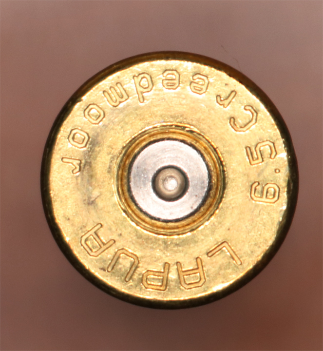

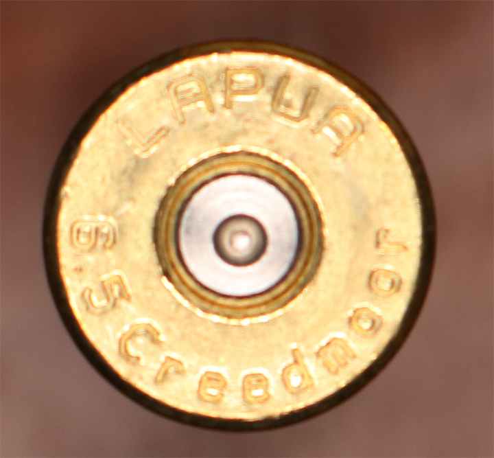

Just a follow up on the sleeve repair to my Remington bolt. First is the pre-repair primer with 39.5gns IMR4350 and 140gn ELD,
the second image is today's range trip, same load, sleeved bolt, all other details identical. For the price of the repair (80.00)
and the primes looking better (to me, anyway), I'd say it's a worthwhile repair. Hat's off to Jerry for a great job and quick turnaround.
Will try the 400 primers next. Last photo is 40gns H4350 and 140 ELD, all loads I tried, 39.5, 39.8 and 40 gave sub-minute groups but
