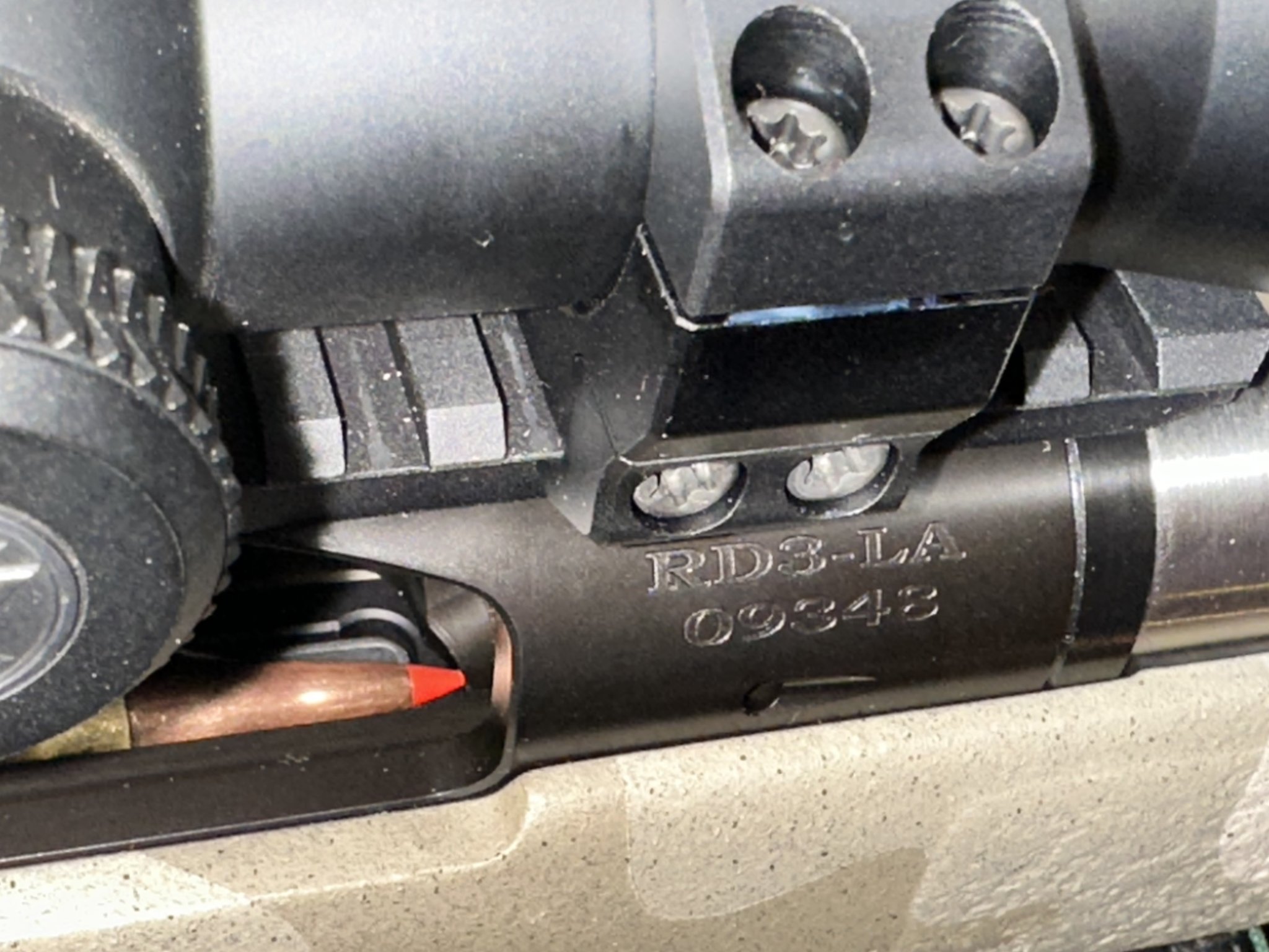

With a loaded magazine and the bolt open, there is approximately 0.25" of vertical travel between the magazine bottom position where it is stopped by the mag catch, and the top position where the top of the magazine makes contact with the bottom of the action/action feed lips. The amount of vertical play strikes me as excessive and seems like it would be temperamental with regards to feeding, and no surprise, it is.
With the magazine in the absolute downward position the bullet tips gets pressed into the vertical portion of the action just below the feed ramp and will feed no further. This might be fixed with some tweaking of the front portion of the magazine feed lips. All of the mag tuning videos I've seen are for short action mags and suggest a consistent gap of 0.4". My mag body has a noticeable taper front to back and I can't seem to find any recommended spacing for the 7PRC/long action AICS Mags.
With the magazine pressed all the way upward the bolt gets stopped by (I believe) the back of the magazine. It might be the back of the feed lips. I will try and verify. I've seen suggestions to shim the bottom of my bottom metal to limit the amount of mag insertion, but that will simply exacerbate the problem described above where the round feeds too low and is being driven straight into the vertical face of the action. I've also seen comments that the weight of a loaded mag will hold the mag low enough to keep from being over inserted, however what happens after I fire 4 rounds and now I have a mostly unloaded mag?

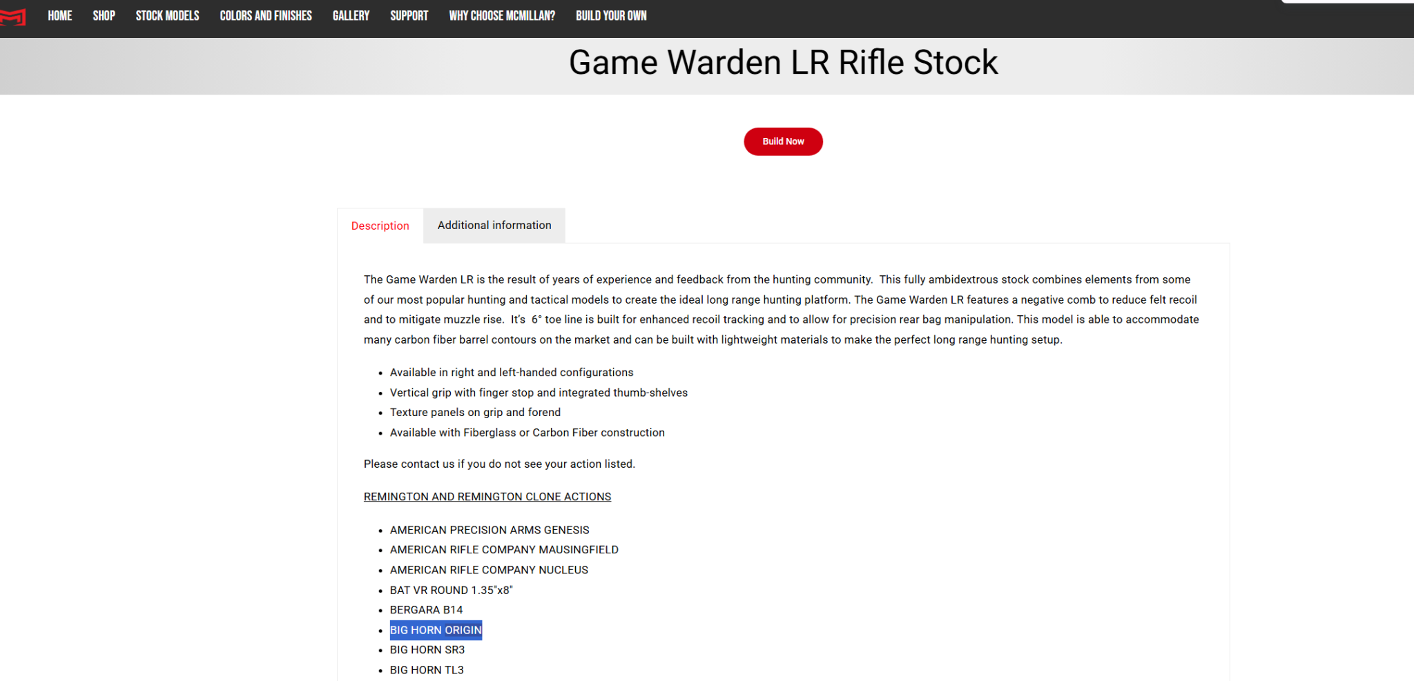

Most likely wrong stock inlet with wrong pillar height. The generic R700 LA inlet is not likely to work properly.
The inlet should've been McMillan Game Warden LR - Big Horn Origin (in Long action).
Zermatt purchased Big Horn Arms a while ago and company had a name change.

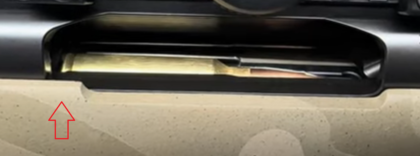

Stocks that have action and bottom metal specific inlets usually have proper stand off dimensions in the vertical (Z) axis and will have appropriate height pillars. The stock will be milled so that the DBM sits as flush as possible with the bottom of the stock and the action sits inline (neither too low or too high above the stock). From your vid and pics, your receiver looks like it sits low in the stock and there looks to be excess material (edge of ejection port below edge of stock by ejection port).

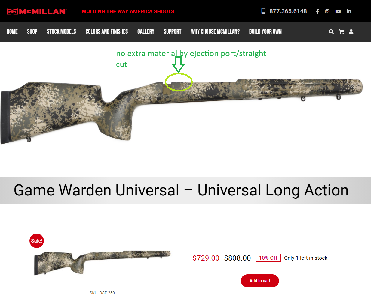

On the McMillan website, there is a Game Warden Universal stock option that has a straight cut on the receiver section to account for a variety of stuff like different R700 clone action ejection port lengths, which is not the same as the non-universal (specific to action) Game Warden LR that they occasionally have as ready to ship items, but is custom order majority of the times.
If you ordered the Game Warden Universal, you have been sent the wrong stock. However, if you did order a Game Warden LR for Remington 700LA, then you ordered the wrong stock. Hence my original thoughts on it being wrong inlet and correspondingly wrong pillar height.
Even if you solve for the magazine and Z height issue, I suspect that you'll end up having weird case ejection pattern/issues due to the excess material on the stock.
