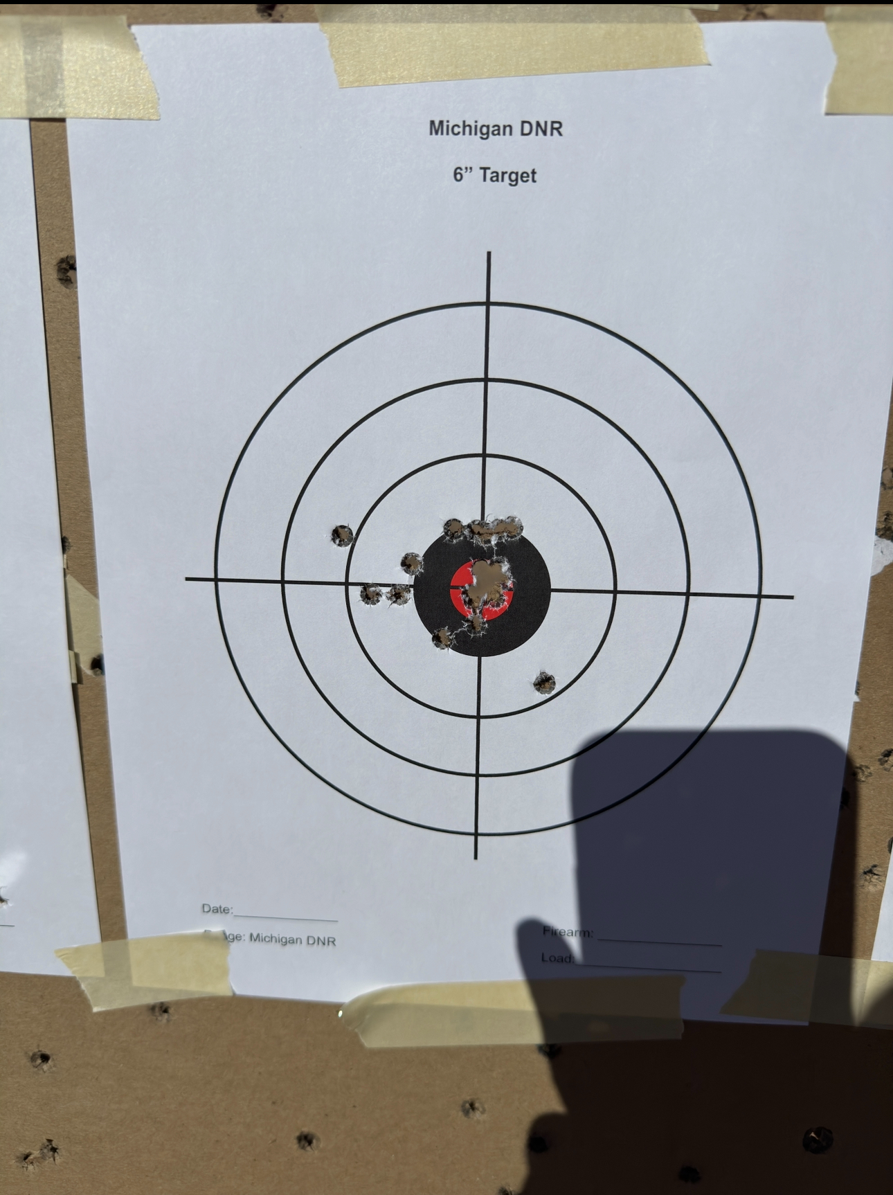

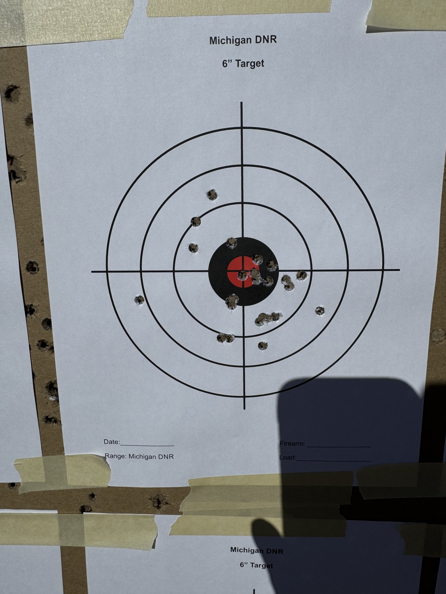

I’m having grouping issues with my rifle and I’m not completely sure if it’s me or maybe my rifle.
Here’s the setup:
Daniel defense DD4v7 pro
Eotech 1-10 ffp
Eotech cantilever mount
Magpul bipod
Ammo shot in this case was new republic 556
(Have had same results with a few other brands of ammo)
My grouping is terrible. At 100 yards groups are spread at about 4”, most within 3”.
I do feel like I’m half decent with basic marksmanship and can do better. I’m wondering if maybe the cantilever scope mount is just bad for consistency? Everything was torqued down evenly with a calibrated torque wrench.
Just for proof that I can shoot better (maybe not super great), here’s a target that I shot at 100 yards with the following:
Daniel defense DD5v4
Geissele 2 stage trigger
Leupold mk5 5-25 scope
Leupold scope mount
Atlas bipod
What would you guys suggest to check for me to improve the grouping?
Same ammunition? Two things stand out, while you didn't say what trigger in the V7, guessing "milspec"? that and the scope power.
1-While one can shoot accurately with the standard triggers, it can add to the difficulty to keep a steady gun as it's pulled.
2-Same on the optic, it shouldn't be an issue on 10x, if on max power on the other, just allows more precise aiming.
Not to criticize gear-but that Magpul bipod is garbage. Magpul makes some decent items, bipods are not one of them. I guess that would be strike 3.
To add-while both guns can be reasonably accurate, my opinion is you are spinning your wheels trying to print pretty groups with either--work on positional drills utilizing support and no support, at 100 goal is to keep them on a B8 repair center black. On some of those positions you should be able to hold a 10 ring. I would also say that the V4 is over scoped, move the Vortex to that, red dot the V7 and use the scope for a MK12, etc.
In addition--check list the fundementals, assuming you are the bench? Even "resting" do you have a good position, body alignment, NPA, clear focus, parallax set, respiratory pause, smooth steady trigger break, follow through. Equipment check list, little things matter as in 20 round mag? You may be to high if using a 30 rounder, how are you resting the buttstock?
The v7 has a giessele single stage super dynamic 3 gun trigger. It’s super light so I don’t expect trigger errors to be much of a factor.
I know the Magpul bipod isn’t great but it’s just to add stability to accurately zero the scope. Once I’m happy with the zero it’s coming off.
As for the scope, I grabbed that for it because eotech gives a great mil/vet discount. I can put an eotech holographic on it but I use that on my ar9.
While zeroing I did have the scope set to 10x.
I’ll try some better quality ammo and try again. Previous ammo I’ve used with similar results are Winchester 223 (brown box), and Winchester 556 white box.
For reference on the better grouping with the 6.5vm, I was using Winchester white box.
ah-missed the "5"! Either way, you can't expect so much from that either and then the scope is ok on the "5" My opinion only, the 1-10 is a heavy scope on that V7 but it's your gun.
Looking at your target, I would say any outliers are breathing, inconsistent aiming point, body alignment/NPA and inconsistent position.
With the ammunition, keep it in perspective, while one can get lucky and have ball ammo shoot accurately, not normal. With good ball ammo, that V7 should hold 2-2.5"or less.
So the general idea is that I need to work on better shooting skills and use better ammo if I wanna tighten the groups up?
I’d be happy to see 2moa on the ar15 and 1 moa (maybe 1.5) on the ar10.
As for the ar15 scope (1-10), when you say heavy do you mean the actual weight or the zoom level of it? Maybe a silly question but I gotta clarify since I don’t feel the additional weight is a concern.
Yes, work on the fundementals. A couple things to remember--you have a light 16" barreled chrome lined carbine, not an "SPR" "DMR", etc. Don't beat your self up, expecting it to consistently punch little "groups" Sure, will you get one here and there-of course as someone will post a pic of one of those. My approach would be what I posted above ref a training program. I think some folks over scope rifles, especially hunting guns. I referenced weight as in making the gun heavy, again-your gun.
Same on the 6.5--it's a 18" carbine

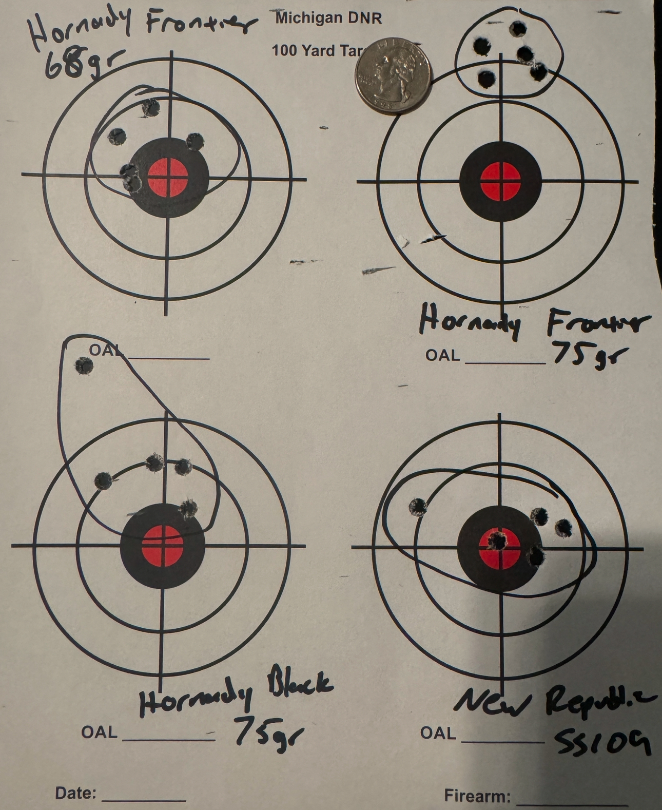

Welp… I finally got back around to getting this rifle on the range again. I tried 4 different ammo types:
* New Republic SS109
* Hornady Black 75 gr
* Hornady Frontier 75 gr
* Hornady Frontier 68 gr
Here’s the target showing the results:
Looks like I can get really close to 1 moa using the frontier 75gr.
However, I did change the scope out for a Leupold mk5 3.6-18. I didn’t turn the magnification above 10 just to eliminate the aiming precision with a more high power scope.
I need to throw the eotech back on this rifle and see if I can get these same groupings with that scope using the ammo I tested today. If not then I’d lean towards the eotech having some issue.
Also, the groupings aren’t super close to center of the target because my scope turrets likely need to be adjusted. I was using the 3 mil mark above the center of the reticle to make these shots. I can only dial down 0.5 mils before the turret stops. However, I can dial up 17 mils before the turret stops. This scope should have 29 mils of adjustment so I’m assuming that Leupold didn’t have the scope set to the bottom (-0.5 mils) before installing the cap?
Edit: turns out that all I had to do is just remove the turret cap, rotate it a few mils and reinstall it. I added 4 mils to the up elevation. I’ll re-zero and confirm then put the eotech on and hopefully have good results.

These groups are not horrible like the 3”-4” groups in the original post. Did you confirm the Eotech was the problem?
