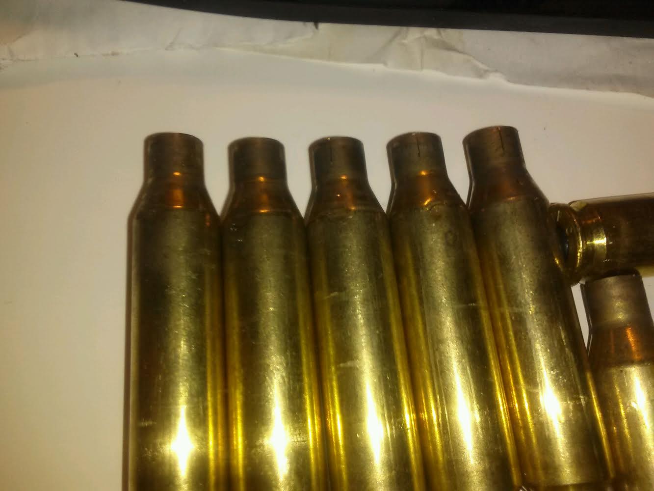

i got the brass laid out here in front of me..several of the casings have flat spots on the necks..and all of these brass have a pretty deep scratch down the side of them from the top of the neck..
ok..the brass laying down is from the 120grain rounds.
Those 4 or 5 on the left standing are the larger 140grain casings.
See the scratch? And the flat spots? I do not think I stepped on any of these when I was picking them up..
View attachment 51996View attachment 51997
Flat spot on neck is from case hitting inside of receiver / barrel extension when extracted.
Scratch on neck is most probably from neck catching the lug raceway on barrel extension upon extraction.
Scratch on body of case is most probably from feed lips of magazine, you can knock down the sharp edge on feed lips to minimize the scratch or go to Pmags.

You better check something here. Do I see burn cuts in the necks of the 120's? The bright pic to the right of the darker ones laying down. Three of those five cases look like burn cuts through the neck.
Also, what's goofy to me is the primer faces look okay. The cratering on them is deep as hell, though.

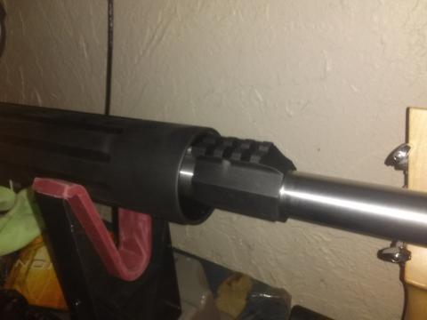

.260 Rem is a reloader's affair when looking at gas guns. For those automatically jumping to a conclusion that this is a lack of gas factor, also consider that too much gas on the extreme end can produce the same results, where the gas runs through the system so fast, it doesn't act on the carrier/bolt impingement chamber long enough to transfer interia into the BCG, and it escapes out through the gas vents visible through the ejection port.

All this rethinking the ammo and gas block is probably premature.
New gun. Shooter new to AR platforms. I bet the farm the bolt is too dry.
99% of the time when a gun comes into the shop and won't cycle, this is the reason. Issues with ammo or too little gas are actually rare in comparison.
Grease up the buffer and spring and lube the hell out of the bolt. I bet it'll run just fine.
