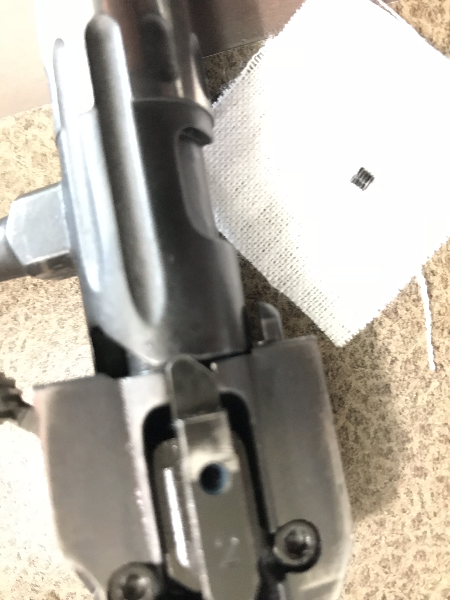

It was my AI that went down at the SnipersHide Cup at RO. The firing pin assembly is connected to the bolt with two screws on top of each other. One fell out at some stage and the second backed out so the pin was loose / depth incorrect (I’m not so good on the technicals). Anyway, they have two screws on top of each other as a redundancy feature so I guess it happens. In any case, a few much more knowledgeable competitors than I reset the firing pin depth and I completed the match with the one screw. A pic below for posterity on how many people it takes to fix an AI ?. Honestly, these guys were the best. Super talented and incredibly generous.
AIs are fine but I think KT hit the nail on the head by saying a) switch barrels, meh and b) the quality of custom rifles has closed the gap on reliability and probably exceed on accuracy if you go with a top builder. My custom rifle is way more expensive than my AI, a function of me being based in the U.K. and importing a rifle from the US with taxes and a weak GBP. I’ve had two AIs but what I really wanted was one really well built top end custom rifle built to my specs.
A pic of the screw / trouble spot
