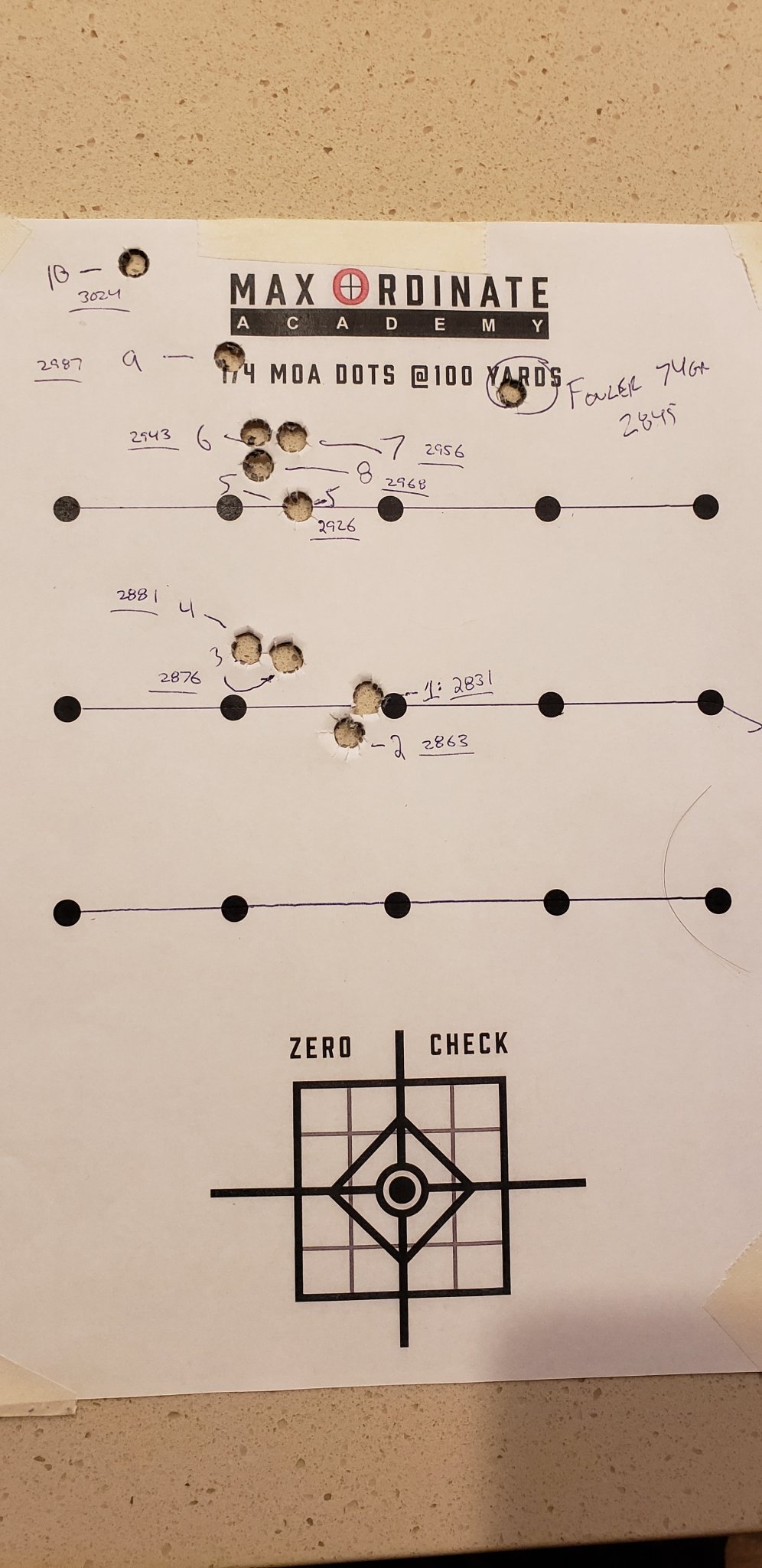

First time working up a load. Not sure where to go from here?
Any and all in ours welcome. #2 was on me.

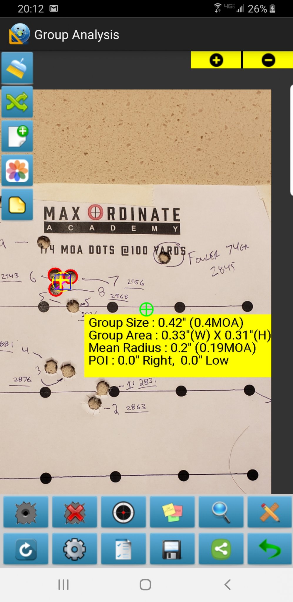

300wm, berger 215s, H1000, .020 jump, 2.781 CBTO, 3.565 COAL
Indoors, shot over Mag Speed V3, 100 yards (should it string that much at 100?) Zero target at bottom is 2" by 2", aiming bottom left and dialed up (except fouler)
Hunting rifle, all shots were cold bore.
Thinking 76 to 77.6 is my high node.
Saw pressure at 78.5 (primer flattened ing, bolt lift wasnt sticky as far as I can tell).
Where to go from here. Load 76.7 and do searing depth or load some 3 round groups first?

No worries. As I understand the ladder test you fire one round at each load setting like you did and then look for where the bullet holes end up next to each other. Velocity isn't considered as part of the ladder test.
The other test you tried to include is what I have been calling the Satterlee test. This is where you measure the velocity at each load point. The load charge weight usually increments by 0.2 grain. Then you look for velocity that stays close to the same for adjacent charge weights.
You must have had the Magnetospeed attached while you were firing? That can affect the harmonics of the barrel as well as cause the POI to shift.

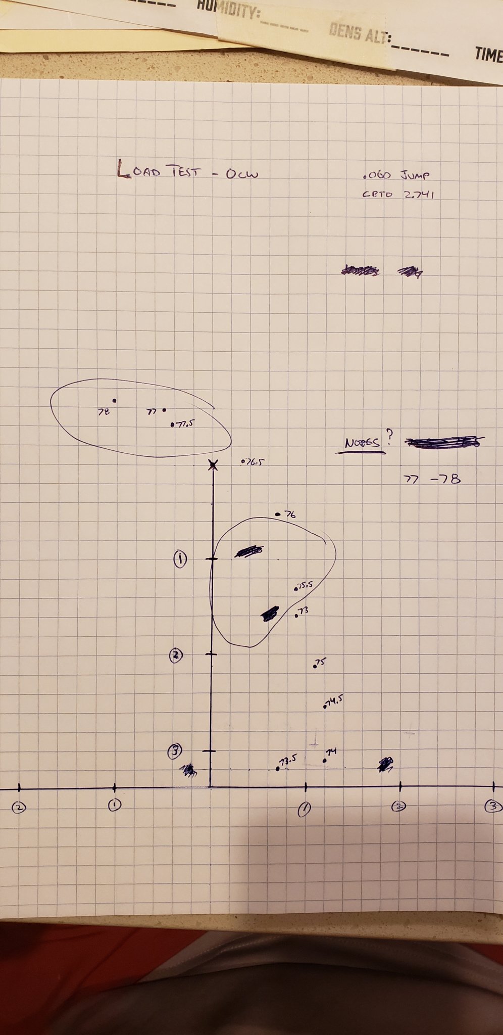

Man, that is an insane amount of vertical for the charge spread. Don’t know what to think about that. I’d have done it at 500 yds or beyond. I also typically do OCW for more data points.
Not sure what to think, this was neck turned, weighed exactly, neck sized down and final tension set with .306 expander, primers seated to a .2 crush, eedding comp dies, a Co-Ax press, etc. etc....everything I could do on my part to make it shoot.
Safe to say 76.5-77.5 is a decent place to load around and check groups at range?
I’d load 77gr and start looking at seating depths.

You won’t see enough variation with a seating depth ladder at 100yrds. You’d need to do it at 400 minimum. I color the tips with sharpies. The ink is left on the target so you know which hits are which. I weigh bullets, and select cases for utmost uniformity.
If you’re going to continue load development at 100, I’d just shoot groups.

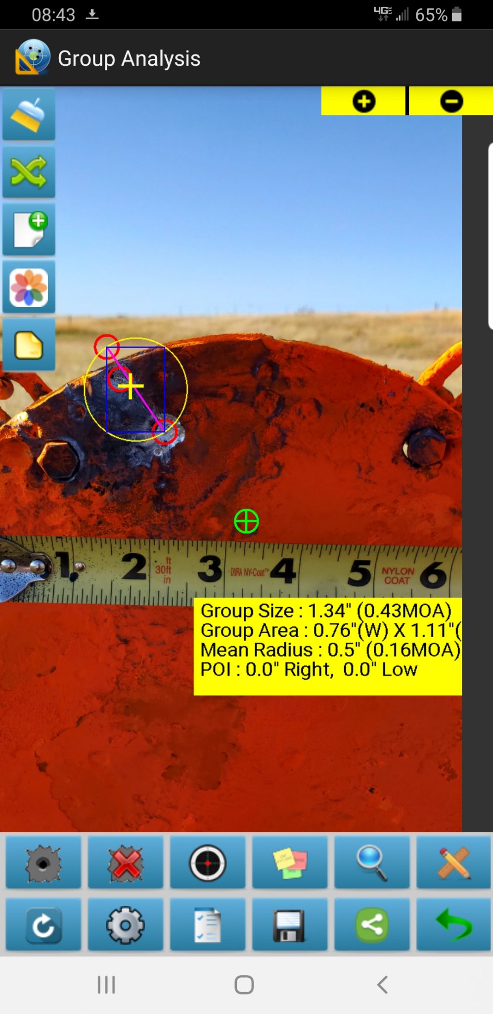

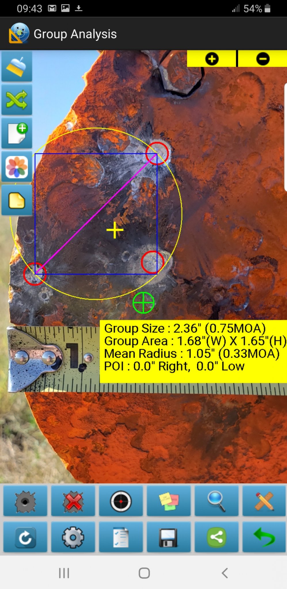

1st group: .010 jump. (.43 MOA), but about .75" of horizontal. Spotter says that 3rd shot just passed at top of steel where I have it marked, probably not valid data since I cant see it on the target. I trust him though, very experienced shooter, spotted through swaro glass)

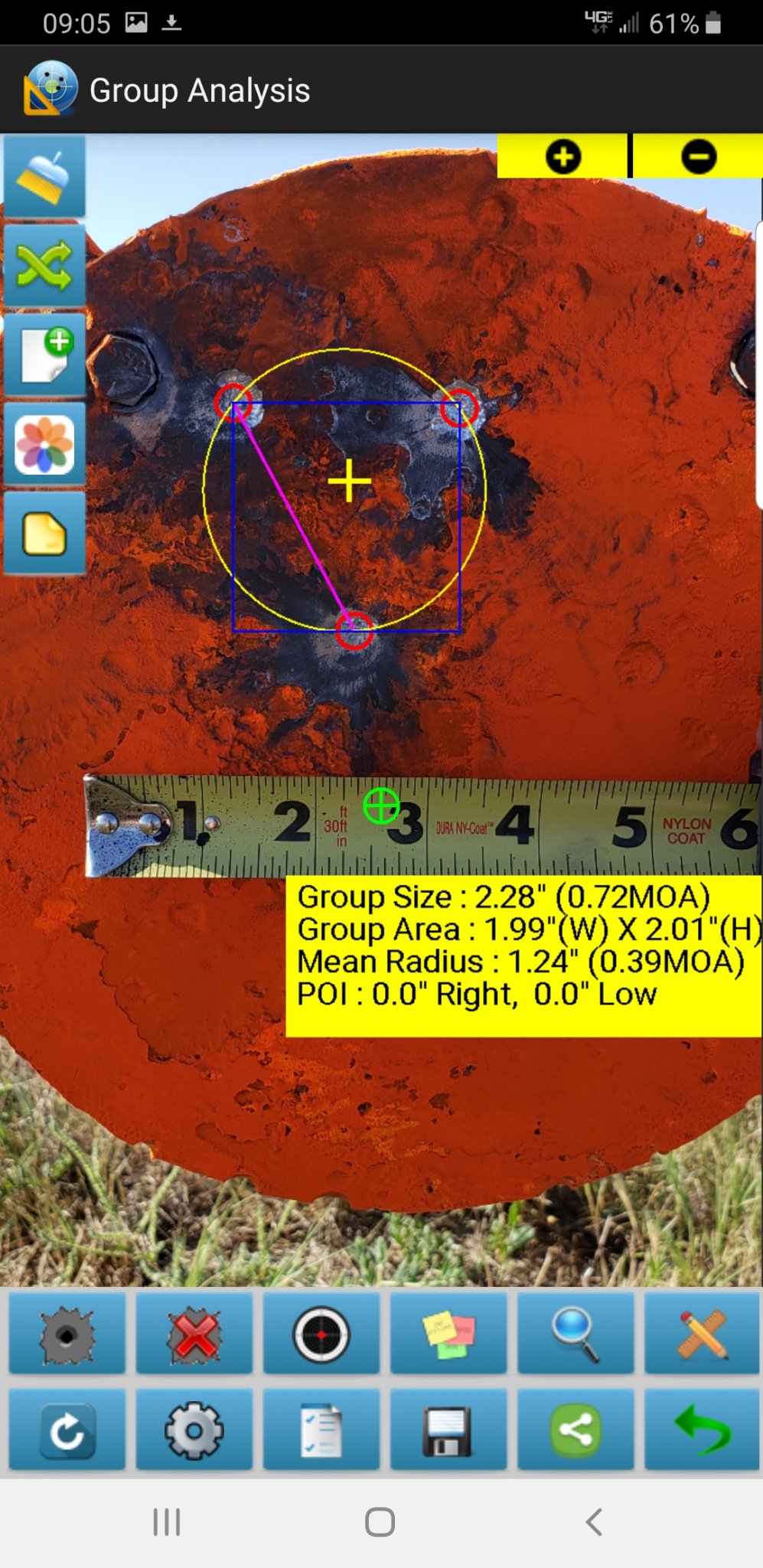

2nd Group: .020 jump (.72 MOA) about 2" or horizontal stringing

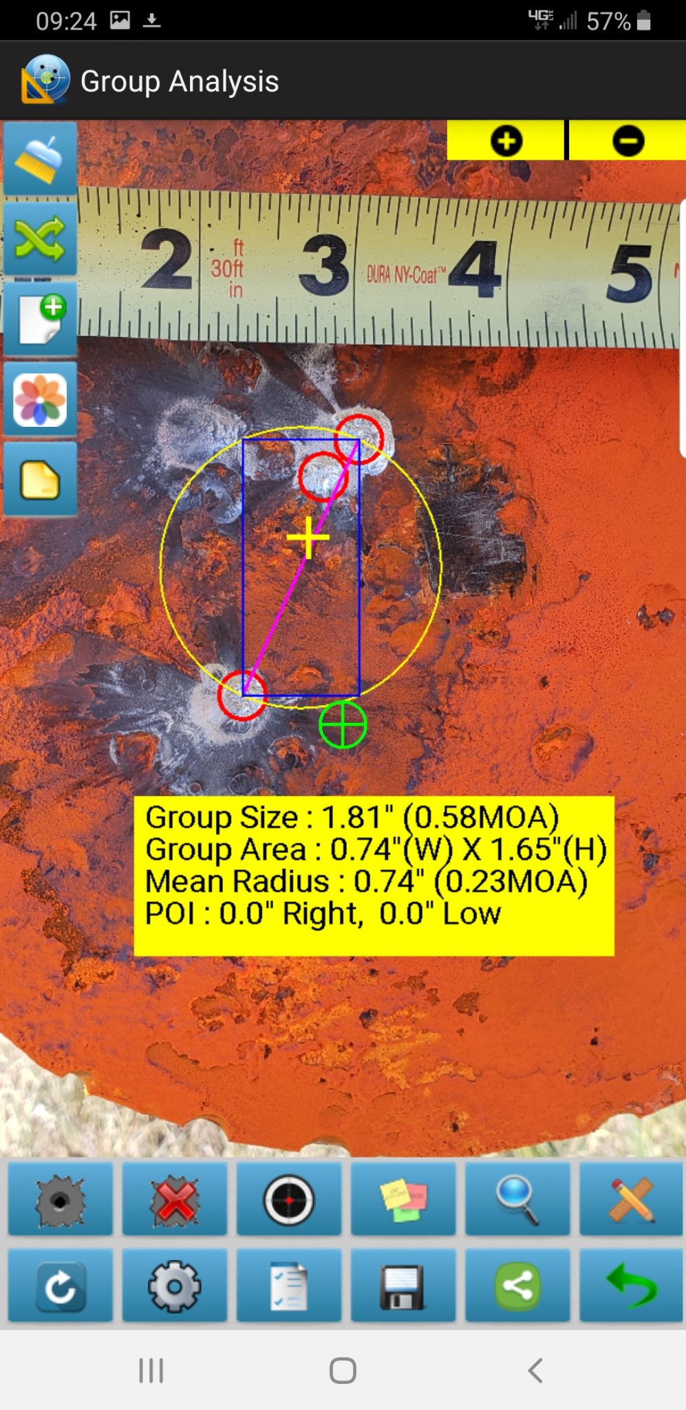

3rd Group: .030 jump (.58 MOA) .74" of horizontal

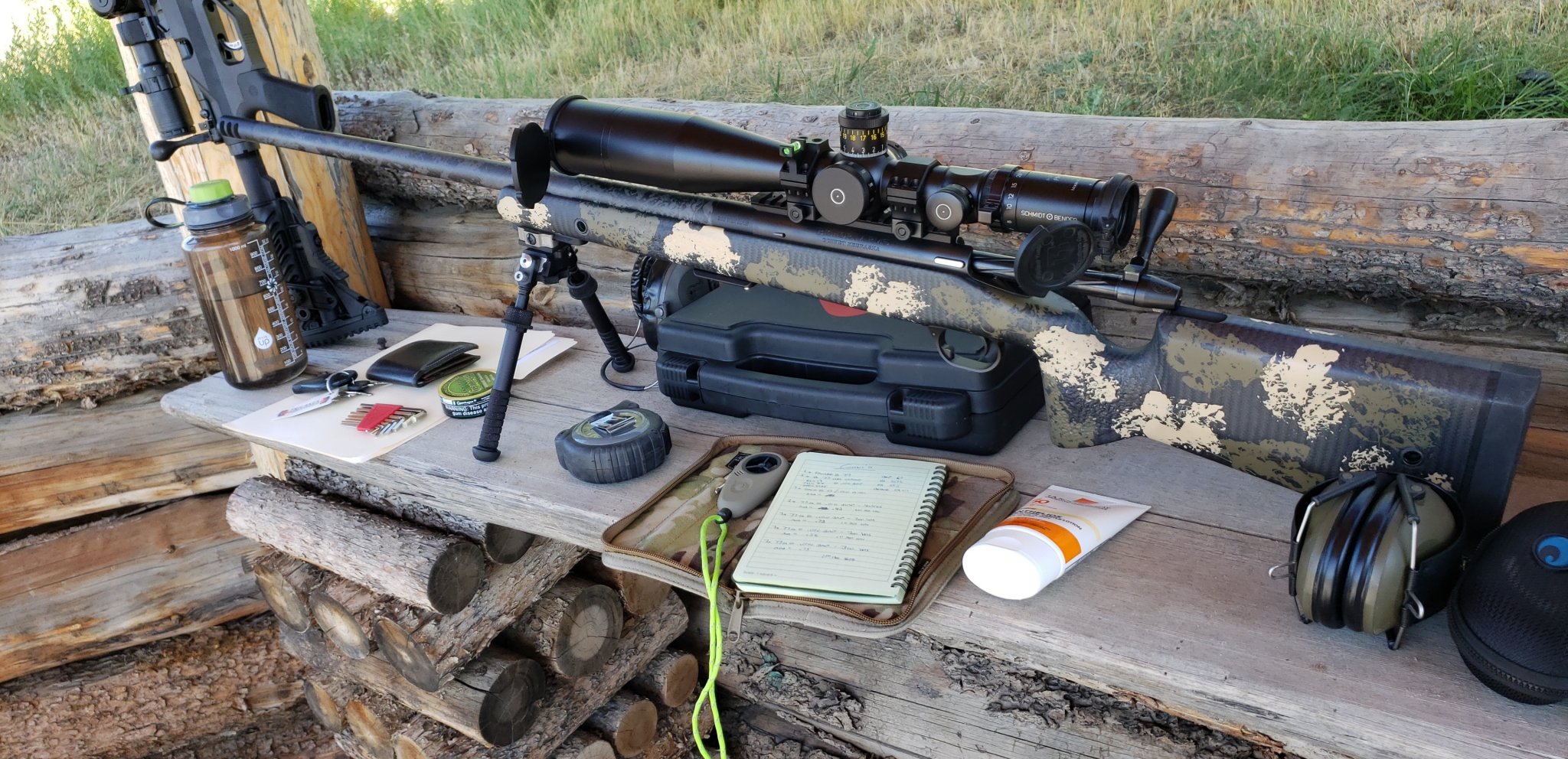

300wm, berger 215s, 26" proof, bighorn SR3, sitting in a non-adjustable EH1, glass is an S&B 5-25
Round count is 75 after 18 fired today.

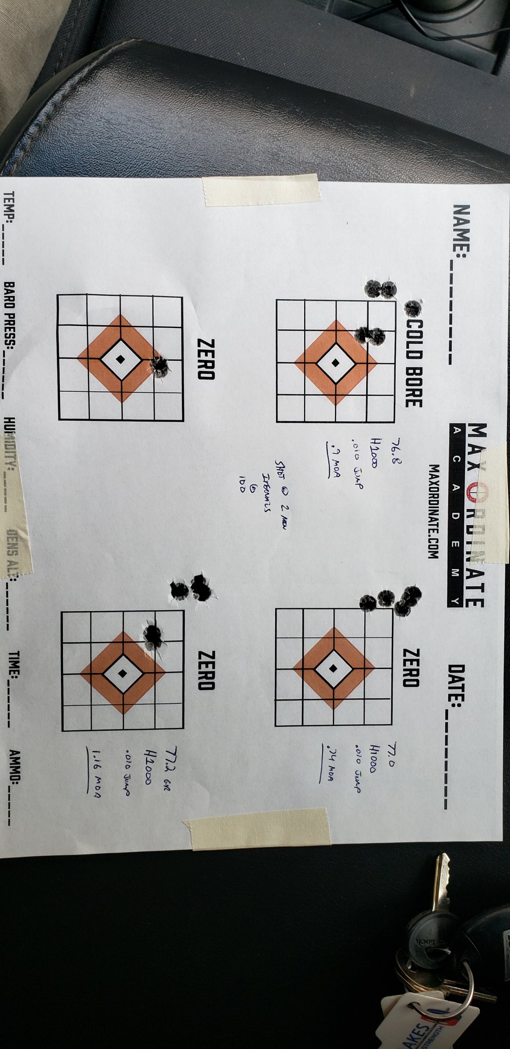

Now I'm beginning to get frustrated. Even a bad load should shoot better than .75 out of this rifle, no? I felt like all these shots were good, and about as stable as I ever get.
This was 5 at 76.8, 77, 77.2 @ .010 jump
2 min intervals.
I cant do any better on brass prep, all necks measure concentric, I measure everyone after I seat it both necks and CBTO, primers all set and measured to a .001-.002 crush, pockets uniformed, flash hole debuted, next bushing sized down with .331 bushing (.013 neck wall) then expanded out with .306 mandrel.
Suggestions? What can I check on the rifle? Barrel isnt contacting stock, brake isnt lose? Heck even the scope was mounted by pro shooter. Action was torqued to 65 front and back, maybe find a torque wrench and check that held?

Update....graphed out my OCW test...figuring 77-78 is my high node? Shot with no chrono. 3 shot groups. Graphed the middle of each group from the 'range buddy's group measuring app. 77-78 was the same POI and a nice flat spot in the vertical. .5-.75 MOA groups between the 3 charges...beginning to think that's as good as I can shoot a 10lb 300wm
Still not happy with the ES...this was at .060 jump now compared to .010 in the previous groups pictured above.
Stick with 77.5 and .060 jump and try CCI primers? Or run another seating test from maybe .030 to .120 jump
Chrono'd 4 after I was done...at 77.5gr, .060 jump and .0015 neck tension
ES 22
SD 9.7
Ave 2981
If you really want to find the nodes for the gun leave the chrono on the gun, worry a out groups after you figure out the powder charge. I am not sure what that graph is but your charge weight should be on the x axis and the chrono velocity on the y. When you graph that as a line you should see so e flat spots.
If i were you at this point you have decent group at 77. Load some more of those and go shoot and practice.
You hear a lot about the magneto speed altering POI, and it does, but that does not matter. Do your work with it then take it off and fine tune your zero. I have used it to develop loads for 4 rifles now and it impacted POI on them all but not the groups i was shooting. My 6.5 shoots 0.4” groups at 100 with or without the magneto speed attached. POI with it attached is about 0.5” high and 0.5” to the left versus without it.
This is not a velocity graph. I think we're talking 2 different tests. OCW doesnt include velocity, per say. As I understand it, it looks to identify a node of 3 charge weights that have the same relative POI when compared to other charge weights, meaning a stable node of charges (not necessarily the most accurate) but the most consistent over a 1 grain spread. Ideally, this also corresponds to an accuracy node. OCW says to find thar node, then tune group size with seating depth.
That graph is the center point of 3 shot groups plotted from an OCW test, the X is the aiming point they were plotted off.
Charge weight for each group listed next to the plot.
