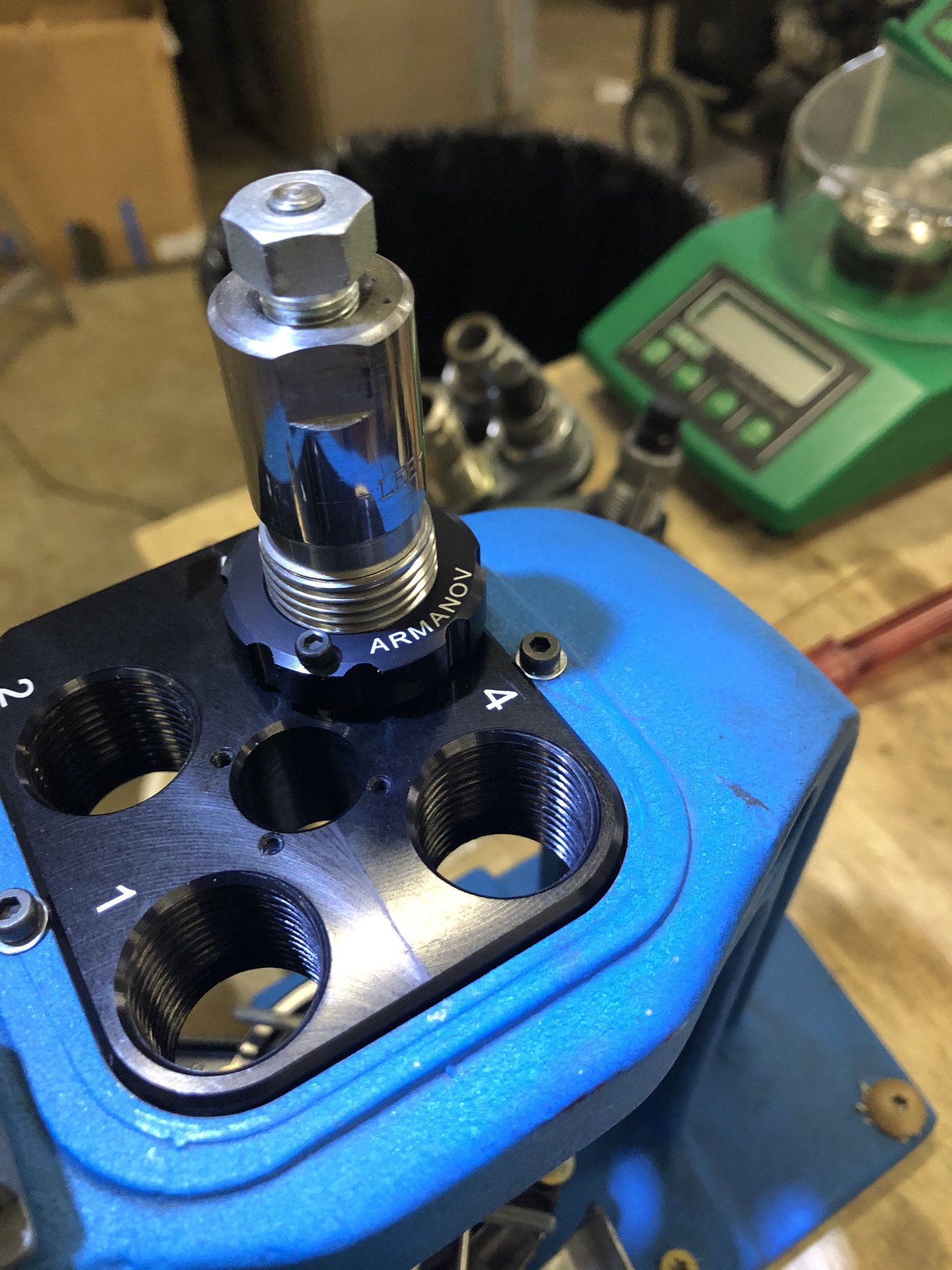

    I use Armanov clamped toolheads w/ floating dies on my 550..and like them so far. No hard data yet, but initially it appears that my bullet seating consistency did improve.

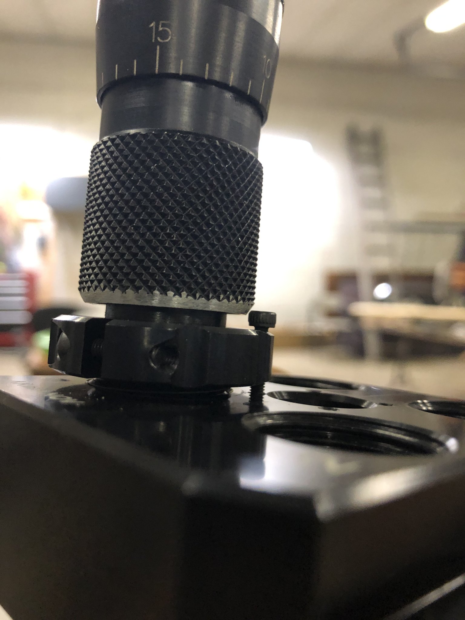

    To clarify.... the Whidden/Uniquetek toolheads ONLY clamp the toolhead... the dies are not pinned, they have a pin through the lock ring, but the lock ring is not tightened down, its floating about one rotation up from the toolhead.
    So heres the idea with the Whidden/Uniquetek or Armanov setup:
    1.) You put cases in all position on the shellplate of your 550. With the dies set in place and the toolhead NOT clamped yet, you run the ram up and keep it up. All 4 cases make the toolhead to come to a rest at a certain position...you clamp the toolhead at this position. The idea being when there are cases in all 4 positions, you want to lock the toolhead to this position so you eliminate the forces on the toolhead each time you run the ram.
    2.) Now that you have the toolhead clamped in to a repeatable position, you free float the dies by running a pin through the die lock ring while the the die lock ring is floating one rotation above the toolhead. This allows very minor movement of the dies to self center and align properly, so the case and the die work freely together to get you better consistency, I.e. - no abnormal force pushing case/die/toolhead in the wrong direction or against the position of another case position.
    The "issue" from Dillon standard toolheads that led to designs like this are:
    1.) The stock toolhead is sort of loose fitting, which helps when making all different kinds of ammo, and the dies are locked down. For precision rounds, its sort of backwords... Each case when it enters the die will impart forces on the toolhead, whichever toolhead imparts the most force wins and the toolhead shifts to that position more. The other positions are not off center/balance, but their die is locked into place so where the toolhead goes, the die goes, creating inconsistency.
    2.) the clamped toolhead/floating die clamps the toolhead in the most "liked" position according the imparted forces by the case positions, but allows the dies to move slightly to help counter those forces talked about in number 1.
    Does it work?? I'm sure it does for some... and I'm sure it may not make a difference for others. Thats up to the reloader to decide for themselves.
    I'll show you what I mean with the pics below.
