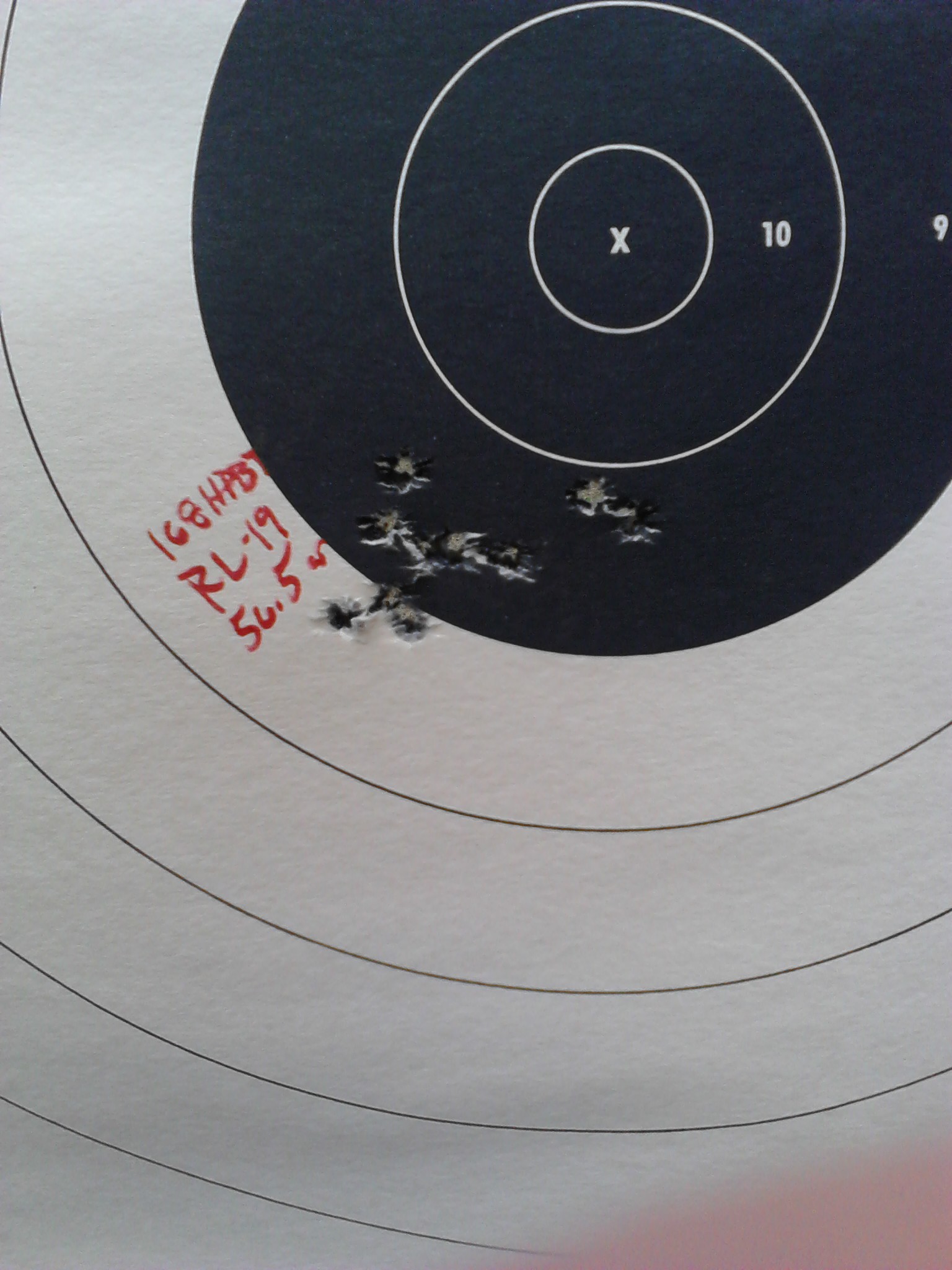

This load of RL19 worked well in my 1903A1
something to play with if you are trying various powders or forced to use whats on the shelf.

Am I correct in interpreting 48.7 as a scatter node?
However, if 48.7 is the EXACT scatter node, which it might not be, that means the stable nodes would be right at 48.0 and 49.4 gr.
I have another reason to believe that 48.7 is, or is close to, a scatter node. 47.3, 3% down from 48.7, despite being tightly grouped, does not follow the POI movement trend (low to high), and my sighter (2nd after cold bore) was also 47.3 gr, but was very far off and also didn't contribute. I've marked it's position relative to POA with the rest of the group:
And look at the target again from yesterday. Huge standard deviation from POA with the two shots at 47.3 gr.
And the 3 shot group at 49.2 had great, consistent POI yesterday. The 1.5% off 48.7 would be right between it and 49.7, at 49.5 gr.
I fixed my other post.im still learning this stuff myself. Hornady book 8th edition shows 178s and 180s the same.
I shoot 178s with hybride 100v in my .06 and found best accuracy at the upper end.
Flyers my falt
Is .5 kind of a big spread for an OCW?
Purpose of OCW not being smallest groups but to find a node where you have play in powder thrown, plus or minus, so that point of impact really doesnt change?
At .5 Im wondering if you may be missing the point where you get two groups showing same point of impact. .2 will tighten up your data so you can see where powder charges give similar impact locations.
Hi pmclaine,
The charge graduations were 1% step increases, yes.
Here was my understanding of what I was doing, and if I'm totally wrong, please slap me upside the head..
Nodes of scatter vs. nodes of consistent POI are stepped by 1.5% charge graduations. I had no idea where I was on the scale with that rifle + powder + bullet combo. At 1% graduations, I would either find a scatter node or accurate node (or get close), but not both, and I would find one or more with fewer charges than if I went all the way up the scale at finer graduations. I wanted to get a big picture of where I should be refining, working from coarse to fine. Now I believe I have an idea what ballpark I'm playing in, and I can begin to refine at 0.2 grain graduations to find that optimal charge in the accuracy where I can have play plus or minus.
So your post, as I understand OCW is absolutely correct, I'm just taking a coarse to fine, long route, means of getting there, trying to learn as much as possible on the ride.
Hi pmclaine,
Yep, my error.
