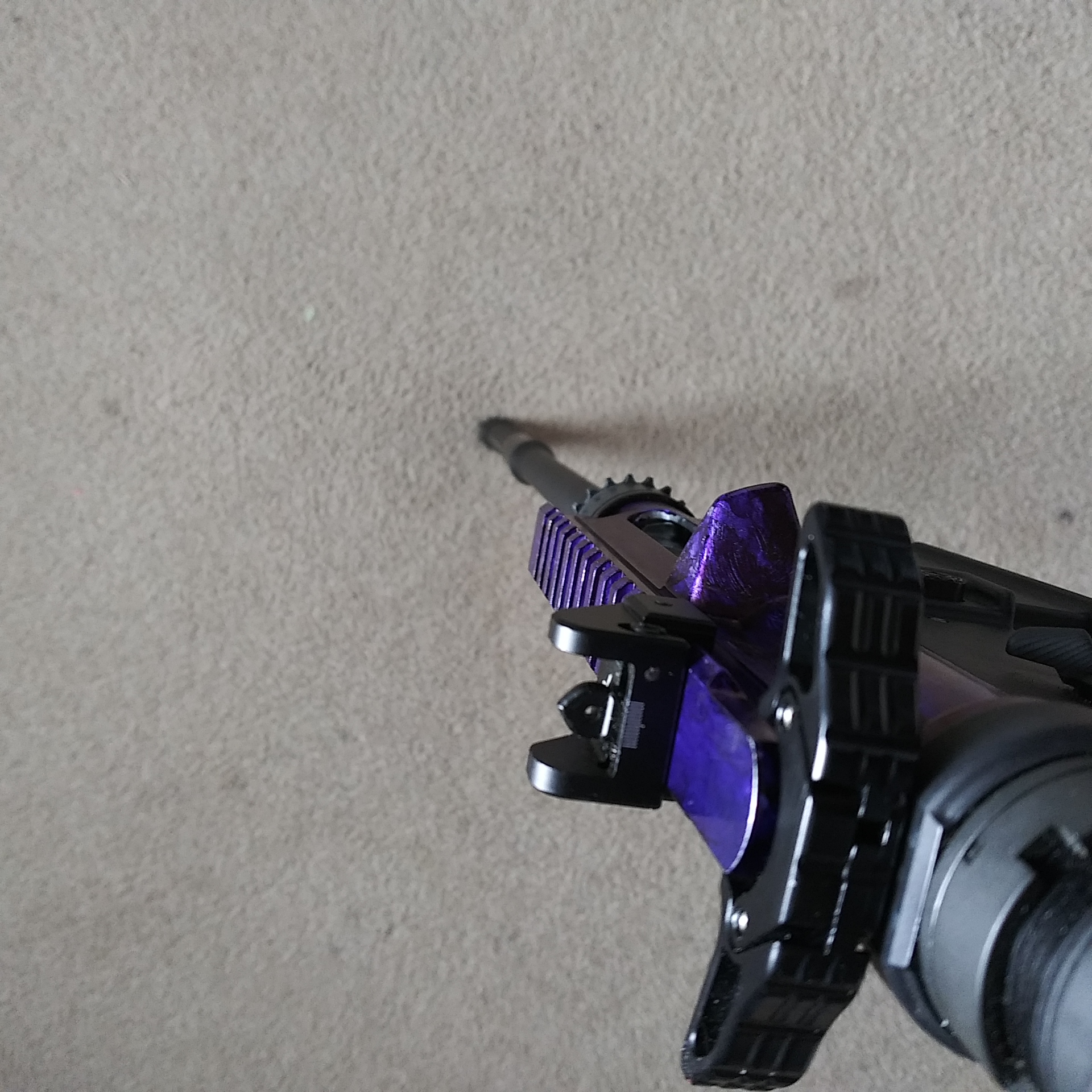

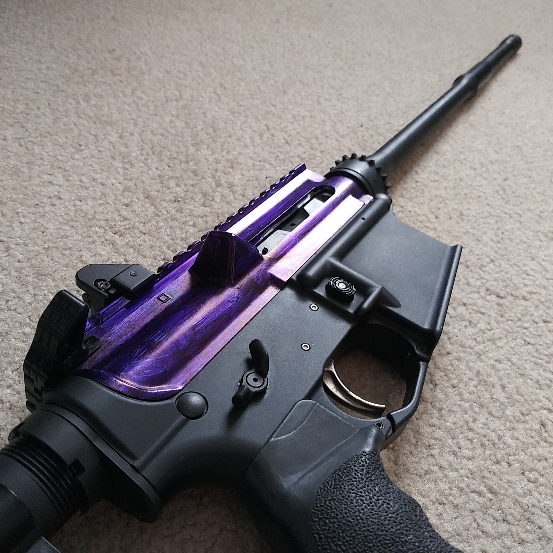

Cheap Lightweight upper has begun.
I need a front sight that can thread on the end under the thread protector or some type of lightweight gasblock sight. I'm not really up on the old type A2 style site. I have a holosun green dot or a 16x scope I can put on it but I want some other low profile light weight iron sight option as well.
My fallback will be a flat piece of alum or steel with a hole for the barrel and then 2 small ears and a front post sawed/filed into the top. I figure I will need ~1" tall so it could even be removable if I had a wrench for the thread protector. This is for 25-100yds. If I could find a way to put a height adjustable front sight that would be better. A folding height adjustable front sight on the muzzle would be the best.
  • Unfinished poverty pony upper
  • blue Dychem
  • Faxxon 16" barrel
  • low profile peep rear sight.
  • no gas block, gas tube, or handguard - gas vents out top - no biggie
  • wondering how lightweight of a buffer I can run if I don't have any gas - single shot only.
Will be running my current lower for now but I'm really wanting to build a dedicated lightweight lower now.

I made a long aluminum flat front sight that went under the thread protector. It was about 2" long, I put a small divot in it to boresight it. It was way too short. On top of that the low profile rear sight was too low to get a cheekweld so so I trashed it and put a clip on Holosun for now. I like the thought of using the Gas block to mount a front sight to but I want it to be optional so looking at gas blocks with pic rails and then just ad a pic rail front globe sight.
