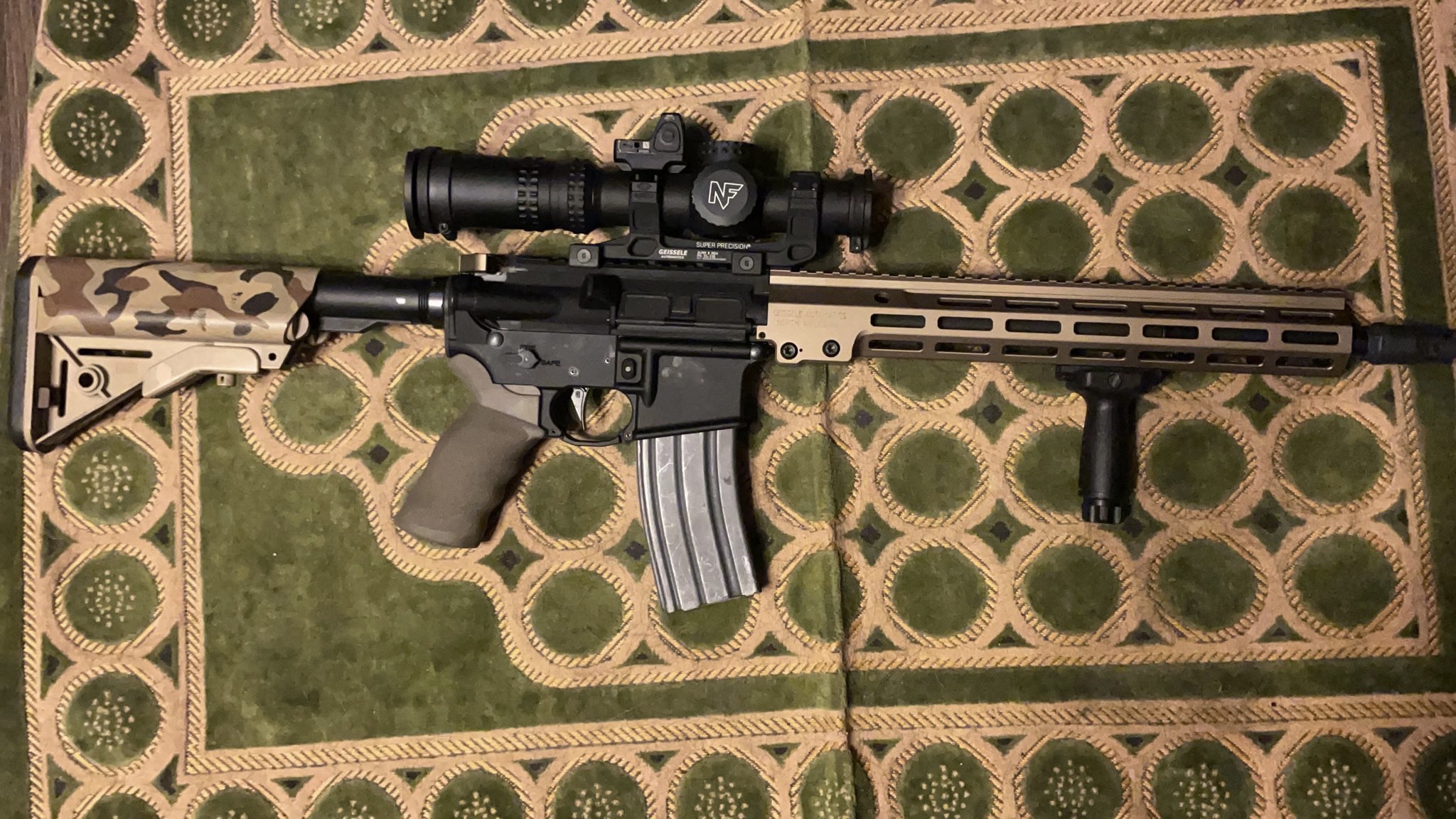

Here’s a 14.7 I just built. The barrel was a 16” CLE Douglas Recon contour, with a little smaller profile past the gas block. I had my local smith cut it down for me. It’s a touch heavy, but balances and handles nicely. I’ll be running a Sig 5.56 SLX-C can on it when it gets out of jail, so it won’t be too unwieldy. I think it will end up being my go to 5.56 rifle for most things.
