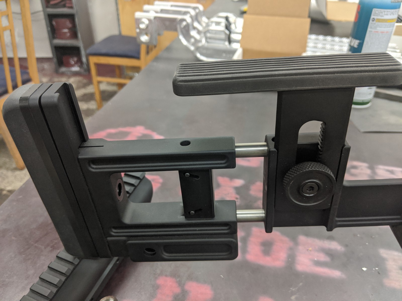

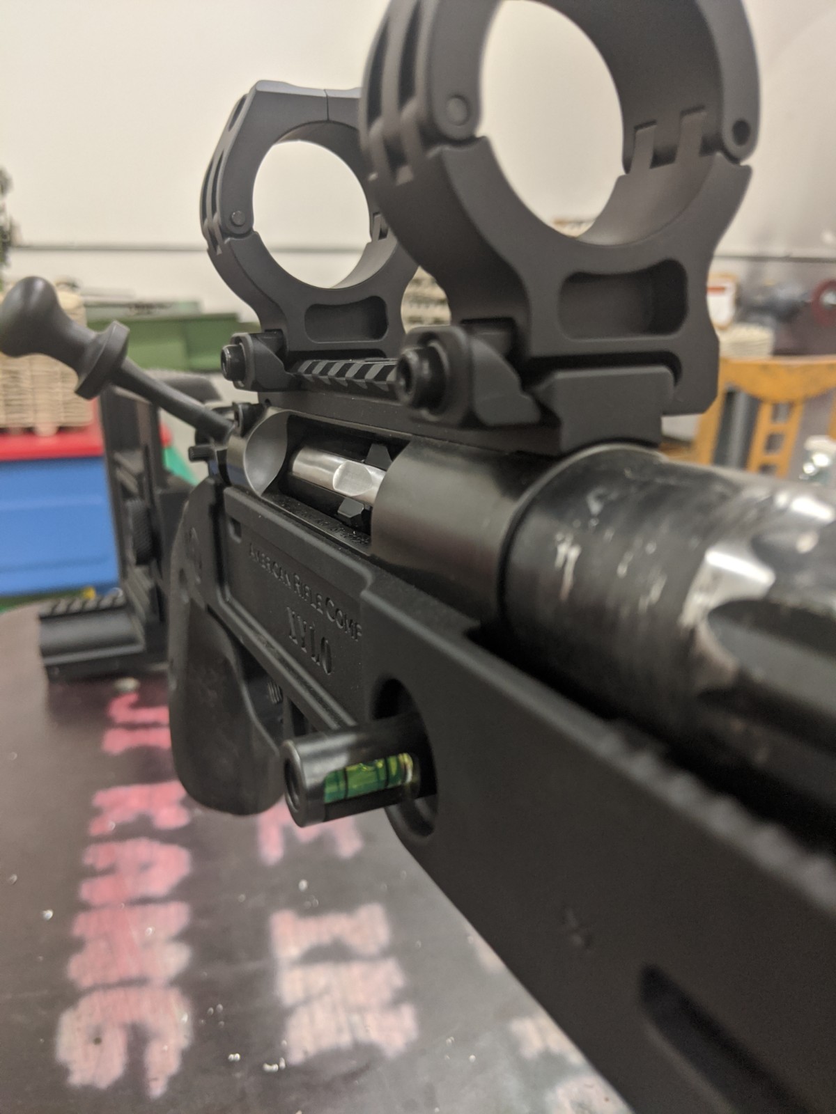

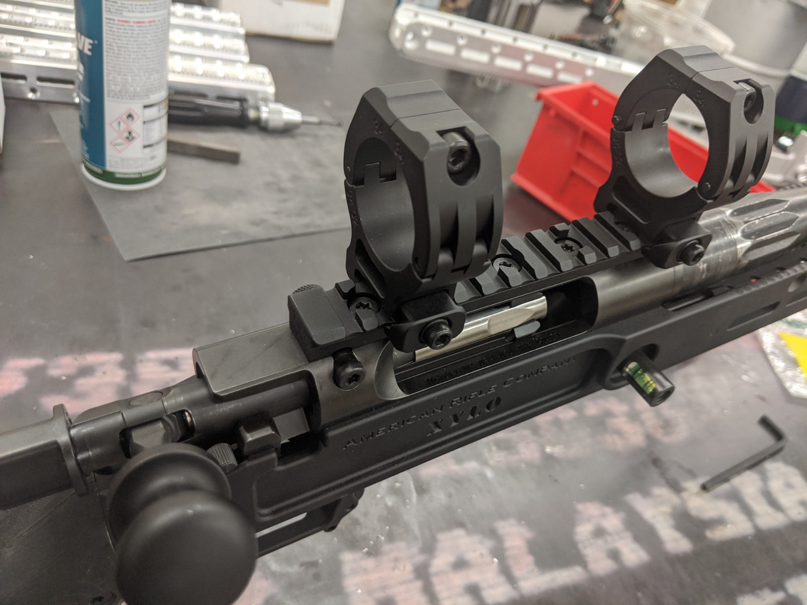

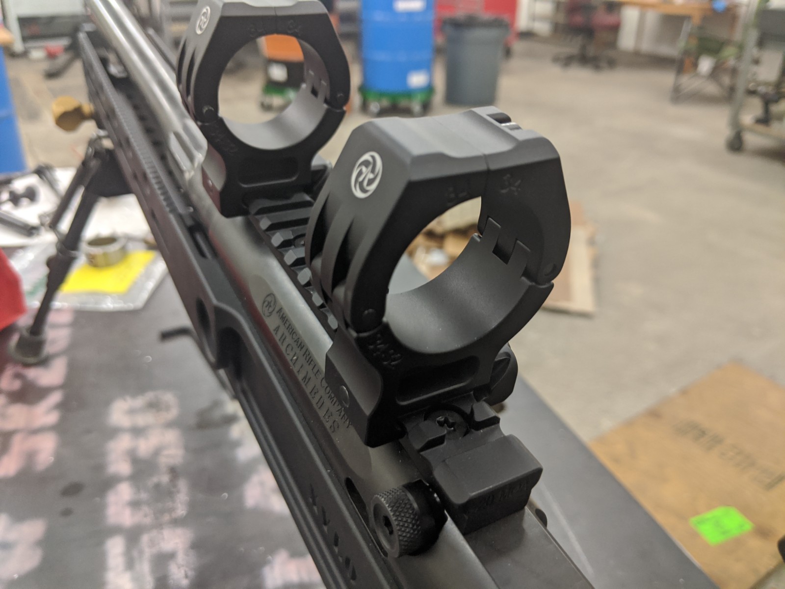

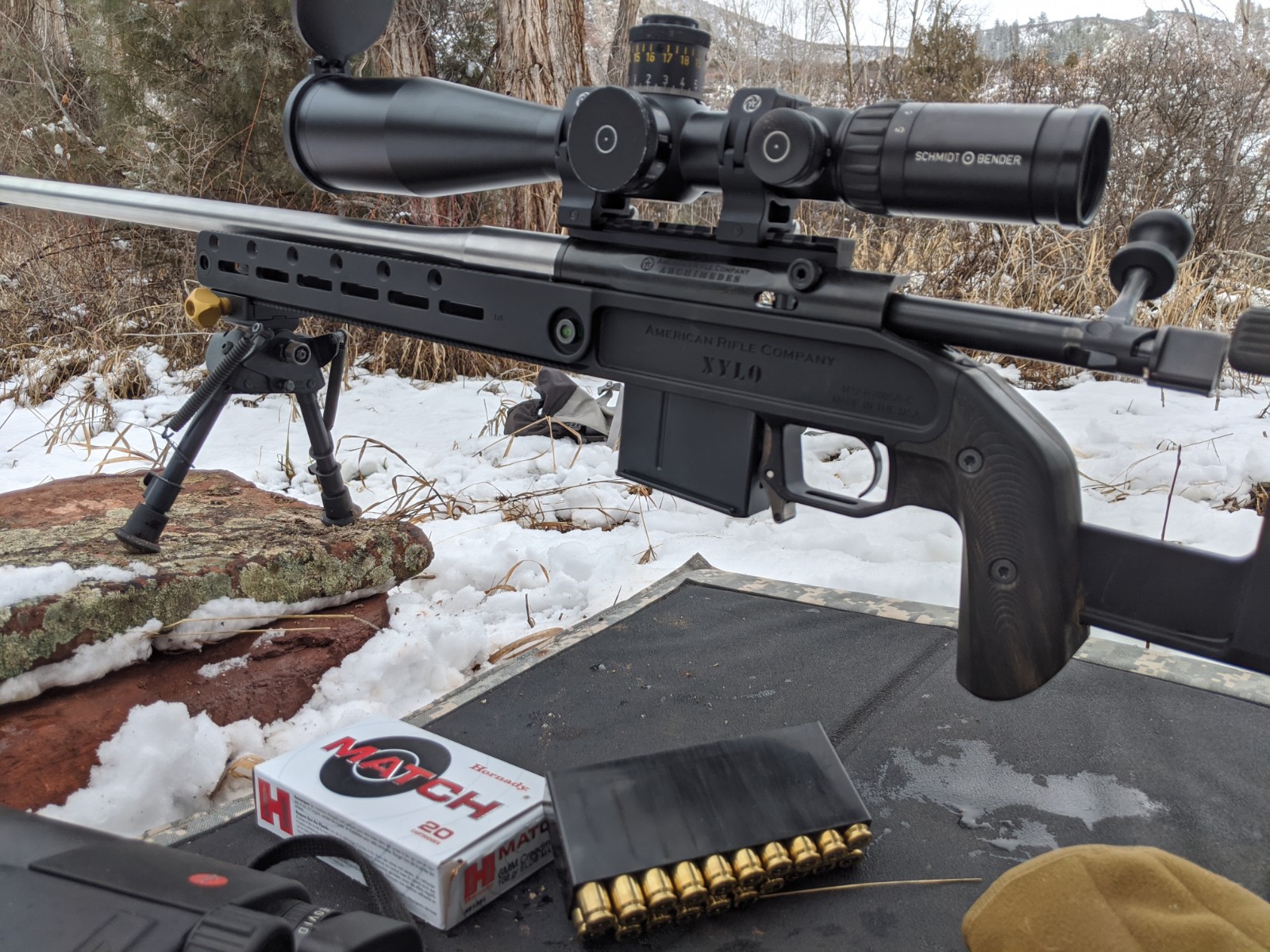

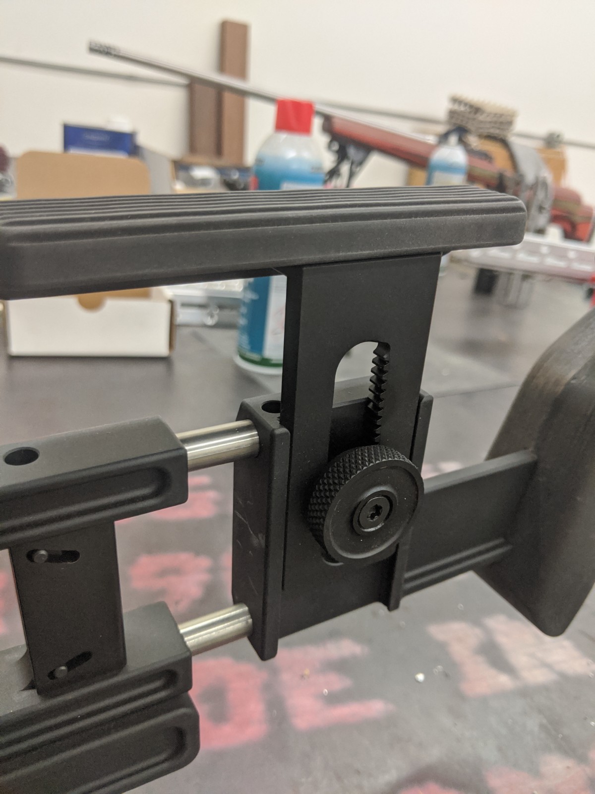

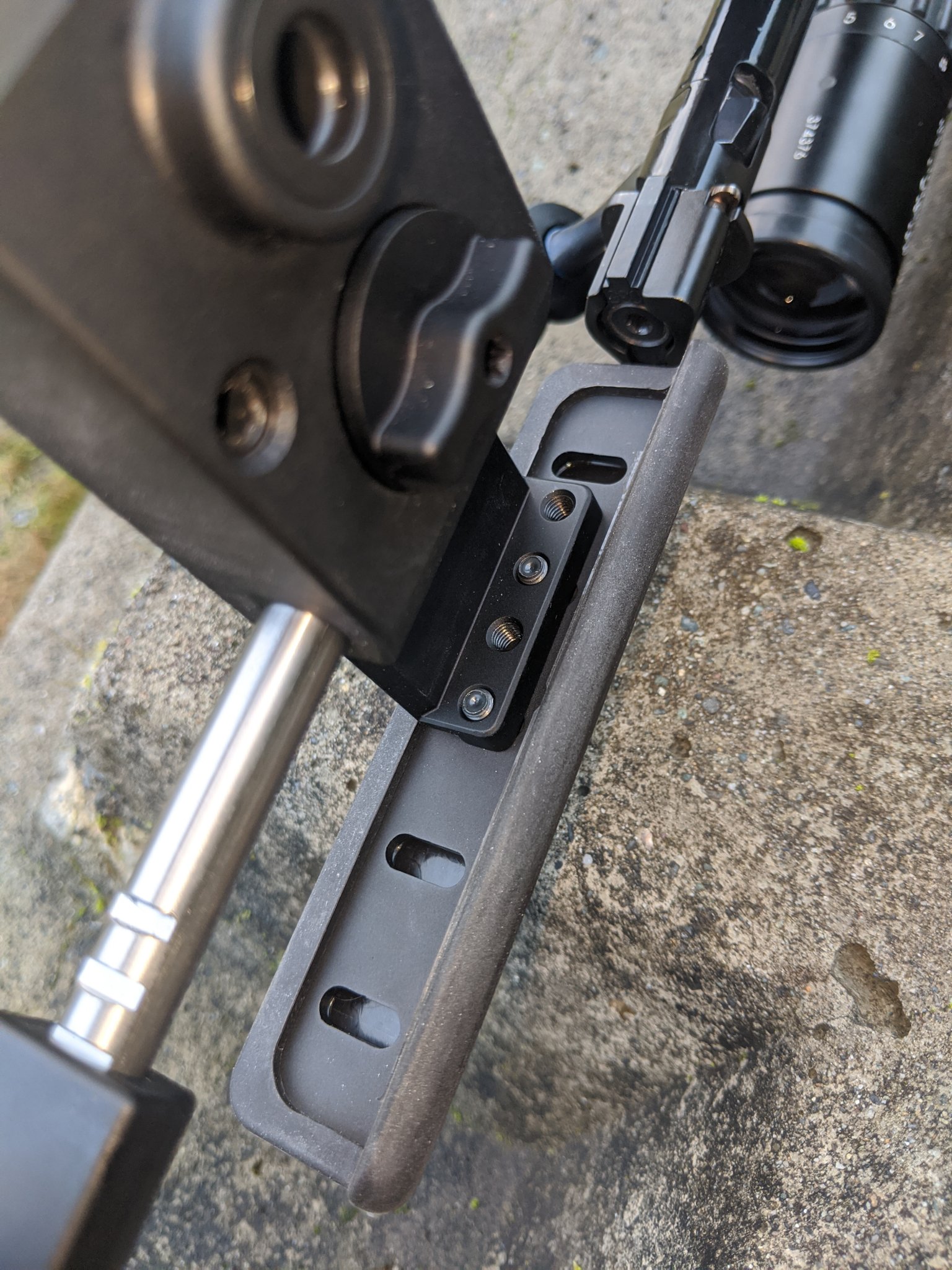

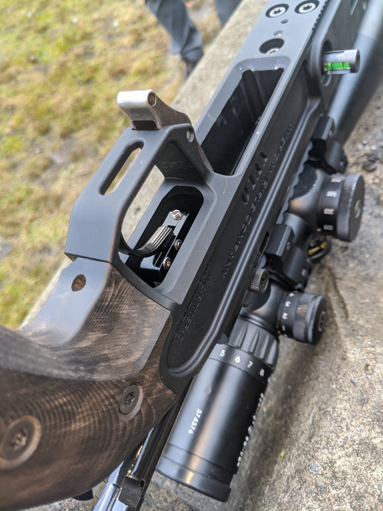

This is Ted, owner of American Rifle Company. I encourage you to look at out products. We make actions that are substantively different than the same old, same old Rem700 clones offered by all our competitors. We also make the most feature rich and best executed chassis in the industry for the R700 platform which features a properly placed ambi level vial that guys over forty can see as well as a pistol grip giving the chassis the feel of a bolt gun, and not that of an AR rifle. It also offers two inches of on-the-fly length of pull adjustment which is awesome for transitioning between positions such as seated and prone. But wait, there's more (beginning to sound like a TV commercial) like the dial-your-head rack and pinion adjustable cheek-piece. This is perfect for micro-adjustments between positions or user-to-user macro adjustments. The rack and pinion provides the mechanical advantage to raise and lower the weight of your head. Come up or down until you see the bright circle within your scope.
As for actions, our Archimedes is currently in stock. It's levering bolt handle makes stuck case a historical footnote. Our Mausingfield incorporates Mauser functionality in the R700 footprint, the only action to do so. Either way, we offered the best extraction solution in history, that of the Mauser 98, until we introduced a better one in the Archimedes, the action that completes the bolt action solution.
We also make the excellent M10 Scope Rings that have now served thousands of shooters extremely well. The cool thing about our M10 Scope Rings is that they use only a single scope clamp screw placed at 12 o'clock that will not rotate your scope within the ring when tightened. It is without a doubt, the easiest scope ring to use and as rugged as the best, and again, without the installation hassle.
If you're considering a departure from AI, check us out. AI makes excellent products but I think our products can out run them and I'm not sure that's true of anyone else. Again, we offer products that I, and many others, believe are the most innovative in the industry.
Here are some photos of a rifle with an Archimedes action and a Xylo chassis that we keep in the shop. If you can find more innovative products offering substantive performance improvements within the bolt gun space, let me know about them. Good luck. We're here if you need us and you can contact us at either 206-226-4387 or at [email protected]
Ted
