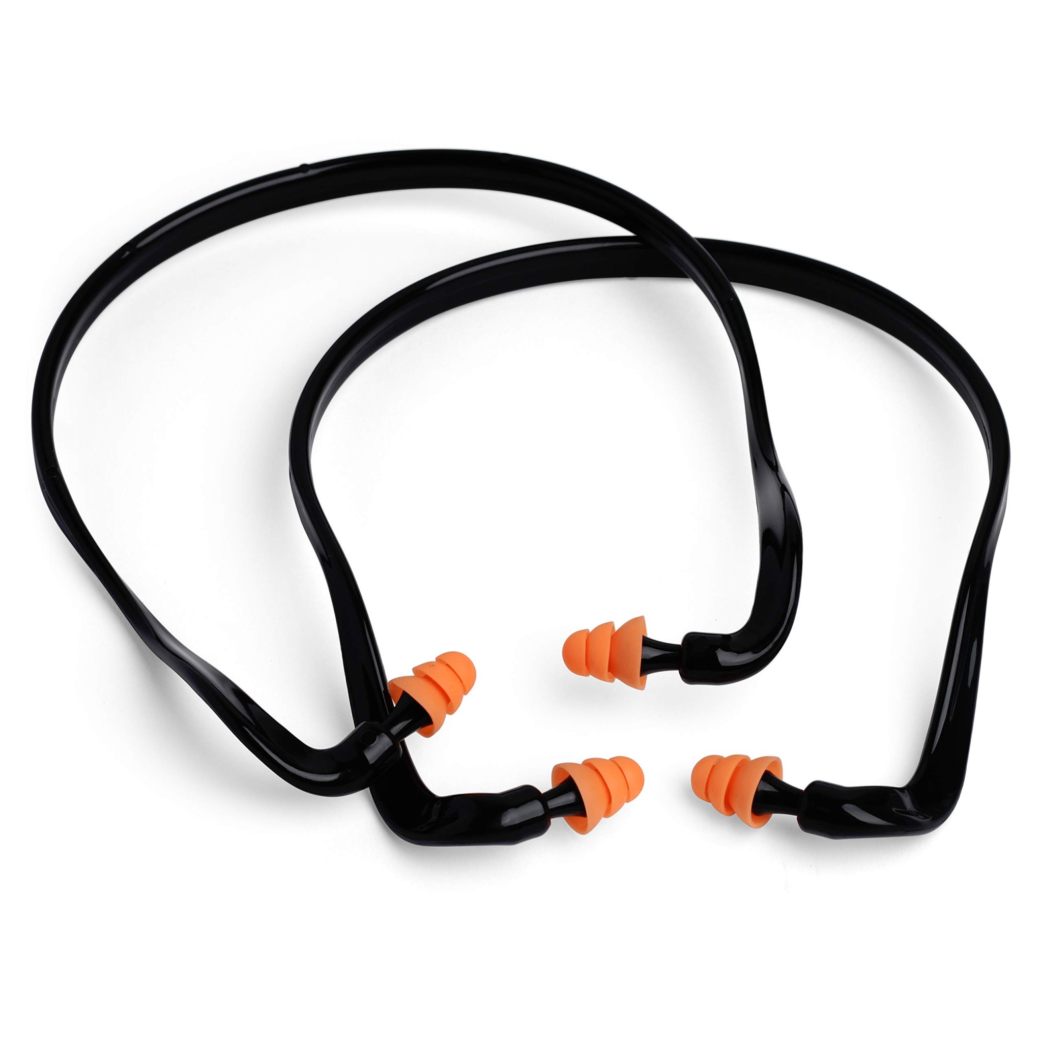

Personally, I'd loose the suppressor for hunting....WTF, it’s only one shot.
These are great for that situation, very quick to poke in. Tuck under your shirt collar etc and they are right there on your neck for quick insert
