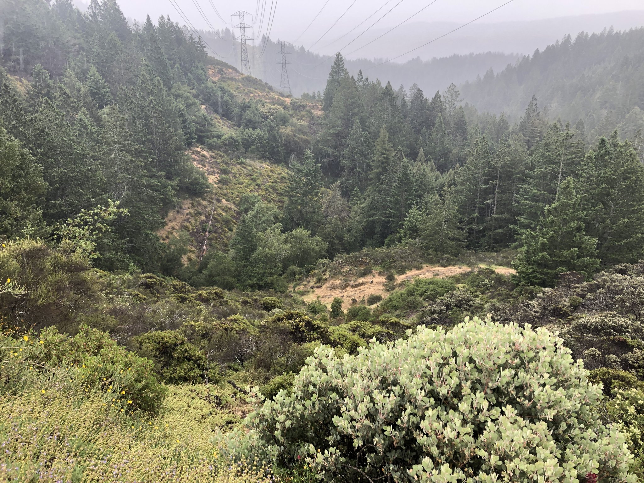

Some pics...
This is probably the longest shot. The bare spot on the hill is about 298 yards.

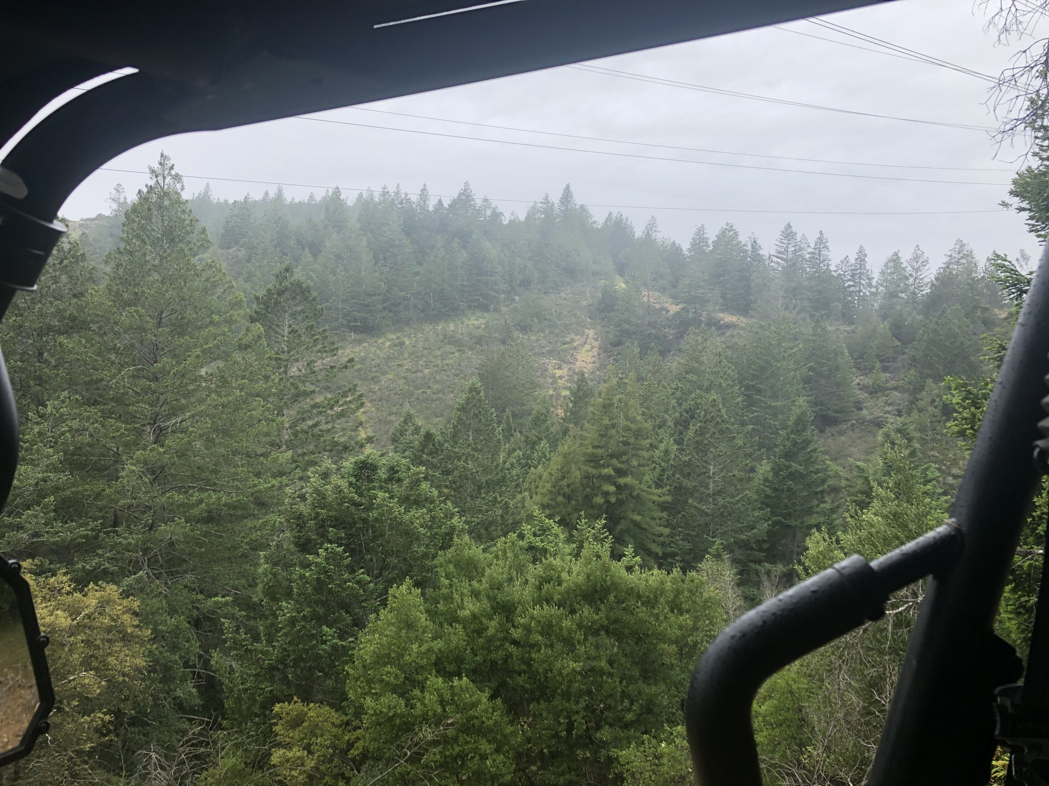

This is at about a 45 degree downhill slope maybe 150 yds. Further as you pan up.

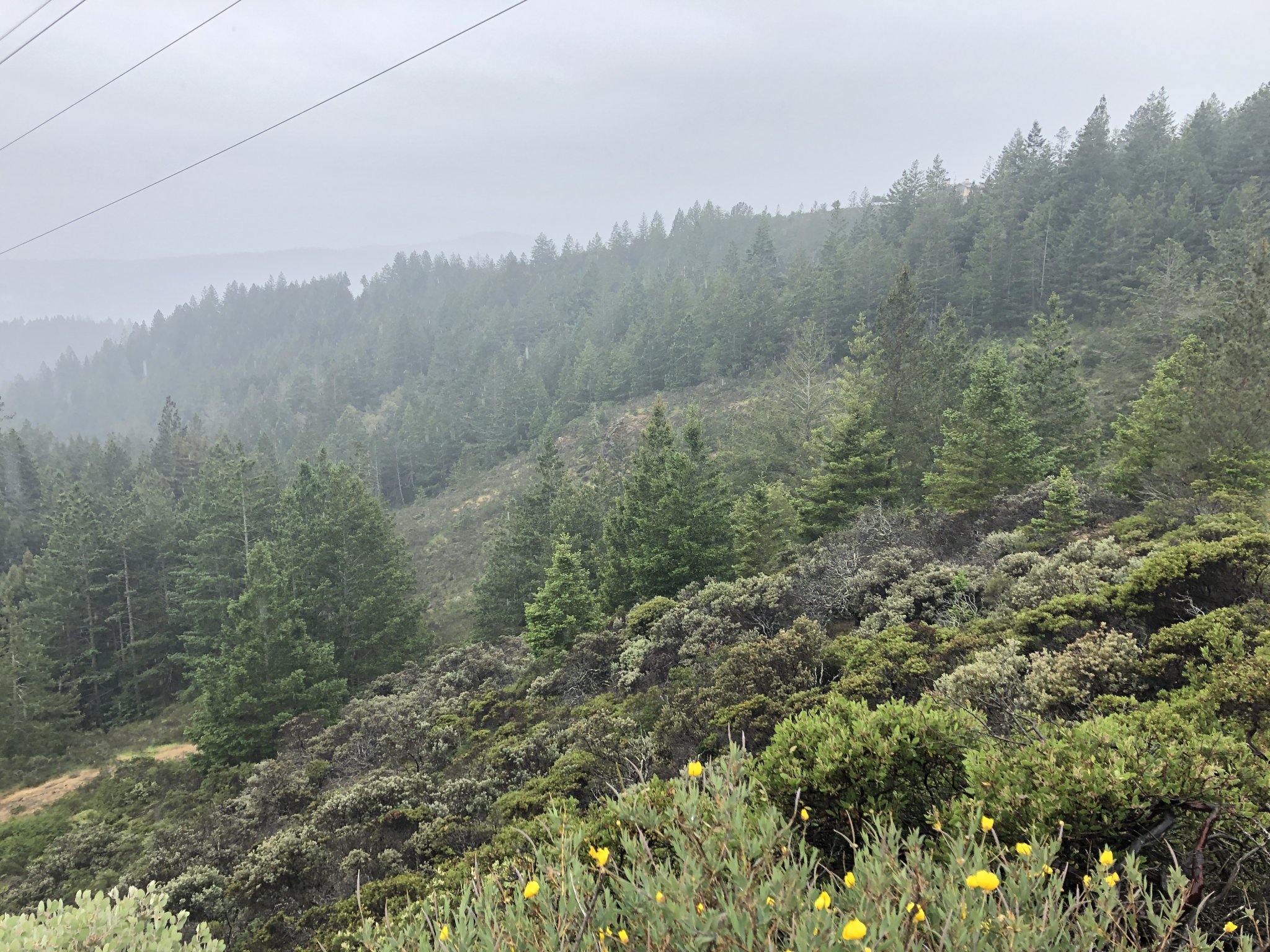

Another pic just to the right of the last. That ridge in center frame is about 250 - 300 yards.
That should give you a good idea of the terrain. What size, type of steel targets would be appropriate here?

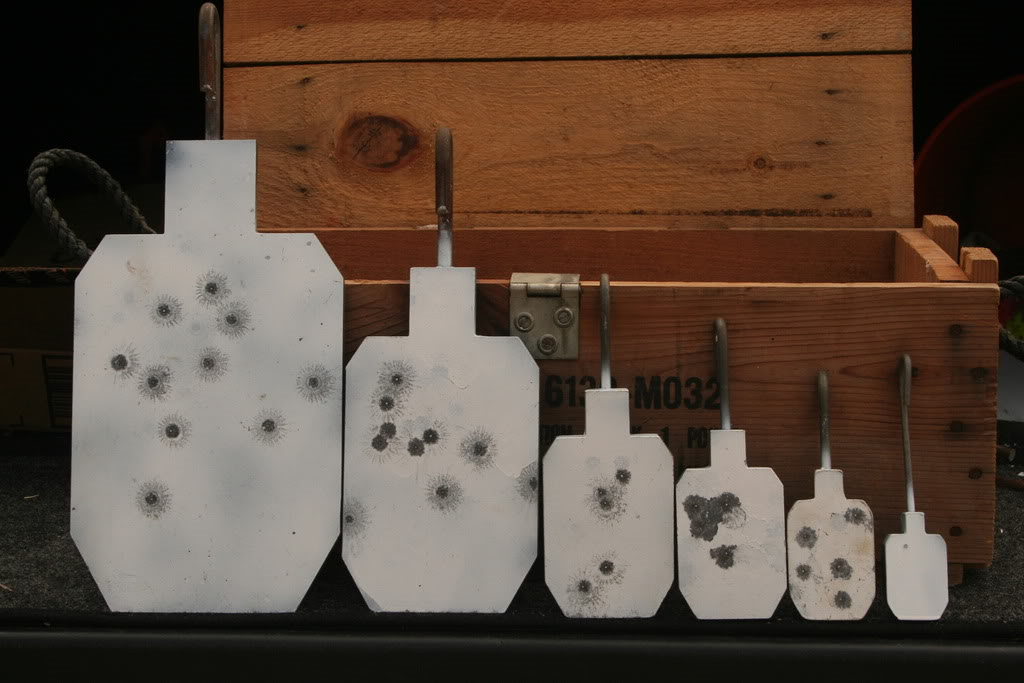

Also add another smaller plate for windless days: 1" at 100, 2" at 200, 4" at 300.
You can also put some rocks you find near the targets to shoot at.*
Put them in front of sandy background for easier spotting.

Target sizes like Littlepod said and multiples like Near Miss said. Large and small together, required hit on large to go for small, need balance between not discouraging new shooters vs. challenging better ones. T post hangers work great, hanging targets from rubber straps in odd locations works. Don't use thick centerfire targets, you want the ring and movement to help verify especially as you get out. My match is also in a natural setting, lots of trees and shrubs to deal with, don't get too creative with scattering targets about with the backdrop it's a PITA making sure everybody understands the COF - spend way to much time explaining. I'm also thinking about the painting issue, first shooters have advantage but rusty targets in a woods setting can be a bitch to point out, maybe markers or survey tape?

Targets: I've bought $300 of rimfire steel in the last 30 days to set up a field match in the mountains. I bought 3/16" AR400 steel from www.shootingtargets7.com Rimfire can't damage the steel; it will rust out before a .22lr will damage it. It's thin nature really helps with impact and carrying steel up steep hillsides. You can self-spot on a 16" circle at 400yds from the movement AND sound. They sell whole sizes from 1" to 4" and even sizes from 4 - 16".
Stands: We made stands from 3/8" rebar. Used a cutoff saw to cut it to length and a jig to bend them. Then a friend welded an additional leg on. Costs about $2 a stand is lighter to carry. We definitely did not want to use the conventional A frame rebar strap stands bc of the increased cost to build, complexity of setup, terrain limitations, and a double strap prevents target movement on impact and makes it harder to spot impact.
Target sizes: I first set up the longer distance targets using the sizes littlepod posted above and they were ridiculously hard. On a 6 target stage we were scoring 2's. We I now have a 3" at 130, 4" at 160, 6" at 200, 8" at 238, and 14" at 298. It's all wind. My rifle is very accurate. I laid down a .7" 10rd group at 100yds right before starting the match. We have a zero target at the first stage. I've won all but two NRL22 club matches I've shot over the last 14 months and my two buds that shot the field stages with me are very good shooter and are quite competitive. They beat me. Top score was 21 out of 42 available points and third place was me with a 16 out of 42. We were really amazed at how difficult the field match is. And in some cases were shooting 4 and 5 moa targets. We estimate it's roughly 75% more difficult than a club match. All the stages are off the belly except one.
Course of fire: We modeled this from a field match we really enjoy shooting in Raton NM. It is a very simple COF and design. Each stage is 6 targets. One shot per, hit or miss move on. A lot of people struggle with the discipline required to not go to war on a target but this simple format is cleverly addictive. When you only get one shot per target dropping just one round is devastating. And it makes it more difficult to dial in your wind hold. For this format, you want to design the difficulty so your top shooters are scoring 90% of the available points in good wind conditions. In tough winds they'll be roughly 70%.
Painting or finding targets: Because of the location of where I set up my stages I didn't want the targets to be obvious. I began painting them OD Green but their natural color the way they're shipped is a dark brown and that's actually perfect. You can still see impacts through your scope. Finding the targets is another matter. We set them up in a troop line or a linear manner. It helps folks tremendously when they know there are always 6 targets in a mostly linear array. If they can't find a target it's usually the first or last target they're missing. Placing them in natural terrain with vegetation unpainted makes them fairly difficult to find. Both before shooting the stage and while transitioning engagements from target to target. Some stages are set up from 70 to 160yds, some from 130 to 400yds. 6 target stages also help keep the cost down. I estimate the average stage cost is $25. Last note: A highly adaptable bipod like the CkyePod is essential.
Hope that helps and have fun out there!
