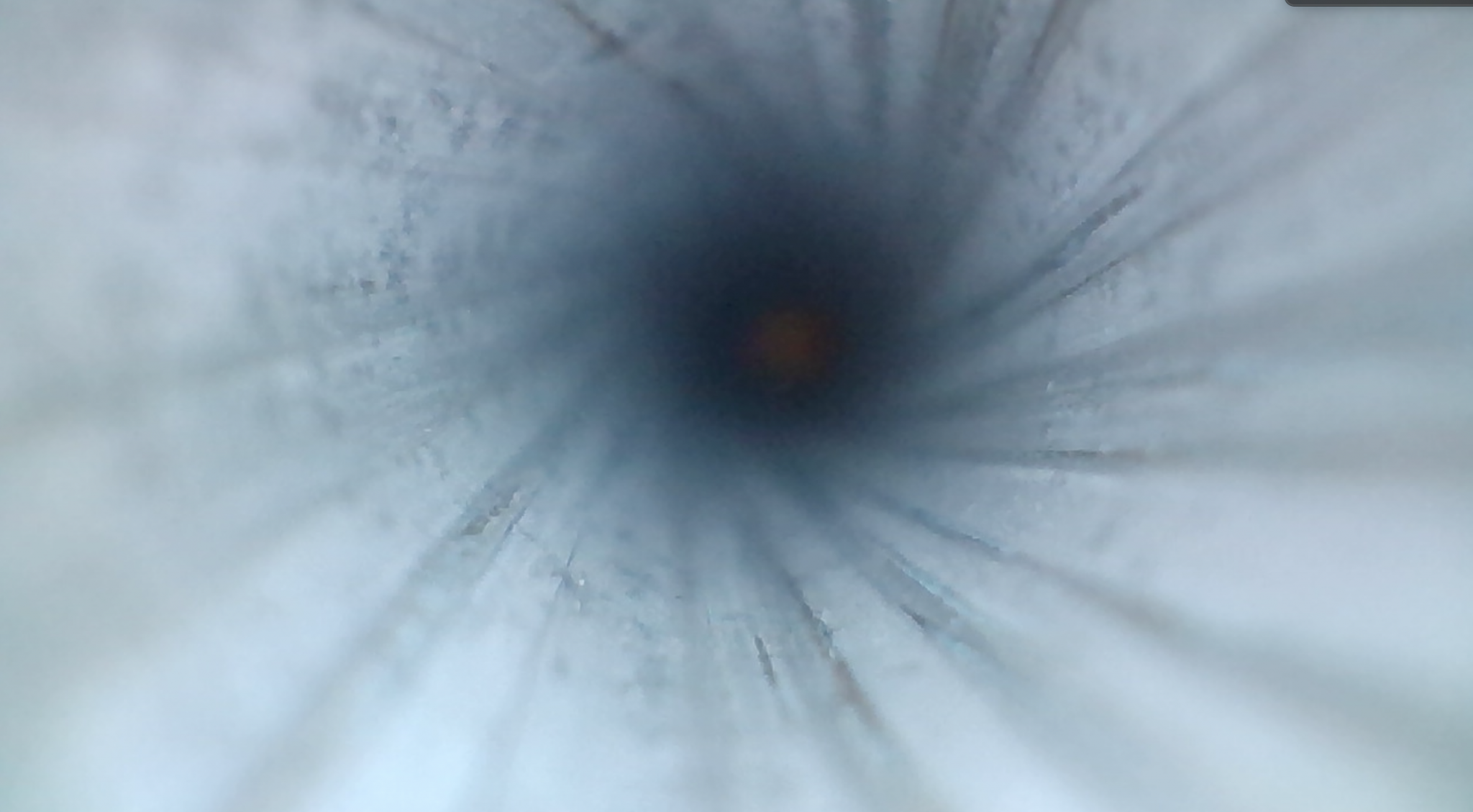

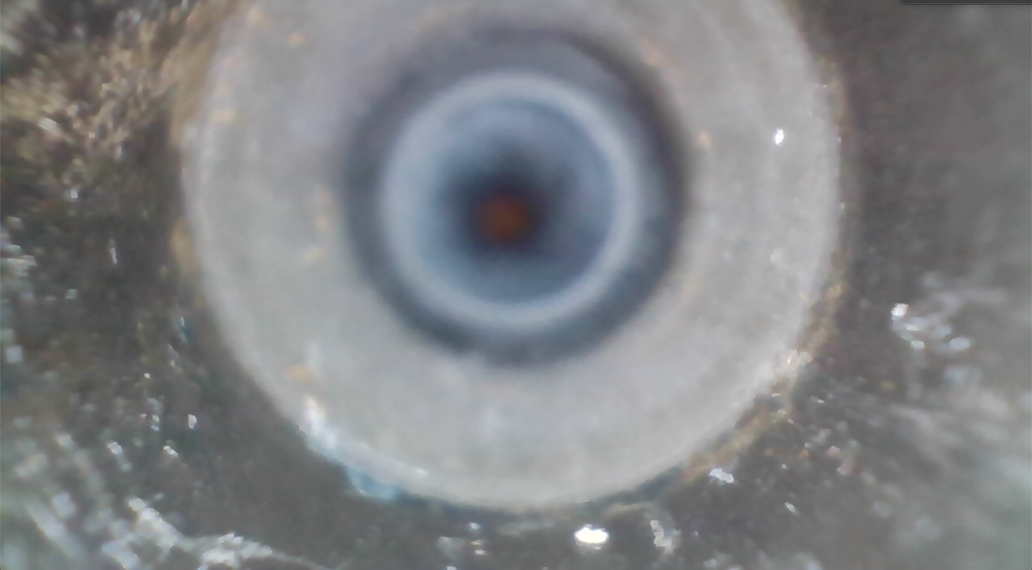

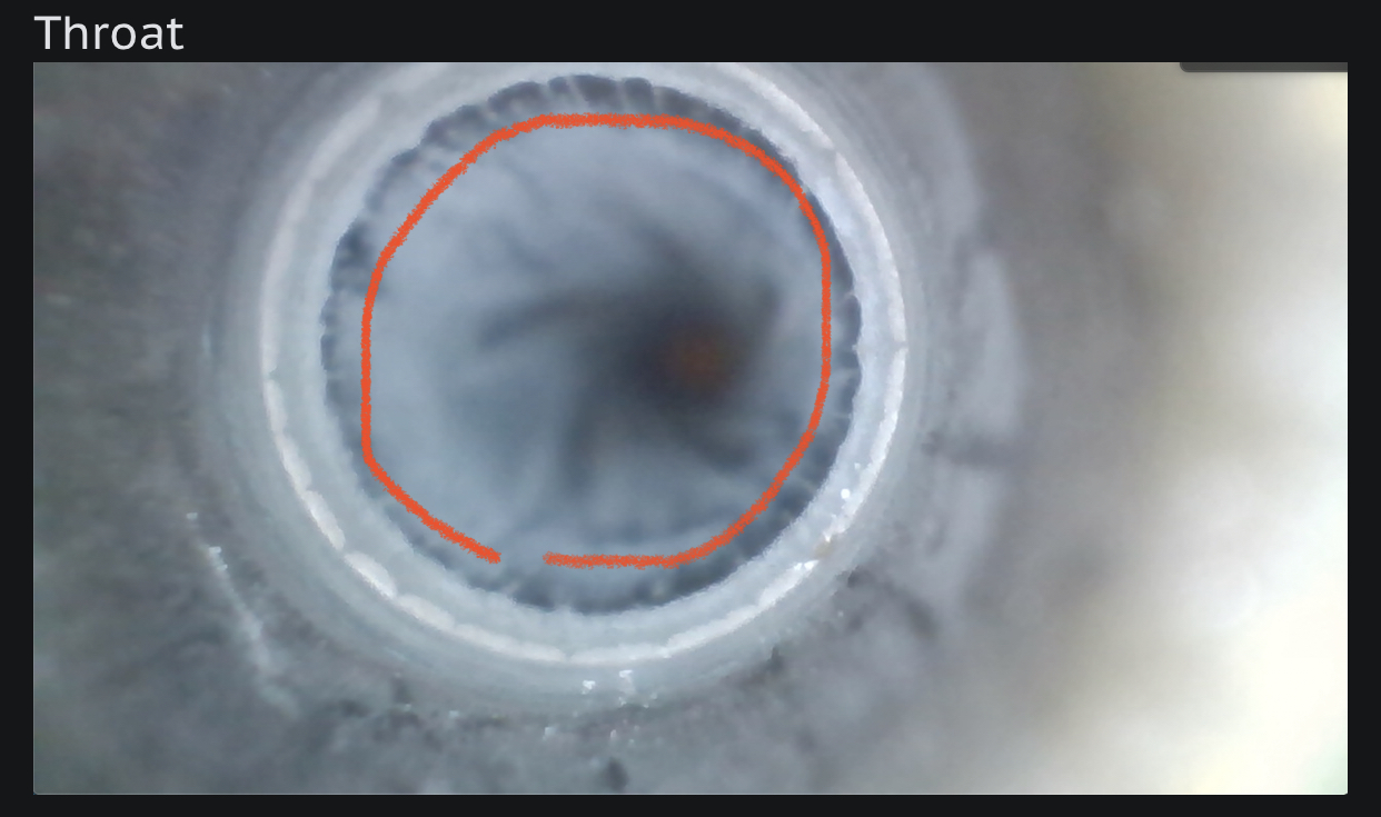

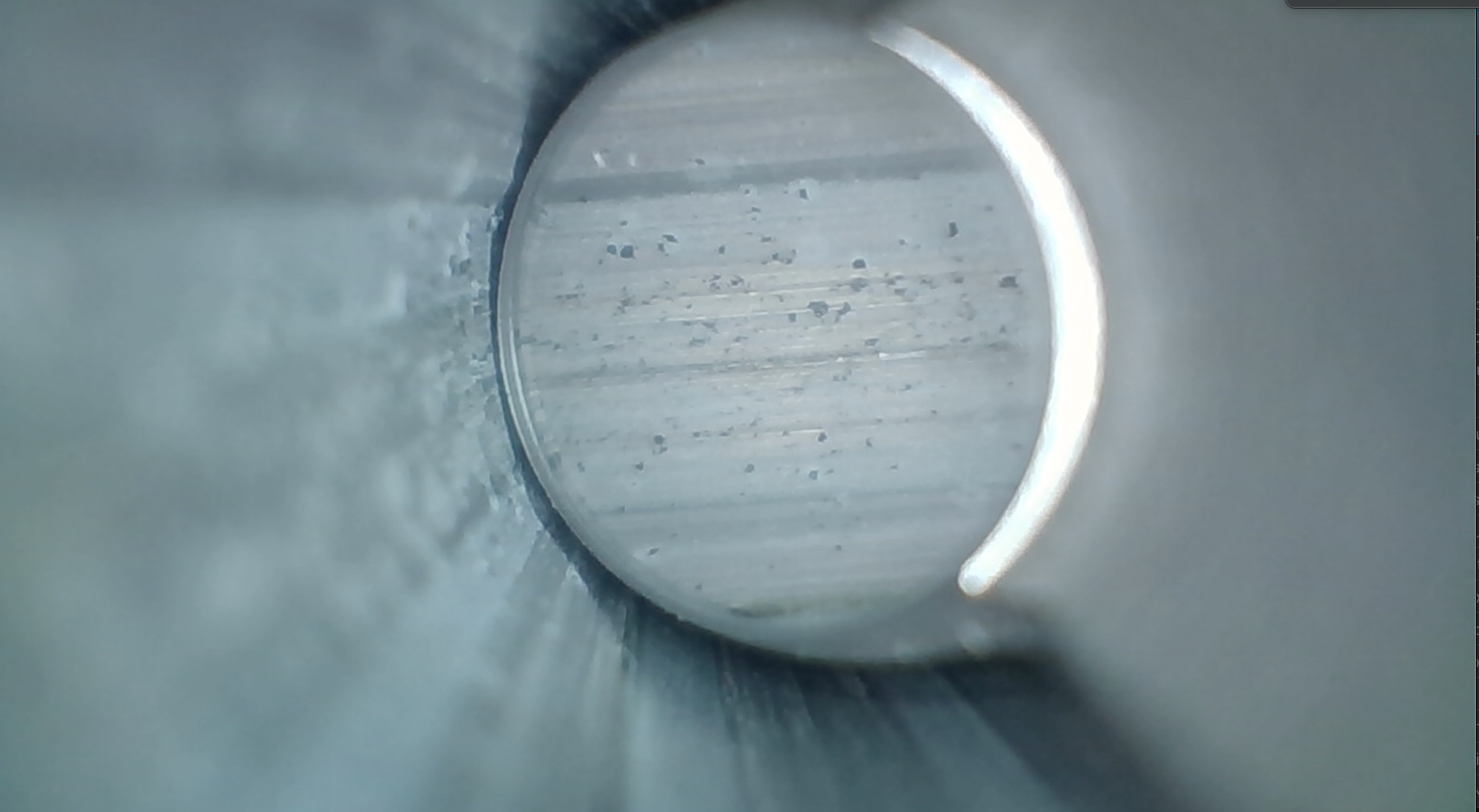

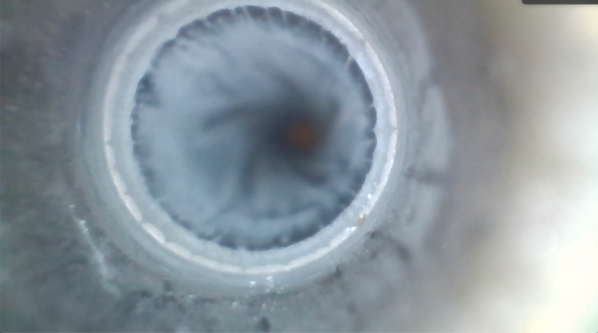

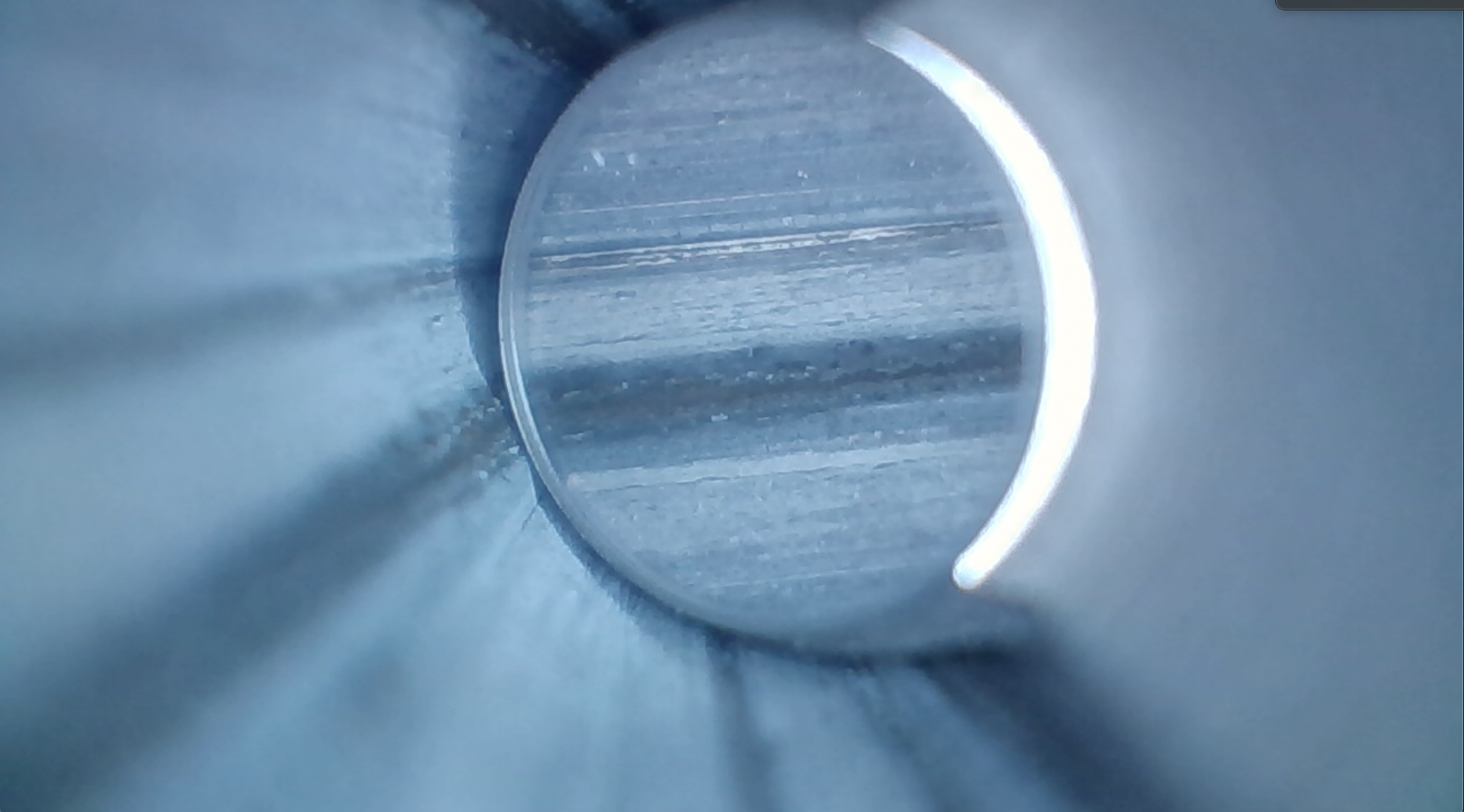

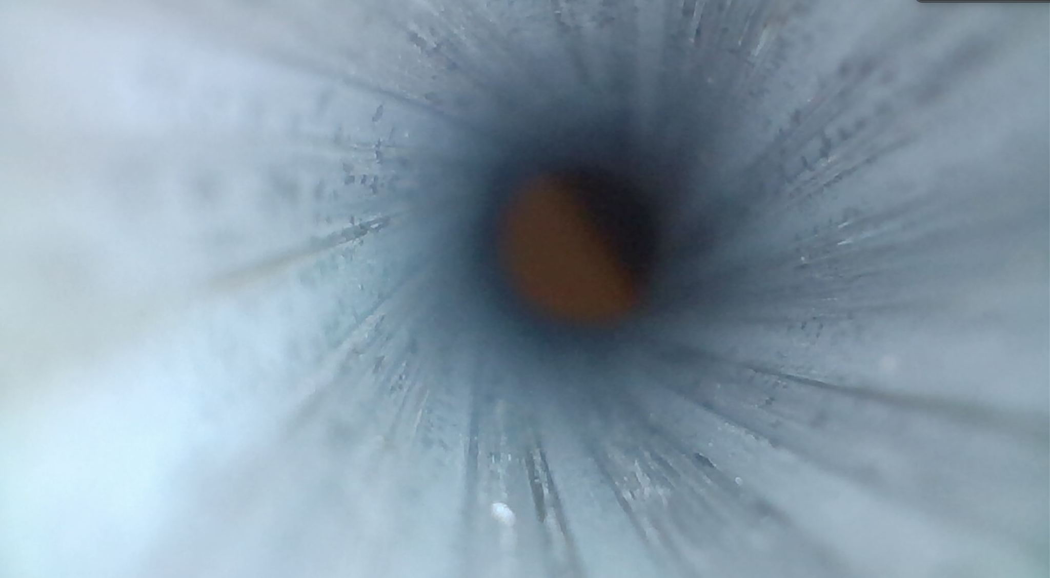

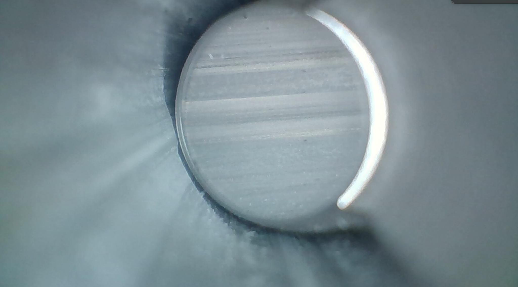

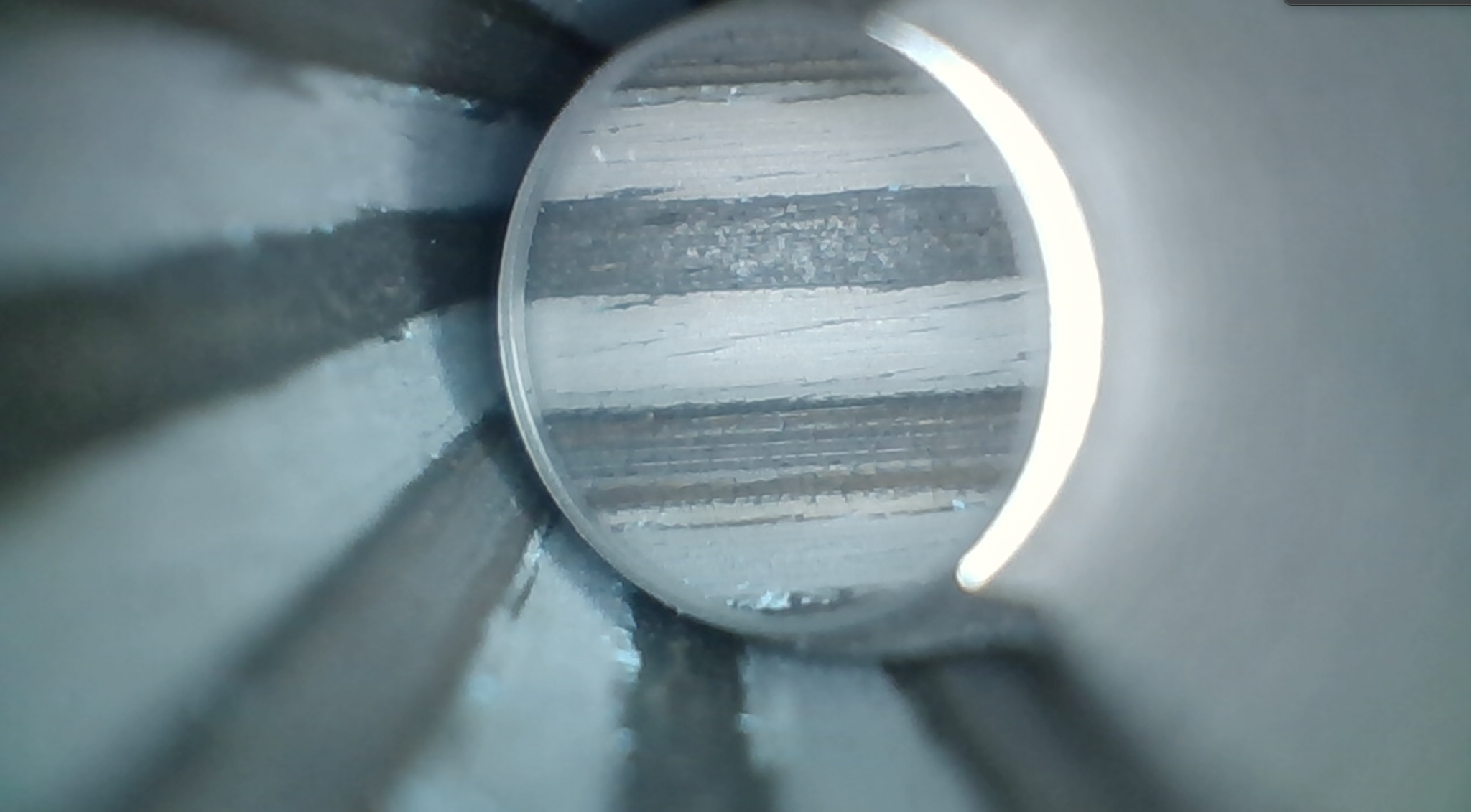

Good evening all. I recently purchased a used 24" 6.5CM barrel from a high quality manufacturer described as having ~200 rounds on it. Having received the barrel, a visual inspection of the exterior suggests that it is in excellent condition. However, I recently purchased a USB borescope and wanted to see what the barrel interior looked like as well.
Based on photos and videos I've seen elsewhere, I expected to see quite well-defined lands and grooves, with consistent rifling from throat to muzzle. I was somewhat confused by what I actually saw, but never having borescoped my own rifles before I don't have the experience to evaluate it (my other rifles are in storage so I can't compare them).
I'd appreciate any comments based on the images below. Please feel free to ask for additional detail or shots from the borescope. Thanks!
Chamber
Throat
A few inches down from the throat (straight on [SO] and right-angle mirror [RAM])
Half way down the barrel, SO and RAM
6 inches from the muzzle RAM only
2 inches from the muzzle, SO and RAM
Don’t know yet.

Let the target tell you what's going on. I have a few barrels with hardly any rifling left in the throat and still hammer.
Honestly to me it looks like a barrel that needs to be shot. Very little fire cracking in the throat and very little copper anywhere.

And yes. That throat has carbon building around it already.

Clean the barrel, you probably aren't using the same bullet or powder. Give your self a fresh start, a baseline to build from.
It seems you may be a new borescope owner too, just run the mirror attachment, the forward views really don't tell much if the barrel has carbon in it. Plus, things will look 5 times different when you scope a clean barrel, way brighter.
